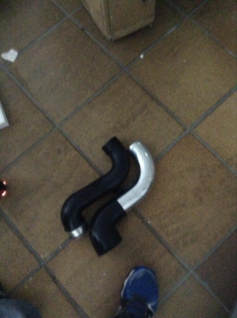

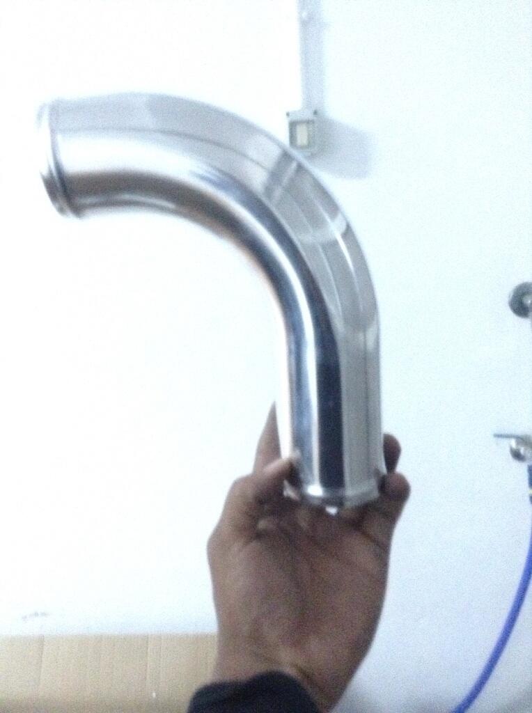

Just installed yesterday. Won't keep you in suspense. YES IT FITS! Originally I ordered a 5 inch and was sent a 7 inch by mistake. So you can imagine my frustration at first when I'm trying to slide this thing in there and it just won't fit. Thankfully I have a dremmel so I could shave off the plastic inside the front bumper cover. However I think I may have to shave more because I'm having a hard tome getting the factory mounting screws tight. But with the extra L shape pipe they send you it will work. But I suggest maybe that they include one more rubber coupling for where the L shape pipe connects into the charge pipe. Right now it's just going into the plastic with the clamp and seems to be sealed well but can never be too sure. Doesn't feel like I have any boost leak but can be very slight.
Impressions are.........uh-fucking-mazement. Let me see. The easiest way to describe the difference is basically like if your car never heats up. You know once it heats up an gets good an warm it feels just a tad slower. Well I don't feel that anymore. Even after multiple pulls. Even after getting off the highway so u know the car is good an warm. Did another pull an still felt just as peppy as right after startup. So does it actually make it faster????? I'd say not so much. But you definitely feel the difference after the car warms up where it normally becomes sluggish but not now.
I will add pics in a bit of the pipes but ill apologize now for the shitty quality. The car was on jack stands an not much room an trying to hold a flashlight makes for shitty pics.
In these first 3 pics you can see the stock lower charge pipe in black and the upgraded one that comes with the FMIC in silver

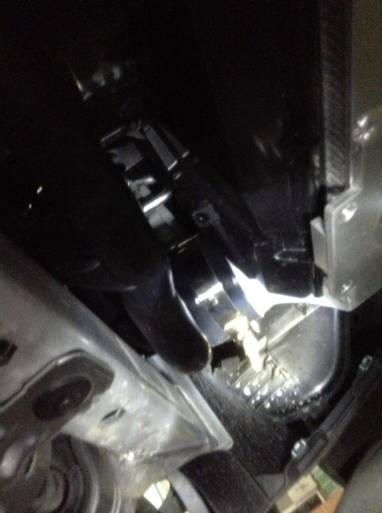

Passenger side rubber coupling for FMIC inlet side
Upgraded lower charge pipe installed on drivers side. It can be hard ro tell looking at it I know but if you follow the silver up and see the light thats the top of the engine bay and the hood was open. Up top is where it connects to the upper charge pipe
Drivers side FMIC connected to upgraded lower charge pipe. Hard to tell I know
And Passenger side FMIC connected to charge pipe coming from turbo
Again please forgive me for the picture quality. All I had to take pics with at the time was my ipad and I had to hold a flash light and aim at the sime time lol.
2013 BMW 135i Alpine white/coral red JB4 stage 2/ AFE stage 2 sealed intake box/ VRSF 3.5 inch catless dp/ Dinan exhaust/ Alpine V3 6000k HID angel eyes/ JB speed AW rear lip spoiler/ OEM mud flaps. ER charge pipe/ VRSF 7 inch FMIC forge star CF5s 19x8.5 and 19x9
