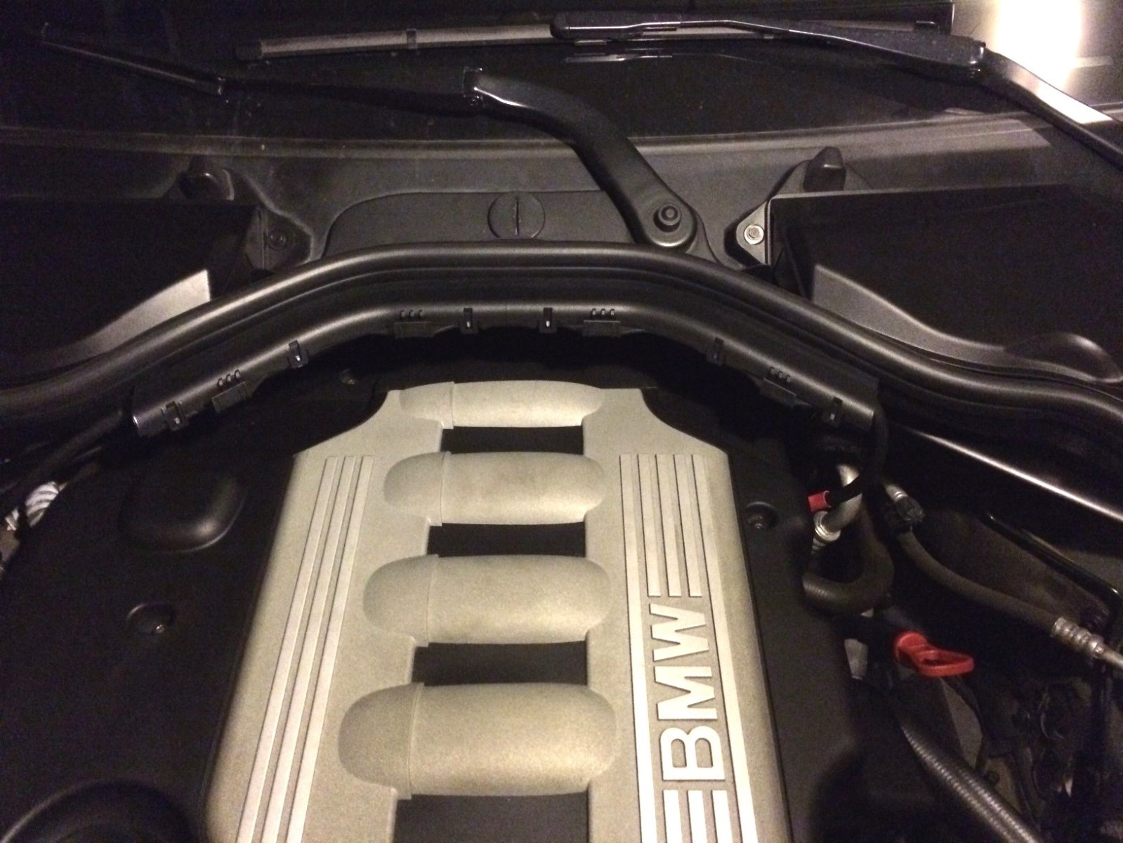

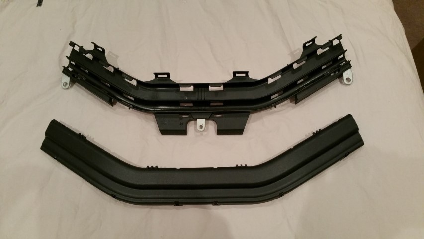

Sorry for continuing a very old thread. I think the folks that did this would like to know of the cable tray parts.
This may be already known info. I scanned through the pictures and read the early dialogue and didn't see it. I bought 2 parts that nicely house the cables coming across the cowl. See the 3 pictures. You can't buy them in North America though. I bought them from Schmeidmann in Denmark. They ordered them from Germany. Took a week to ship from Germany to Denmark and then another 5 days or so to arrive in Houston. Really finished out the project nicely. About $60 total to my door.
part numbers:
12-52-7-838-732 cover
12-52-7-838-733 lower tray
These bolt to the cowl along the front edge. Enjoy the pics

The cable tray is from RHD M3. I also have it on mine.

Can someone show how the cable support, lower tray piece is to be mounted? (PN 12527838733) Does it attach to the cross members or to the bottom of the M3 cowl? I see three screw tabs but they don't line up. I will remove my rear plastic engine cover & try again...
It looks like you have to break out the tabs on the cowl pieces to slide the cable tray on and bolt it. My issue is that the cables are too short to fit.

How did you get your cables to fit?...mine appear to all be too short to go through the cable tray.
Best,
Andy
I have a 335d so maybe its cable is longer than on your gasser.
