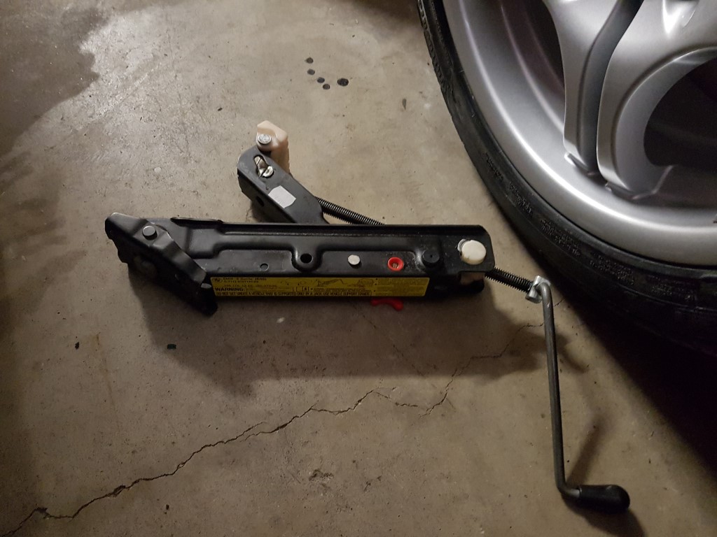

Yep, I hate not having a spare (so now I have one). I also carry a mobility kit, a compressor, and a scissors jack. I'd recommend a small breaker bar over a ratchet. If a lug is really stuck and you stand on a rachet, it might break and still leave you stranded.
My jack kit from BMW-Direct came with a breaker bar and all the other goodies including the torque bar. I'm carrying a full size 18" spare until my alloy space saver arrives.

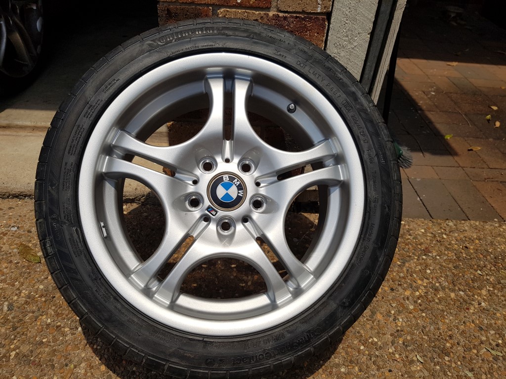

Picked up am OEM jack and spare wheel in anticipation of my move to non-runflat tyres. The wheel is 17x7.5 and is brand spanking new shod with a new 225/45ZR17 Continental tyre. I scored them both from an E46 318i sedan at a wrecking yard for $120. Now if only I could find a retailer that has Michelin PSS's in stock!
