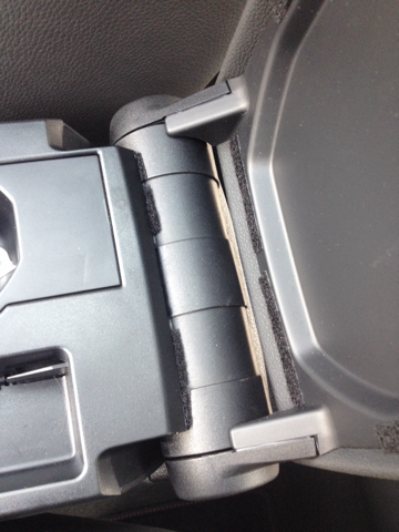

2008 BMW 135i  [10.00]
A while back I mentioned I used 3m double sided Velcro to solve this problem on my 1er. I placed the loop side Velcro as shown below, no creaks since!
I found the biggest difference was when I placed velcro on the round hinge mechanism. The plastic here showed signs of wear from the two panels rubbing and even after I did the door on the console it still creaked, so I tried that and it solved the issue.
