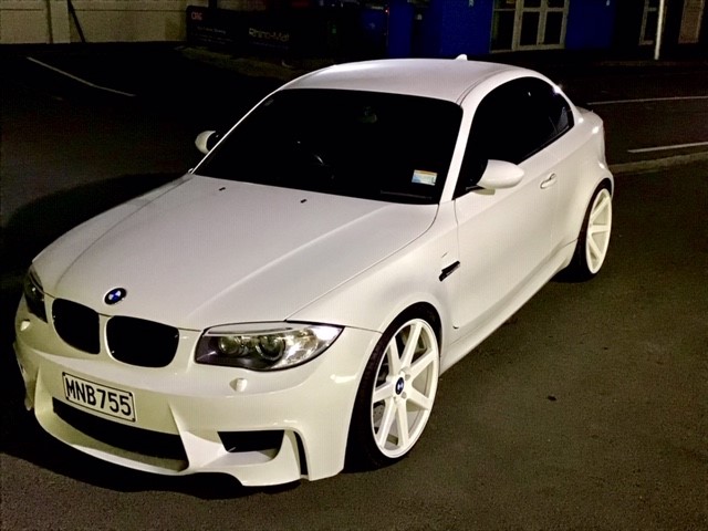

Drives: 12/2016 M140i (witch-craft)
Join Date: Dec 2018
Location: My 'MAN' Shed
My modded 1m
Wheels:NICHE VERONA PAINTED WHITE
Front: 20x9 ET21
Spacer: NONE
Rear: 20x10.5 ET25
Spacer: NONE
Tires:
Front LEXANI LX-TWENTY 245/30/20
Rear LEXANI LX-TWENTY 275/30/20
H&R LOWERING SPRINGS/Fender Mods: MOVED INNER FRONT FENDER FORWARD/Camber:NONE
Notes:
No rubbing after moving in front fender forward
(Rubbing or anything else to note)
