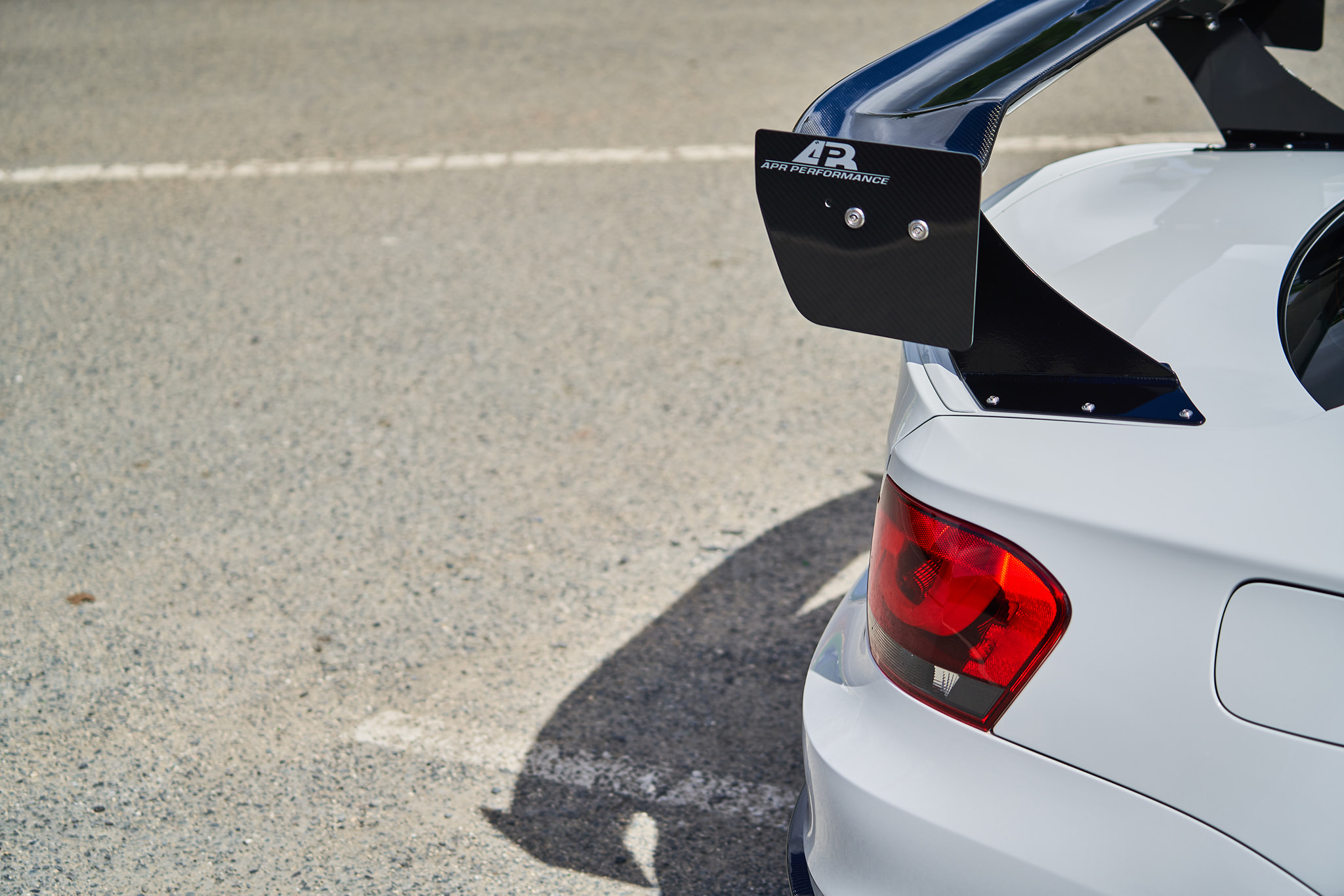

The wing is attached to the trunk with Rivnuts, 6 on each side. 12 in total.
I had the mounts custom fabricated, and they are large enough that they dissipate the force evenly across the trunk. I've had the wing off numerous times since originally installing, and there is zero deformation or bending on the trunk. No additional brackets inside the trunk, no. I've had the car over 150mph with the wing installed, and it was rock solid.

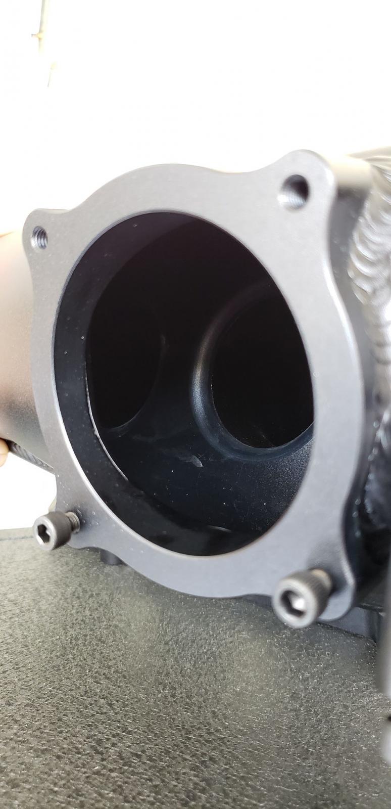

BMS/ Phoenix Racing Port Injection Manifold & Carbon Fiber Interior Trim!
In preparation for running heavy concentrations of ethanol in the future, I decided to pull the trigger on a Phoenix Racing Port Injection Manifold from Burger Motorsports. I installed it with a set of injection plugs for now, until I can figure out the exact size injectors I want to run.
Install was a breeze, and it looks great! The stock plastic manifold was such an eye sore! The butt dyno says that it flows slightly better than stock. Top end pull seems a bit stronger now!

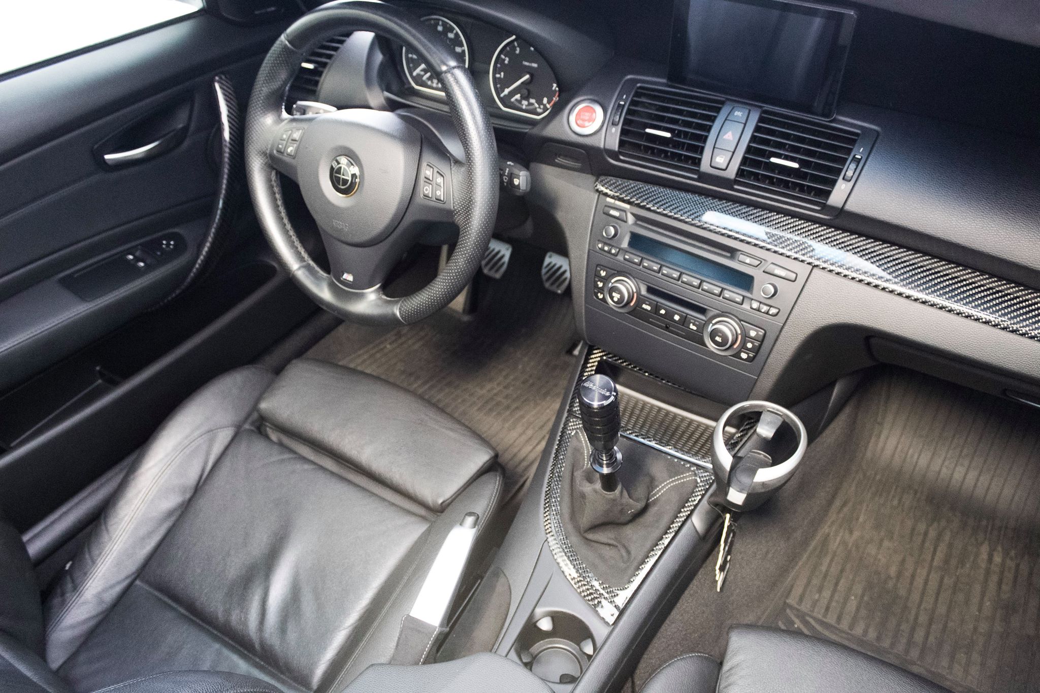

Made a few changes to the interior as well.

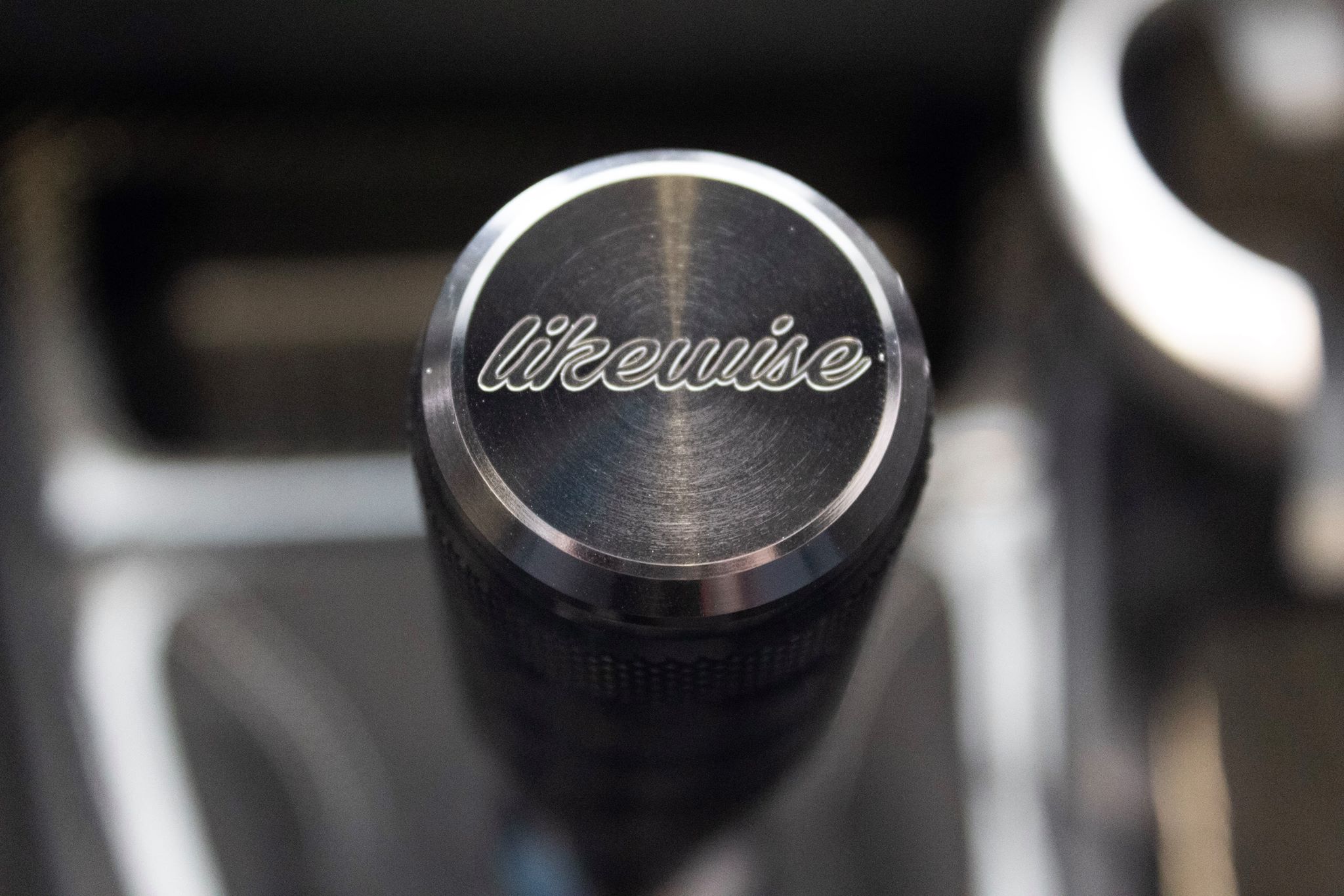

I am now running the Daytona Pro shift knob from WeAreLikewise. It is made from 304 Stainless Steel, and weighs a whopping 1.3lbs. The RTD shifter used to be slightly notchy with the BMW Performance knob, but the added weight now helps it slide effortlessly into gear.
I like having an assortment of shift knobs on hand. Switching them out periodically changes the feel of the car more than you'd think and keeps things interesting.

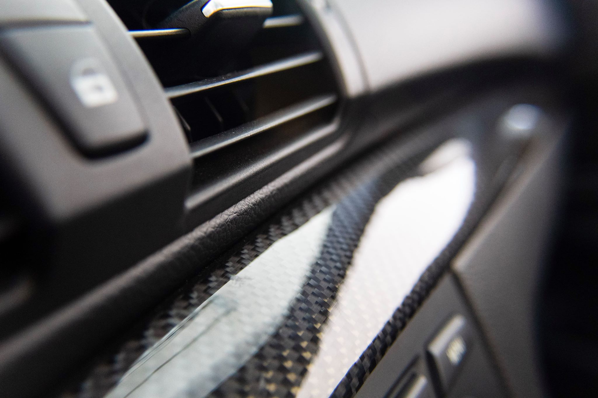

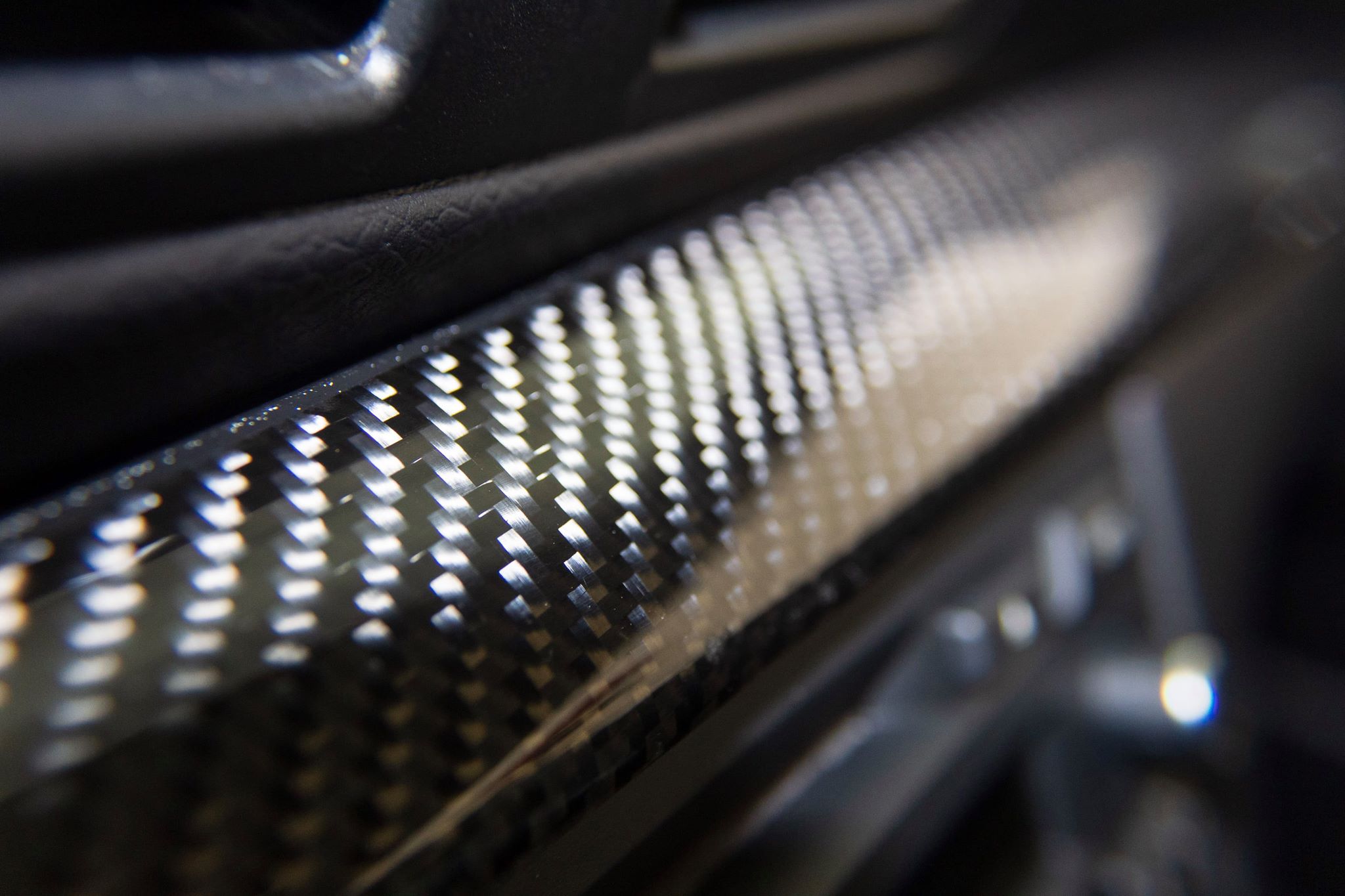

Also, finally received the carbon fiber interior trim kit that I ordered from Mashimarho a couple of months ago. The kit was custom made to order, and definitely worth the wait. It's beautiful! I was very happy to get rid of the wood grain..
