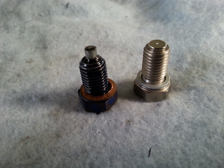

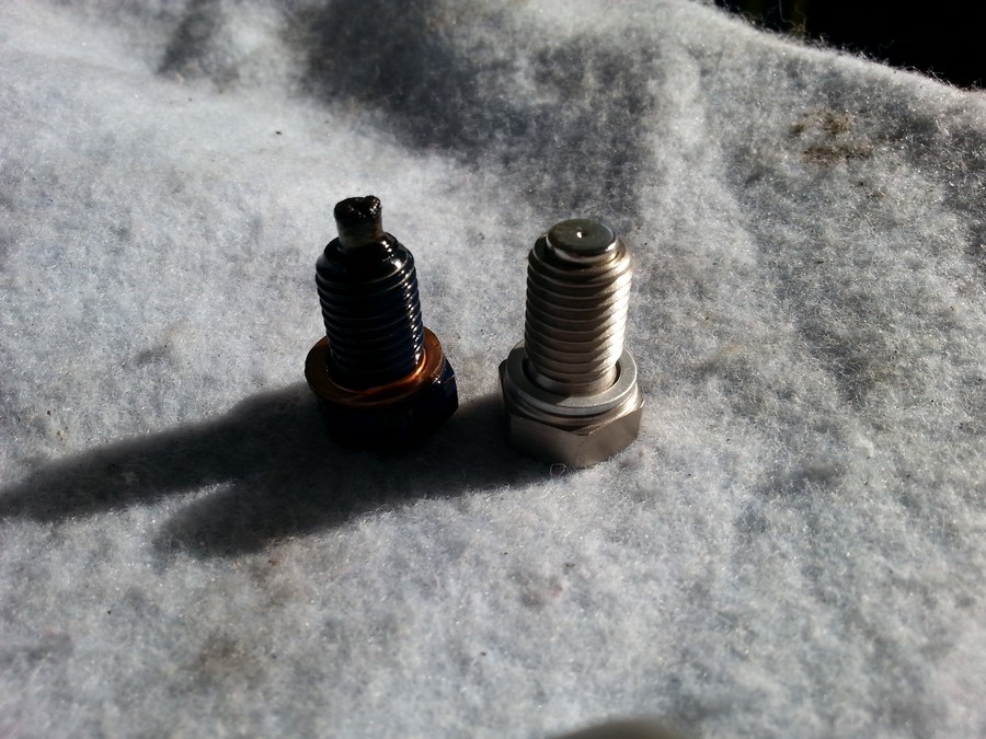

I just realized I never posted my Dimple oil drain plugs in this thread. I really am more happy with the DImple plugs over the UUC plug. The magnet in the Dimple ones is way stronger than the UUC one.
Attachment 1079943
Attachment 1079944
Attachment 1079945
Attachment 1079946
More Dimple plug pics here...
http://www.1addicts.com/forums/showt...=496058&page=2
