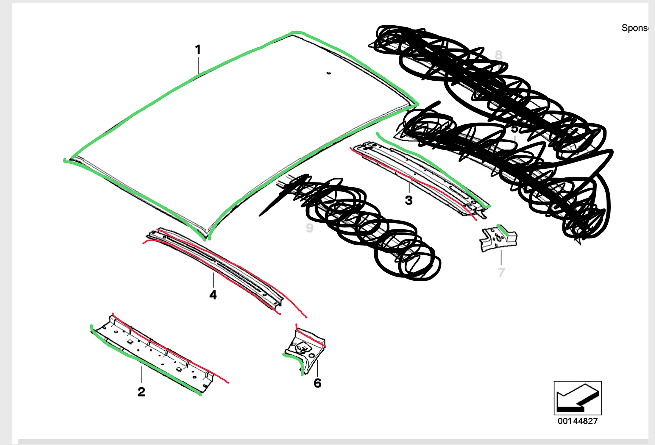

Good. I’m happy to help. Do you have some pictures of this job posted up somewhere?
As for your wobble. You should have used a thick bead of sealer/dampener on the top of all roof bows to form a semi flexible bond between the skin and the bows. BEFORE bonding the roof in place. Was that done?
See pic.
Green is bonding adhesive.
Red is sealer/dampener

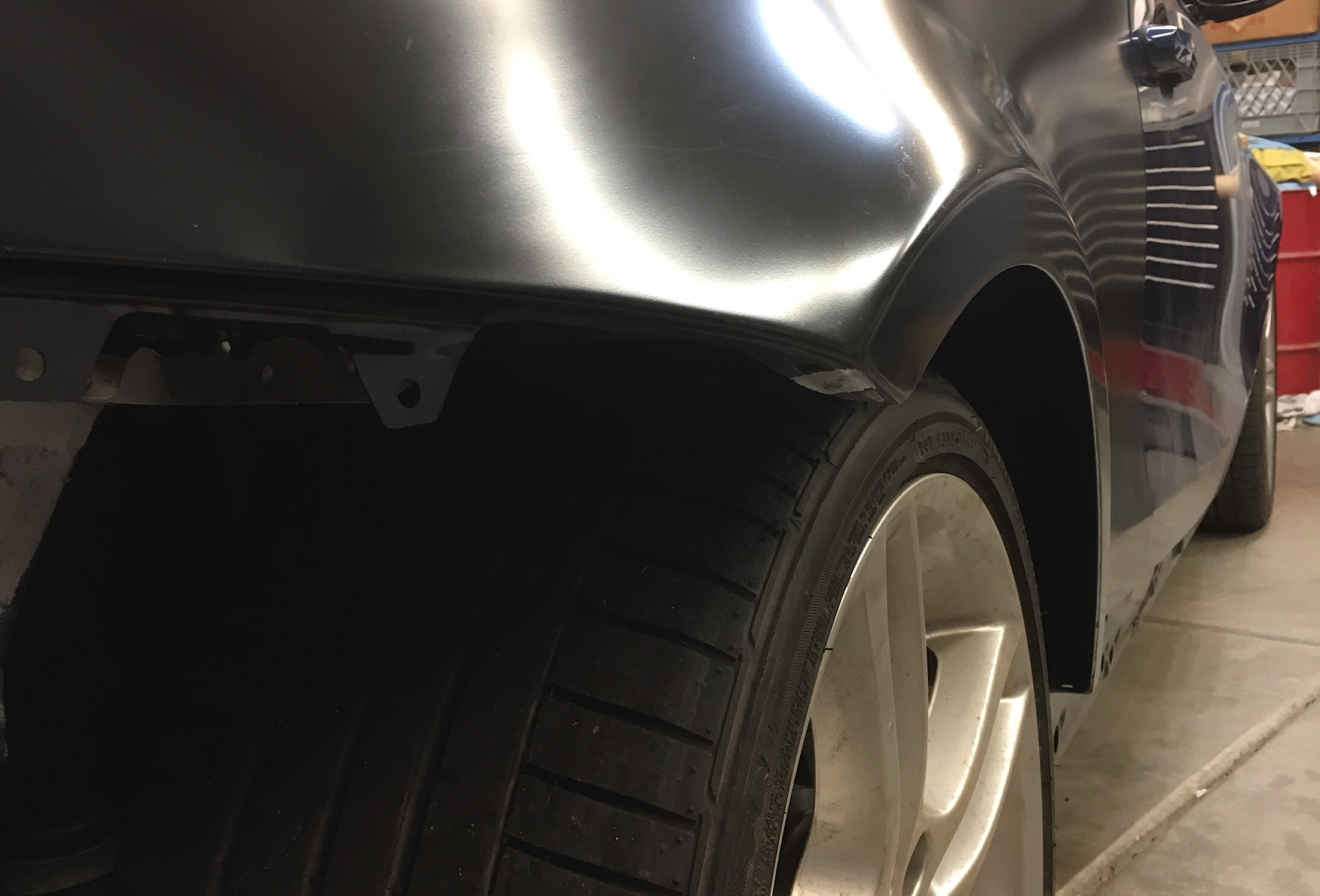

Tire clearance. Chix dig it. Nothing here to catch on the sidewalls. Rolled over like a door skin.

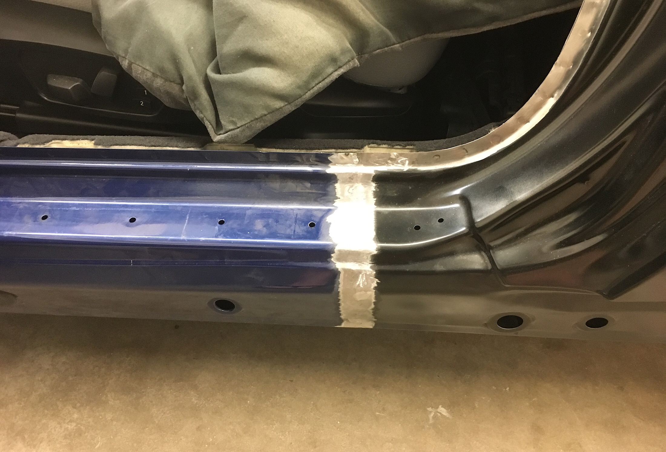

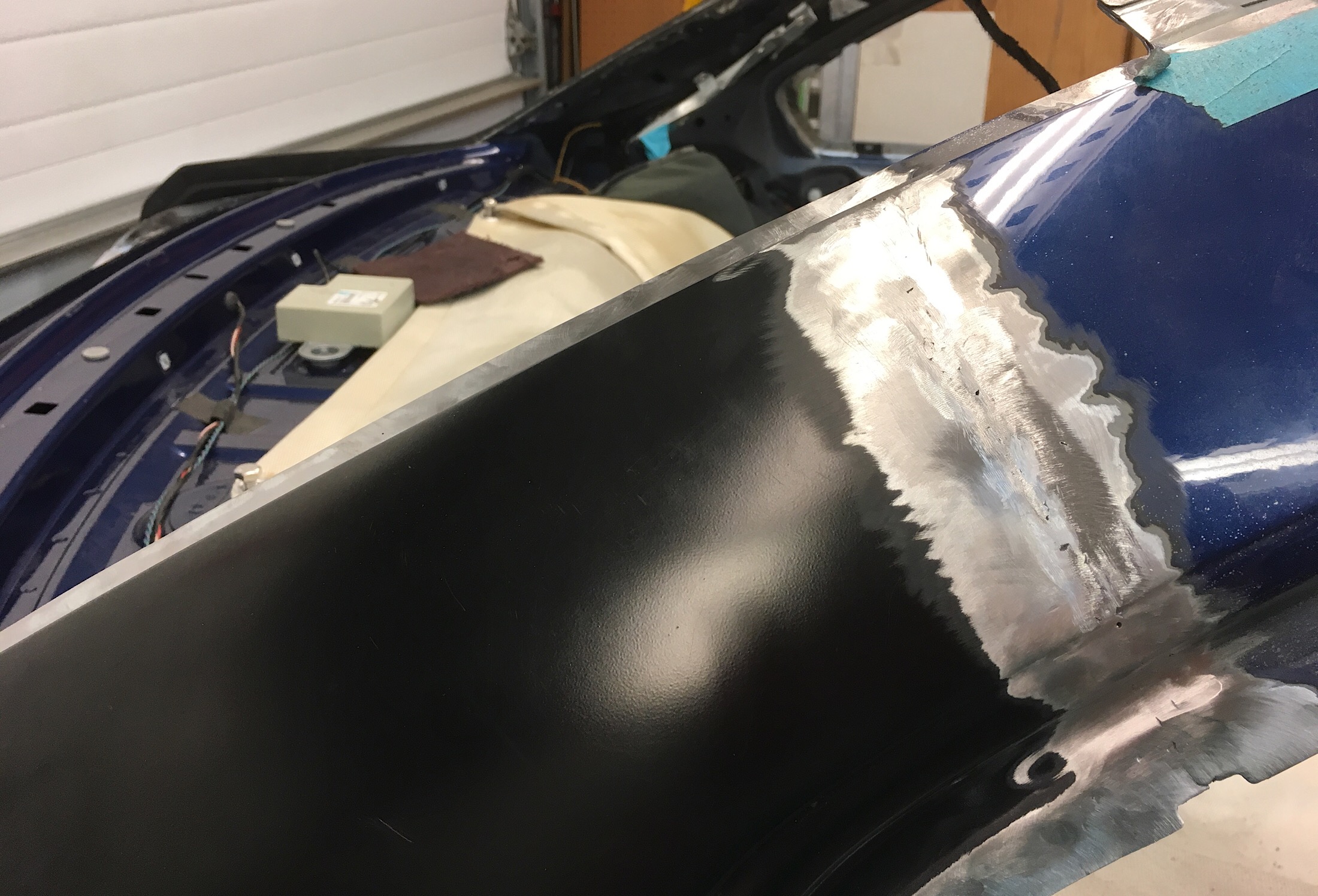

Just about all done with metalwork on this project. Just about time for some filler on the seams.

Roof ready
Roof is prepped and ready to bond.

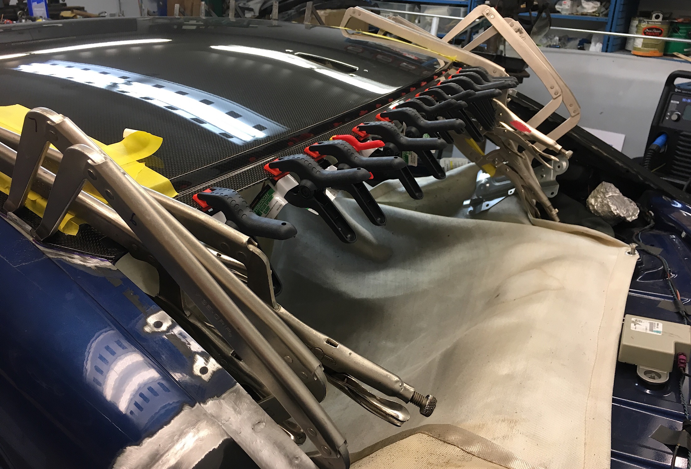

      06-23-2019, 12:01 AM   #115
BillDaCat8
BillDaCat8's Avatar
287
199
Drives: Toyota Tacoma
Join Date: Dec 2015
Location: Glendale AZ

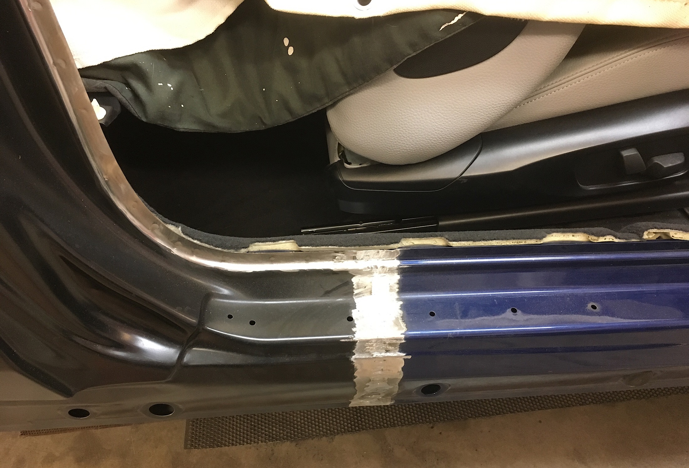

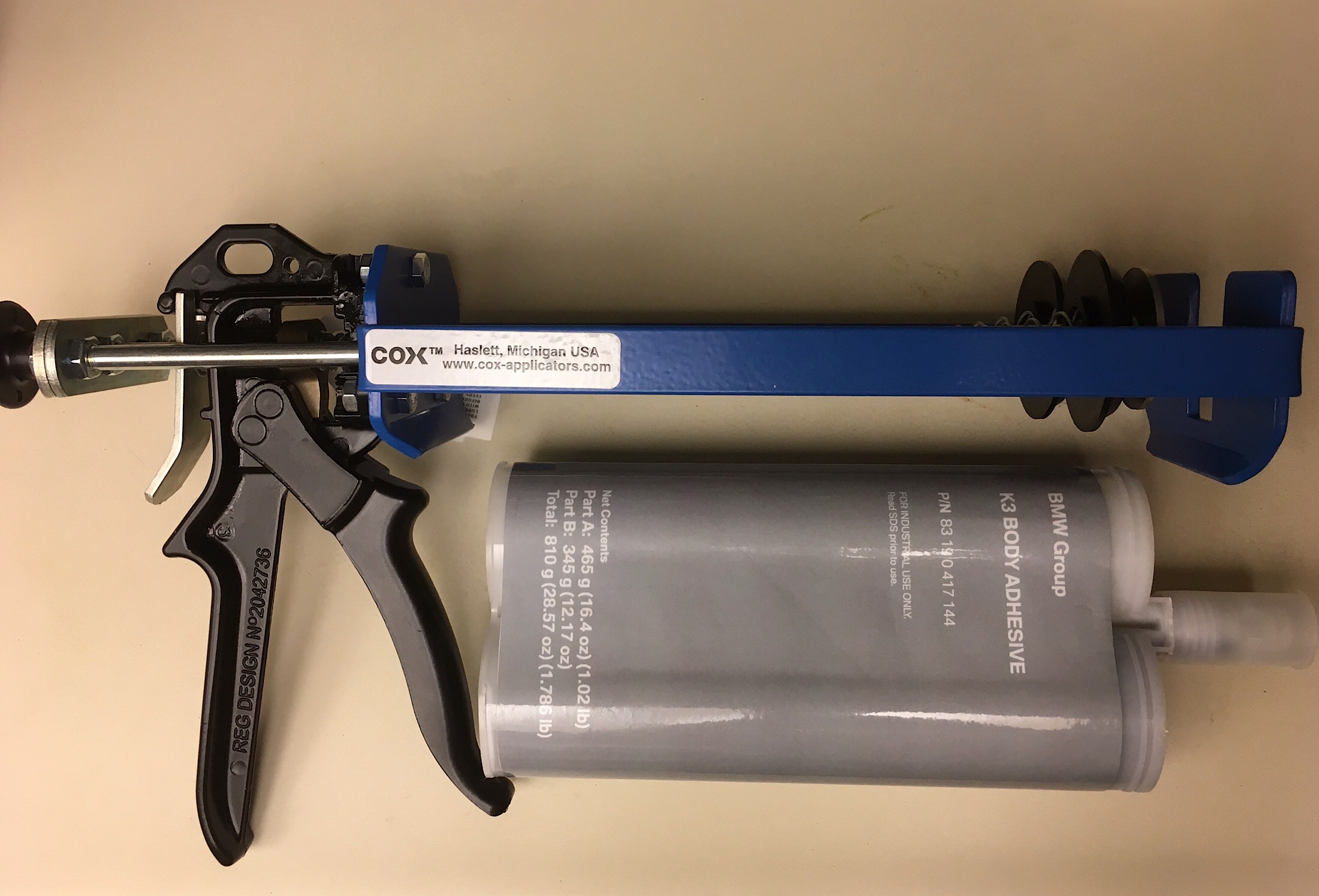

Roof bond tomorrow

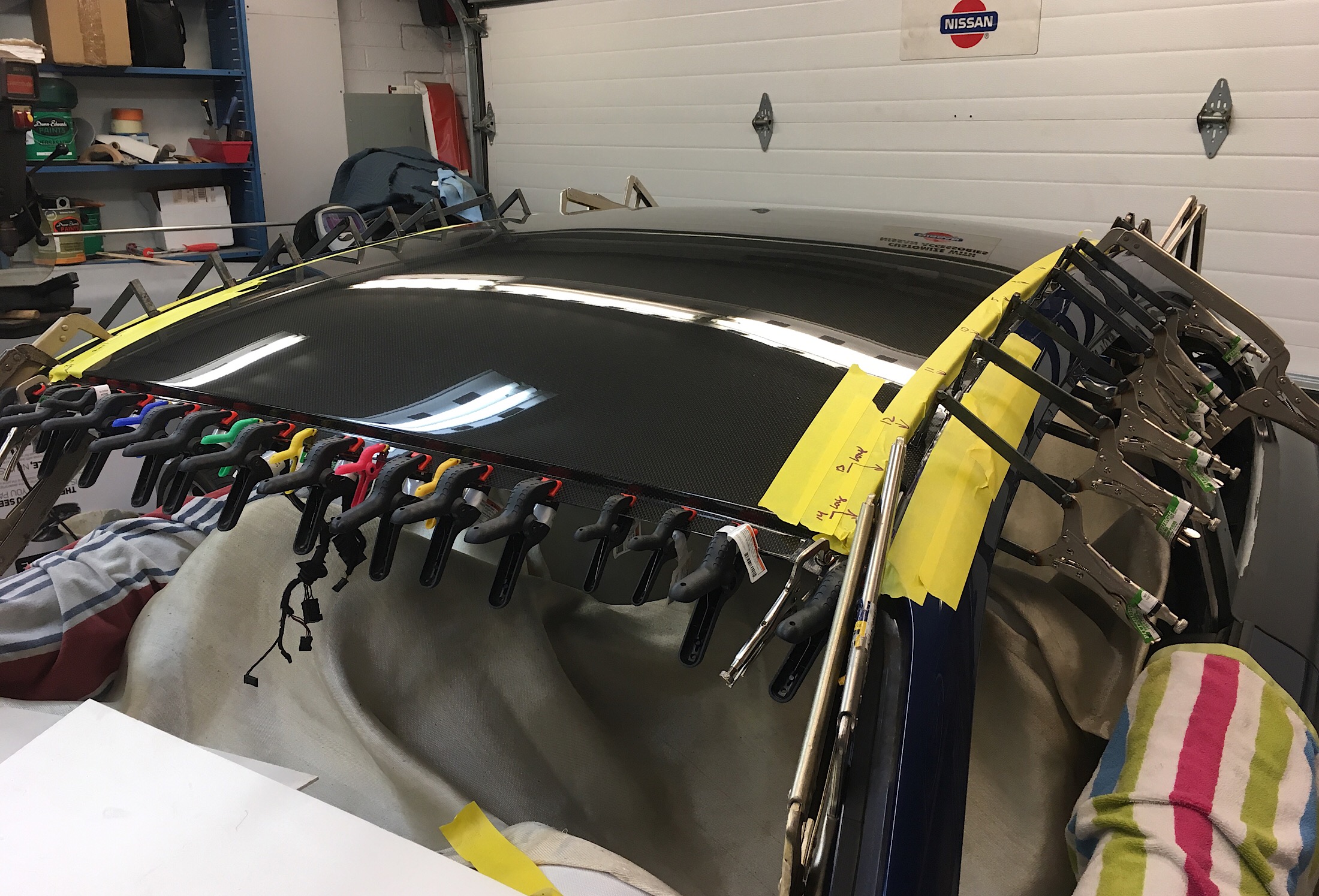

It’s time. I’ve conned a couple friends into assisting with the bonding tomorrow morning. Gotta do it really early while it’s cool in the garage. This special adhesive from BMW sets up in 10 minutes. Even faster when it’s warmer. So, we will be working like an F1 pit crew
Ended up making 16 of my own clamps. I didn’t like the way any of the “off the shelf” clamps were hanging off of the sides.

      06-24-2019, 08:32 AM   #116
BillDaCat8
BillDaCat8's Avatar
287
199
Join Date: Dec 2015
Like a lead balloon
Well, we tried. Turns out that the batch of adhesive from BMW that I bought was bad. It locked up in the gun after laying about an 18” long bead. I’ll have to re-order more and try again.

      07-03-2019, 12:16 AM   #117
BillDaCat8
BillDaCat8's Avatar
287
199
Join Date: Dec 2015
Second batch of adhesive arrived today. Can’t do much with it for another week though. My pit crew is out of town this weekend.

      07-25-2019, 09:22 AM   #118
katsooba
katsooba's Avatar
90
359
Drives: bmw 135i
Location: Israel
do the press-your-finger-to-the-roof test for me
heh
great work as always
the bmw adhesive has a shelf life of about 6 months IIRC, should check on the dates

      09-01-2019, 01:23 PM   #119
BillDaCat8
BillDaCat8's Avatar
287
199
Join Date: Dec 2015
lucky find

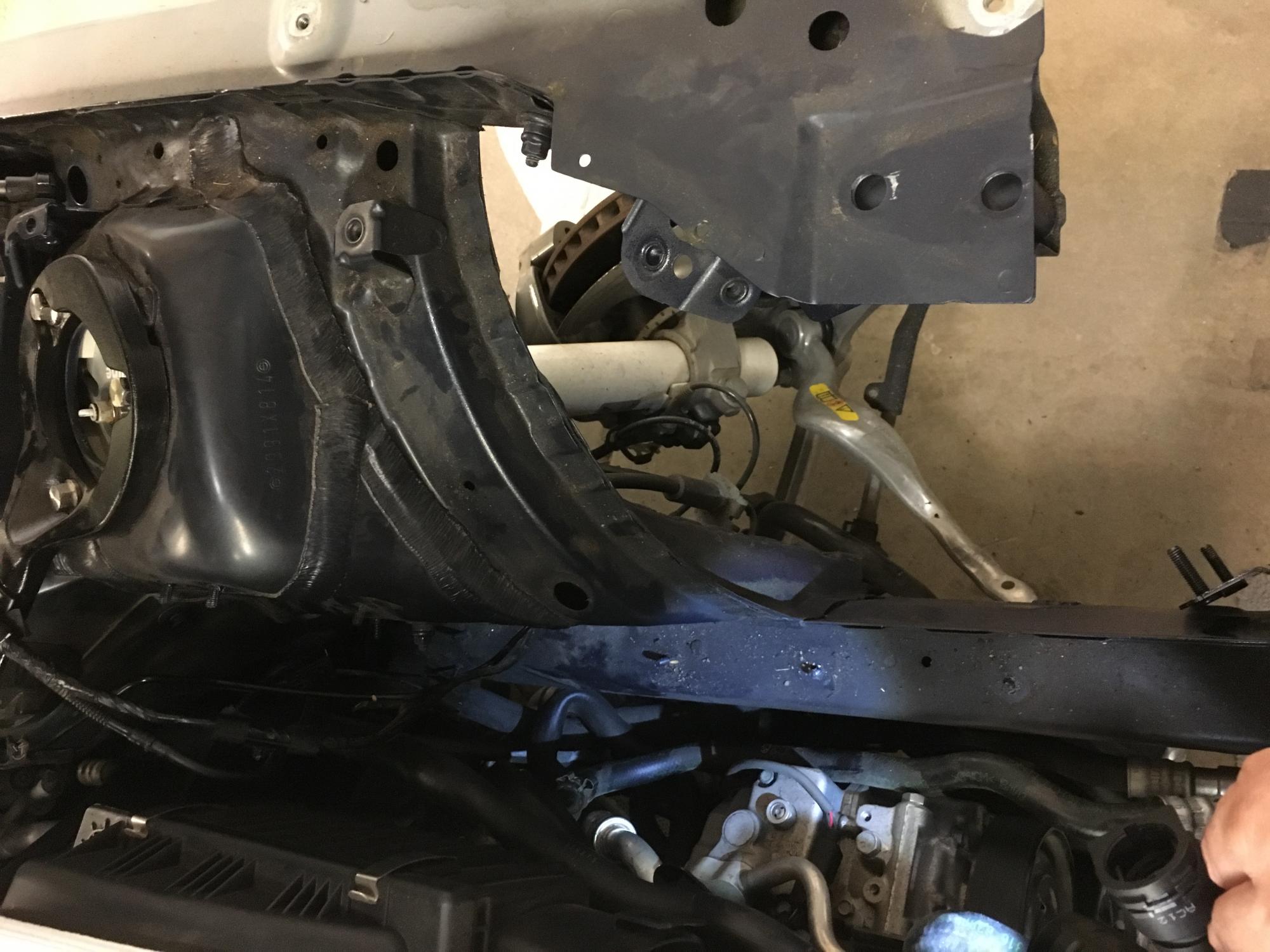

Well, I've given up on bonding the roof until we have cooler weather here. There's just not enough working time with the adhesive when the temperature is this high.

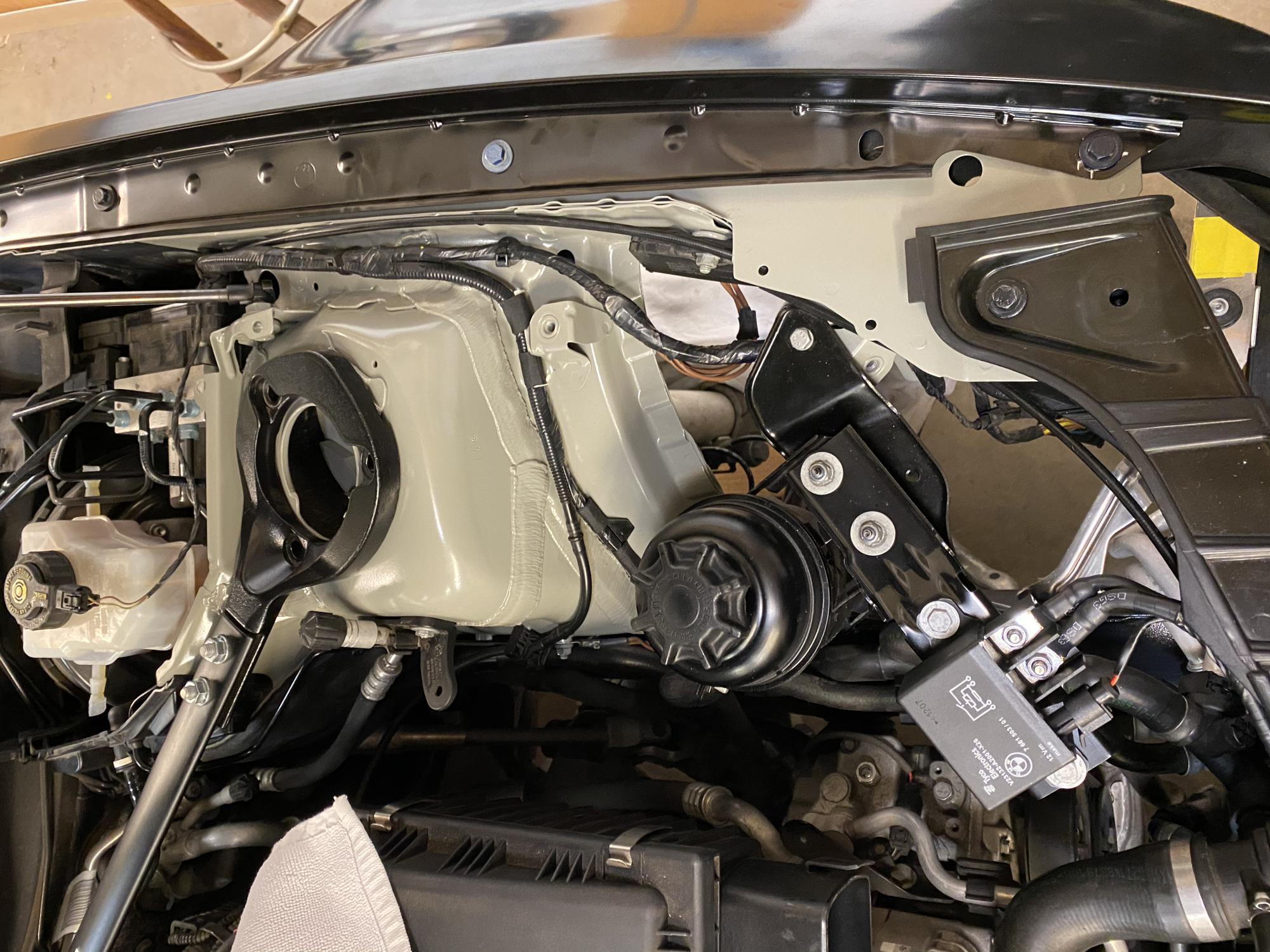

I've decided to move on to the front of the car. Most of it is all easy bolt on stuff. Although, I do plan a few tire room maximizing modifications.

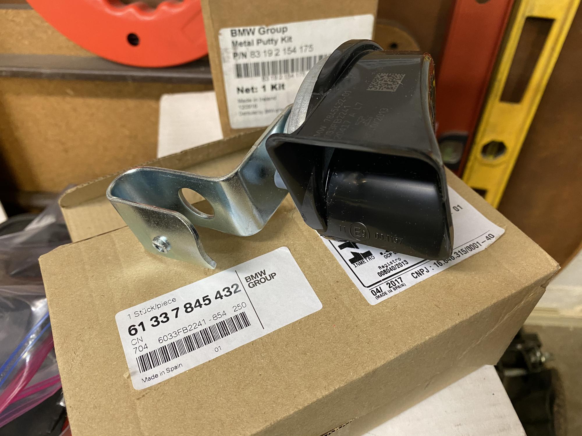

One of the things that needs doing is to relocate the horns to make room for the aux radiator. Being as picky as I am; I didn't really want to just fab up some brackets to mount them. So, Working with my local BMW dealer, I was able to find some (from what I know of) "non-existent" part numbers. The "BF" horn brackets being the most elusive of them.
BE: 61129162854
BF: 51742179530
BG: 64219415899
BH: 07129905471
BI: 67618370818

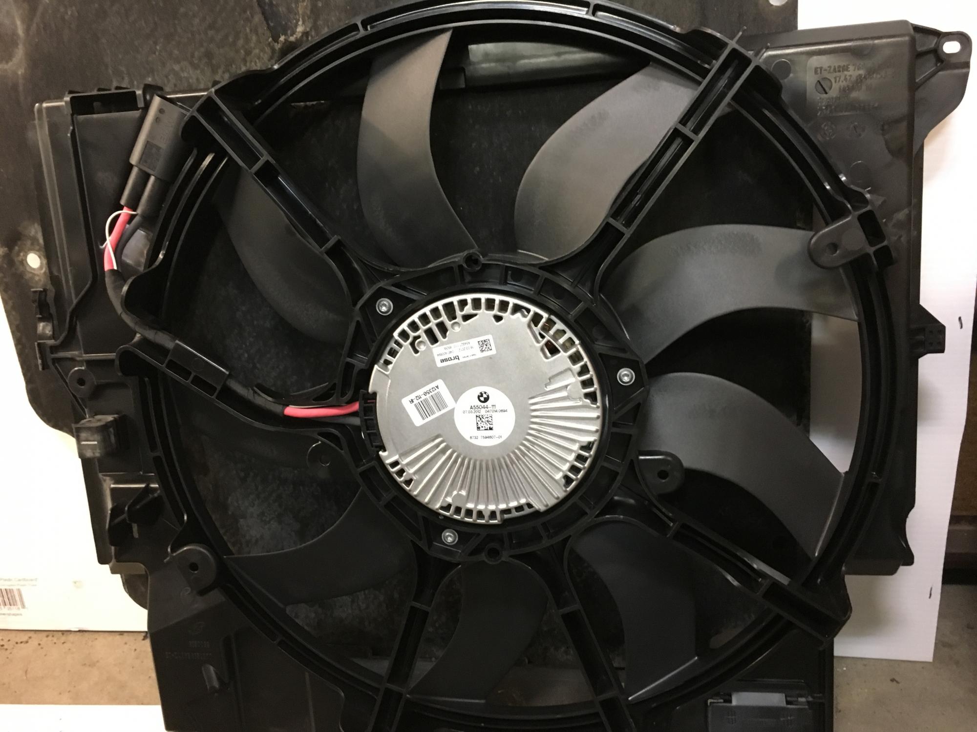

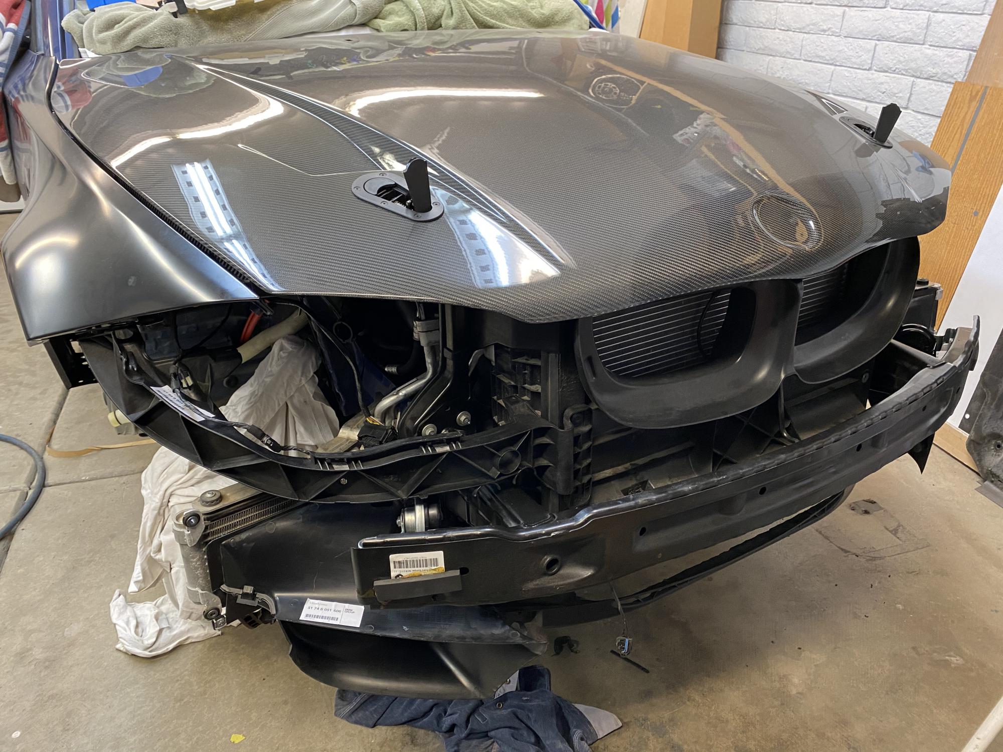

The front begins
Blew up the front of the car yesterday. Waiting on PPK parts to arrive now.
I’ve been on the fence about doing the entire ppk2 kit, or, just buying the auxiliary radiator and accoutrements separately. I’ve finally just decided to do the whole kit and add the uprated fan, etc.
Not sure if I’ll go with the included ecu flash or not. Currently the car has the euro spec ppk flash. I’m told that it won’t smog here tho. I can’t get ahold of the guy that did the remote coding and flash for me. So, I may have to re-flash to the US spec. Need to do more research on that.

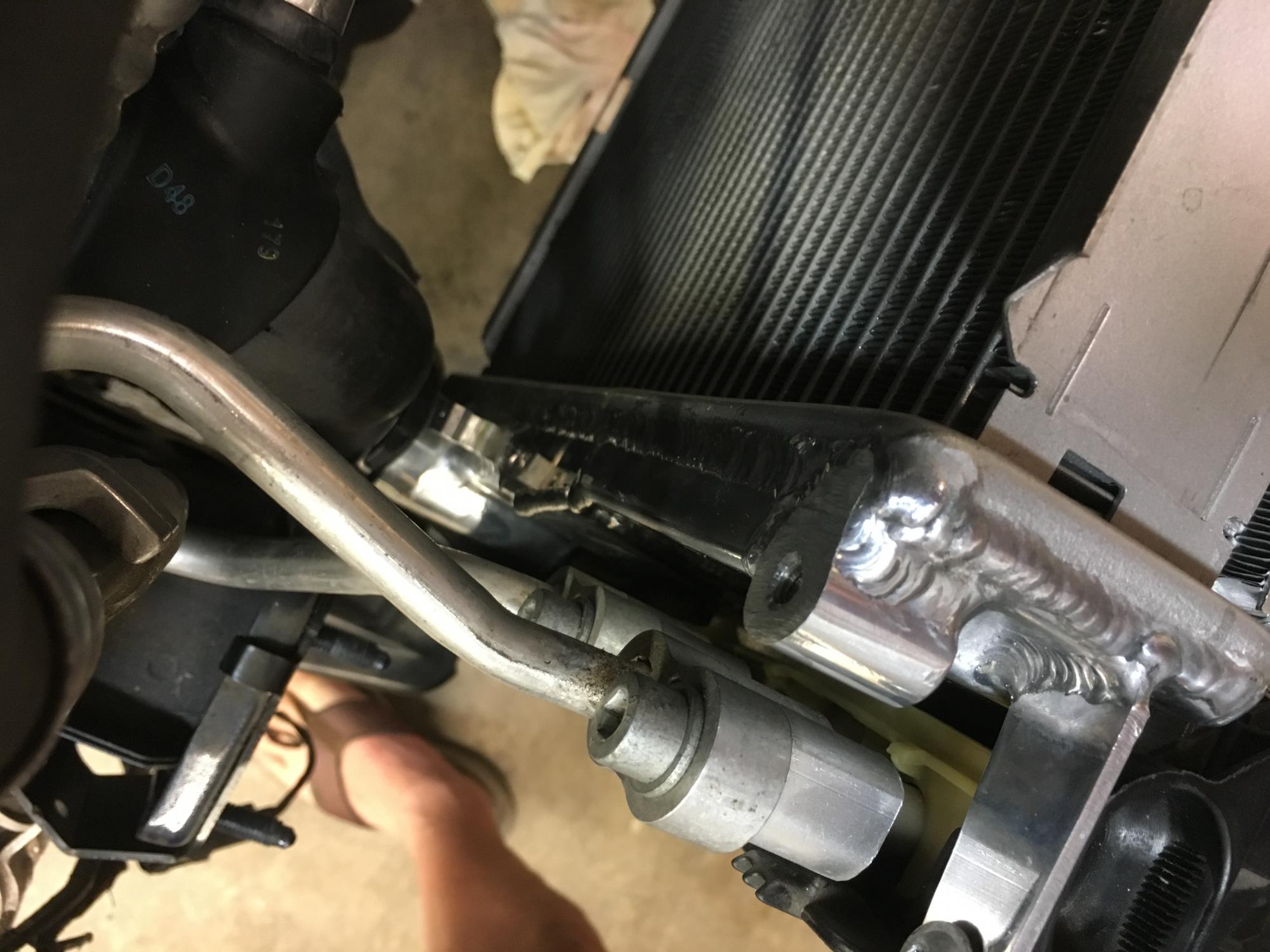

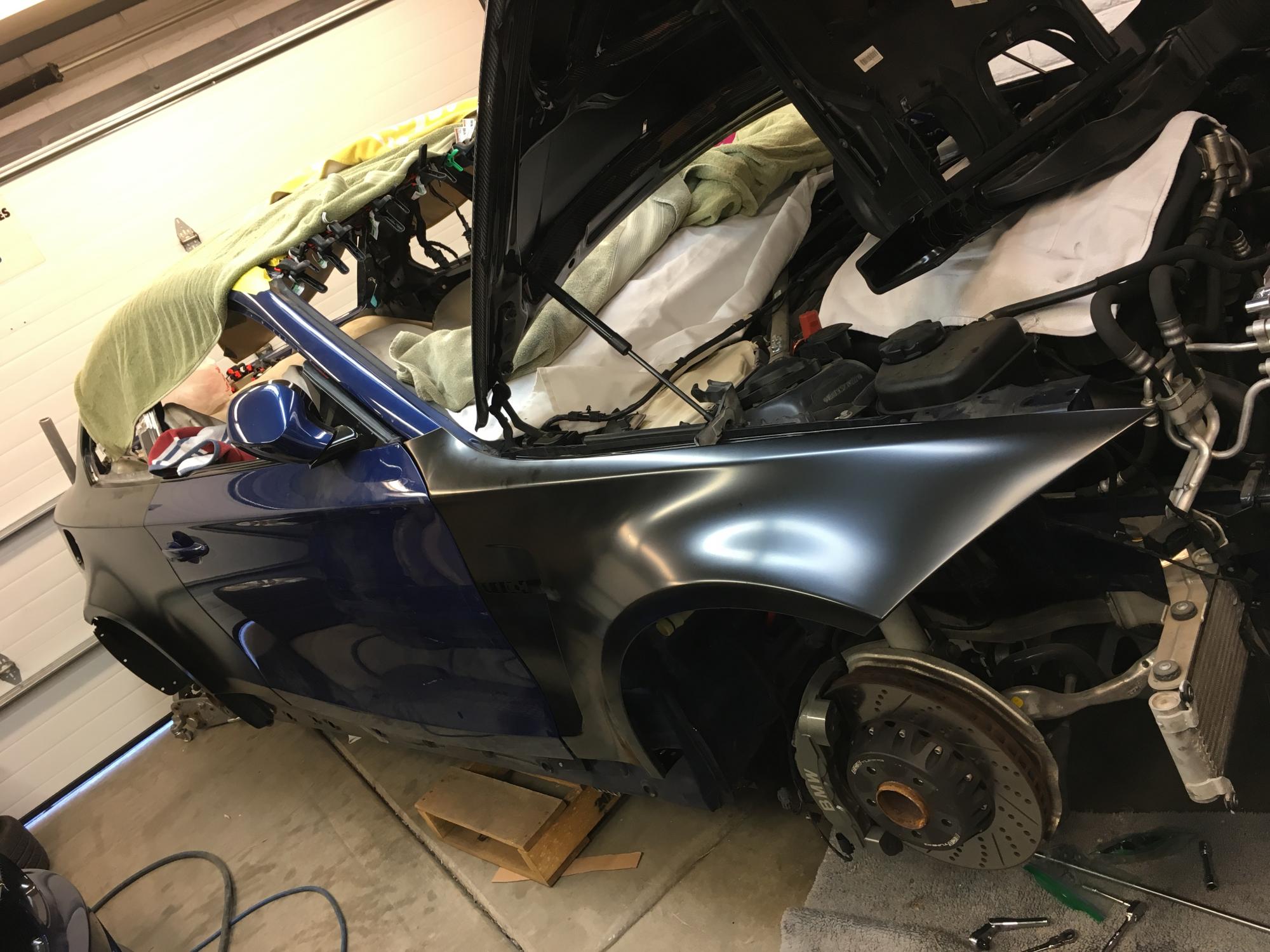

Haven’t posted much. But, I have been working.
Taking advantage of the increased space I have to work with while the core support is off; I finally got my GFB DV+ diverter valve installed. It’s been languishing in the glove box for some time now. I just dropped the three water pump torx bolts and was able to access the valve with a long 5mm T-handle from the front.

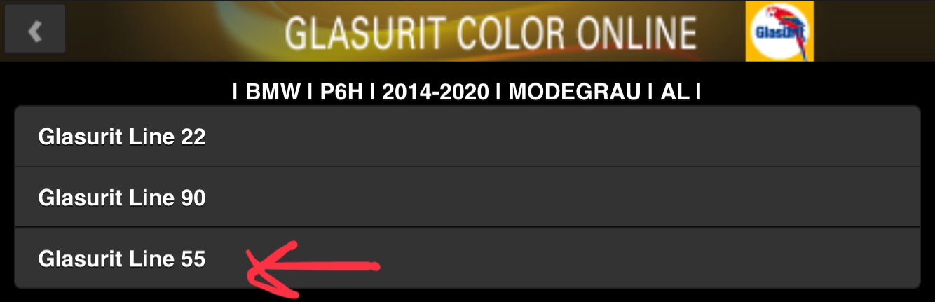

Paint was also ordered up yesterday. BASF Glasurit Line 55 for the color. P6H. It’s for real now.
A few other random pics...
I’ve got some work to do in the shock towers as well. Gotta make more room for more camber. A keen eye will notice a mistake I made when adjusting the suspension. I managed to break off the adjuster nub on the top of the strut! That will he headed back to TC Kline for repair soon.

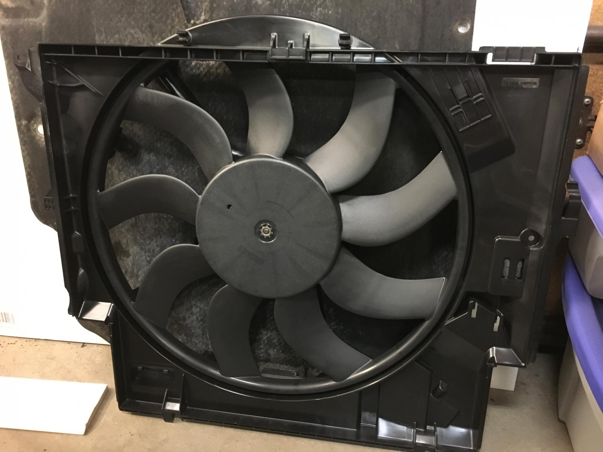

CSF radiator needed a minor bit of cleanup to work with the 850w ppk fan. I’m very impressed with the amount of electrical bolstering BMW adds to support this fan. The wiring and relay are beefy.

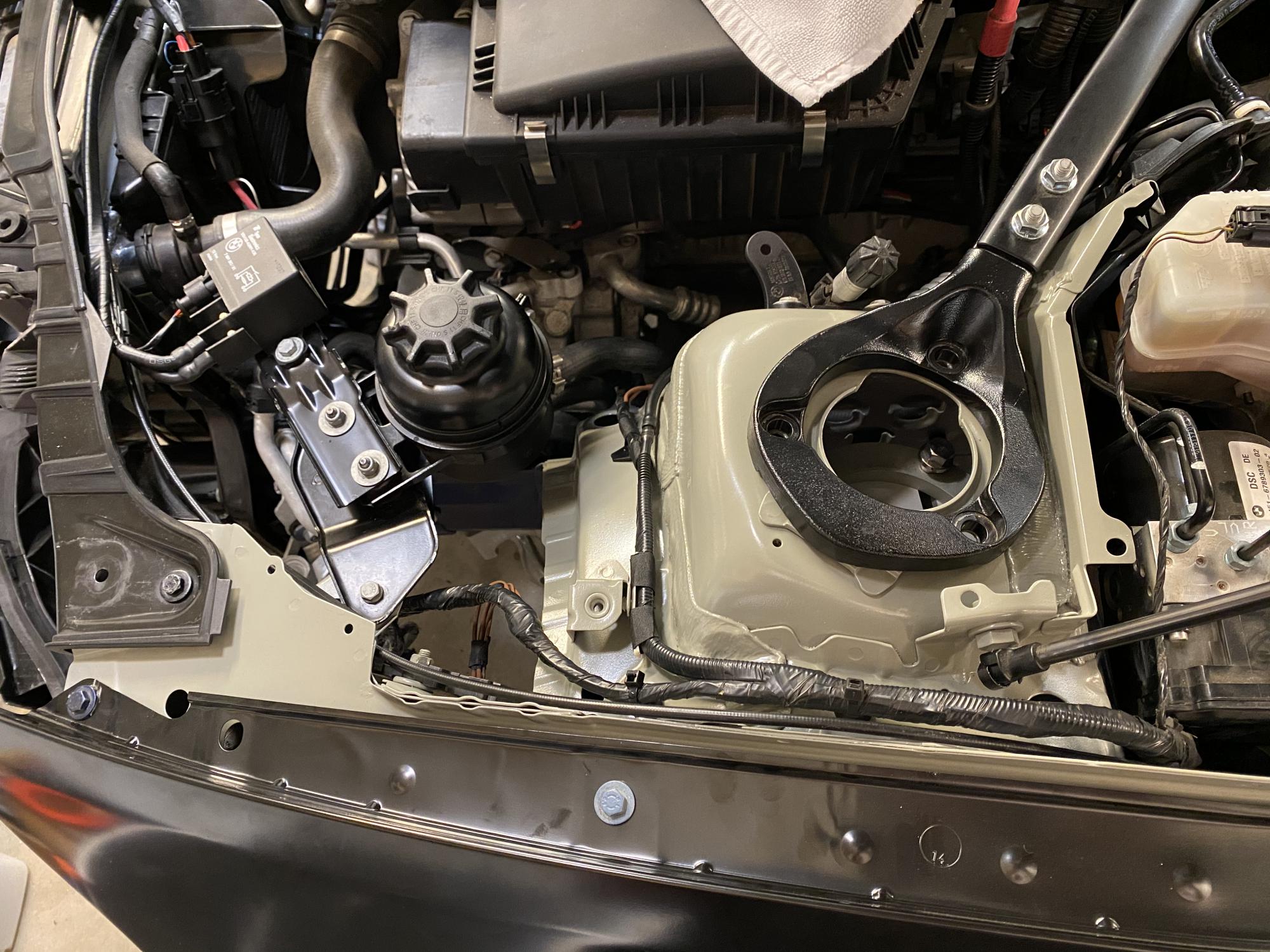

My plan is to paint as much under the hood as possible. Since this is a complete color change, the aprons will still be visible with the hood up. They need to be painted now don’t they?
Center bolt for the strut support bar is a size that I don’t have apparently. I’m guessing that I borrowed the correct socket when I installed it originally. I’ll churn one up tomorrow and get those out of the way. Then I’ll begin paint prep in these areas.
BE: 61129162854
BF: 51742179530
BG: 64219415899
BH: 07129905471
BI: 67618370818
How many of each do you need to relocate the horns?

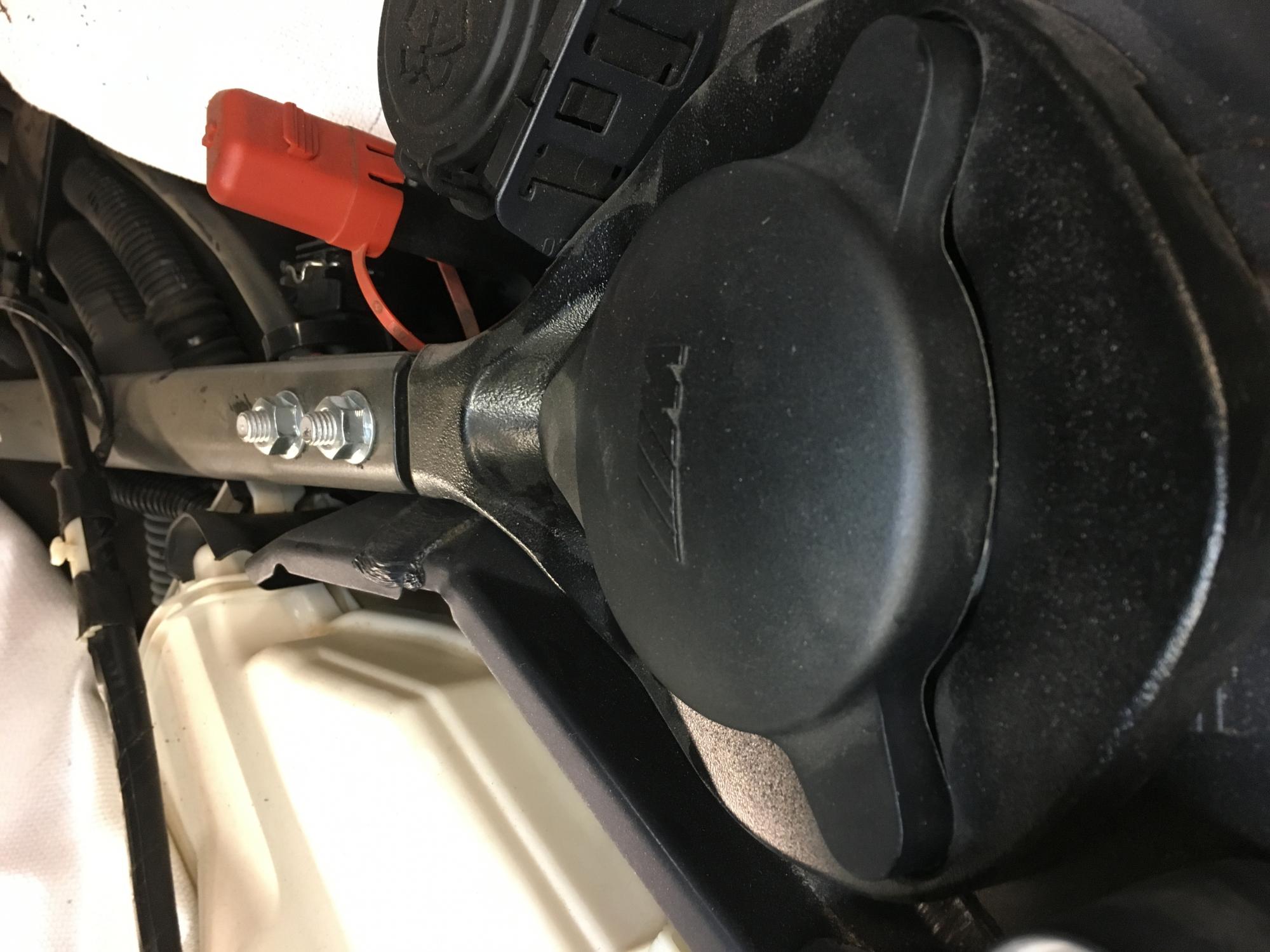

Two of each with the exception of the harness. Just one of that number is needed.
These parts are to re-locate the horns to the top center of the re-bar as per the PPK instructions.
NOTE: Since posting that info, I’ve learned the the 1M has the horns mounted behind each end of the re-bar. Those brackets come with the horns themselves.
Really appreciate the pics. Yeah I recently discovered I can mount the horns bare to the front bar so less $$, parts, weight even if it's ounces.
Now to figure out whether to do the PPK radiator or just Fab a bracket or use a bolt for the driver ductwork.

I’d posted before about painting the aprons. Here they are freshly shot with color. No clear yet. Notches for more camber can be seen here.

Putting things back where they go and adding the PPK harness and relay for the upgraded fan.
