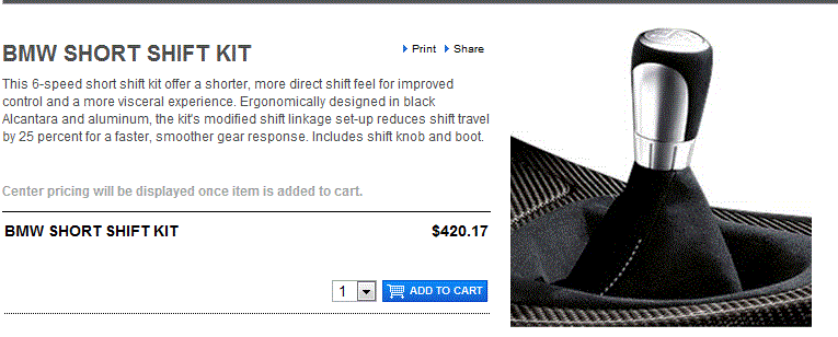

I luv mine !!!

Originally Posted by PA135i View Post
I luv mine !!!
When did you order that? Am looking into that for my 135i, bmw can't find the part. Is it discontinued?

As far as I was able to ascertain, N54 135i SSK has been discontinued for a couple years; N55 135i SSK was never made.
There are several viable alternatives, from Dinan to UUC to different BMW SSK levers, but each may require some work. Is yours N54 or N55?
Posts 16, 44, and 97 on this thread provide some part numbers.
There's another SSK thread on here I didn't see you post in which gives additional detail:
http://www.1addicts.com/forums/showt...=414760&page=3
Good luck!
It really feels awesome once you find the right short-shifter for you.
