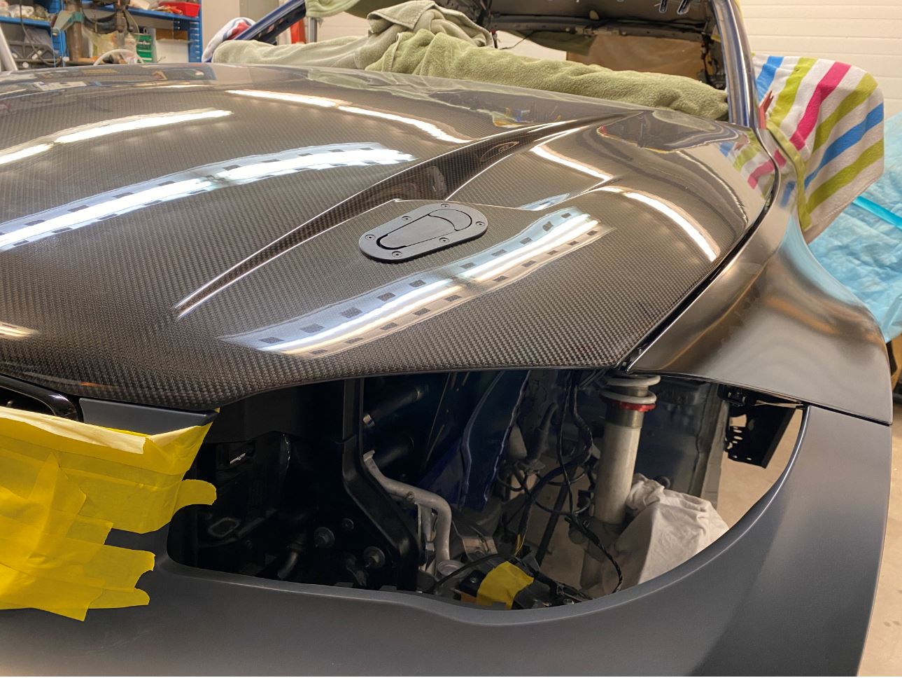

      03-20-2020, 08:38 PM   #138
BillDaCat8
BillDaCat8's Avatar
287
199
Drives: Toyota Tacoma
Join Date: Dec 2015
Location: Glendale AZ
Ryan calls it “J-spec”
Fussing over gaps and such.
Revozsport did me no favors with this hood. It's easily 3-4mm narrower than the OE hood and the fit up front over the grilles was, frankly, awful. Not to mention a large flaw in the finish in a very conspicuous spot. (good thing I'm painting it) For a product that costs what this does, I am NOT impressed.
Anyway, I've managed to make lemonade I think. Have a look. There's a LOT of shaping going on here to make that gap over the grills and the three upper bumper tips as clean as possible.

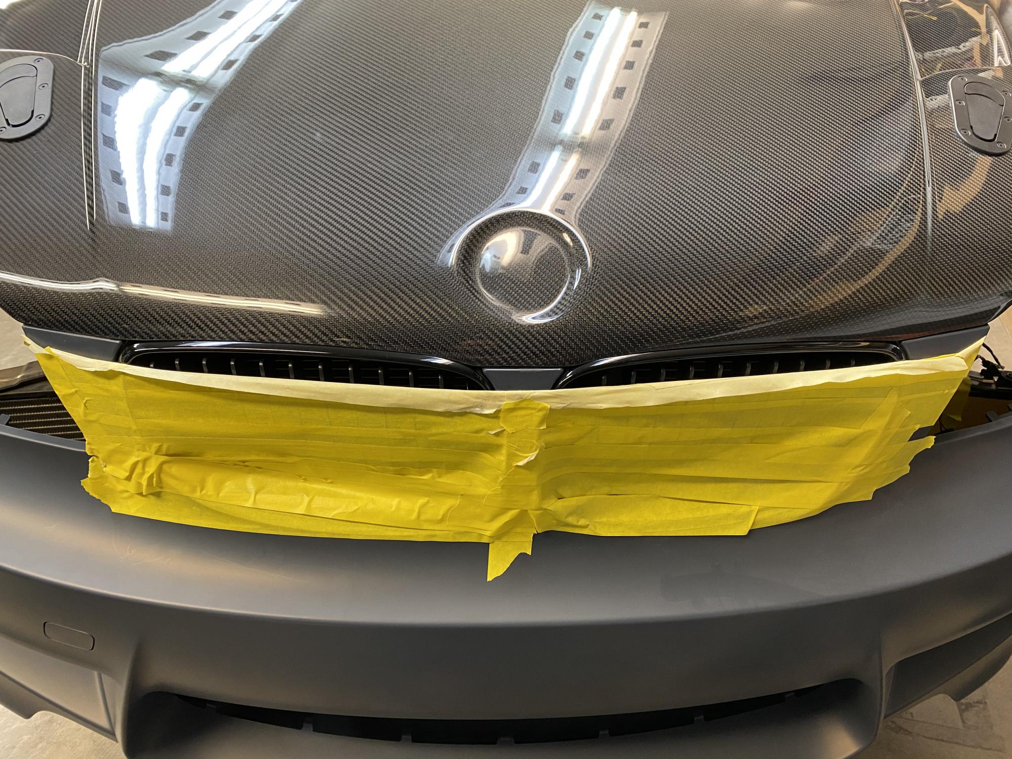

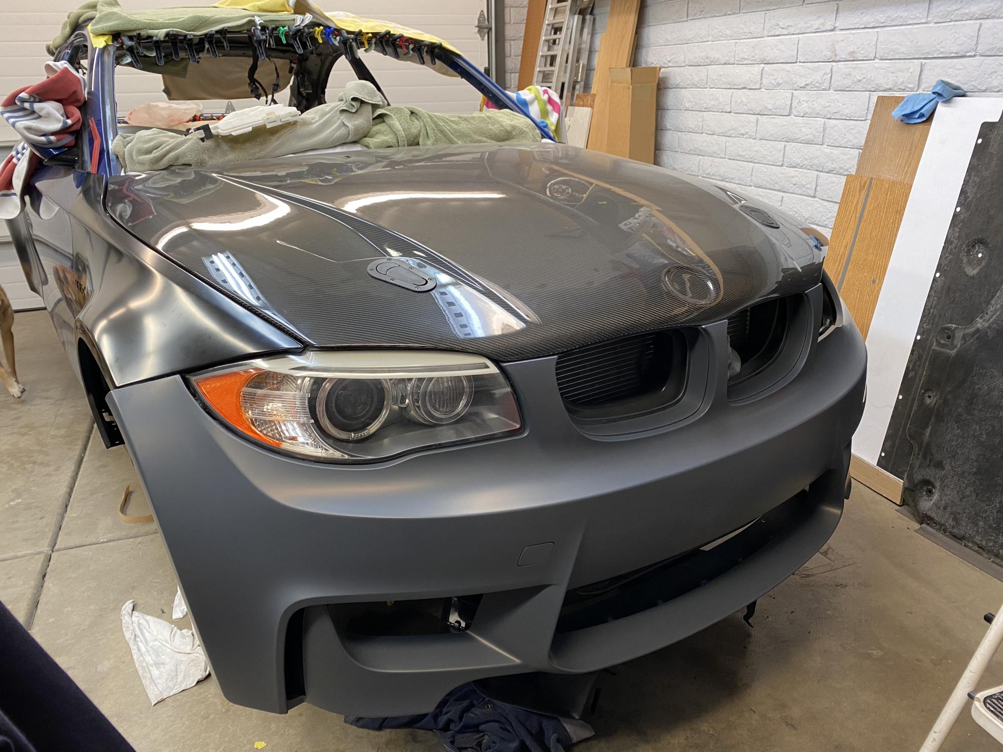

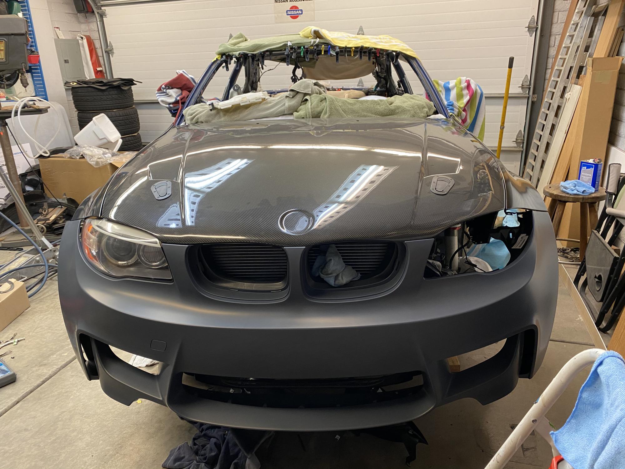

Ok. I’m settling.
Not perfect. But, I’m fairly happy with these gaps. Since these pics were taken; I’ve yanked the hood and ripped the fenders off to paint their inner areas as well as painting the hood hinges and the areas adjacent next.
Yeah. I’m slow and picky. Sorry everyone.

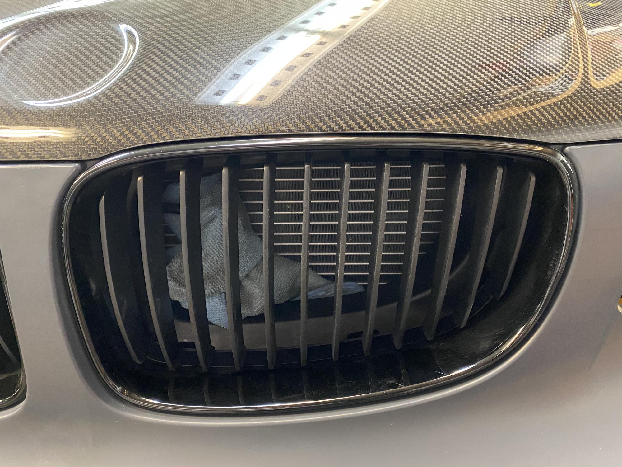

Originally Posted by ///Makis View Post
Hi Bill, fantastic build btw.
I'm just wondering, how did you fix the gaps? The pics before look wider than the straits of Gibraltar and then the last ones look like they were made for your car.
Gaps to the fender are adjusted by moving the fenders and hood around obviously. Had to cheat little bit on those to get them in closer since this hood is a bit narrower than the OE hood. Tiny notches in the fender mounting holes did the trick there.
Clearance to the grilles was made by adjusting (sanding) the hood itself. Adjust bumpers to a lower position and then sneak a piece of emory cloth between them. Very slow going and blister inducing.

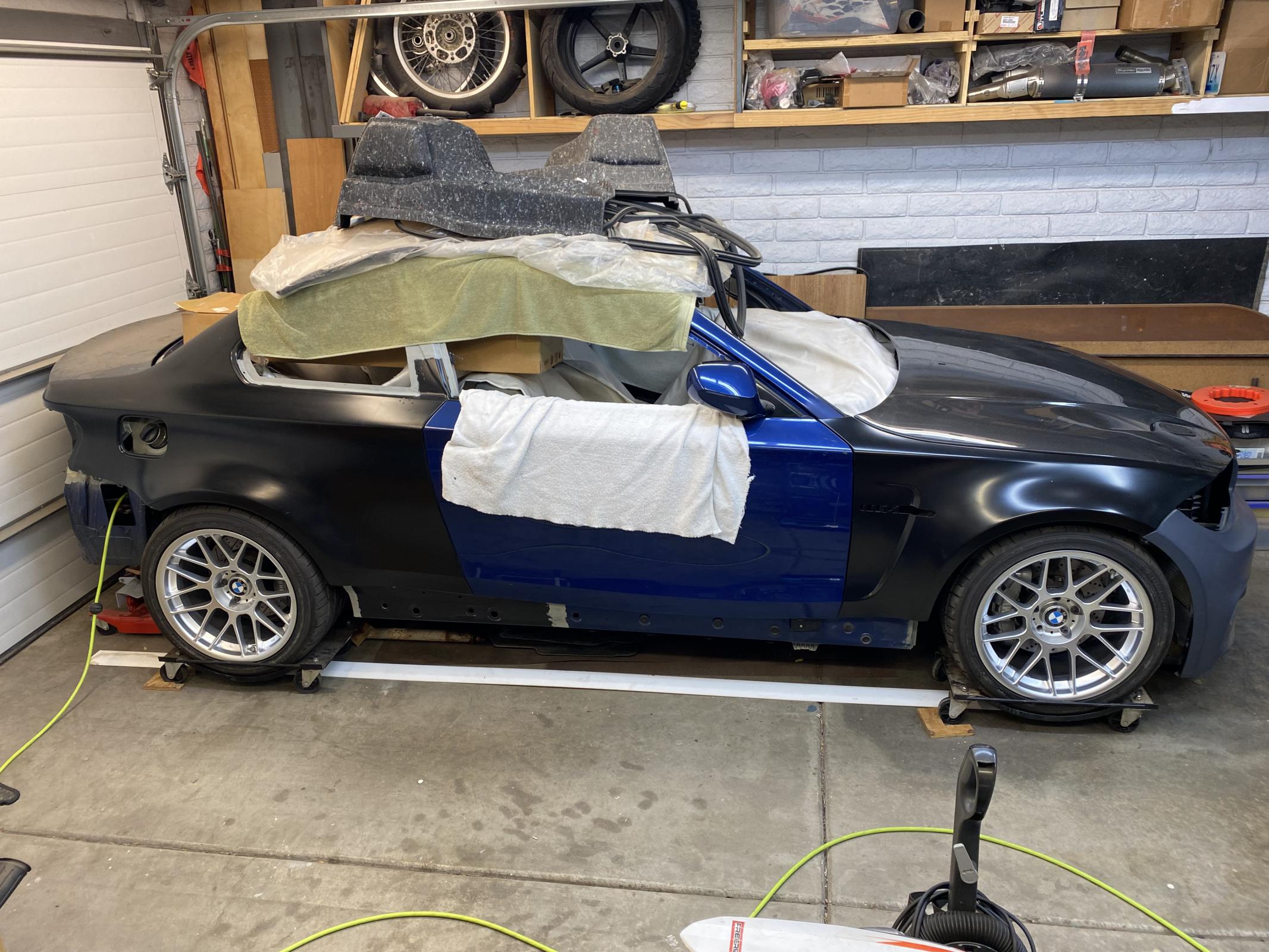

Still alive
This project has stalled obviously. I’ll be getting back to work on it soon now that I’ve found work again.
I did recently bolt the “new” wheels to it and set it on some skates so that I could move it around a little easier. Grabbed a few pics when I did that.
