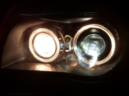

Just finished installing the retrofit (I have AHL headlights), everything OEM, and according to the manual instructions. Although I have some issues.
1. The corner lights go on when i switch on the high beams
2. the high beams only work when i flash
3. The foglights are always on.
4. The interior lights dont't turn on.
5. The headlamp washers don't work.
I haven't coded yet. Maybe that's the problem, what do you guys think about it?
