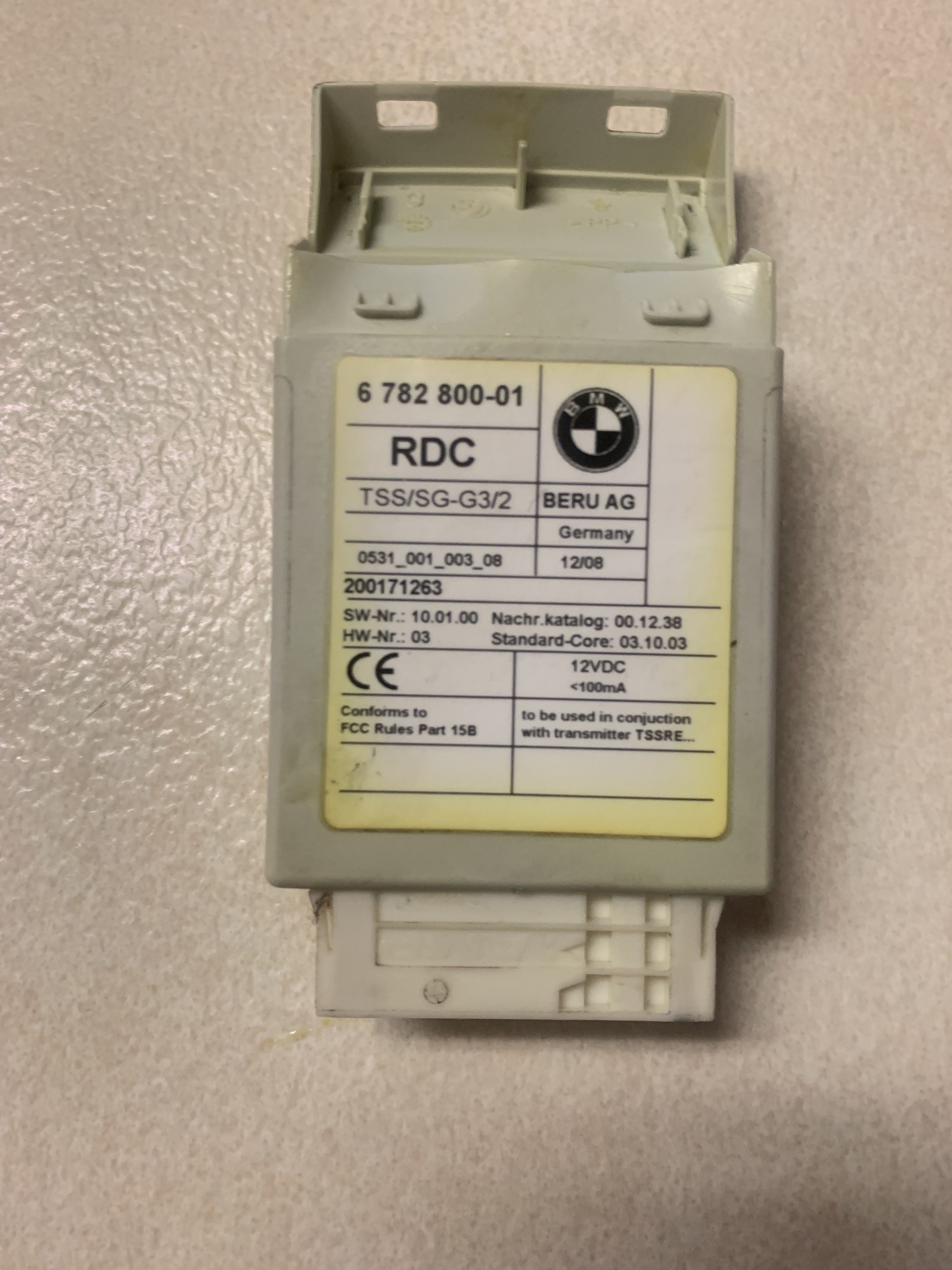

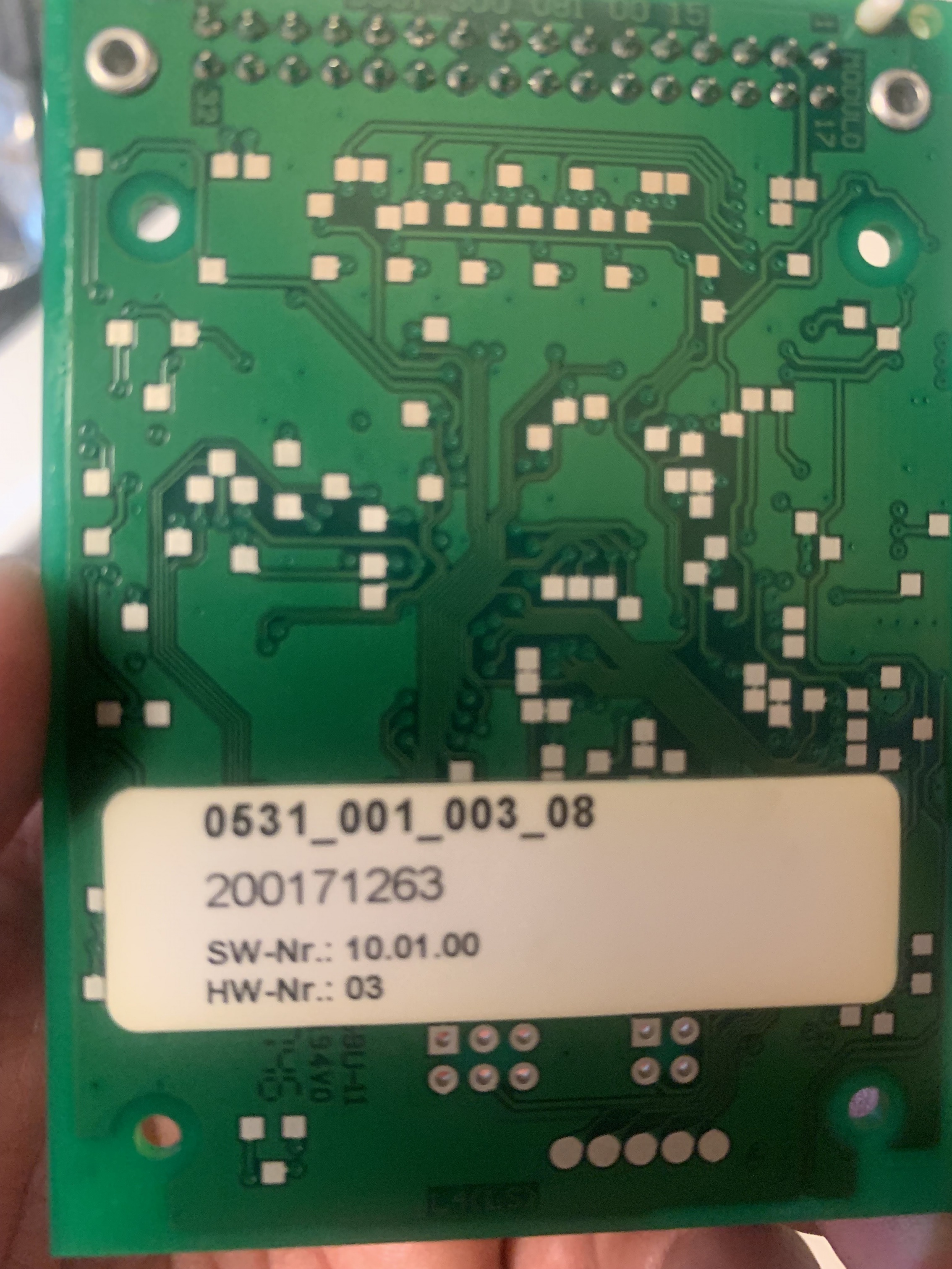

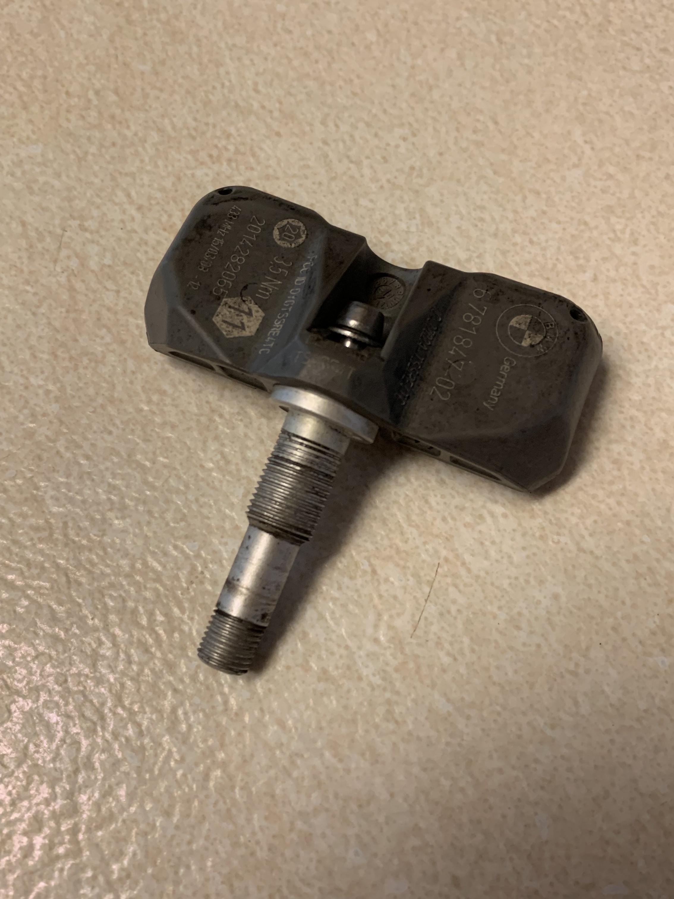

After chasing “TPMS INACTIVE” error for a werk or so was able to find the culprit thanks to CARLY reader. “Well sort off “
Just like the most obvious first step was to check and inflate tires all good there. Cleared cod but it would come back on righ away. So did some research and before going any further into expensive parts, check my RDC module for mosture as its very well known for water intrusion in our trunk. Module was just bit díscolor but nothing like the water intrusion I found on my go pasive module which I had to replace.
Anyways checked, dried with a hair dryer just in case. Plugged back in no change. Error was still present. Even though Cary app was pointing me to the “Whel electronics rear left but really was not clear what was it exactly.
Went to a Discount Tire near my work checked on all the sensors witj thier wireless devide. ALL SENSORS CHECKED GOOD. The technician which I immediately sensed he wasn’t fully knowledgeable on this RDC system but still gave it the benefit of the doubt. 🤔
Did a little more research amd going to the realoem site. Idid see the wording about a “Wheel Electronics” referring to a sensor in the diagram and thats when it clicked in my mind. Its gotta be a sensor.
I also found a post saying that even if the sesnsors read good at the tire shop that may no be the case. Went back to Discount Tire next day I asked how muc for a new sensor installed and was $82. Bit the bullet and tada it was the bad sensor RL causing the error message.
The technician was able to reset TPMS in my iDruve and just a few blocks down the road the message was gone. I hope this helps someone out there.
Cheers 🍻
