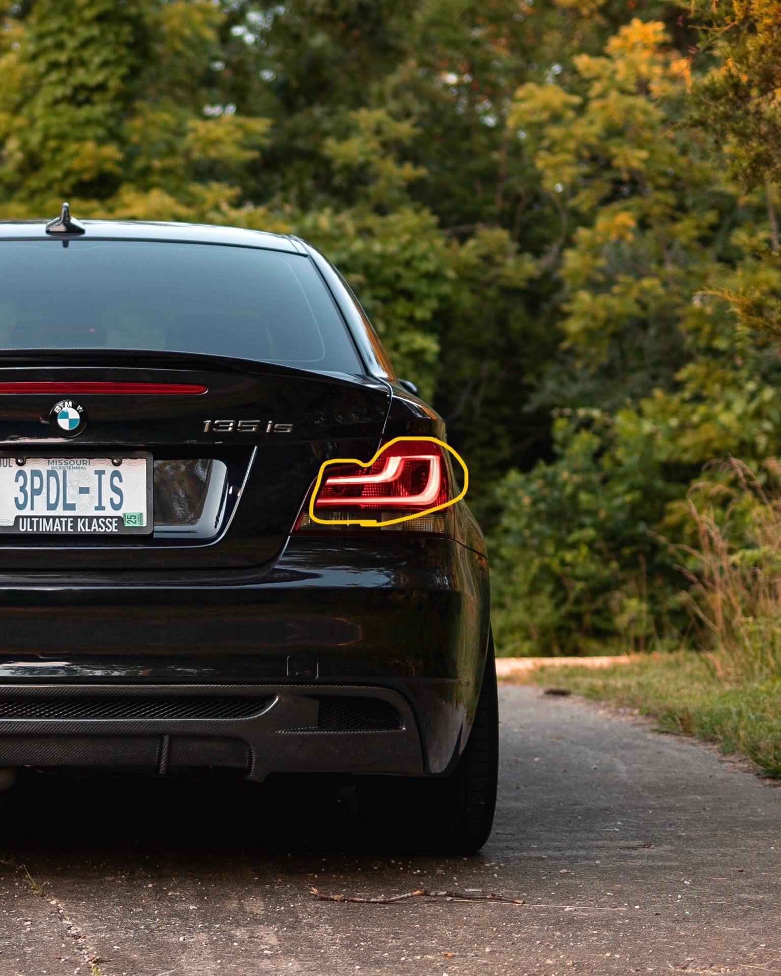

Anyone know if it’s possible to make the light bars be on with DRL’s? I tried with the Carly app, all it did was turn on my brake light bulbs. Could also be doing it wrong

Yes. You need to code this to active (I don't use any app, but NCS Expert together with NCS Dummy as I have been using that for the last 15 years)
Module: FRM(3)
Parameter: DRL_TFL_MIT_SL_2
SL_1 are your angels/brows
SL_2 are the rear led bars
And I totally understand why you would want these the light up as well. They look awesome and they are led, so don't consume bulbs. All the new models have the rear leds/strips on and this makes the car feel just a little bit more modern. And did I say they look great?
It's nice having them on without the license plate lights.
EDIT: according to some googling, in Carly it should be "Daytime running lights – tail lights" • on/active.

Thanks! That’s the selection I made in the Carly app, it just does the bulbs which is weird
