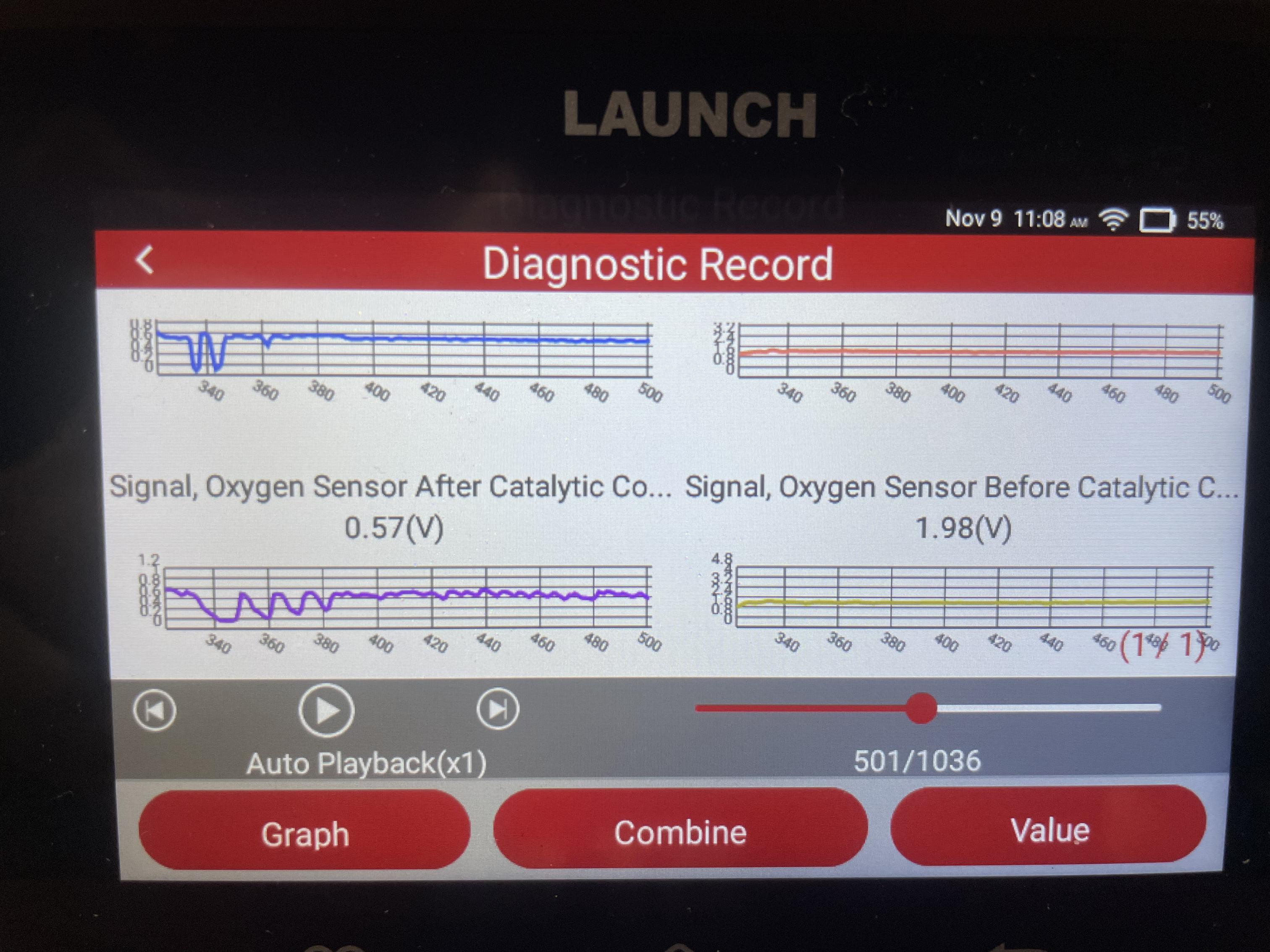

but you have to think that if one of the bank 2 o2 sensors is giving a value out of expected range (usually the post cat), then the car might think that is indicating the cat is not performing as it should when it is actually the o2 sensor giving a faulty value.
or the o2 sensor is doing it's job and the cat is indeed clogged/bad. hard to say... i would personally rather deal with a bad o2 sensor than a bad cat

Ok I apologize I couldn’t figure out how to export the graphs.

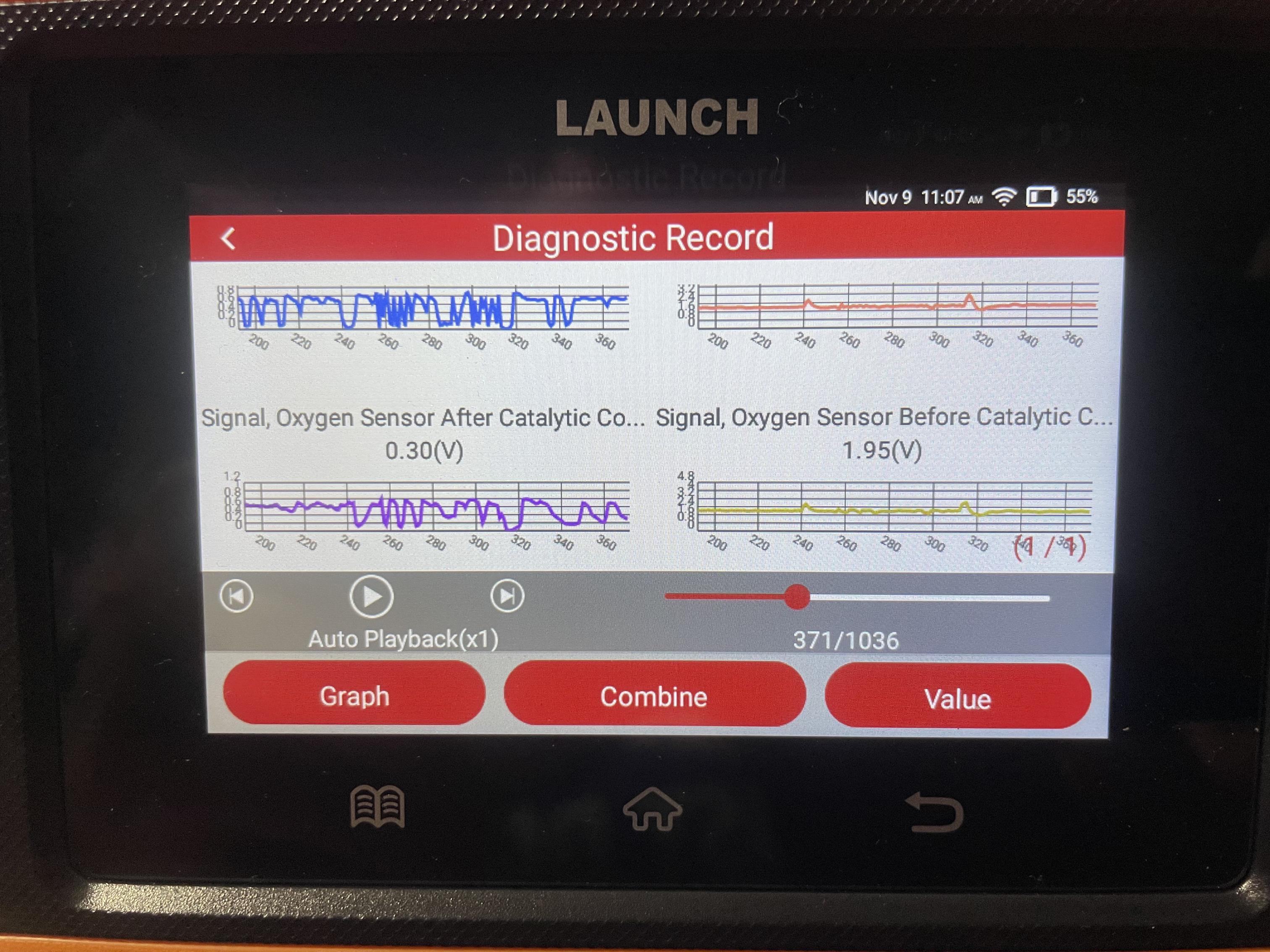

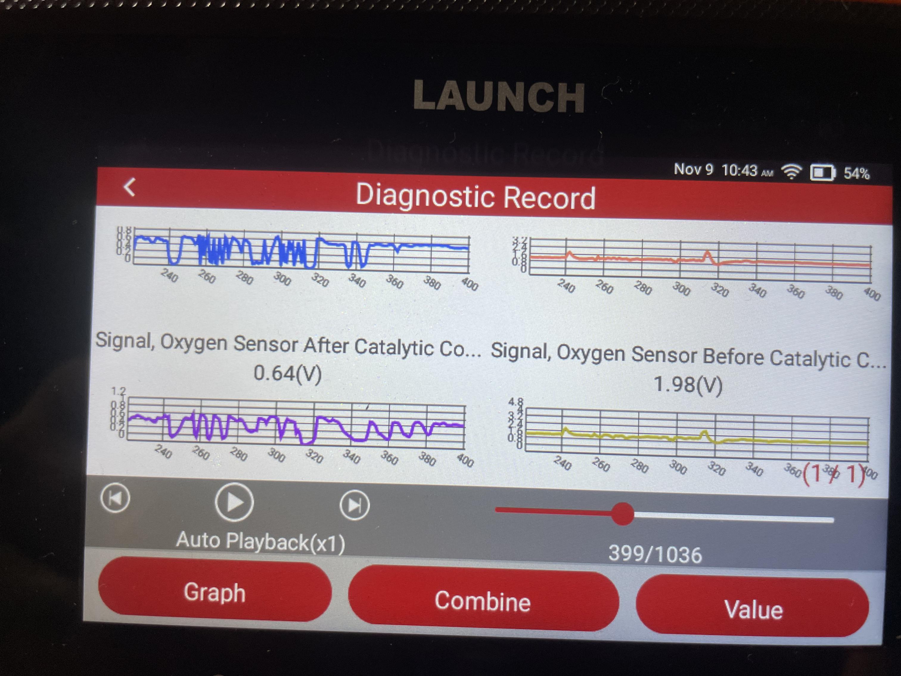

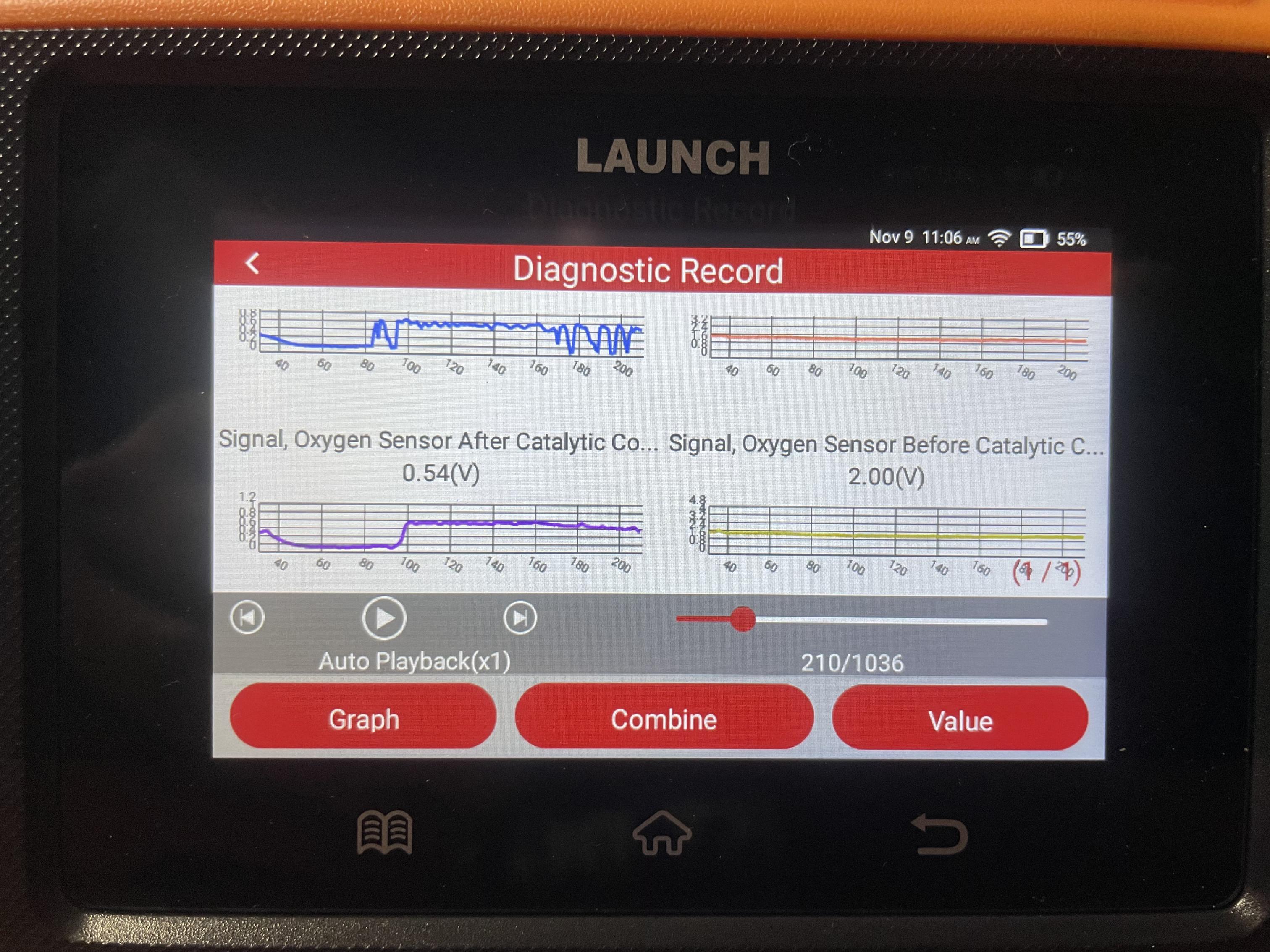

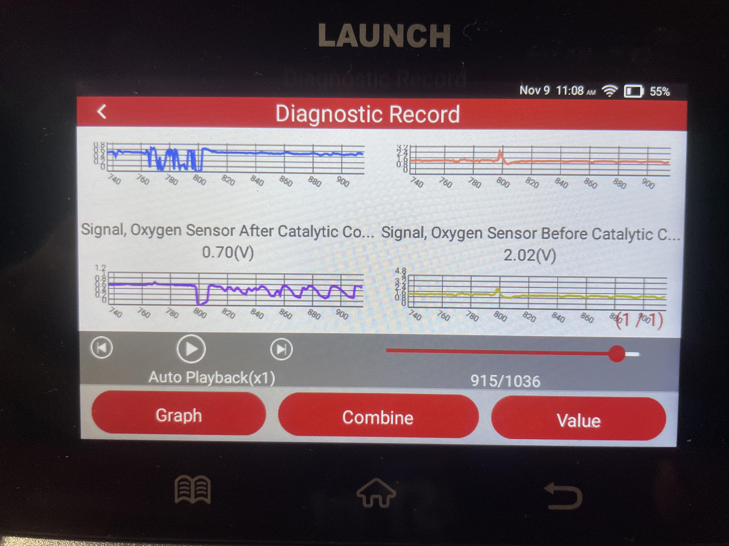

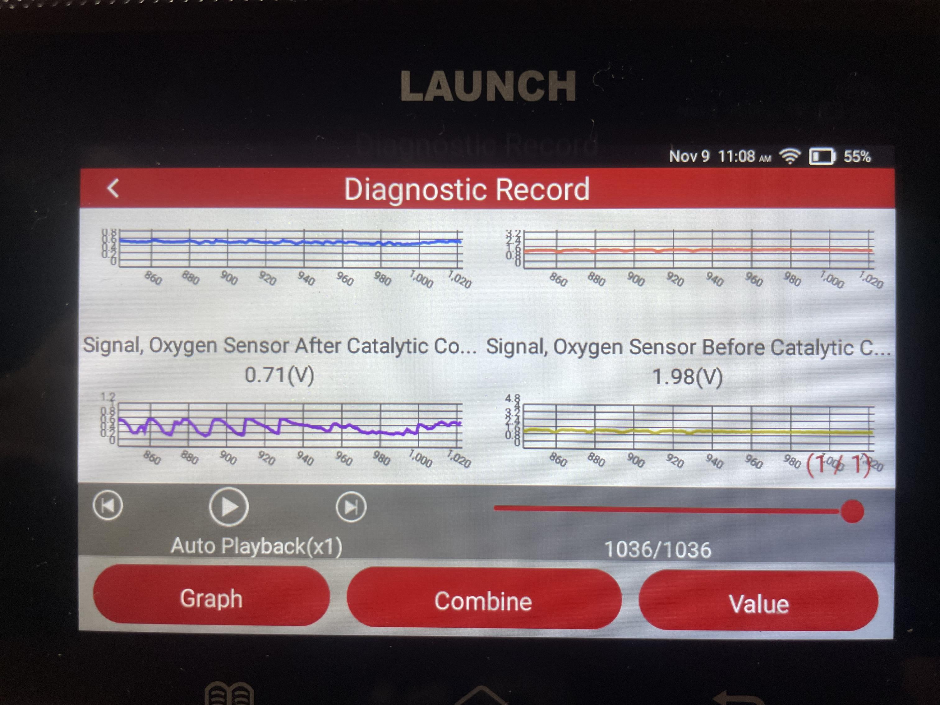

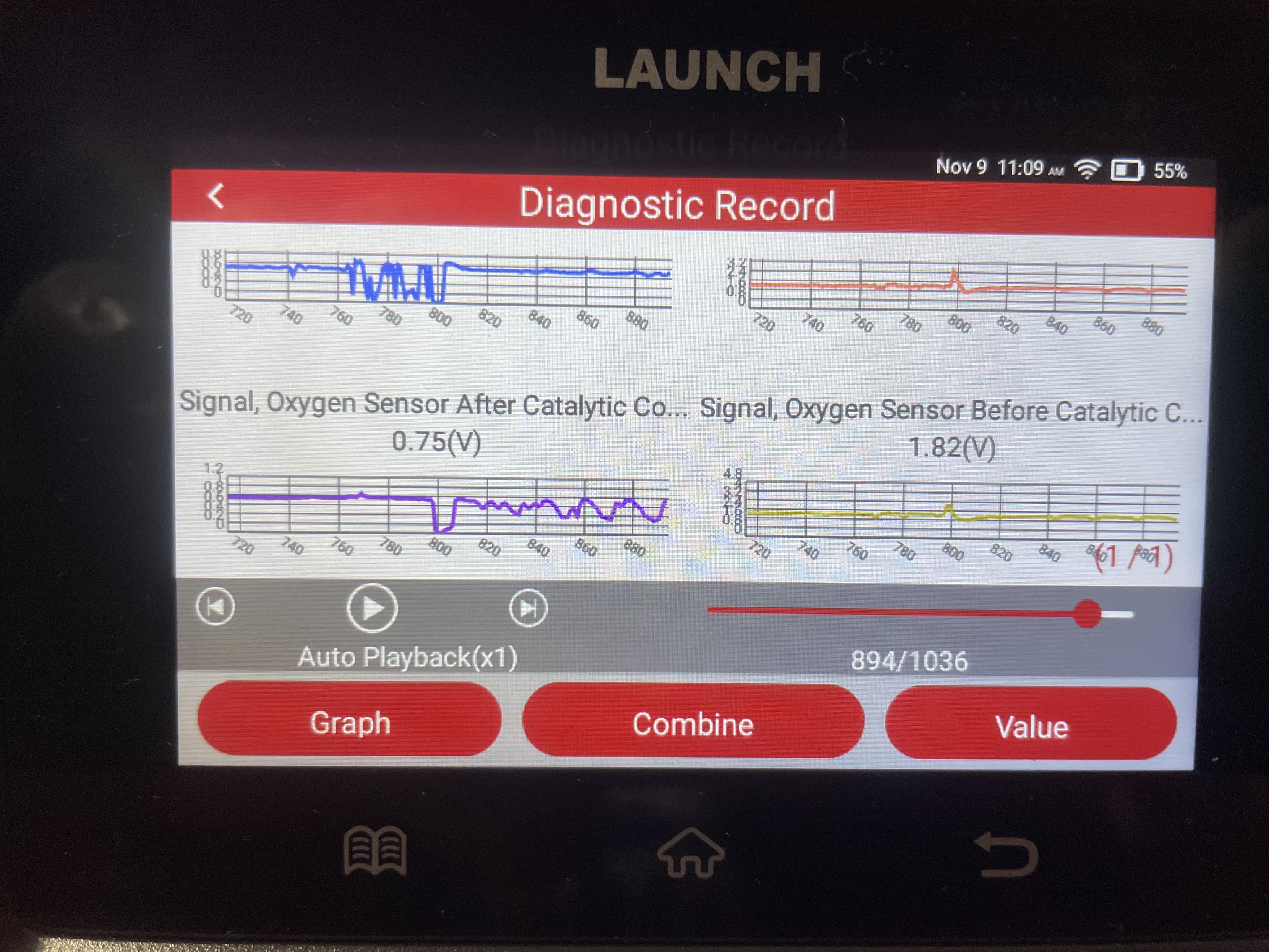

      11-09-2025, 10:29 AM   #10
2012TN128i
Drives: 2012 bmw 128i
Join Date: Nov 2025
Location: Knoxville, TN
I let it idle for a while then a couple times before rev’d the motor up to 3k rpm and held it at the end for a few seconds. Top graph is bank 2 (error code bank) bottom row is bank 1. I see obvious difference but have no idea what it means. The bank 2 post cat is erratic at times. From what I see it looks like my bank 2 cat is bad and the bank 1 is on its way? This car has over 151k miles is this normal?
