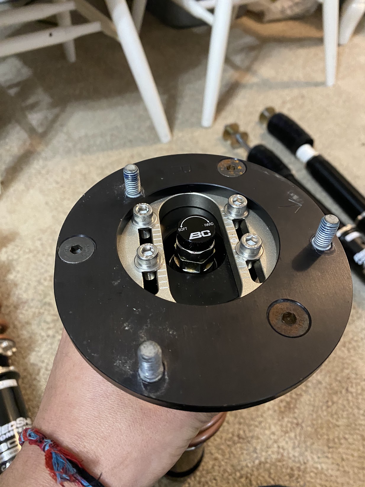

Hey all,
It seems like this trick would result in added caster. Am I am seeing this correctly?
Dinan camber plates with coilovers that have camber adjustment tophats.
https://www.youtube.com/watch?v=Z12A1-4oC6Q

Originally Posted by SedonaRed_128i View Post
Hey all,
I ran this set up on my old 128i with Red Shift coilovers and offset bushings.
While it does increase caster, I never saw negative effects. The extra camber far outweighs the caster changes. I had 245/40R17 RT660s on 17x9s with 17mm worth of spacer and it was a good fit.

I would suggest ordering longer hardware. I used loctite to tighten it down and did swap it out for longer bolts at some point.
