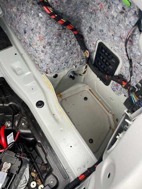

Thanks for replying. Here are some pics of my trunk. I do not see the RDC. Am I missing something?
On some years it is in the trunk well on the passenger side, but that is nto the case with my car.

There are two different versions. LCI cars have the receiver near the charcoal canister on the outside of the battery box, like the first post in this thread.
EDIT: I see those pics are OP now. That's the whole system in the LCI cars.

Thank you !!! That clears up my confusion.
