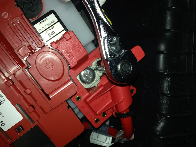

Next step is to remove the battery's positive terminal along with that big red box on top of the battery. Flip up the cover as shown below to expose the positive terminal of the battery.
Again, use your 10mm socket and rachet to loosen this nut. You don't have to remove it. If your rachet is all metal like mine, make sure you don't hit any metal part of your car or it will cause a big short.
After loosening the positive terminal's nut, you now have to release the clips holding the big red power box to the sides of the battery. This is where your screw driver comes in. There are clips on either side and you just position your screw driver as shown below and pop them out.
After releasing the 2 metal holders, your entire red power box should come loose.
