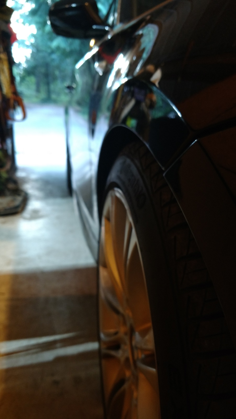

Put BMS 10mm spacers on the front. They seated perfectly and look agressive (front and rear wheel outer edges seem lined up now). Definitely am close to the line on the fender now, but no rubbing lock to lock and much more space on the inside, which is what I wanted. Need to get some camber dialed in in the front (how much negative can you get stock?) to make sure there is no rubbing when the shock is fully compressed. Anyone else running 10mm spacers on the front?

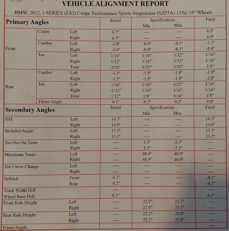

So, in conjunction with getting TPMS installed on my new wheels, I got an alignment done at a local shop with a decent reputation. Unfortunately they (like all shops local to me, apparently) will not adjust "out of spec" so I told them to push camber to the limits, if possible. Turns out they left it cambered out of spec in the front in my favor anyway, as, apparently, the front was already cambered at ~-1.0, -0.9(??). This didn't make sense to me based on everything I have read on this forum, but unless their machine is messed up that's what it is (alignment pin is still there BTW). I should probably check to see if I have M3 control arms or something... I did buy the car used.
Good news is that the car drives fine. They did push the rear camber out and actually let me have 0.1 over on one side. I also noticed they used the spec for the 135is (mine is an M-sport). Not sure if that matters.
This should be fine for the last two track days of the year...next year I may spring for a custom suspension setup, including camber plates and figure out how to do all this myself...

1/8" toe in on the front is quite a lot. Its about 0.14 degree per side. For track use, zero front toe is a good starting point. More front toe in = More understeer.
Rear alignment is good. Rear looks like max camber and 1/8" toe in, which is ideal IMO.

I would have preferred zero toe for the front as well, but they wouldn't go "out of spec" on that parameter, so I am at the min spec. Maybe as I build a relationship with this place they will become more pliable. They were willing to leave the front camber OOS, after all.

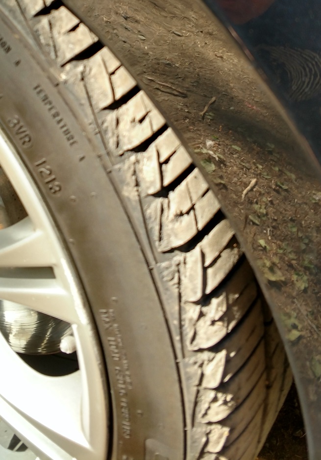

New wheels and tires worked great on the track! Still got some chunking on the edge of the fronts (need more camber!), but no visible rollover like i was getting with the stock RFT's. Now just need to wear them out so I can put on RE-71's...
