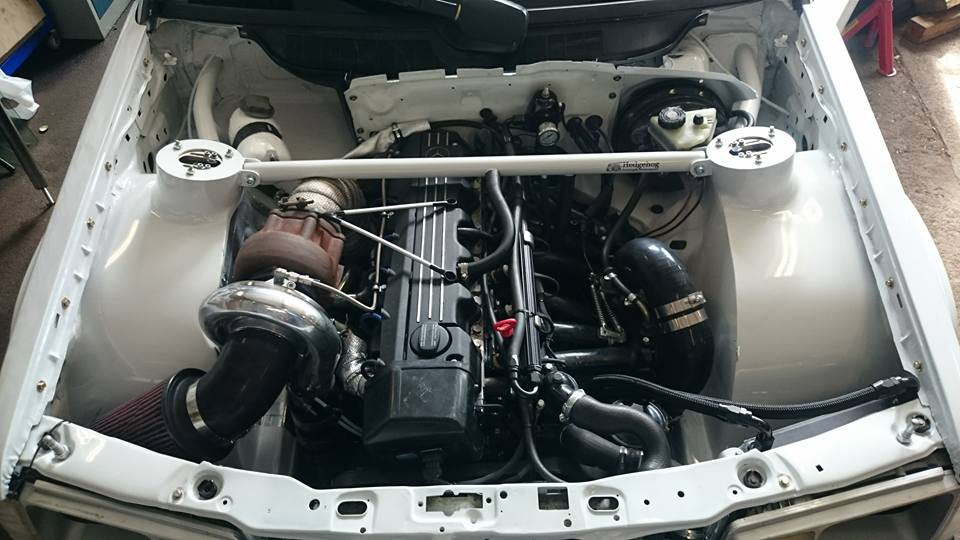

Originally Posted by lab_rat View Post
Great taste in cars and mods.
Please share more about your former 190E...those cars are amazing, and all too often underrated.
Thanks!
Yes, they're lovely cars. The disadvantage of them are the aftermarket, when I started building that car back in 2011 there was nothing available.
It had an M103 3.0L pushing about 550whp & 700wnm, and the weight of the car was 1150kg, so it was fast. Almost impossible to drive
I rebuilt the whole car, it was an never ending process for sure. When I bought it, I didn't know a single thing, never touched a weld machine before so it was an quite interesting start. Started to do alot of rust repairing, Sweden and salty roads... And the cage was next up, and so it went on.
The first stage of the car was finished in about 11 months.
Later on I rebuilt the whole drivetrain and chassi, wasn't available to find "high end" components to the suspension so I decided to rebuilt the tubs to fit coilovers from E36, both front and rear reinforced in to the cage.
Went for an GS5-39DZ gearbox from E46 330D, prop from E46 330D and differential and axles from M3 3.2 E36, the big 210 case and thing started to hold up for the power.
Short summary
Loved that car! But it wasn't the best trackday car, for drifting for sure but not to do fast laps

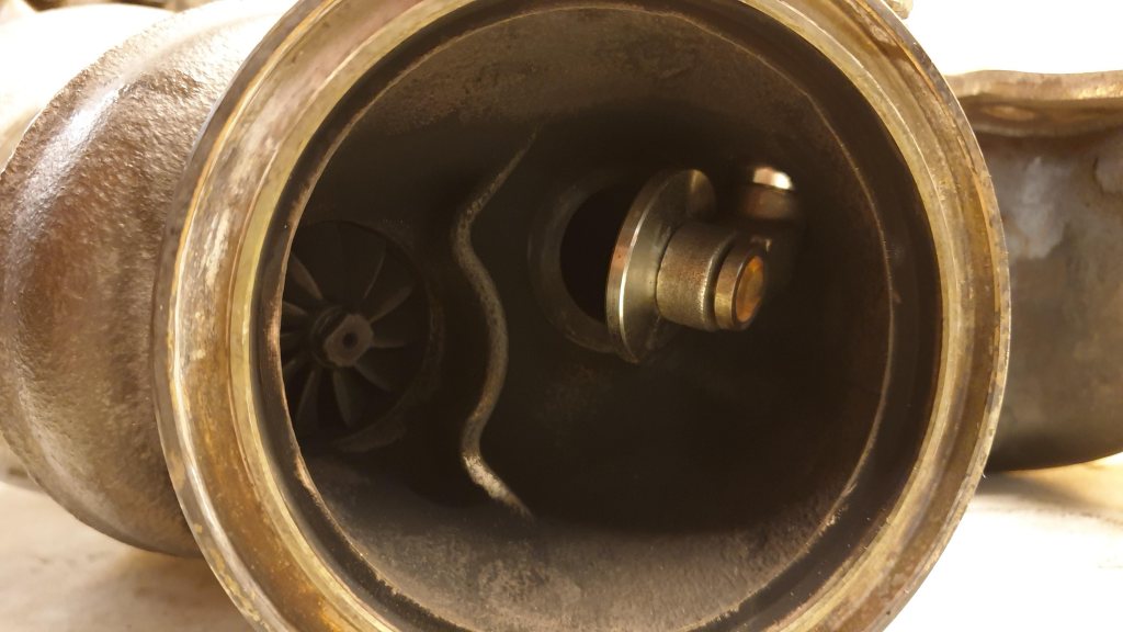

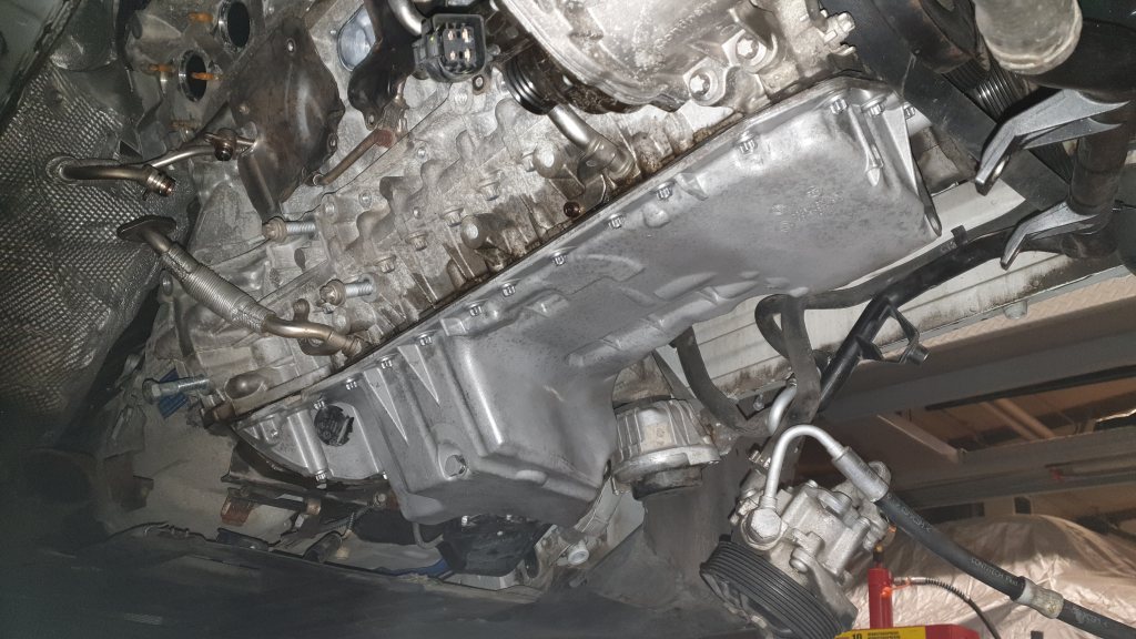

Is that the VAC baffle or custom/self-built ?
How do you like AR1s over the distance of the 'ring lap? Consistent or noticable drop-off towards the end?

Gotta love that beautifully clean and open engine bay. Very nice work!

It's an nock-off off the VAC baffle, I hope it will save some bearings.
I think the AR1s performe great, the ring is quite harm to the tires during the high speed and long "straights" and the facts that you don't push the limits as on an smaller course.

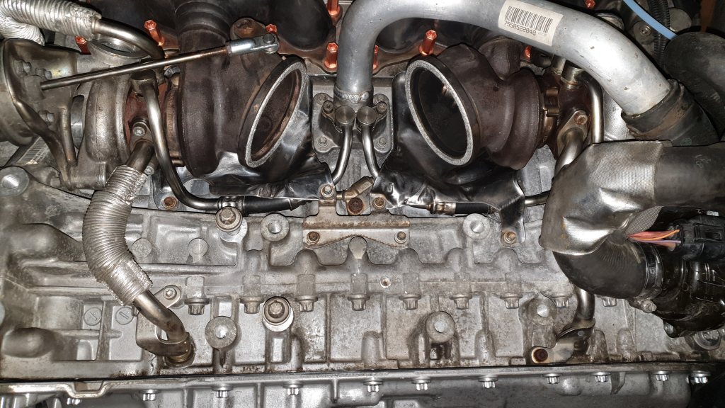

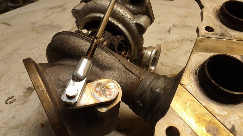

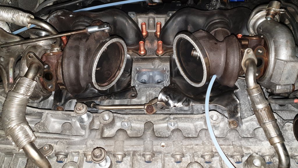

I had big wastegate problems when i visited the ring, the last 10km I was almost all out of boost.. But I was available to set a 8.36 with a restart of the car and boost problems so Im really pleased. Next time I hope for a sub 8.

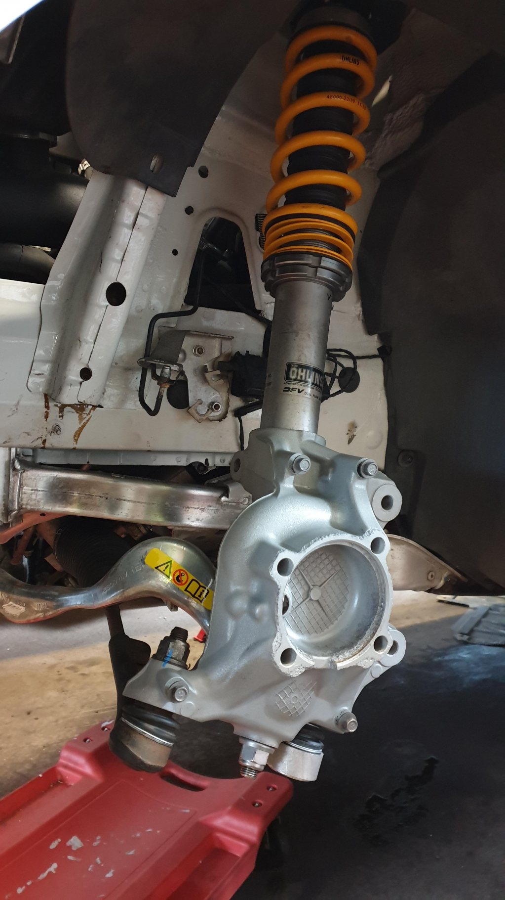

      03-08-2020, 03:22 PM   #6
alindquist
Sweden
150
47
Drives: BMW 135I
Join Date: Jan 2020
Location: Sweden

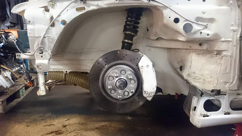

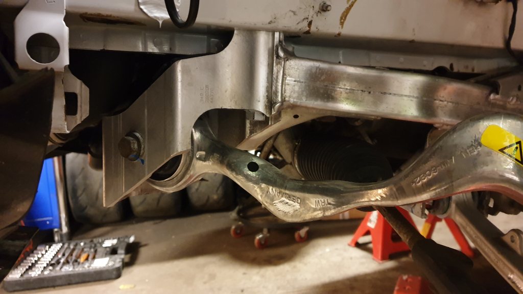

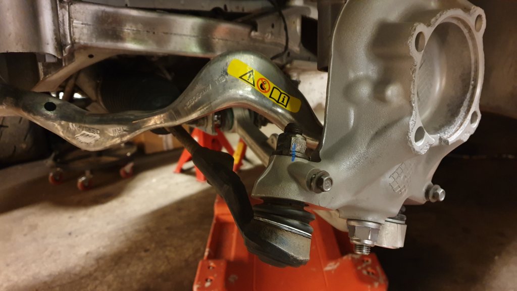

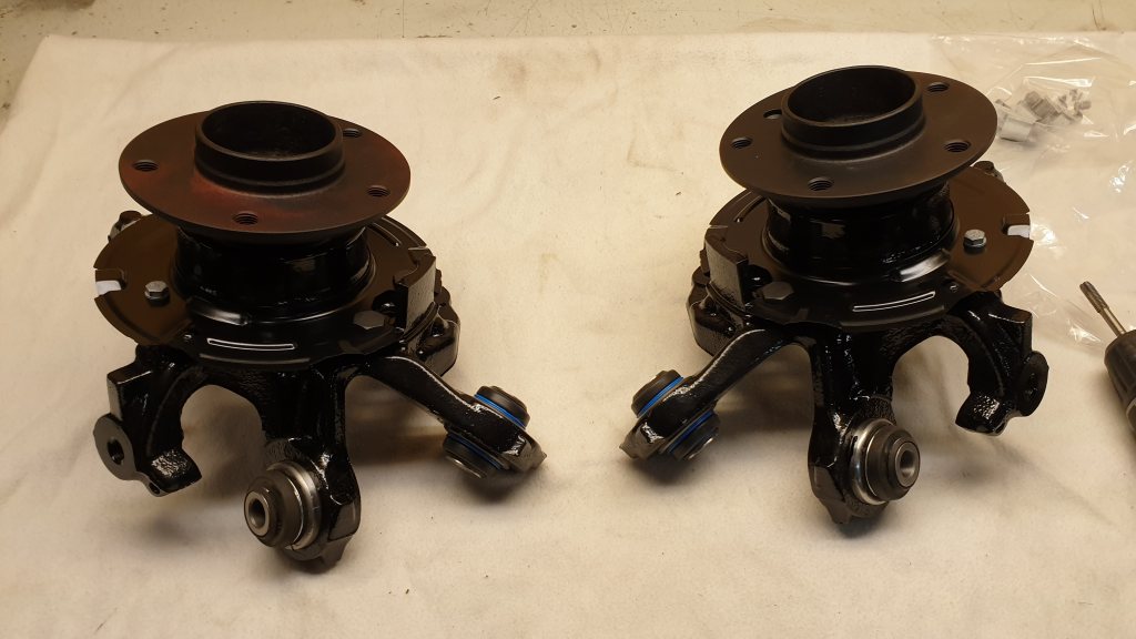

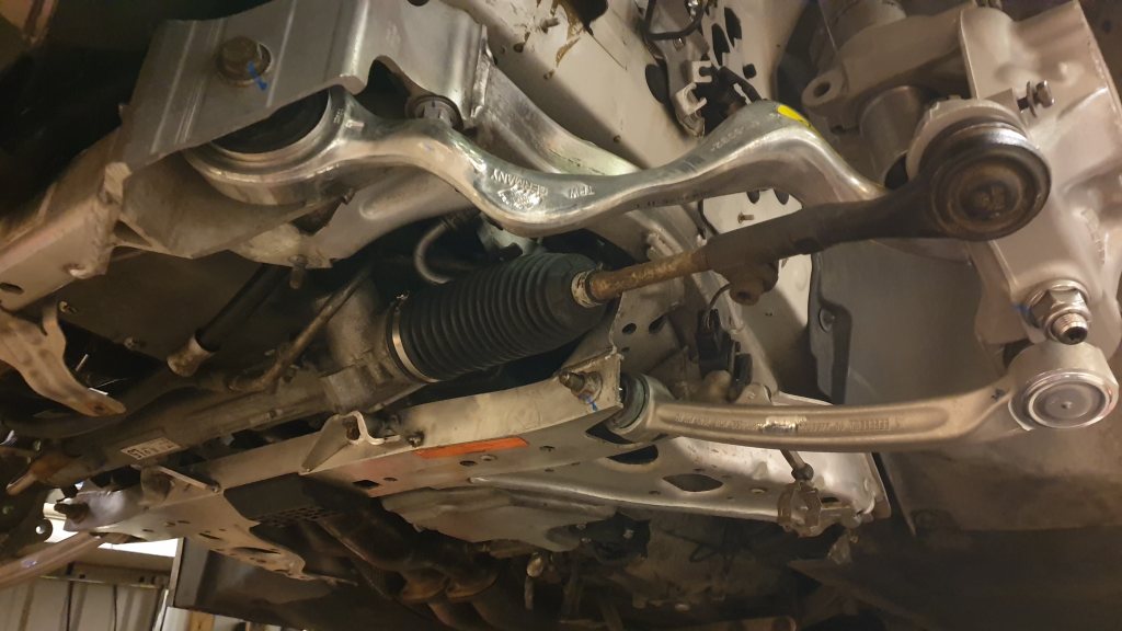

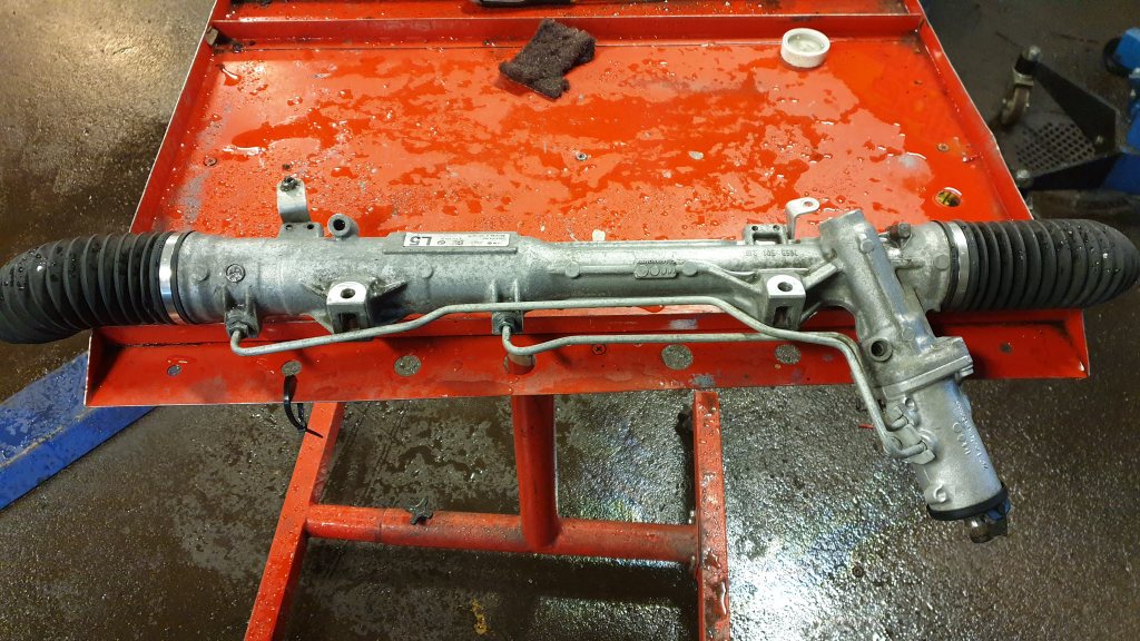

The front suspension coming along nicely.
gmx171.00
lab_rat396.00
BMWWorld236.00
fe1rx1649.00

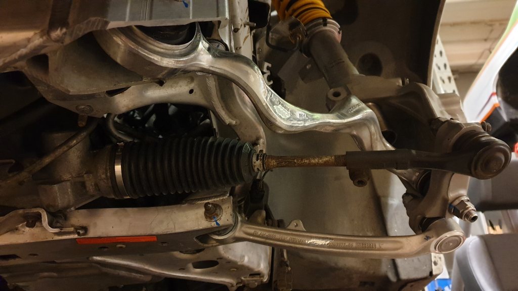

      03-11-2020, 02:44 AM   #7
alindquist
Sweden
150
47
Drives: BMW 135I
Join Date: Jan 2020
Location: Sweden

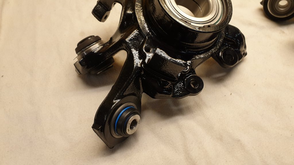

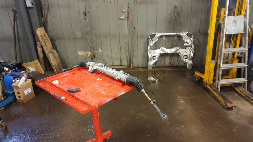

Look at this
Appreciate 7
gmx171.00
bbnks21234.50
houtan792.50
SKI-R167.00
lab_rat396.00
BMWWorld236.00

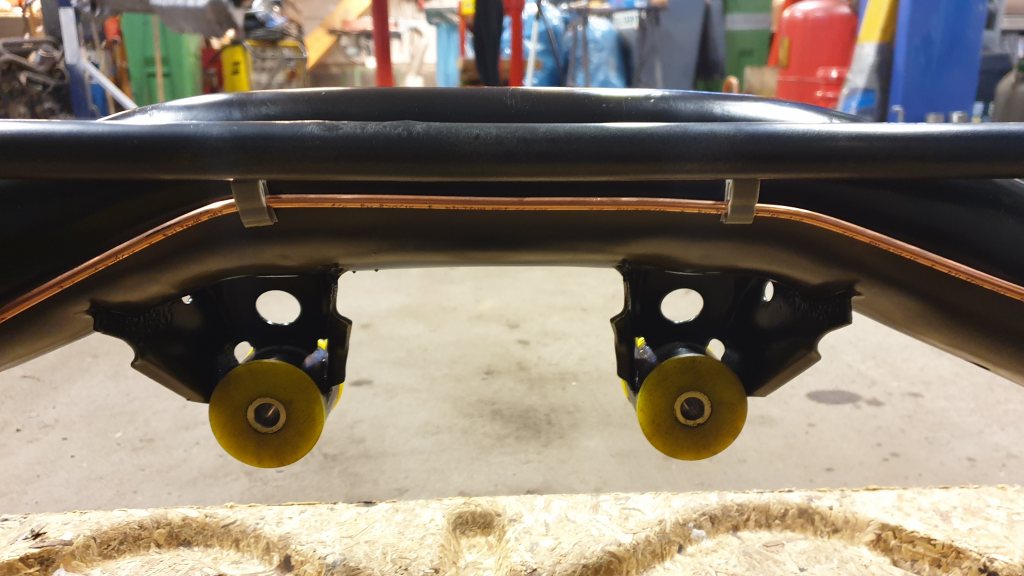

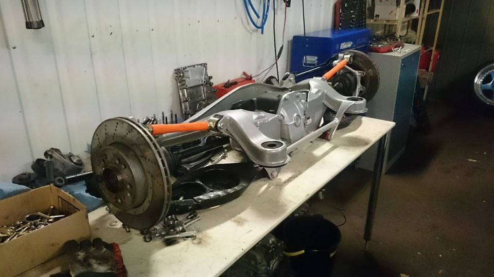

      04-05-2020, 04:07 AM   #8
alindquist
Sweden
150
47
Drives: BMW 135I
Join Date: Jan 2020
Location: Sweden

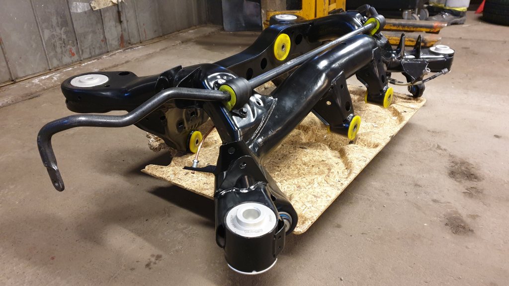

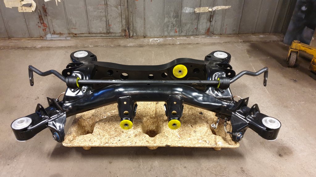

Made me a new set of brake shields.
And the subframe is ready to be mounted back on the car.
Suprgnat3001.50
SKI-R167.00

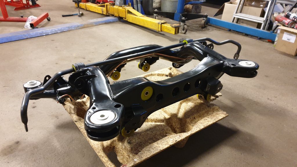

      04-15-2020, 05:29 AM   #12
alindquist
Sweden
150
47
Drives: BMW 135I
Join Date: Jan 2020
Location: Sweden
Originally Posted by wuX2 View Post
There's a stickied thread for coding: https://www.1addicts.com/forums/show....php?t=1216642
Thanks! Gonna check that out!
Originally Posted by BMWWorld View Post
Nice mods👌🏽
Thank you!

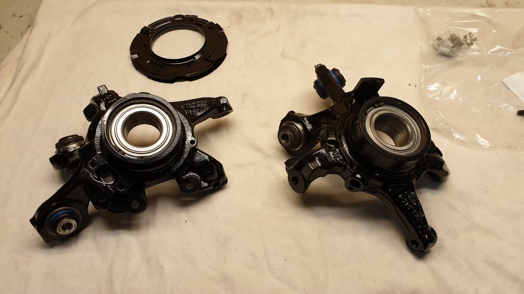

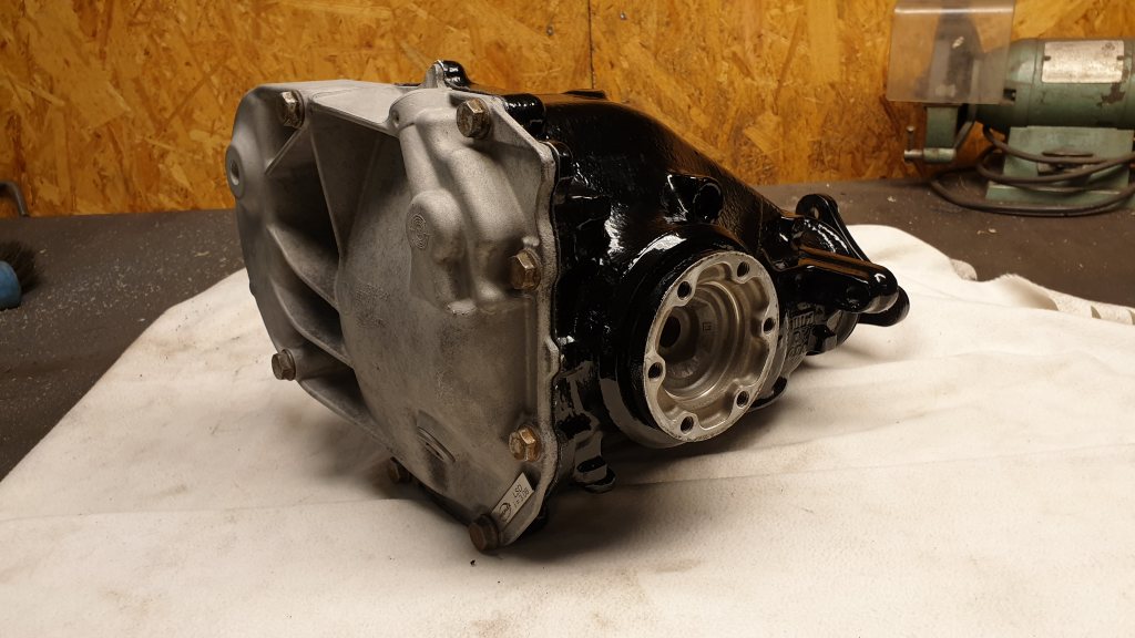

One step further!
fe1rx1649.00
SKI-R167.00
Suprgnat3001.50
houtan792.50
      04-17-2020, 07:28 PM   #13
fe1rx
1649
808
Drives: 135i, 328i, Cayman S
Join Date: Jan 2008
Location: Canada
One step further!
I assume you are electrocleaning (i.e. reverse plating) the hardware. Can you provide details of the process, and are you re-plating the hardware before using it?

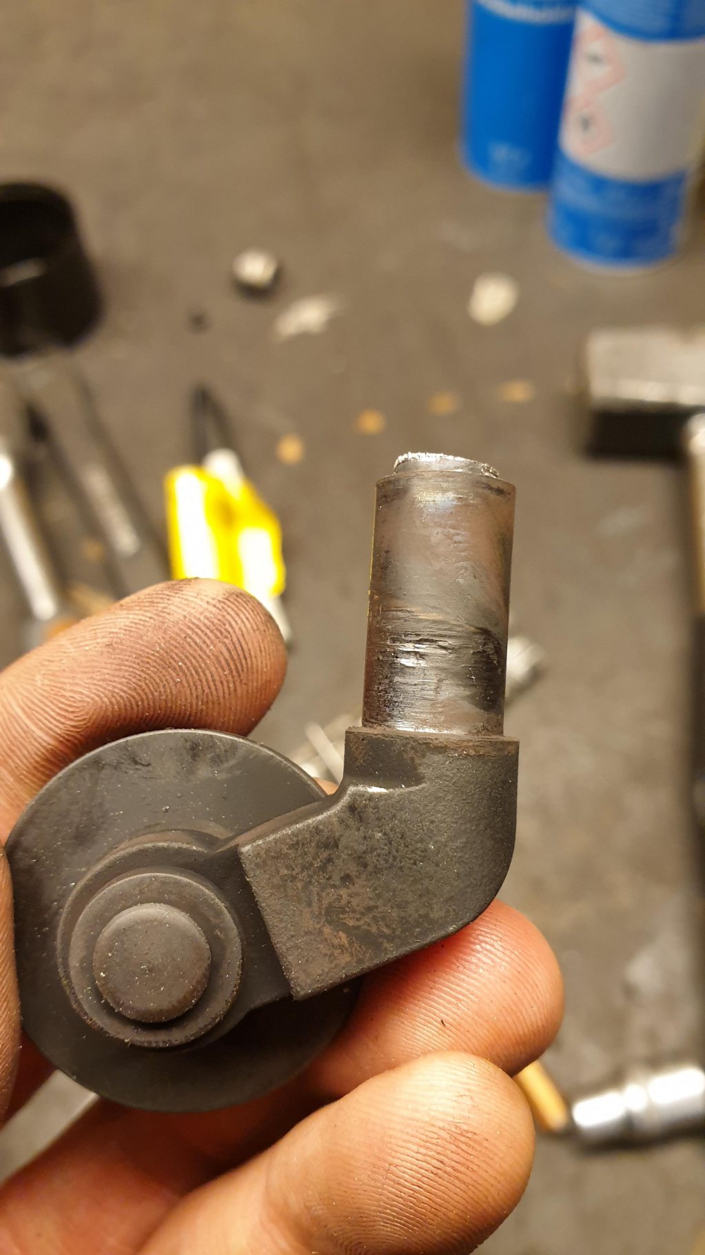

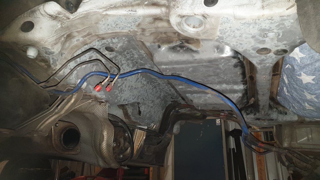

This might help agains the terrible pedal feel, did some coding with ProTool and deacivated this codes. I set the remaining codes as 1m, interesting how this will effect the car.
FLR ("Engine Power Reduction to Prevent Brake Disc Overheating")
FBS ("Brake Fading Compensation")
BB_RAB ("Brake Standby")
Also, changed the stock pistons to stainless ones.

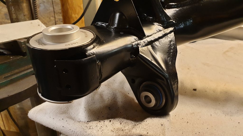

Wop wop! Finally rebuilt the terrible axle back system. The plan was to rebuild the whole system, from the dual 3" downpipes to a dual 2,5" mid section collecting up to a single 3,5". But I decided to just rebuild the axle back section now, less pain for my wallet. The axle back section is made of 1,5mm 3.5" stainless.
Also changed the rubber bushings in the front M3 controlarms to monoballs.
