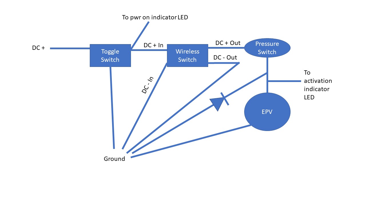

Hey by any chance could you take a pic of the diode placement and the remote relay setup?
I have everything ready to go and still trying to figure out how to get this remote relay wired.
+ DC input 1 -->
- DC input 2 -->
+ DC output 3 -->
- DC output 4 -->
Also on the pressure sensor, I see a third white wire. What is that for?
Sorry for all the questions and thanks again for everything you did to document the install.

      04-18-2022, 10:47 PM   #55
AndyW
AndyW's Avatar
746
1,796
Join Date: Feb 2012
Location: Washington, USA
+ DC input 1 -->
- DC input 2 -->
+ DC output 3 -->
- DC output 4 -->
No problem. A pic won't really help as I wrapped everything in tape. Here is a diagram that should help. The white wire is the line to the activation LED.
Best,
Andy
