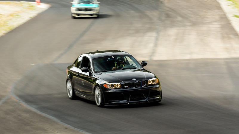

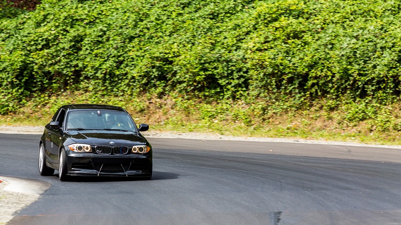

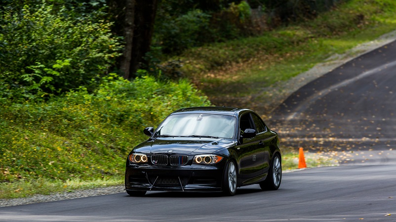

I run 255/35/18 RE-71's on BMW 135 ET50 wheels.
Things not stock:
Rolled Fenders
Fronts have a 10mm spacer (so effectively ET40).
M3 Control Arms
GC Camber plates (Thx, JPuehl)
KW Clubsports with Swift Springs (Thx, berns )
Ground off the lip between front bumper cover and front wheel panels (pretty standard mod for this)
Moved front quarter panels out as far as possible (increases visible gap to hood slightly) (thx, Ginger_Extract )
Camber is -3.2 in front, -2.2 in rear
I don't notice any rubbing. Thx to JPuehl for convincing me it was possible.
Here are some pics of the car on track in that config:
Best,
Andy
