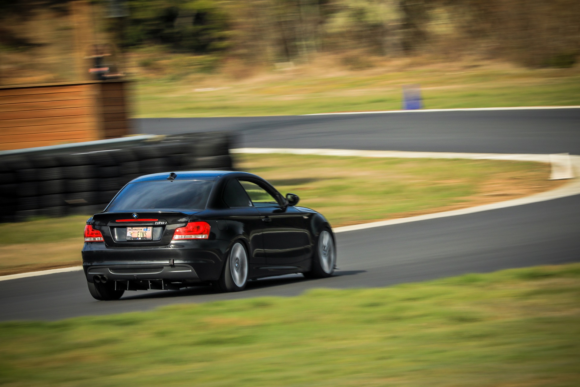

This pic from my recent track day makes me wonder if I really do need to upgrade to the M3 anti-roll bars. it is about a 65 MPH sweeper turn with a 75-80MPH exit speed. Car felt good and stable, but man...that squat. And this is with clubsports with 750 Swift springs.

Squat and/or roll is not nessicarily a bad thing. If the car feels good, what are you hoping to improve by adding the sway bar?
Also, do you have any pictures of the car stationary? Hard to tell how much it's squatting based on the picture. It could be a lot or not much depending on what ride height you run.

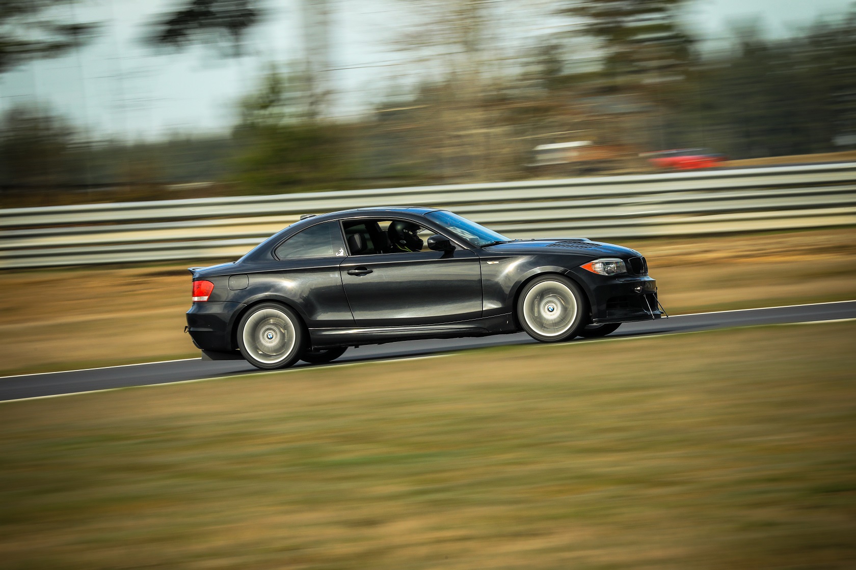

I hope to improve traction by keeping more tire on the ground. The pic just shocked me a bit. Since I upgraded to the clubsports in 2019 the car has been much more planted and the pics I have all had pretty benign roll...until this one. Maybe it's just the angle.
Not stationary but this is the basic stance, which I think is great.

Adding a rear sway bar will reduce rear traction. It will actually unload the unweighted tire more and shift the load onto the outside tire. At the front of the car, less load is transferred side to side. Adding a rear sway will change a cars roll couple distribution, that is, the roll stiffness of the front of the car relative to the rear. I don't want to get overly technical, but given your goals a rear bar upgrade is not the route to go.
For your goal of 'improved traction', can you elaborate on that? By rear traction do you mean more generally rear grip, or mostly traction while accelerating? If you mean more generally to just improve rear grip, what section of the corner (entry, mid, exit, all of the above?) There's lot's of approaches you can take to improve these areas, or even just rear traction.
