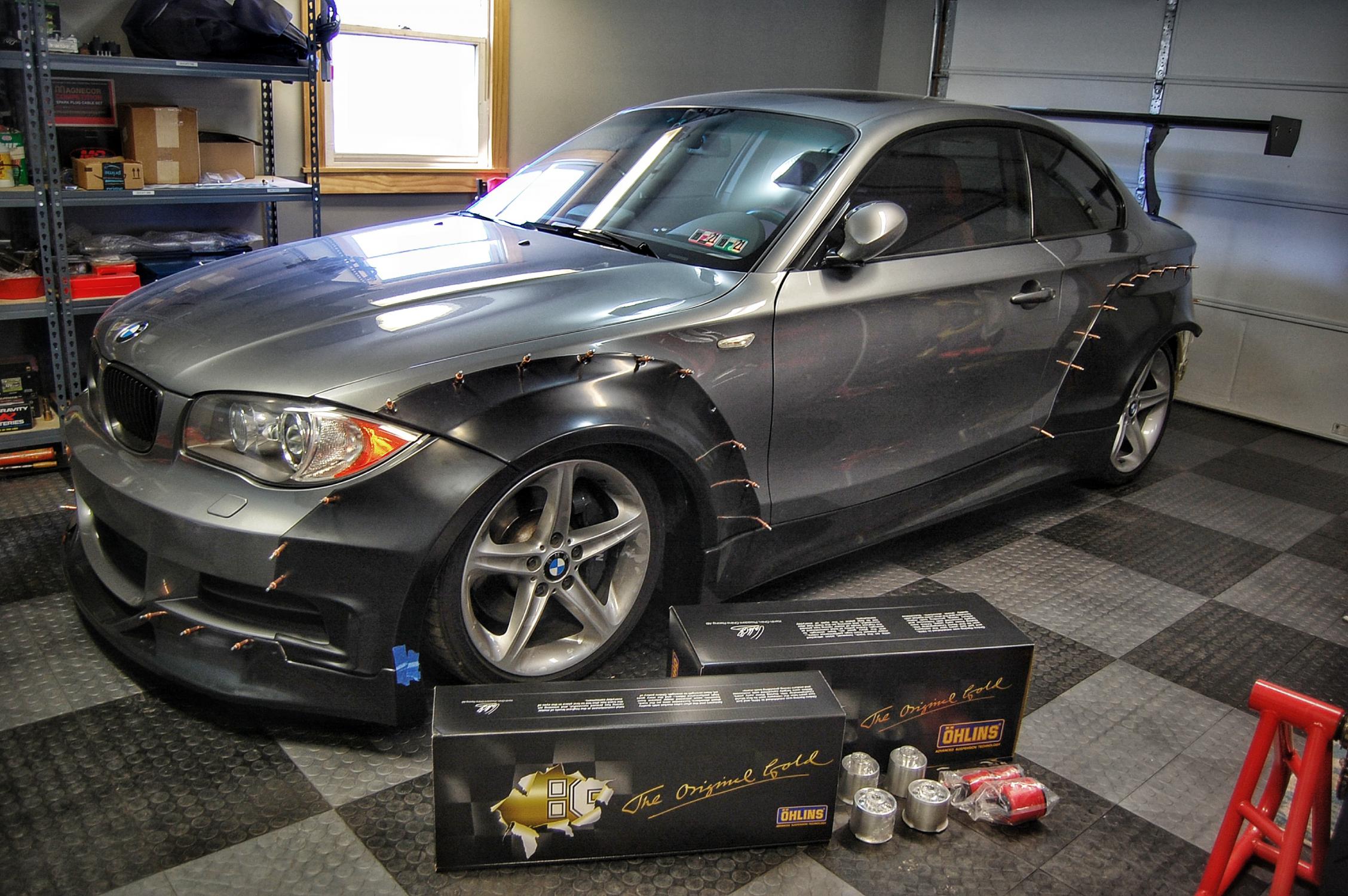

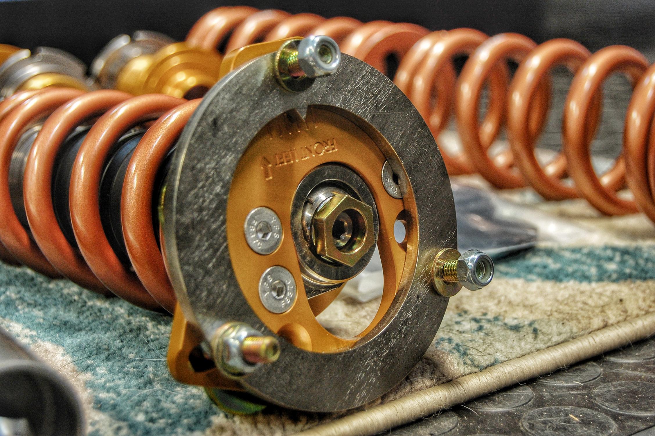

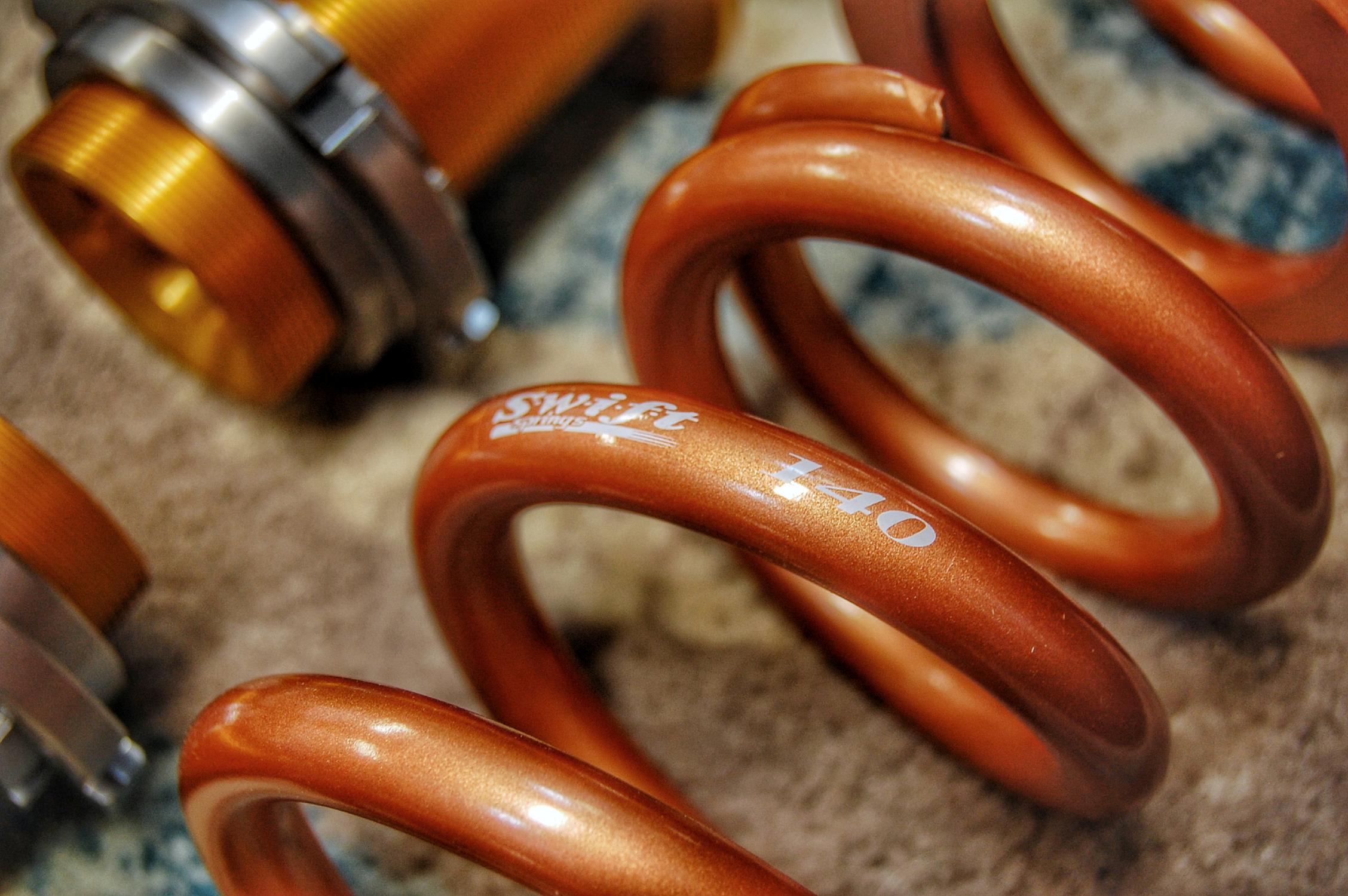

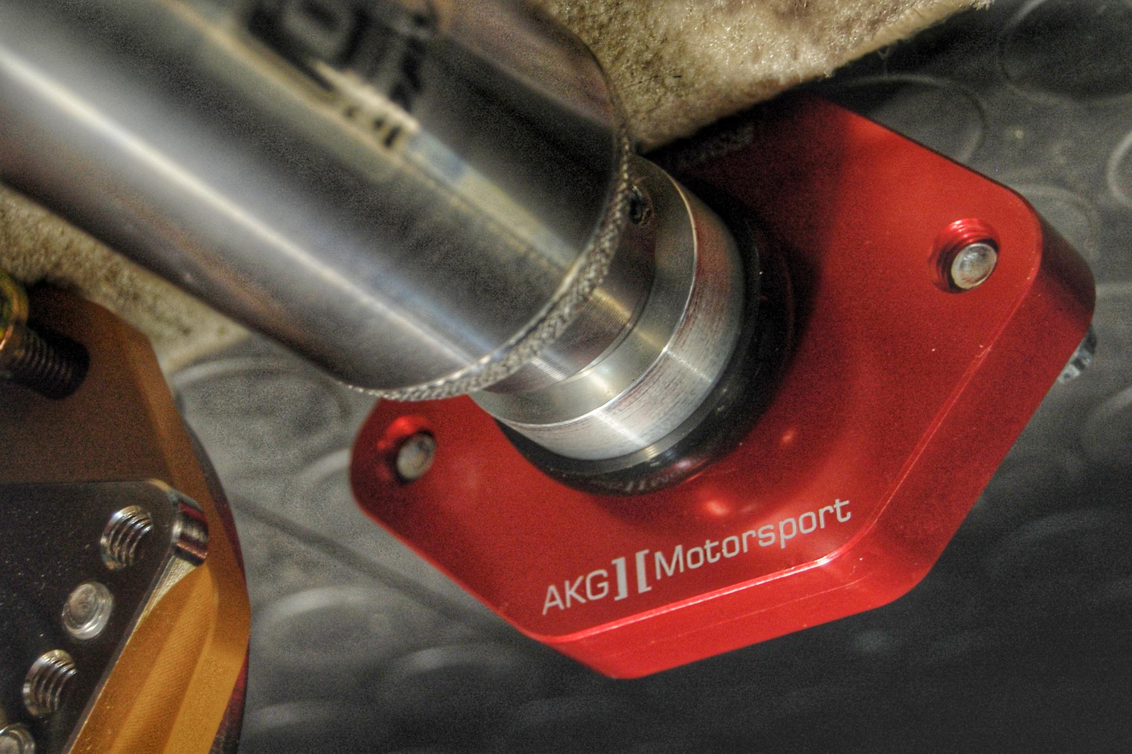

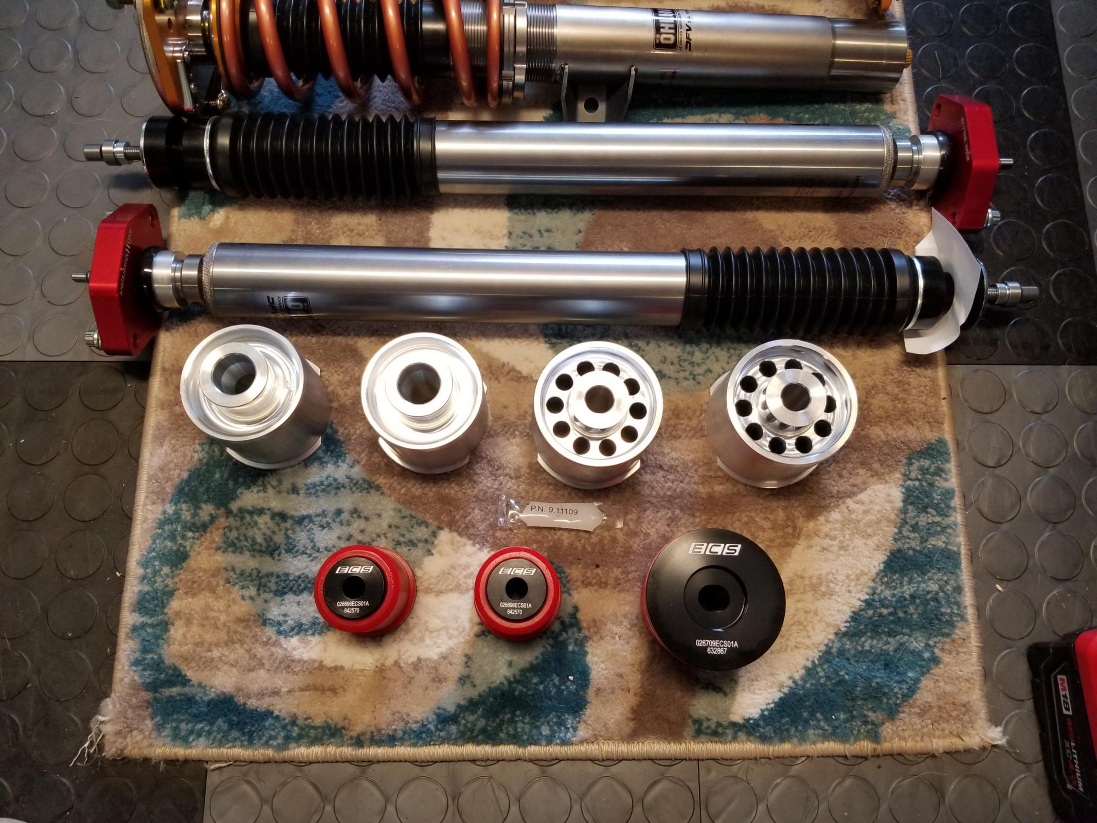

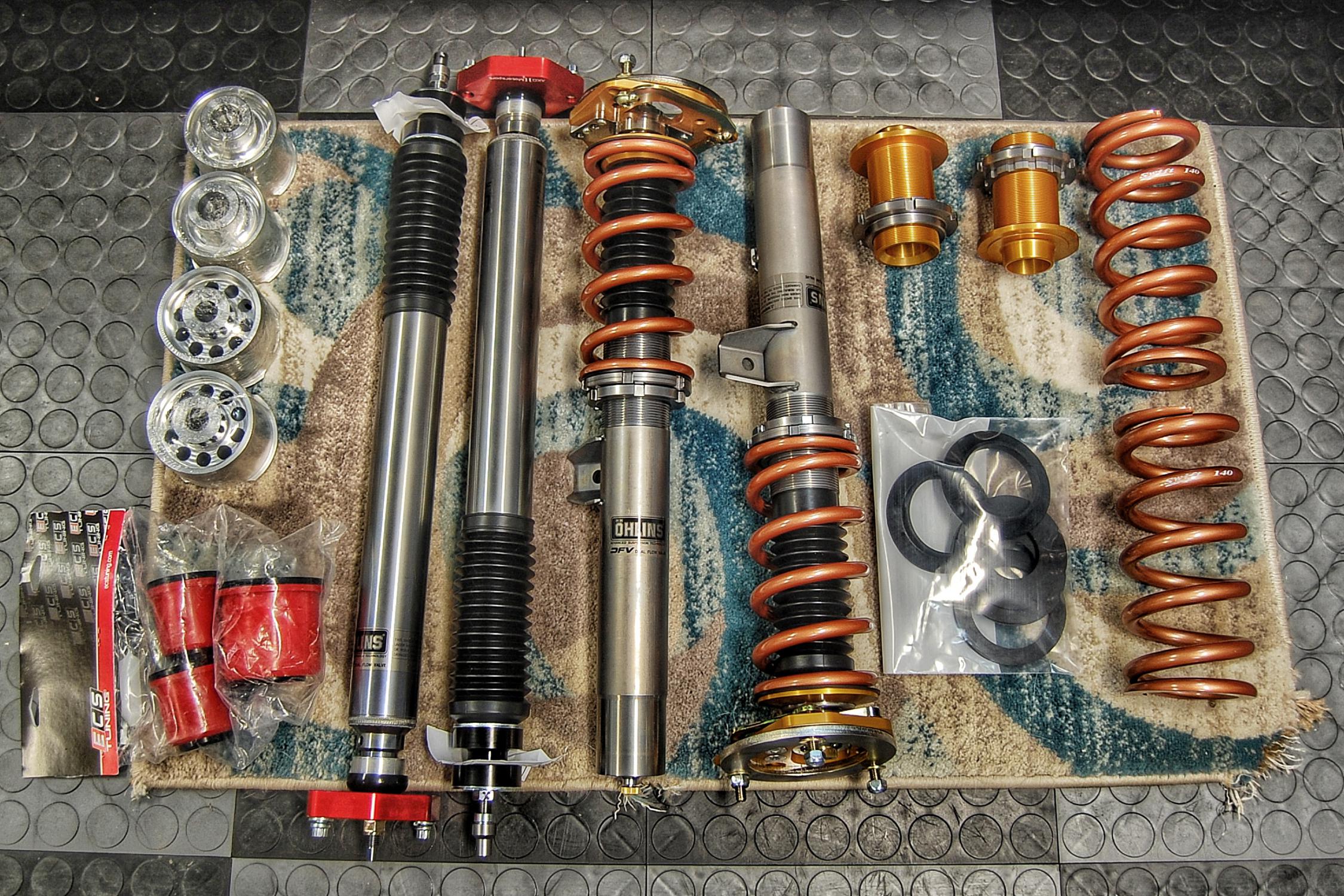

Ohlins Trackday Kit by 3DMsuspension arrived.
-Ohlins DFV Coilovers
-Solid mount bushings for the Subframe and 95A poly for Diff
-Swift Springs: 80/140 Nmm
-Vorshlag Racing Camber Plates
-AKG Spherical Bearing Shock Mount

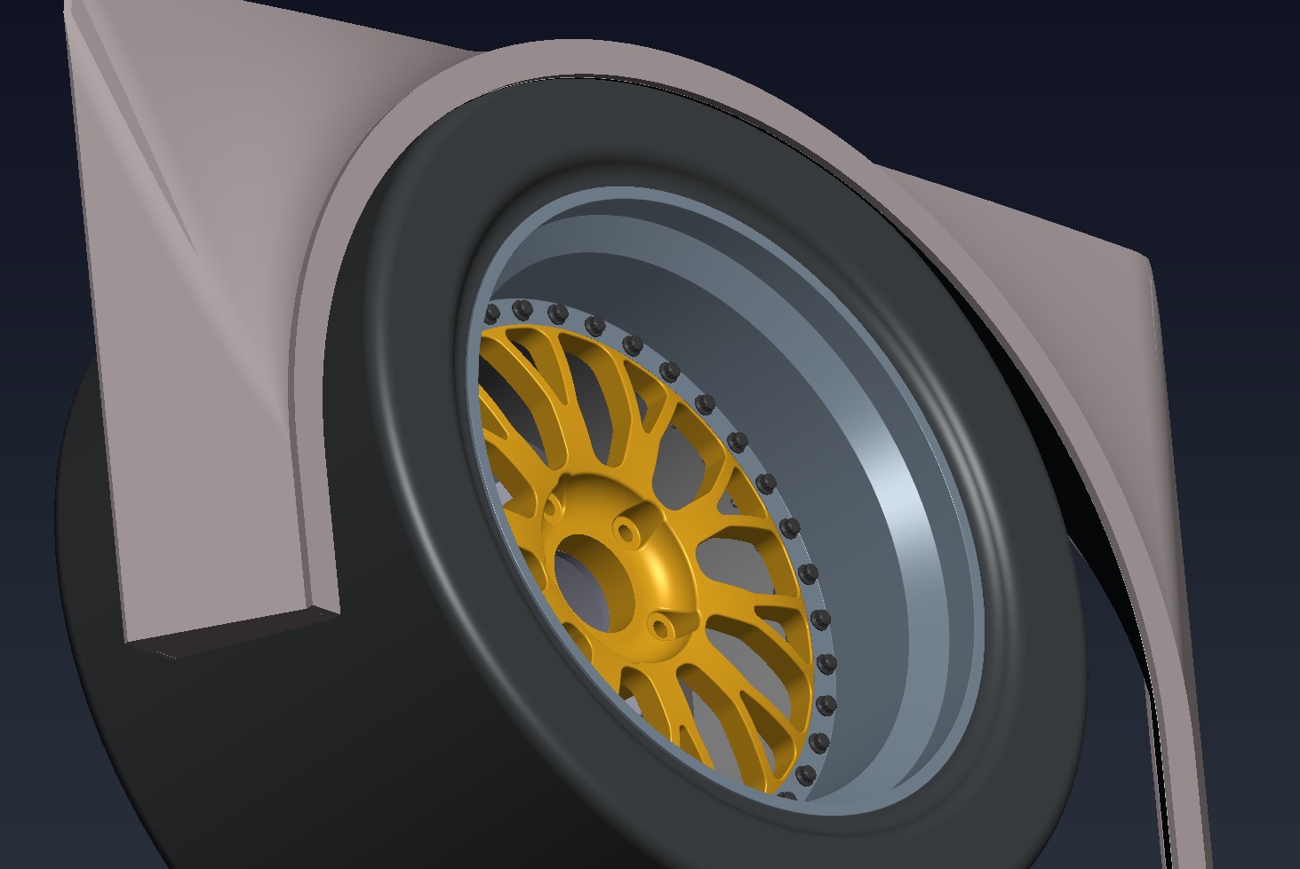

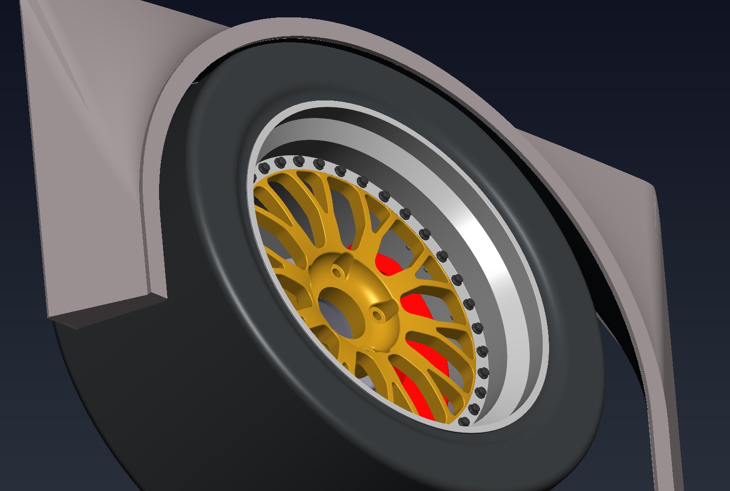

Some final calculations prior to ordering wheels. I plan on using the Toyo R888R's with a 265/35 front and 315/30 rear. Using the specifications provided by Toyo I was able to calculate the overall tire width on 10.5" and 12" wide wheels.
Based on my calculations the front maximum tire width will be 11.1" and the rear will be 13.0". I made the tires in CAD and plugged them into my model. I also plugged in 2.8° front camber and 1.8° rear camber. This results in a 2mm clearance from the tire to the inner fender panel in the rear and a 9mm clearance in the front. More room in the front will allow me to run a 275 width if I feel I need to in the future. I am going with the 265 so I can get a small amount of stretch on the 10.1" tread width to preload the tire for better handling and feedback.
It will be interesting to see how accurate my calculations are when the wheels/tires come in.
Front: 265/35 Toyo R888R | R Disk 10.5" width 4mm offset | 2.8° Camber
Rear: 315/30 Toyo R888R | A Disk 12" width -2mm offset | 1.8° Camber
Another factor I considered was the overall tire diameter. The stock setup is 24.77" front and 24.75" rear, so approximately flat. The new setup will increase the height by 0.5-0.7" to 25.30" front and 25.44" rear.
In theory, I believe this will be the widest setup that offers the best handling possible for an e82.
This may seem overkill, but I haven't found any E82's using a clinched widebody for a track oriented car. They all seem to be stanced. Some guys are running 13" wide wheels, but with massive camber angles and tire stretch.

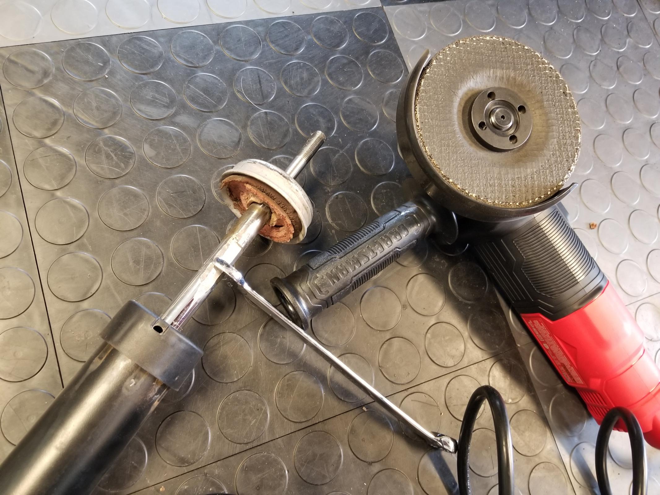

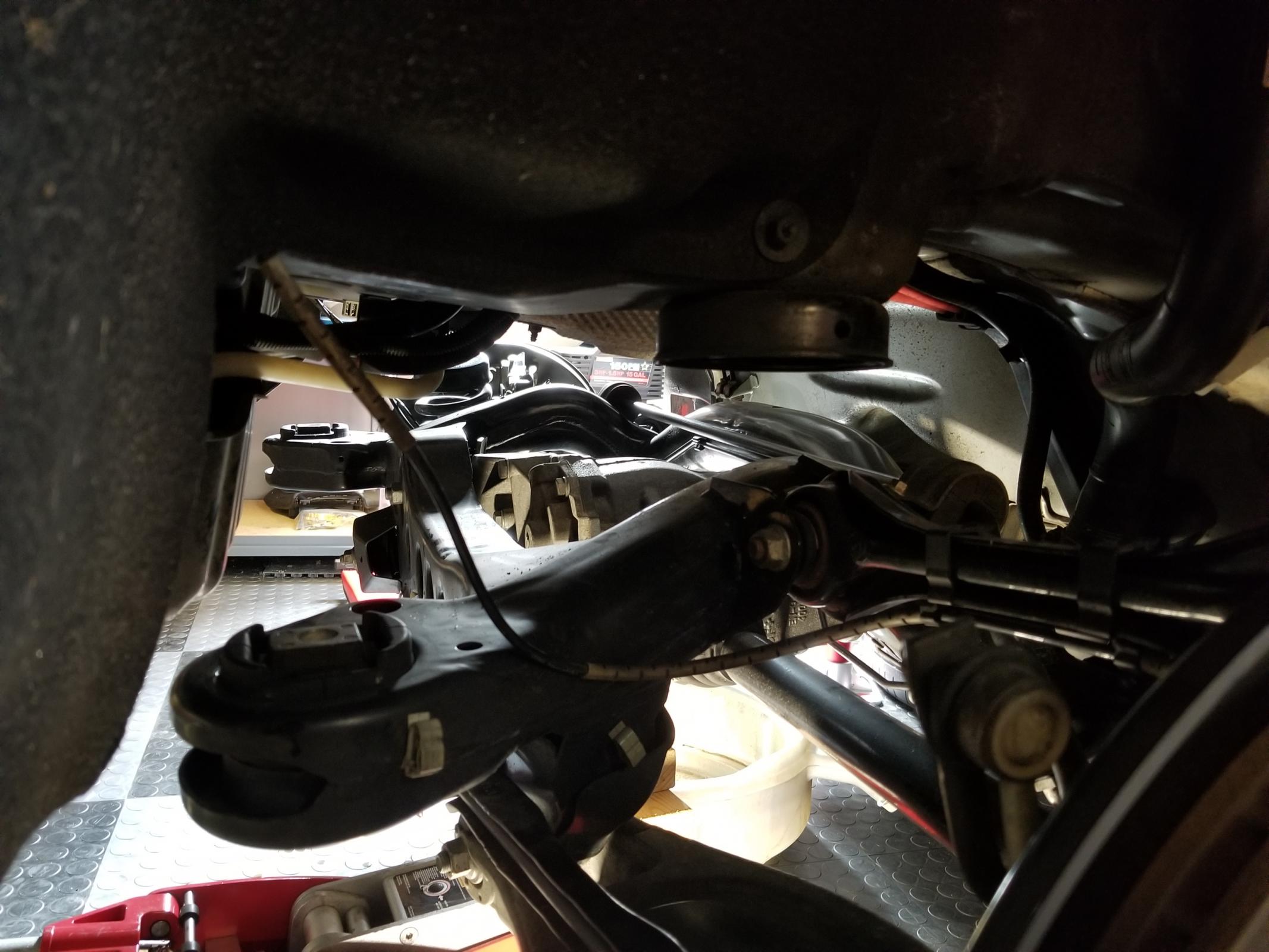

Decided to start with the rear. Removing the old shocks turned out to be a chore when the top hex portion sheared off so I ground into the rod and used a wrench to hold it while I removed the top nut.
Subframe lowered, ready to put the solid bushes in. Doing the diff may be tricky as I'm trying not to have to remove the diff nut.

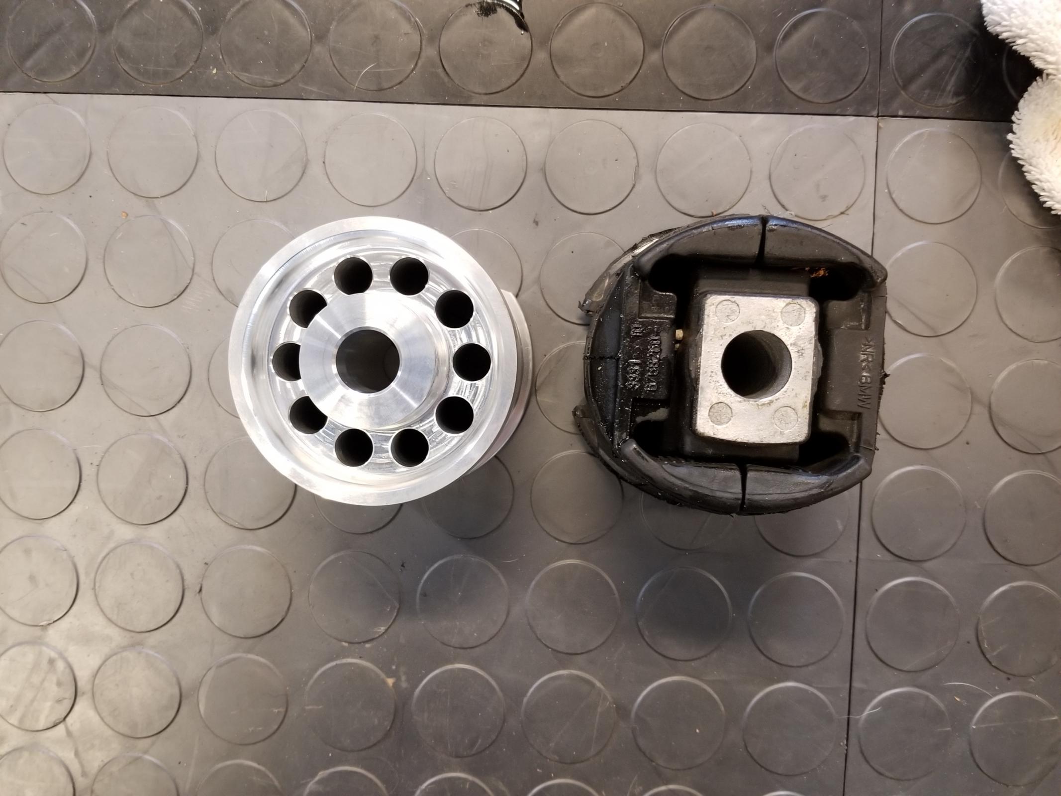

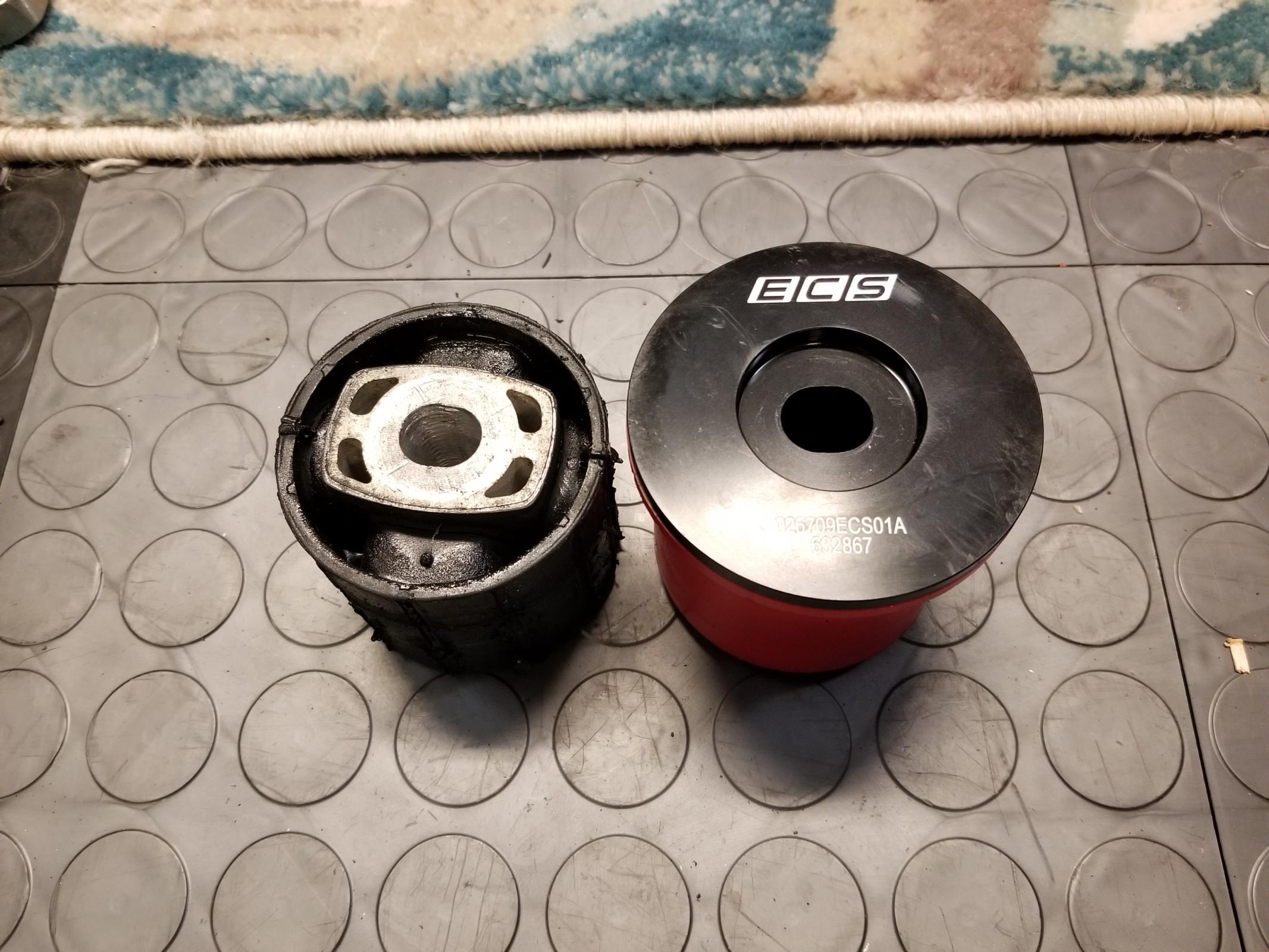

First bushing out.

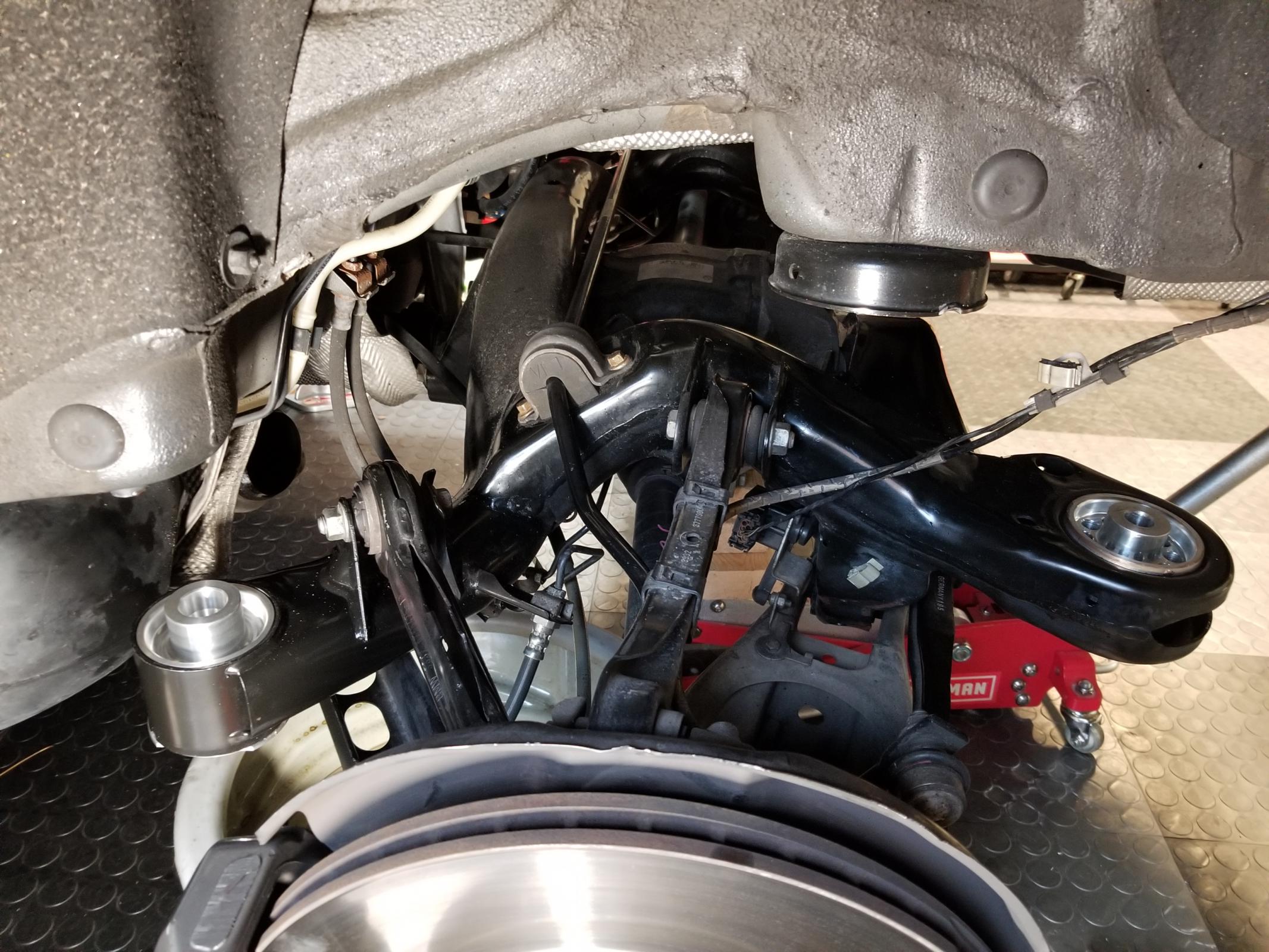

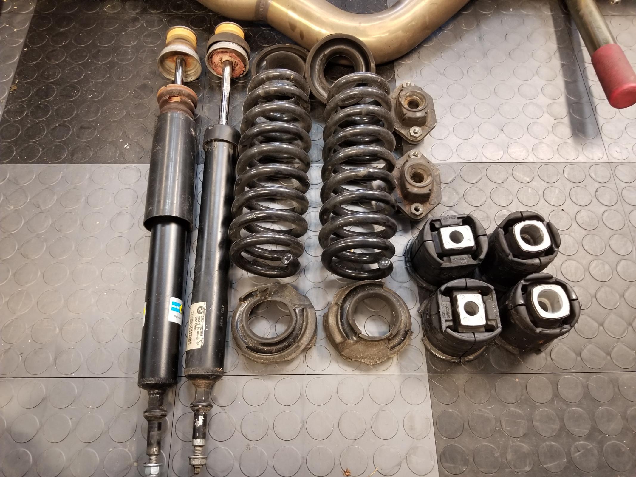

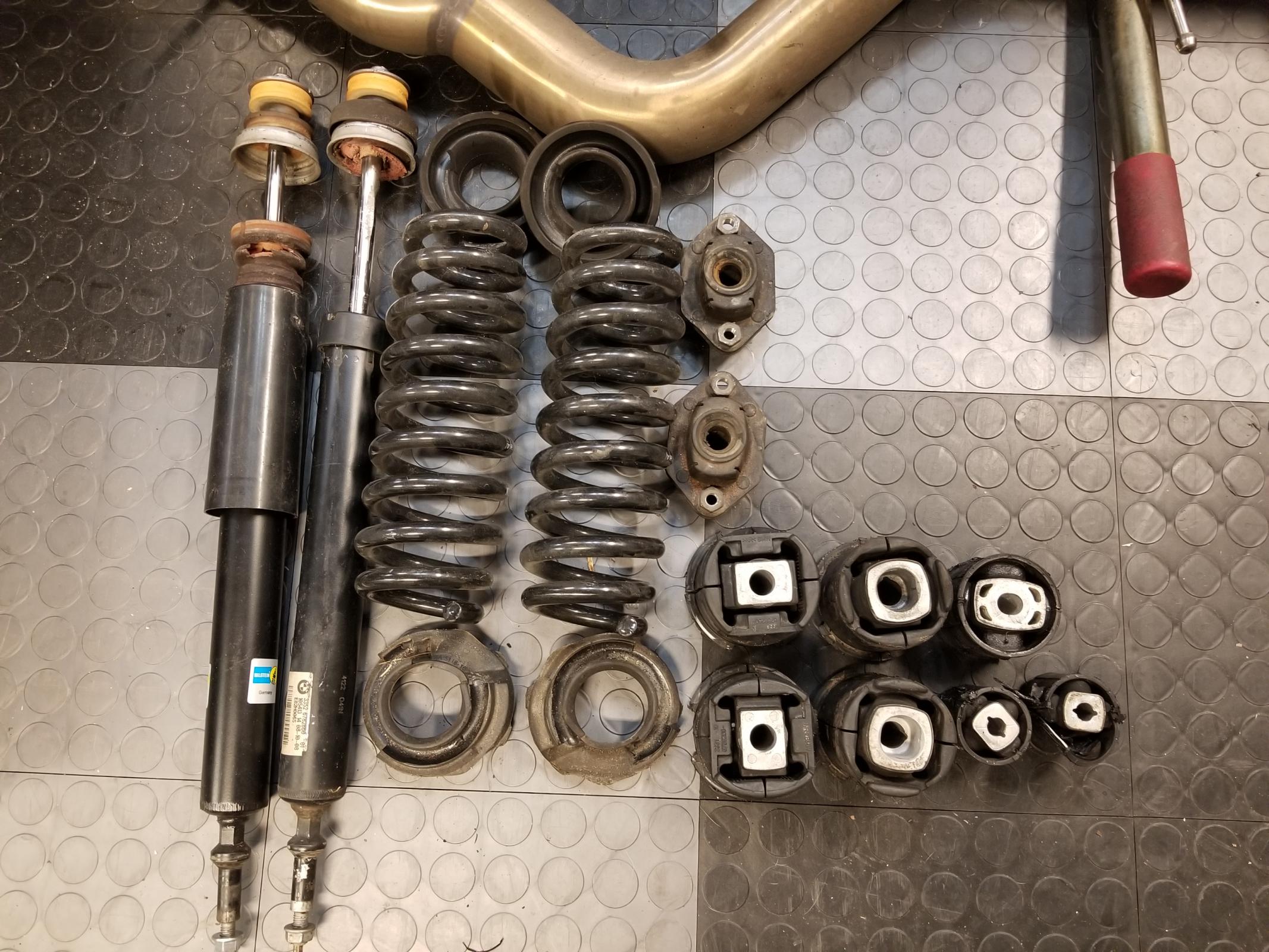

4 hours to drop the subframe, get the old suspension and bushings out, minus the diff. Not bad. That's it for today, hopefully finish up tomorrow.

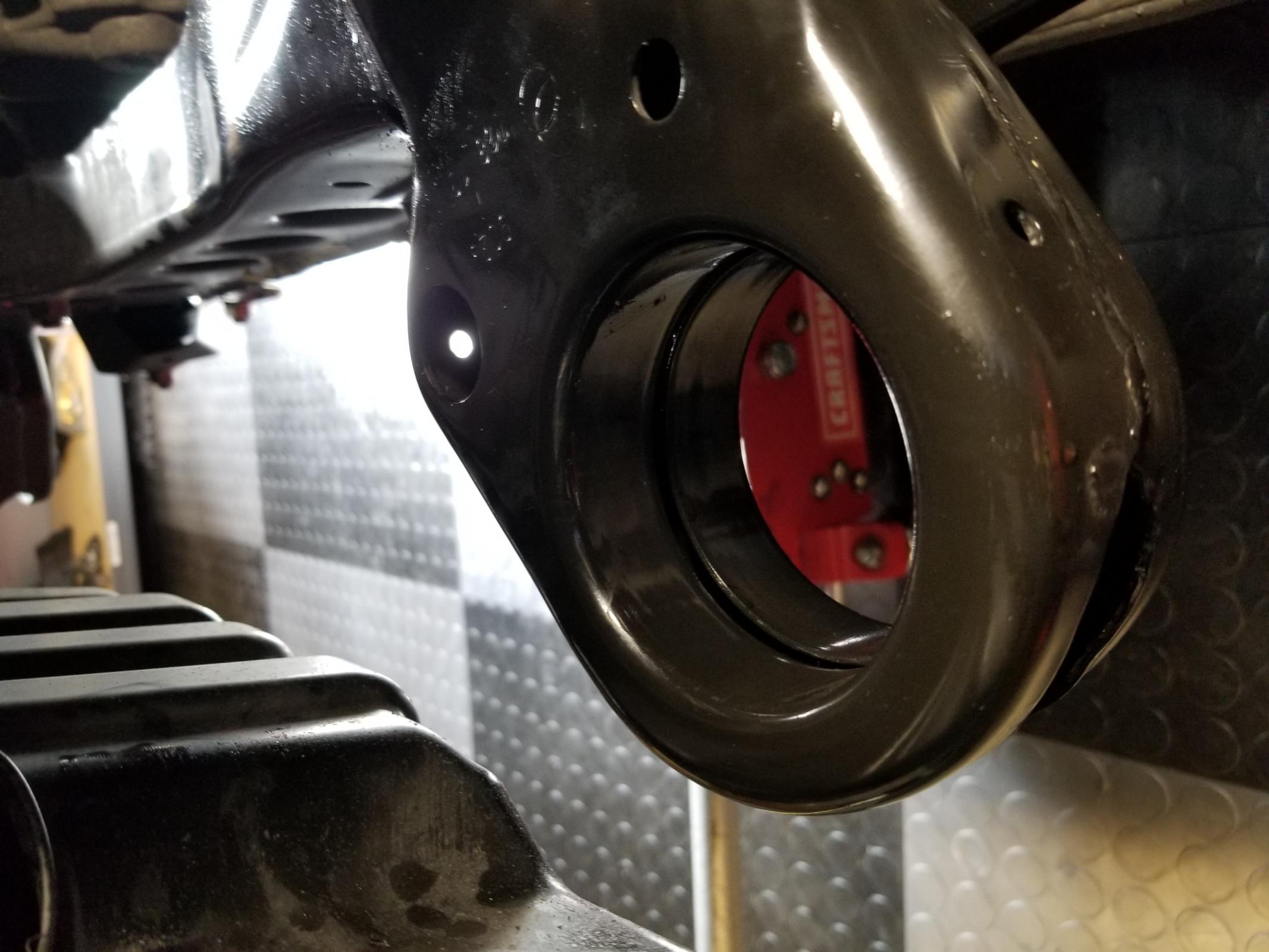

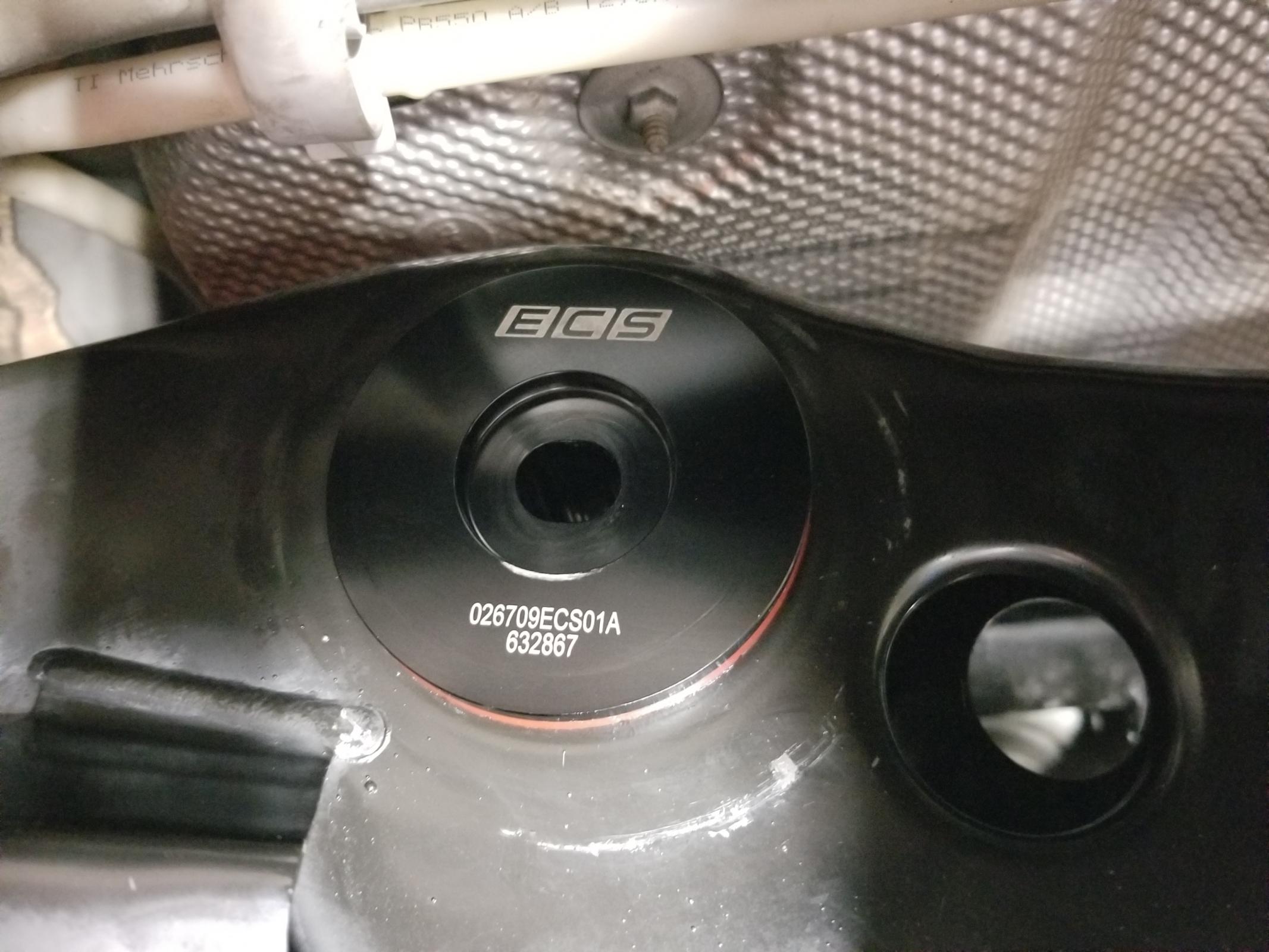

Solid subframe bushings in. That was not a fun job.. now onto the diff bushes.

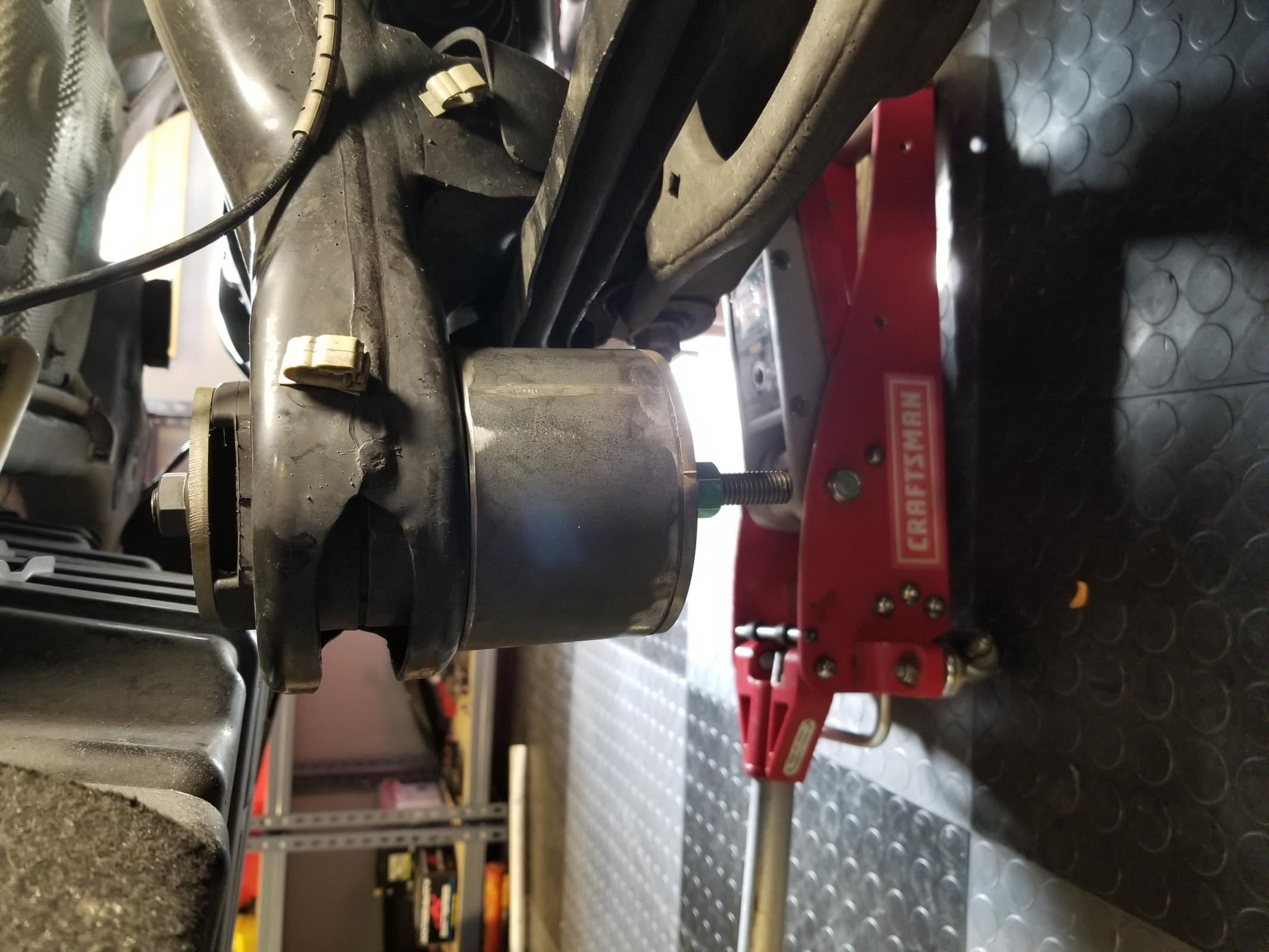

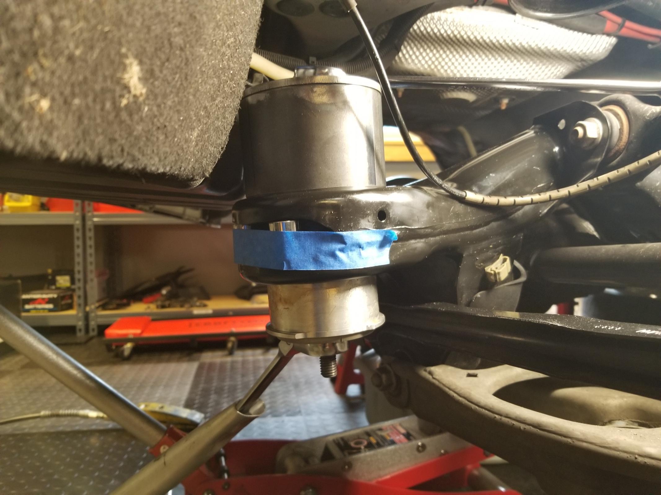

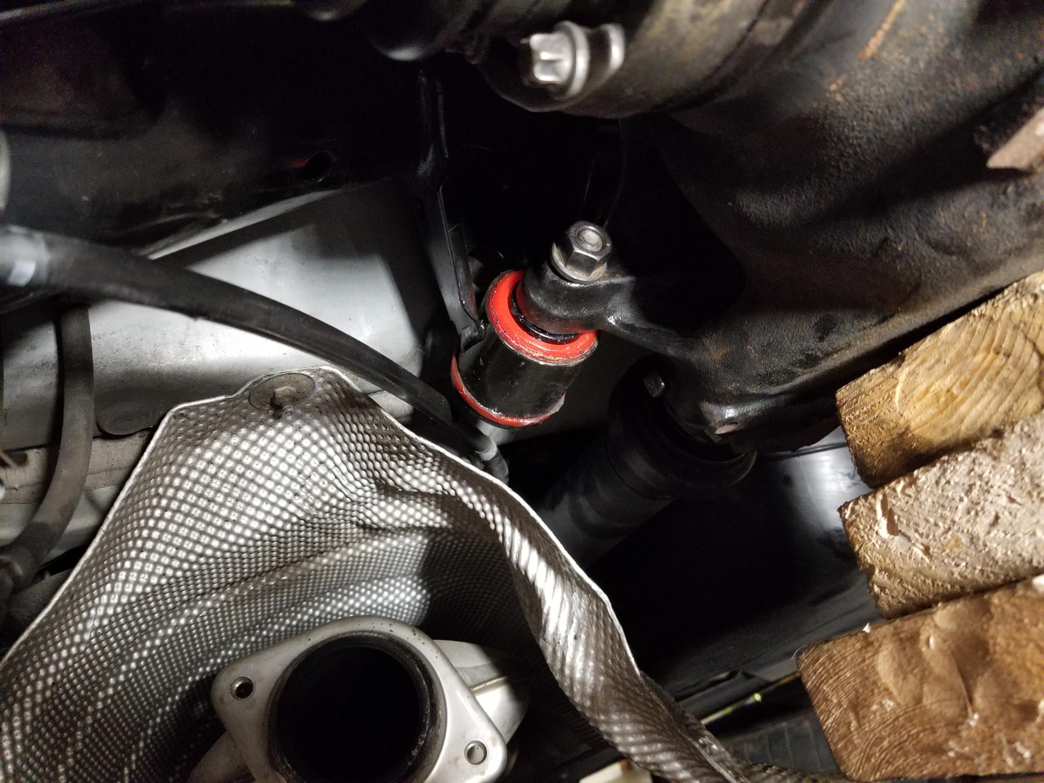

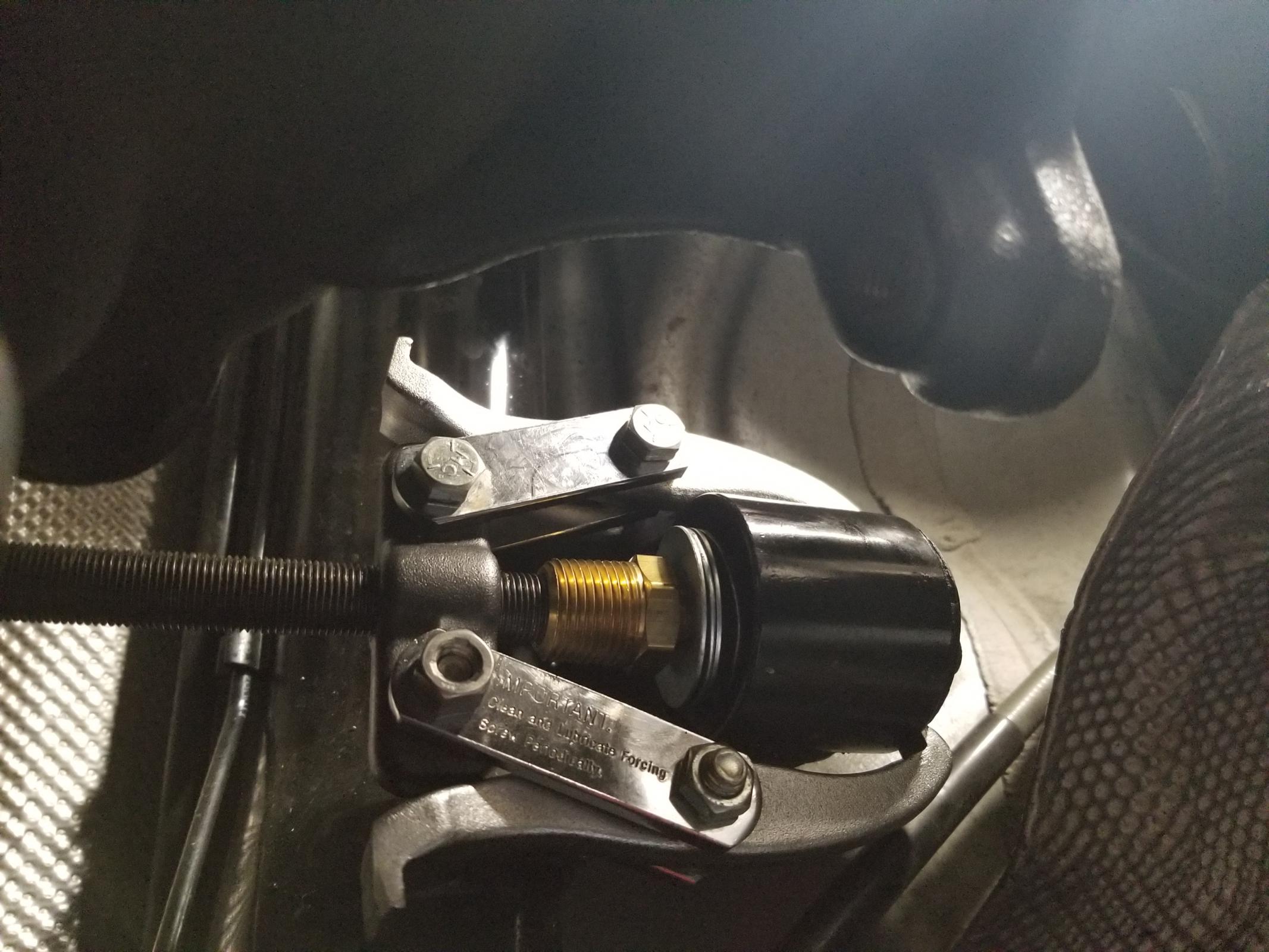

Rear diff bushing is out. Not sure how I'm going to get the front ones out yet since there isn't much support for the cup tool I'm using.

That was a tough job, but all the bushings are in. Now for a short vacation, then I'll get the coilovers in when I get back.

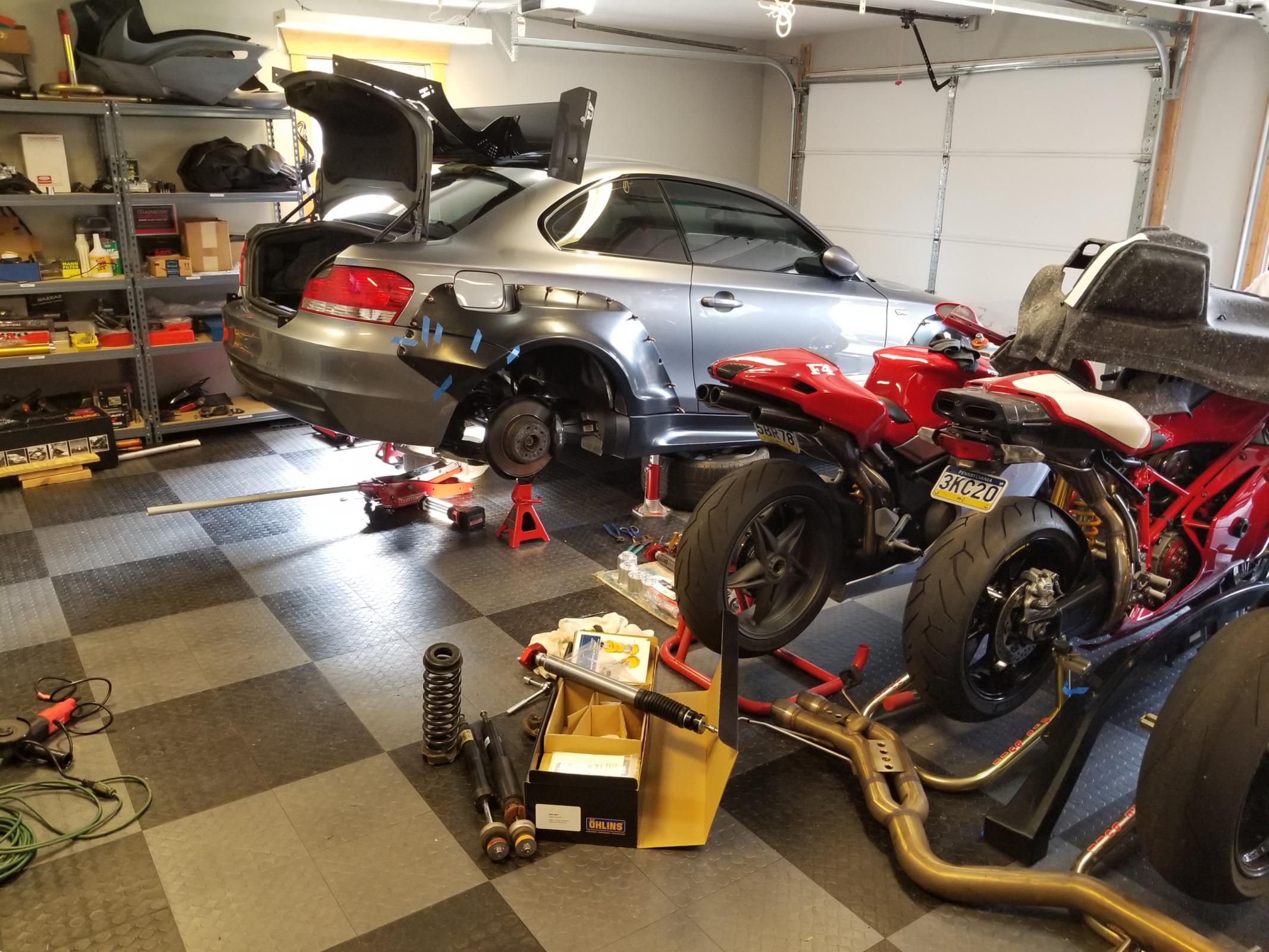

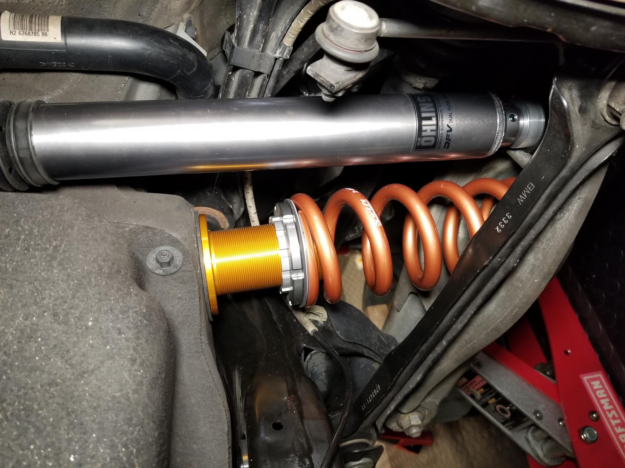

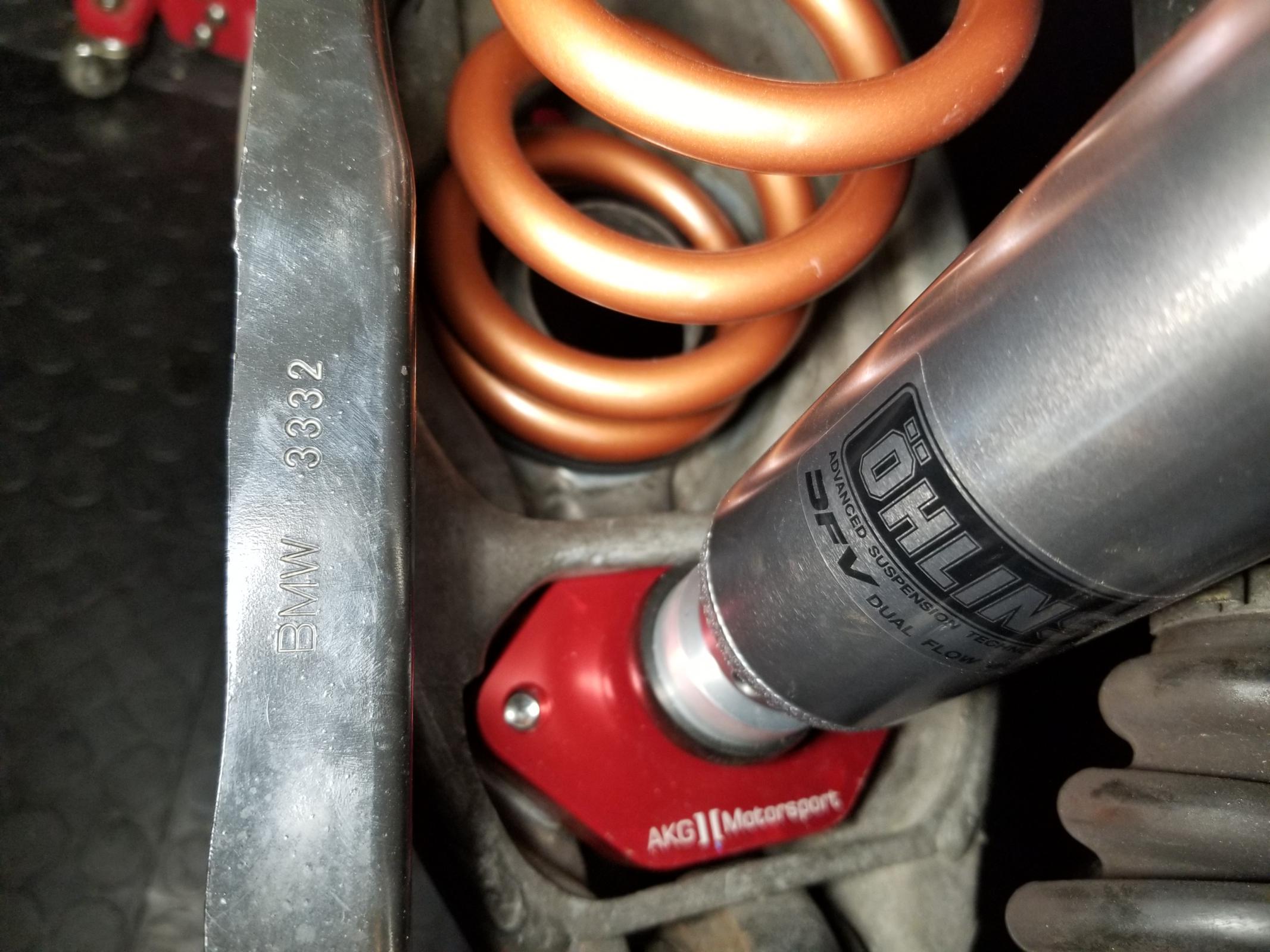

I have finally gotten around to installing the rear coilovers. Just waiting on new subframe bolts before I put the rear back together then move to the front.

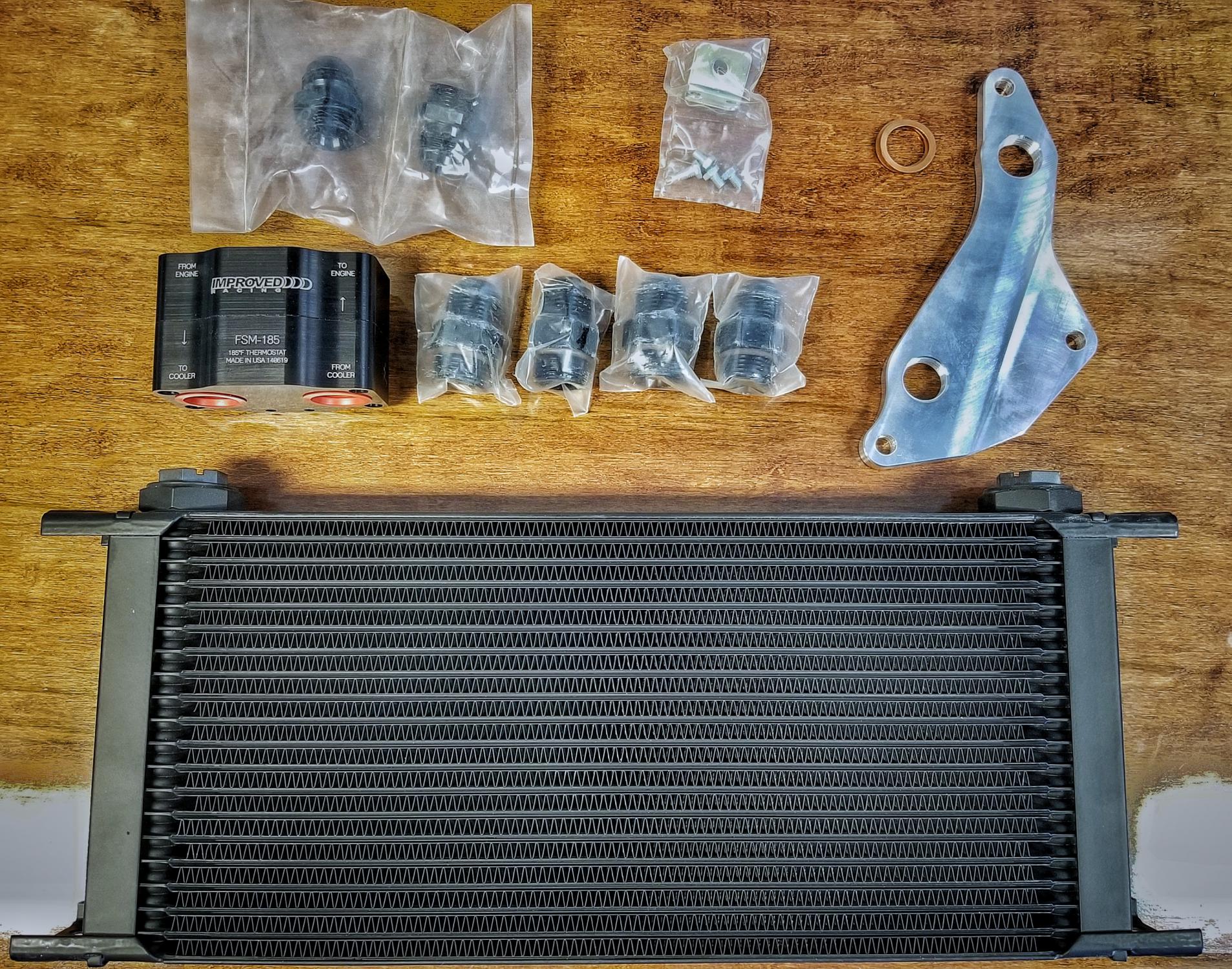

So I've had this Setrab 50-920-7612 oil cooler and IR 185F thermostat sitting on my shelf for a few years and I'll finally be making a custom mount for it. My plan right now is to place it on the diver side in series with the stock cooler.
