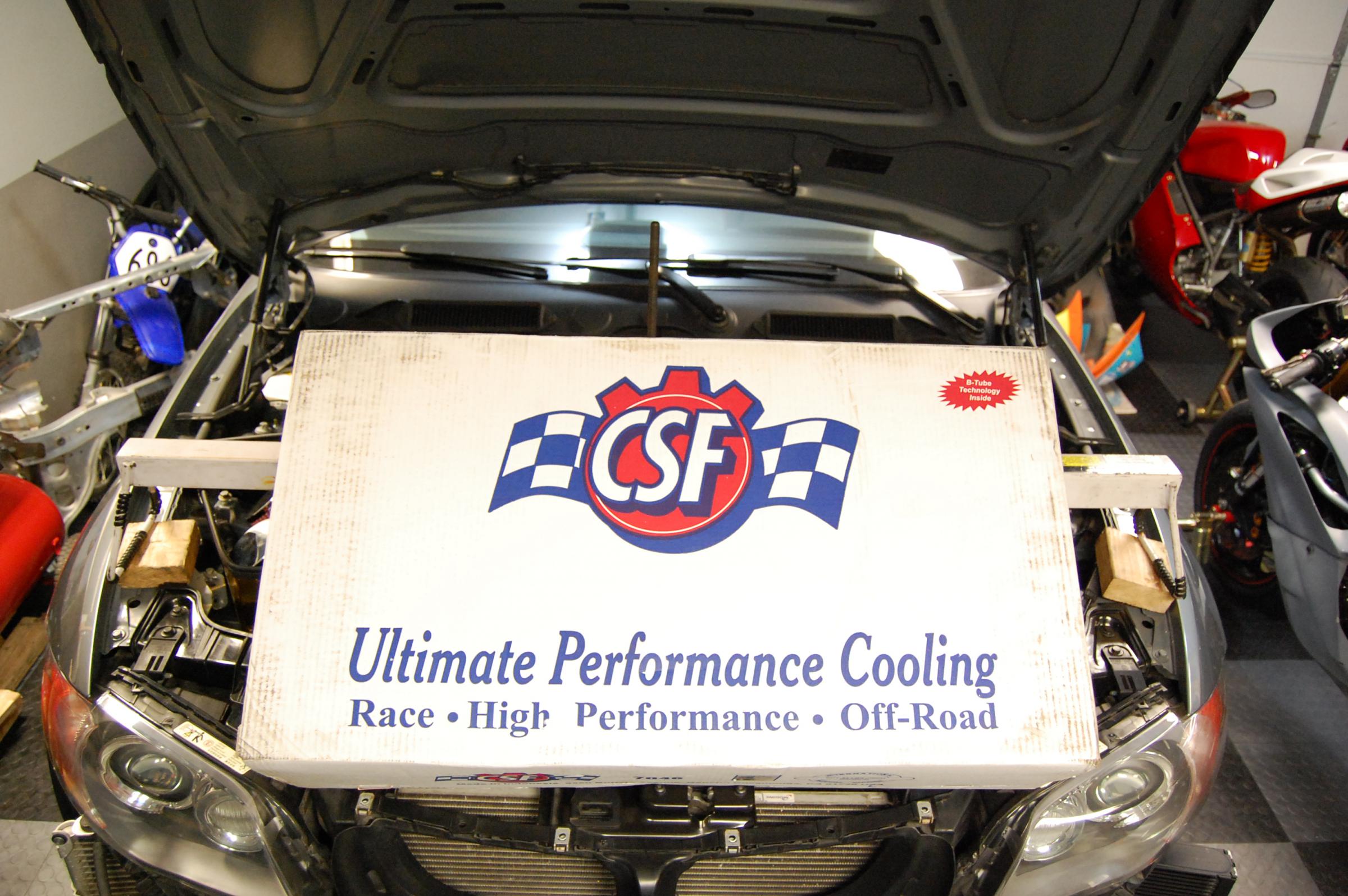

CSF radiator finally came, only took 6 weeks. Just waiting on my Turner expansion tank (hopefully ships this week) and I can start putting everything back together and get it fired up.
Is the CSF radiator a direct fit? Are you using the factory fans and shroud? Thanks!

Yes it's a direct fit, but it's tight. Since I relocated the inlets there's a bit more room on my setup.
