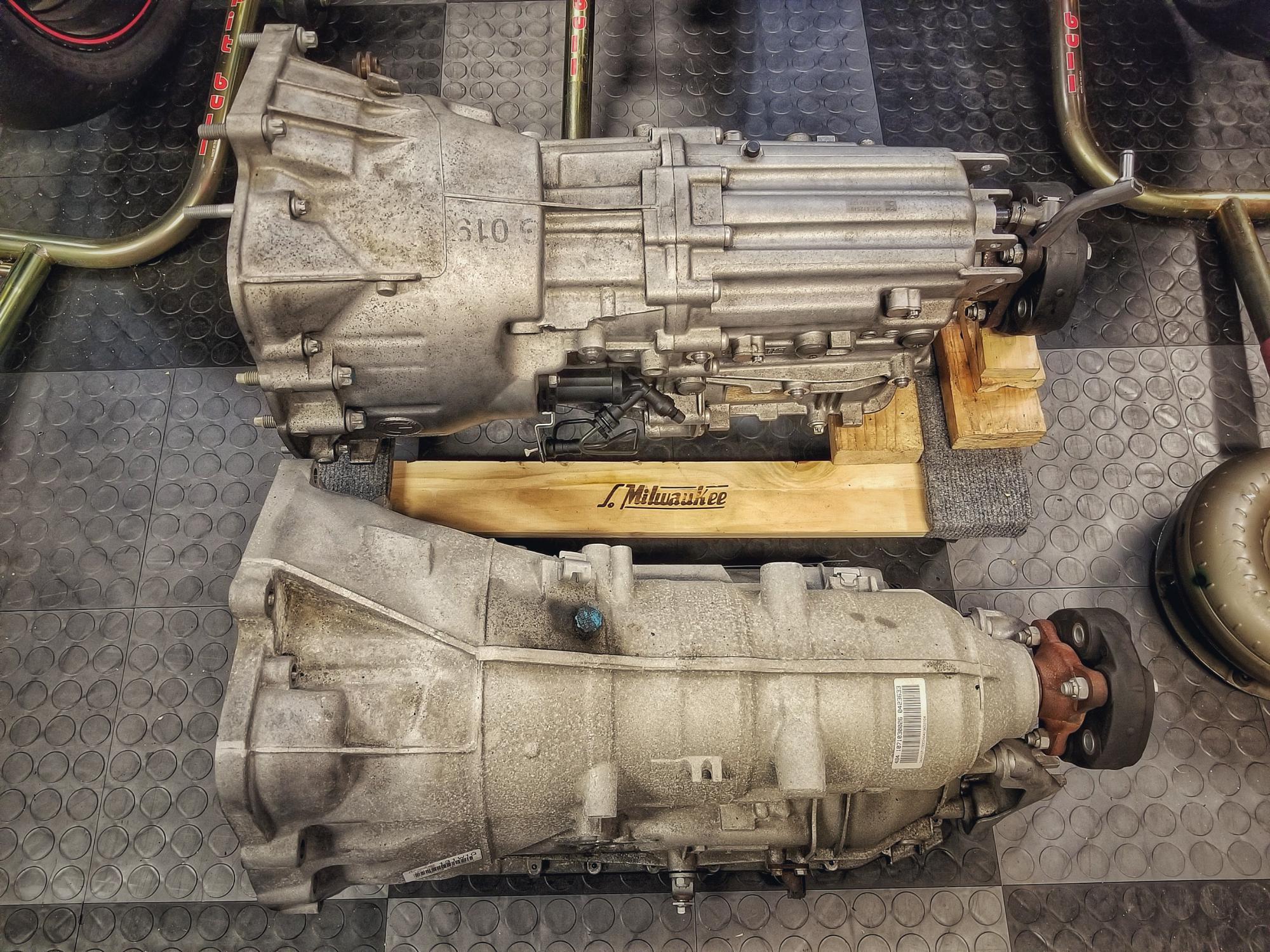

The beautiful GS6-53BZ MT showed up today. I've got almost everything I need to do the swap so I'm going to start removing the AT this weekend.

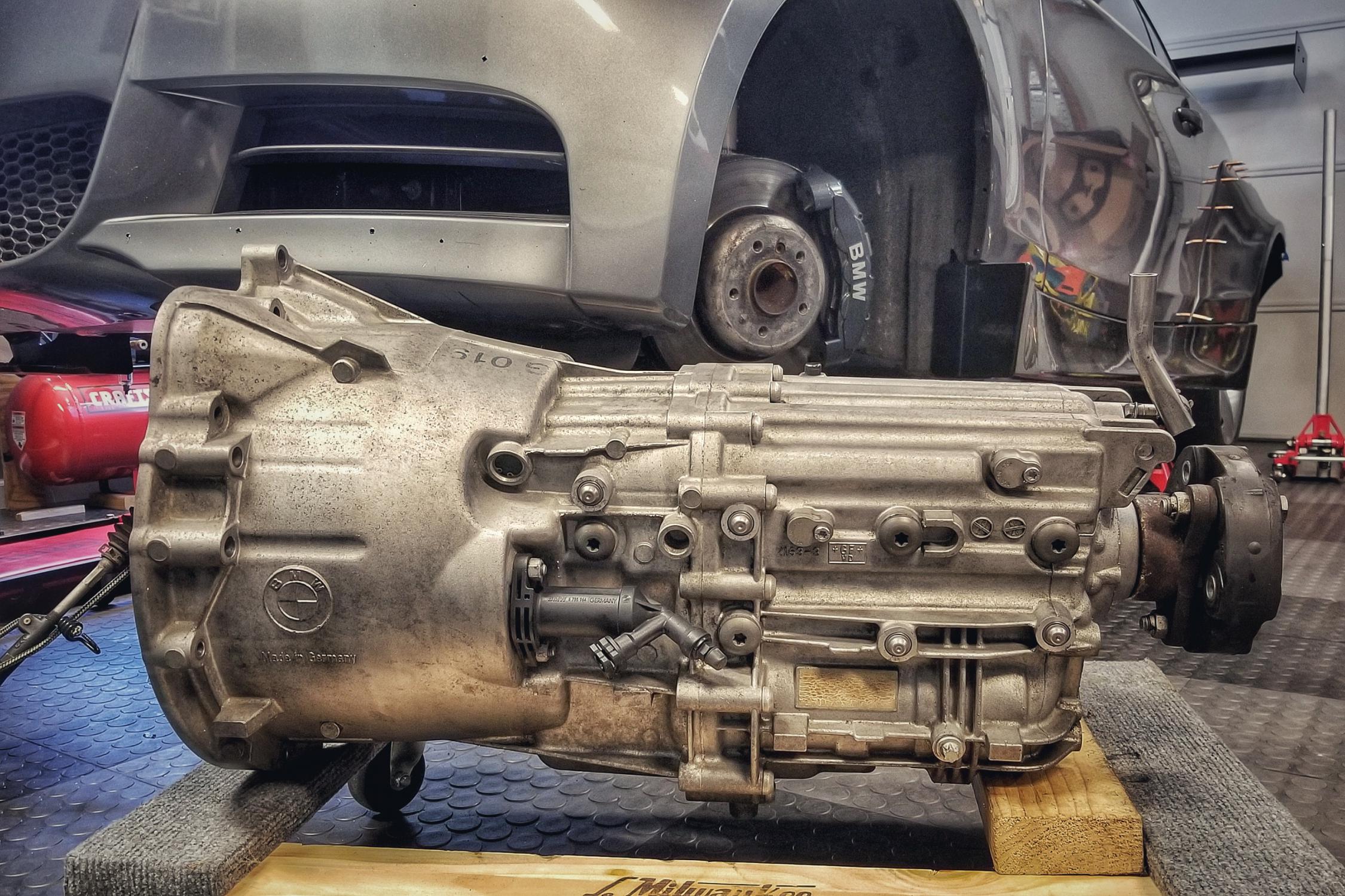

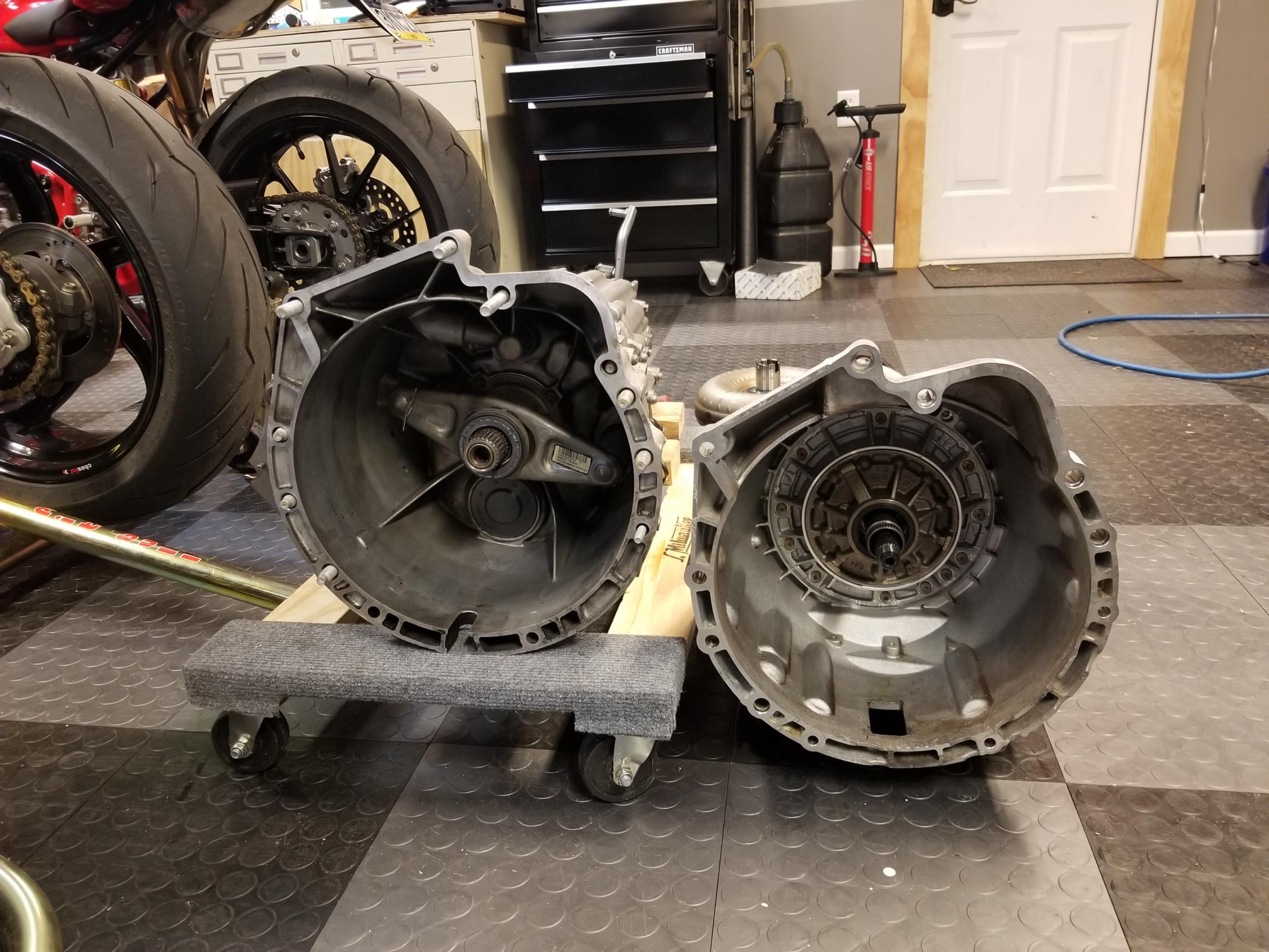

Auto trans out, took about 6 hours. Getting to the trans/engine bolts was the hardest part. Just waiting on the clutch and flywheel now.

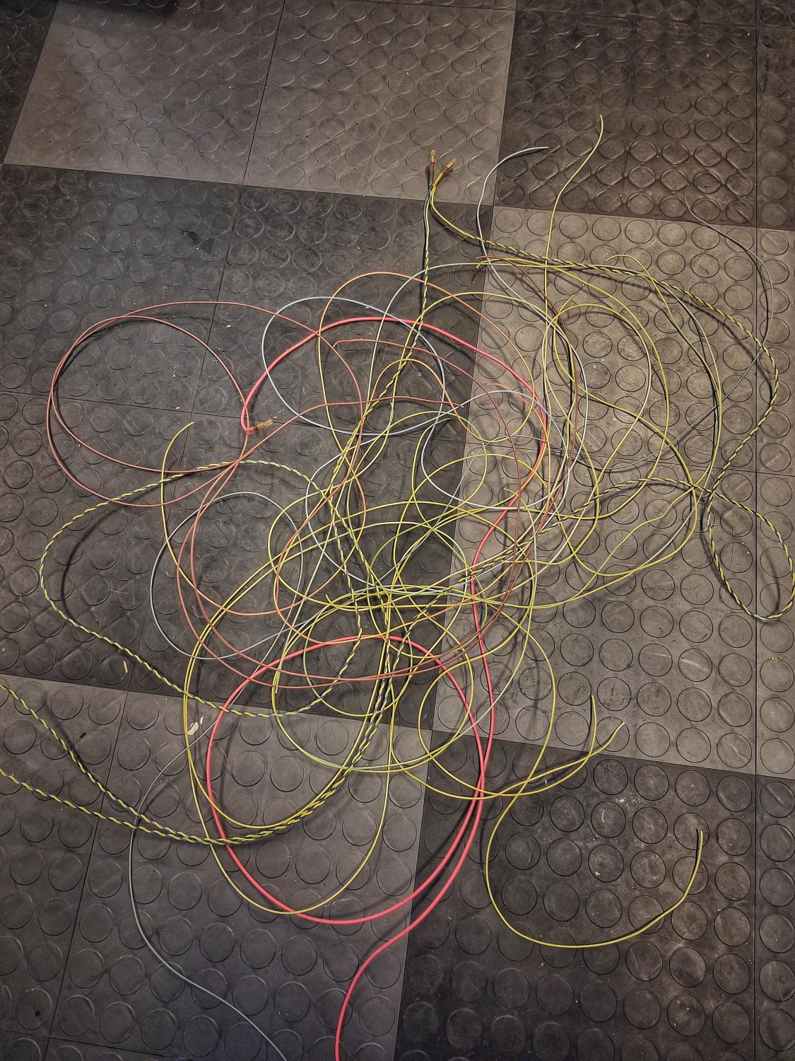

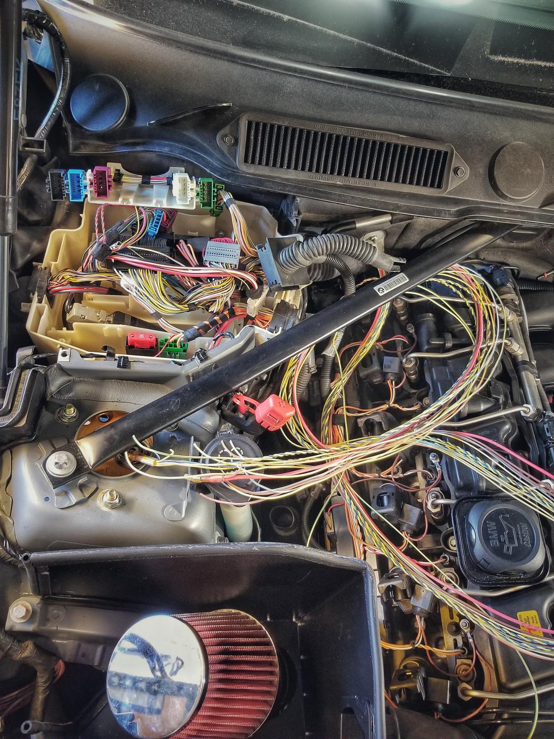

Removing the AT wiring harness.

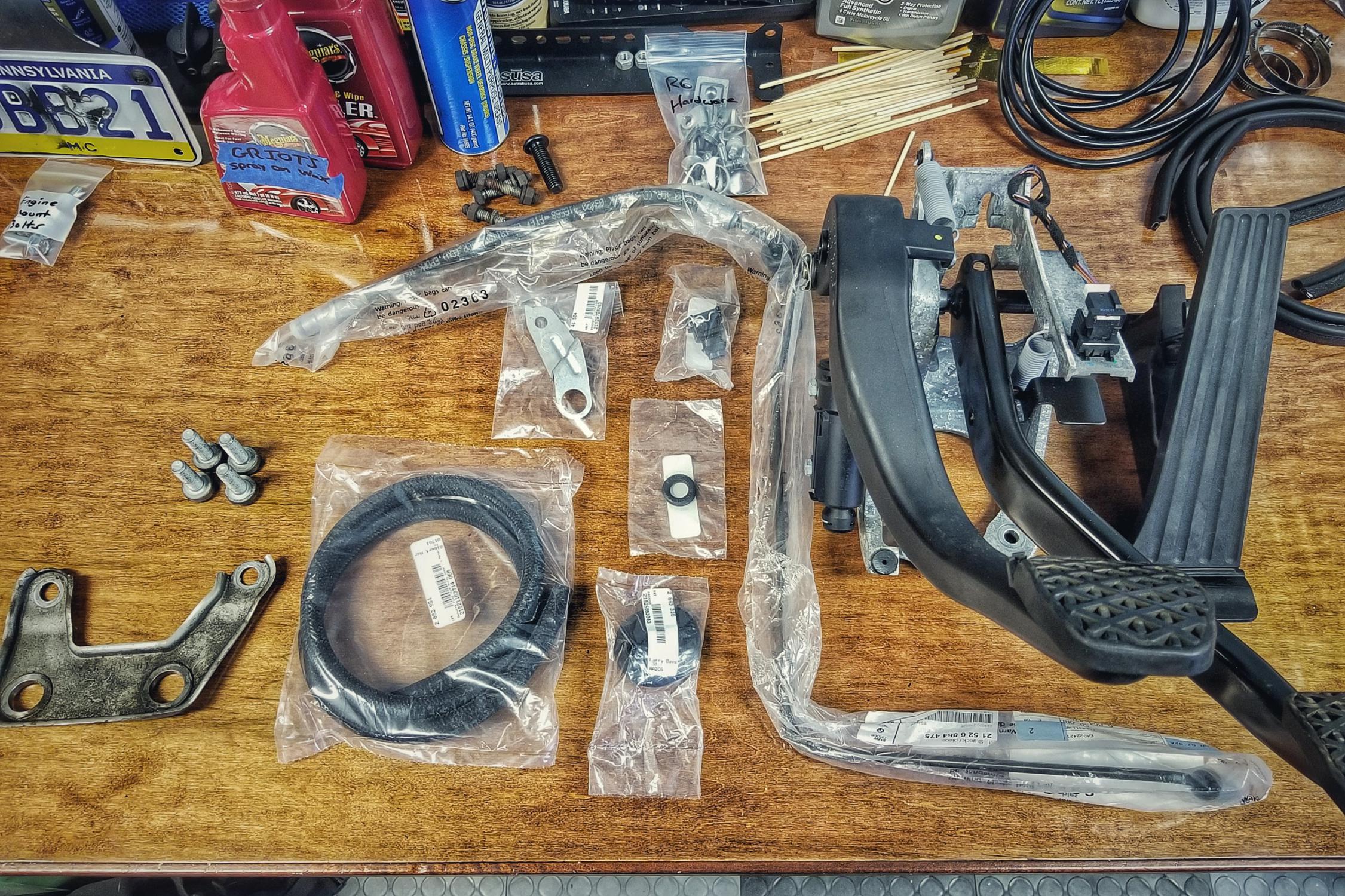

Still waiting on the clutch, shifter linkage and some brackets/misc parts.

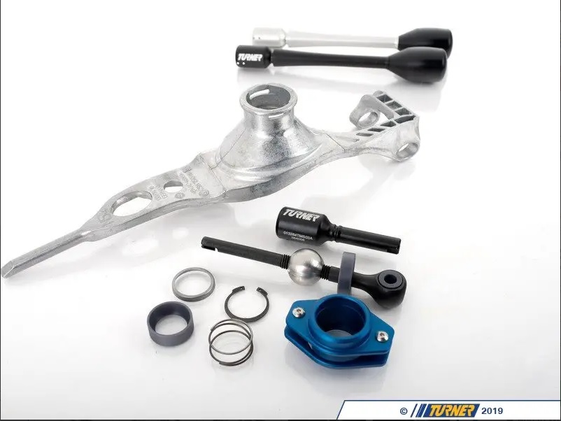

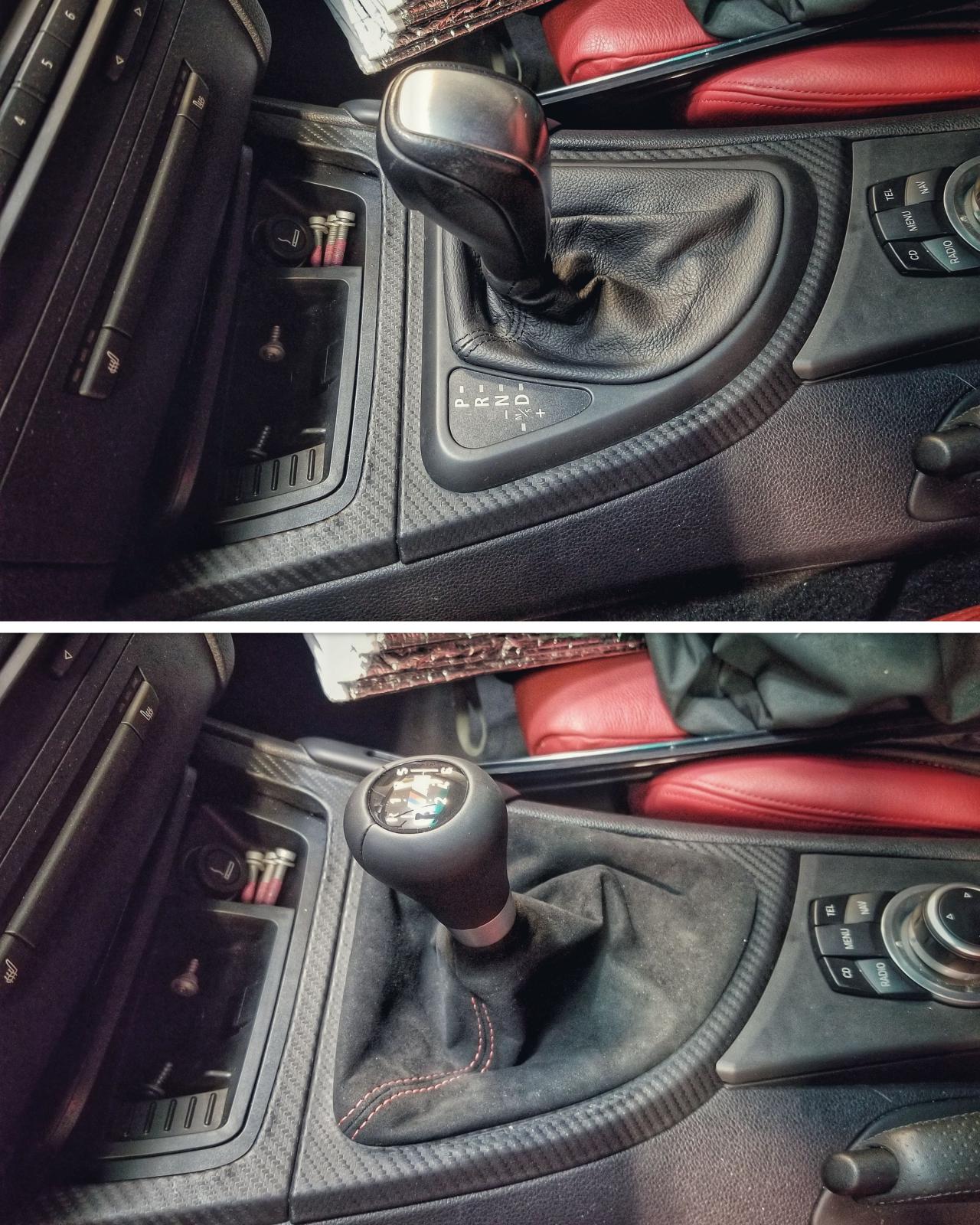

Thanks, yes I was actually considering the RTD short shifter, but ended up buying the Turner adjustable short shifter and upgraded bushings. I figured this would be a good option to start with, and I can always upgrade to a self-centering shifter down the road if I feel the need. Wondering if I should upgrade to the UUC DSSR while I'm at it.

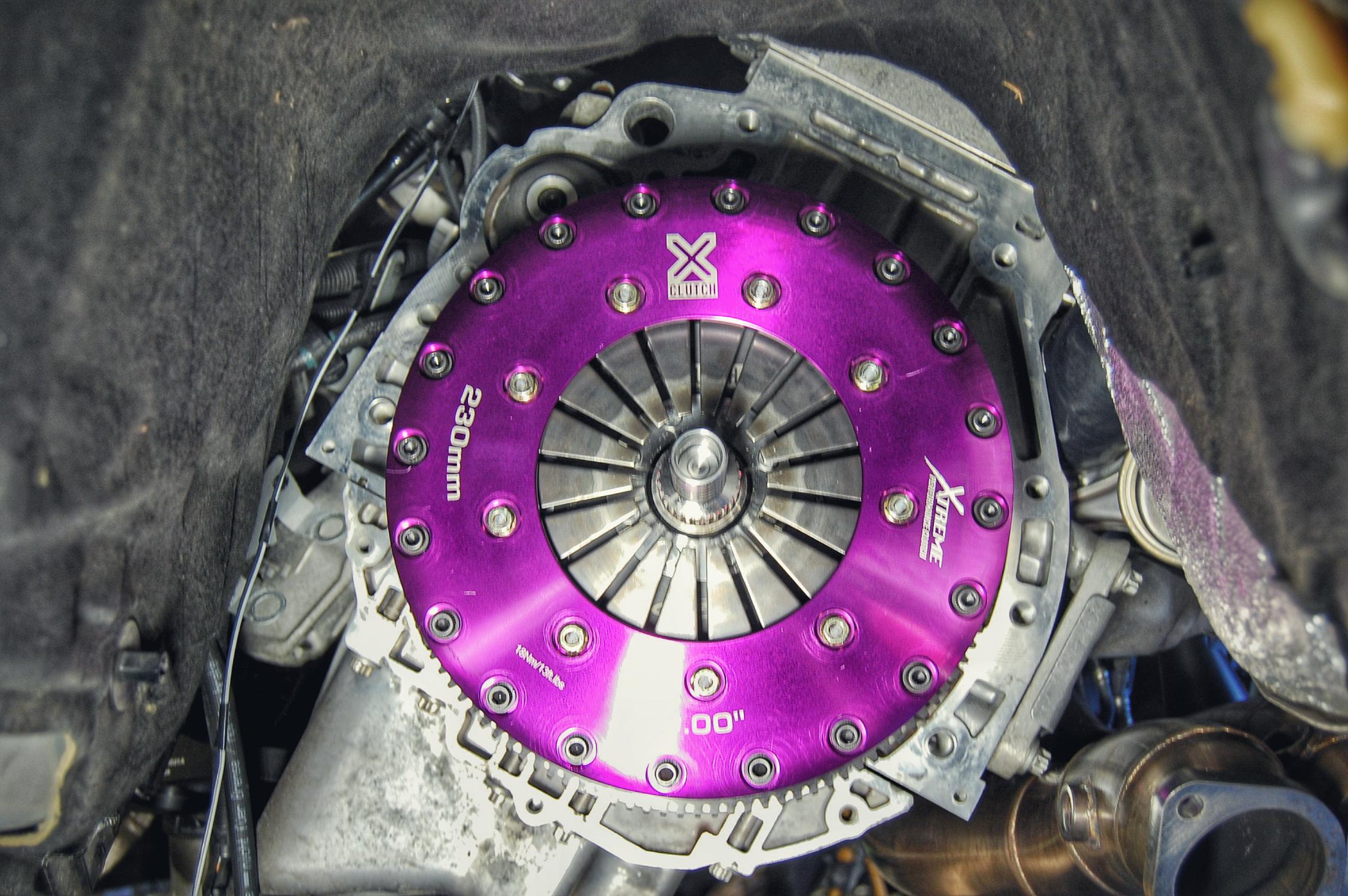

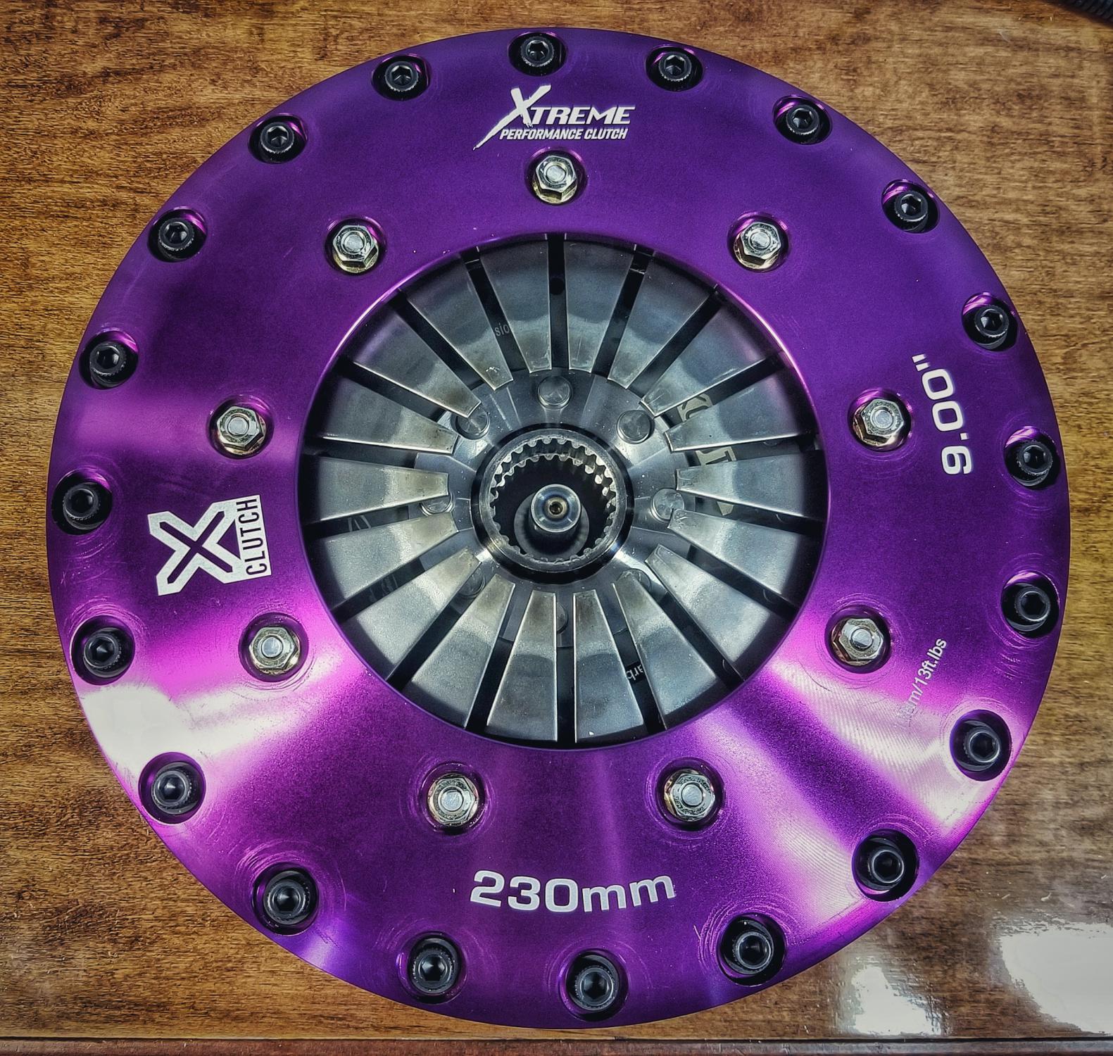

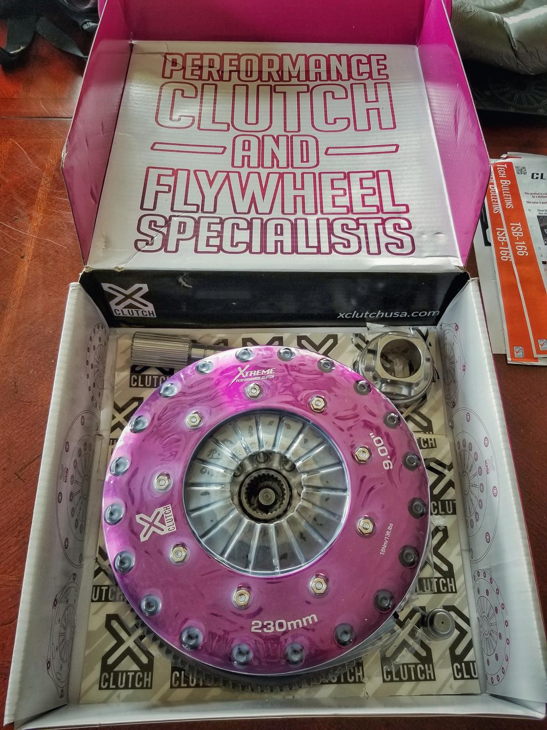

The 9" Solid Organic Twin Disc Clutch from XClutch showed up today. Most of the parts I need to finish up the trans swap and to get the motor started keep getting pushed out so may be a while before the next update..

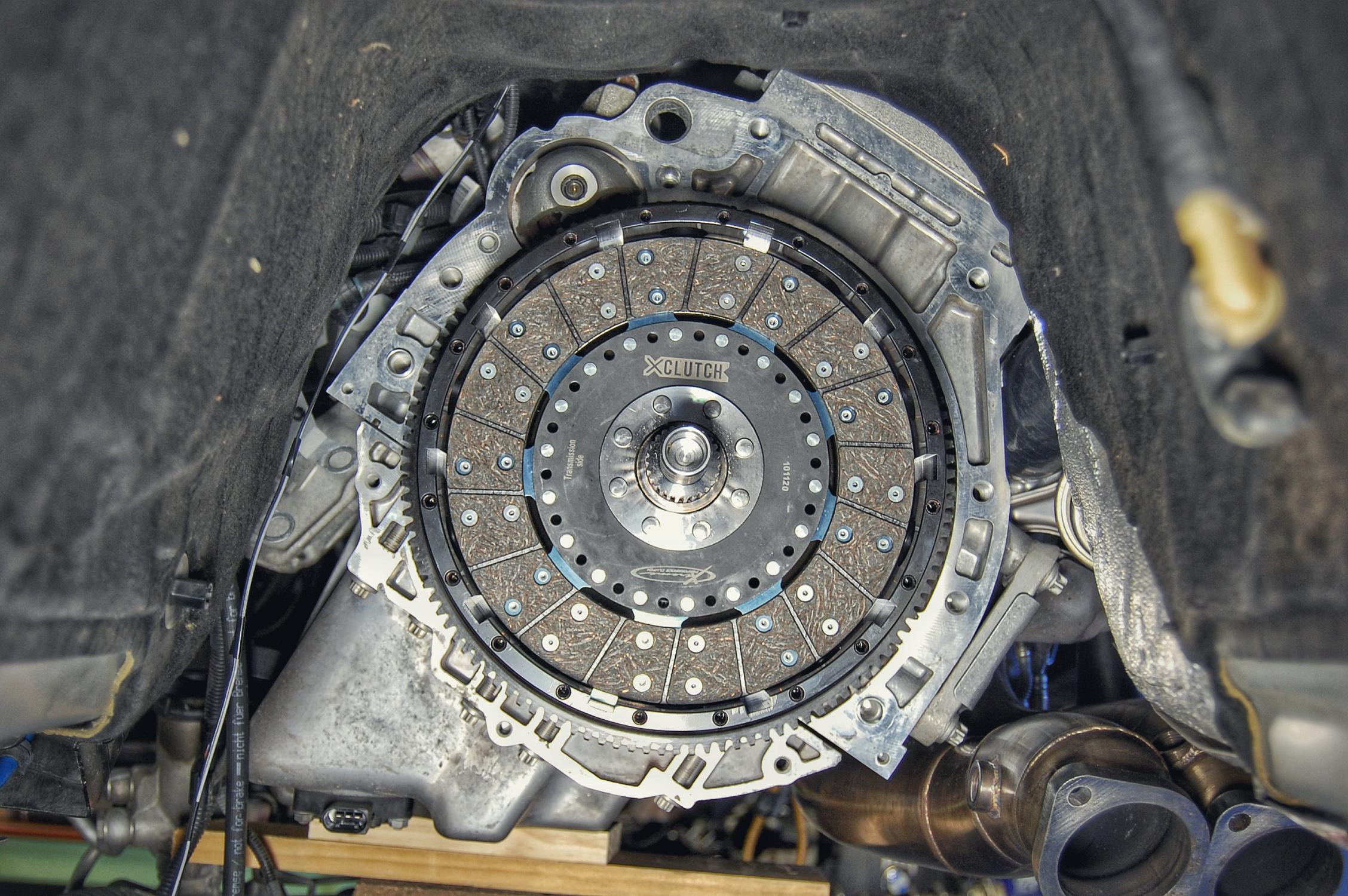

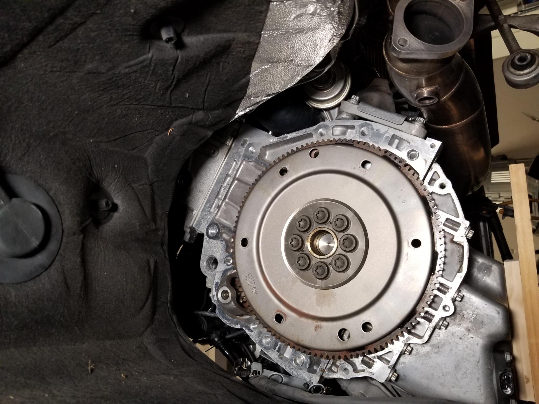

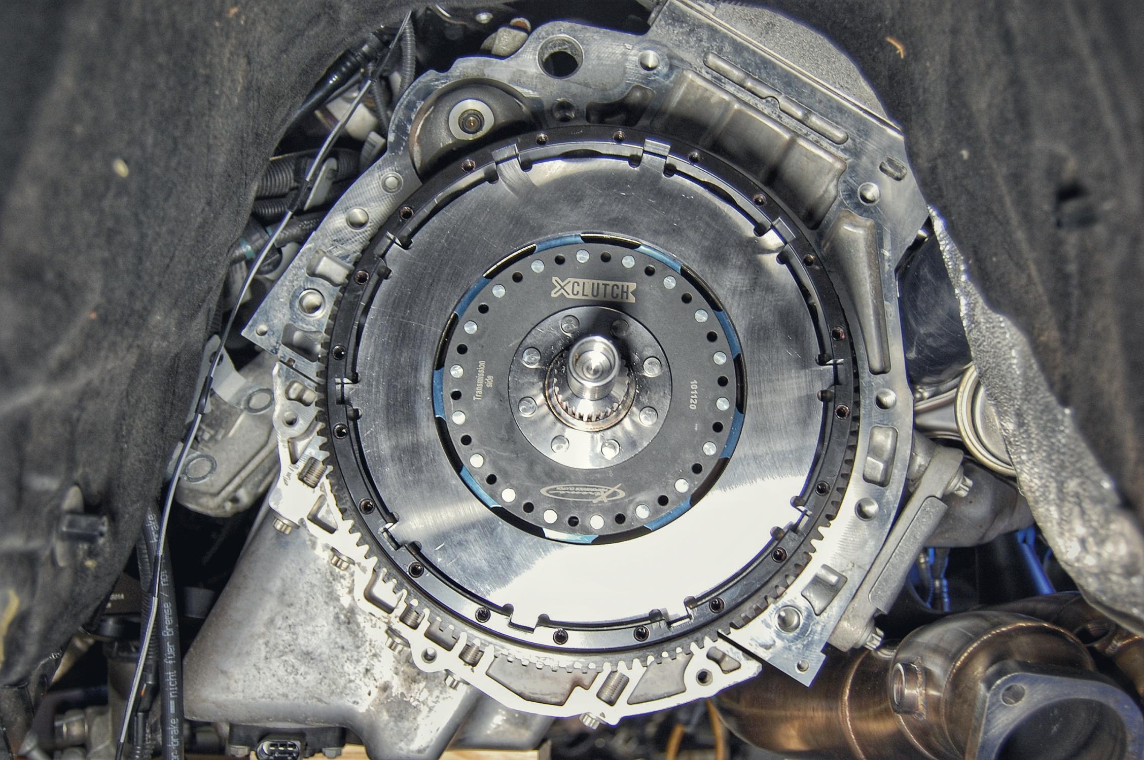

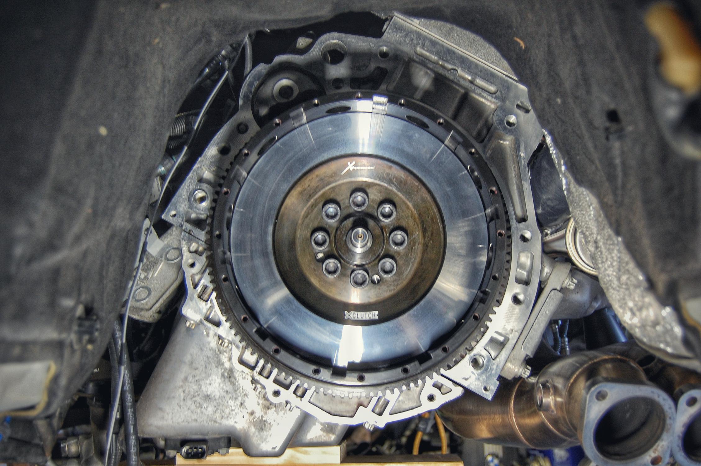

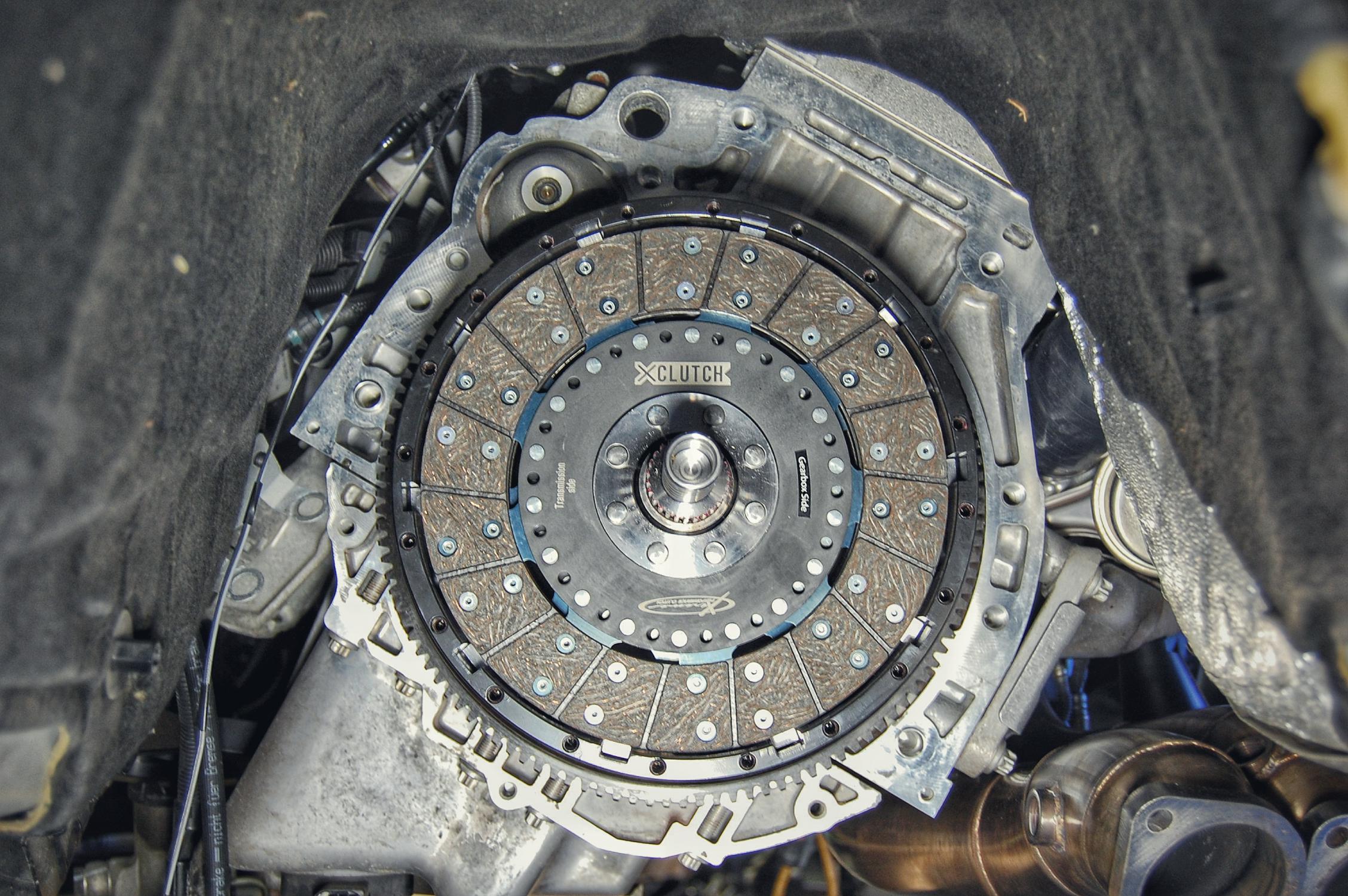

Bye bye torque converter, hello clutch. I can finish the catch can plumbing and figure out where I'm going to relocate the vacuum canisters while I wait for parts..

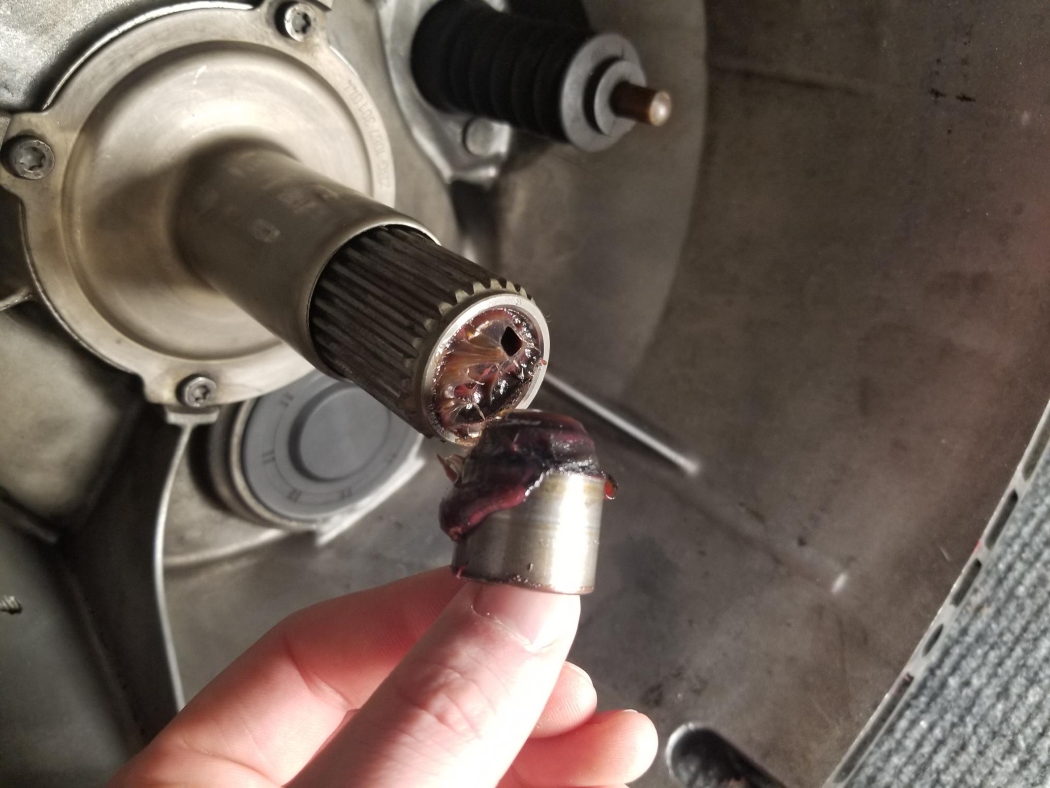

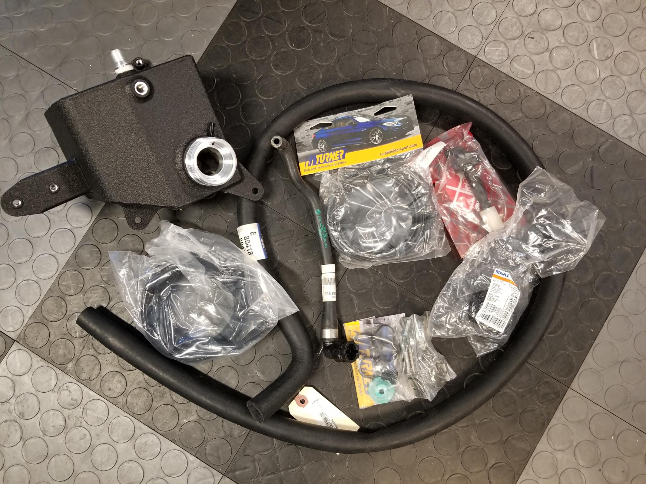

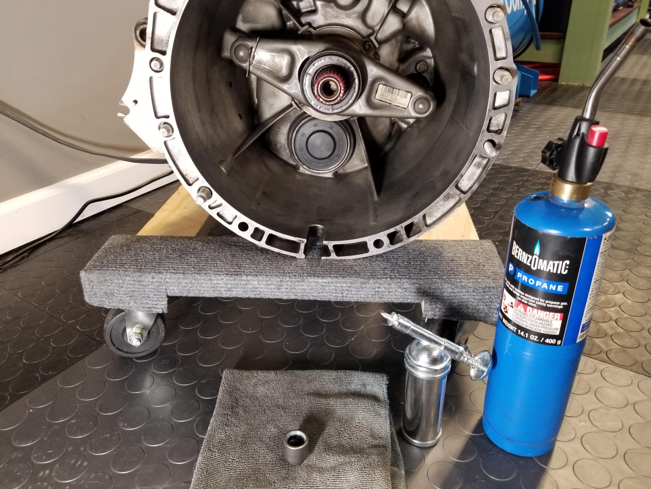

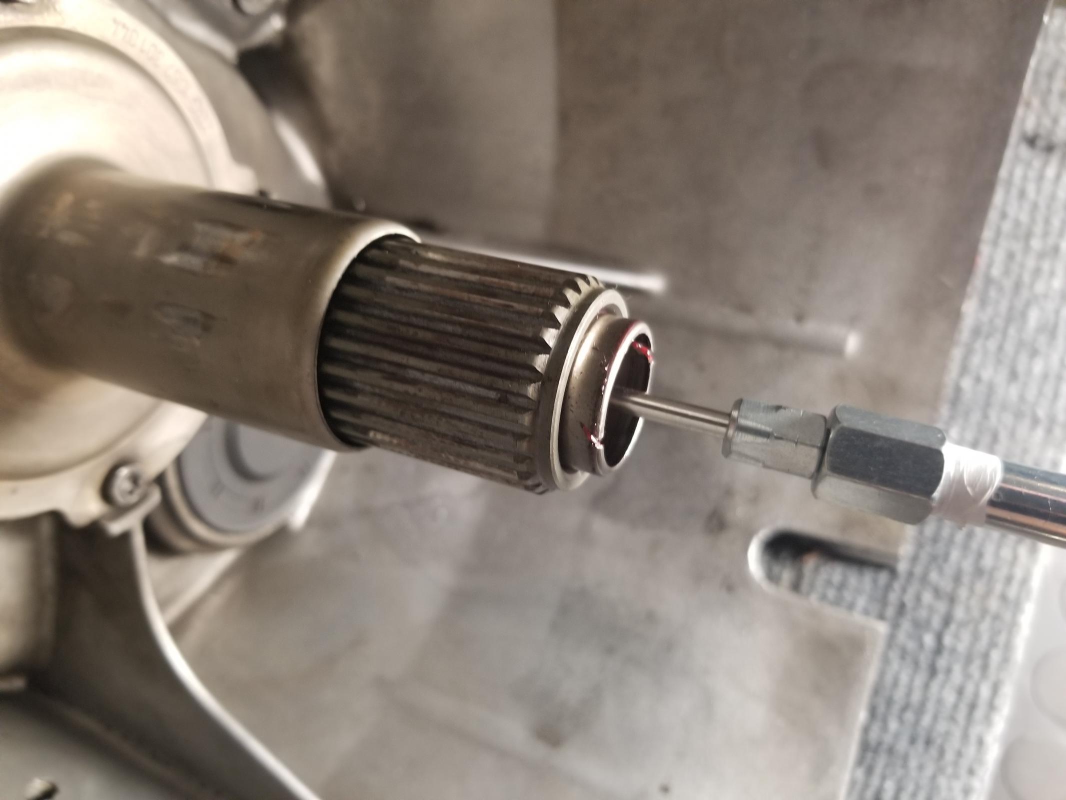

Turner expansion tank relocation kit arrived (ordered in Sept), and it looks like a few more parts shipped out. Hopefully I can make some decent progress this month.
Attempting to remove the pilot bearing using grease and Pascal's Law, haven't been able to get it to budge though. May need to get a lever actuated grease gun... Youtube made it look easy using this method...
Instagram: ///TheAxisGarage

      12-06-2021, 10:17 AM   #103
wdb
dances with roads
wdb's Avatar
5536
4,190
Join Date: Jul 2015
Location: the perimeter
Attachment 2757417
Why am I looking at the bell housing, etc? The pilot bearing should be in the end of the crankshaft, or in the flywheel...
      12-06-2021, 11:35 AM   #104
Dieselboy
Dieselboy's Avatar
503
283
Drives: '09 135i
Location: PA
This pilot bearing is located in the center of the transmission input shaft.
BMW PN: 21-20-7-536-792 - Clutch Pilot Bearing, Flywheel Bearing, Cylindrical Roller Bearing R 219900
      12-06-2021, 11:47 AM   #105
wdb
dances with roads
wdb's Avatar
5536
4,190
Join Date: Jul 2015
That's a first for me. What does it pilot into? Or maybe I should ask what pilots into it...

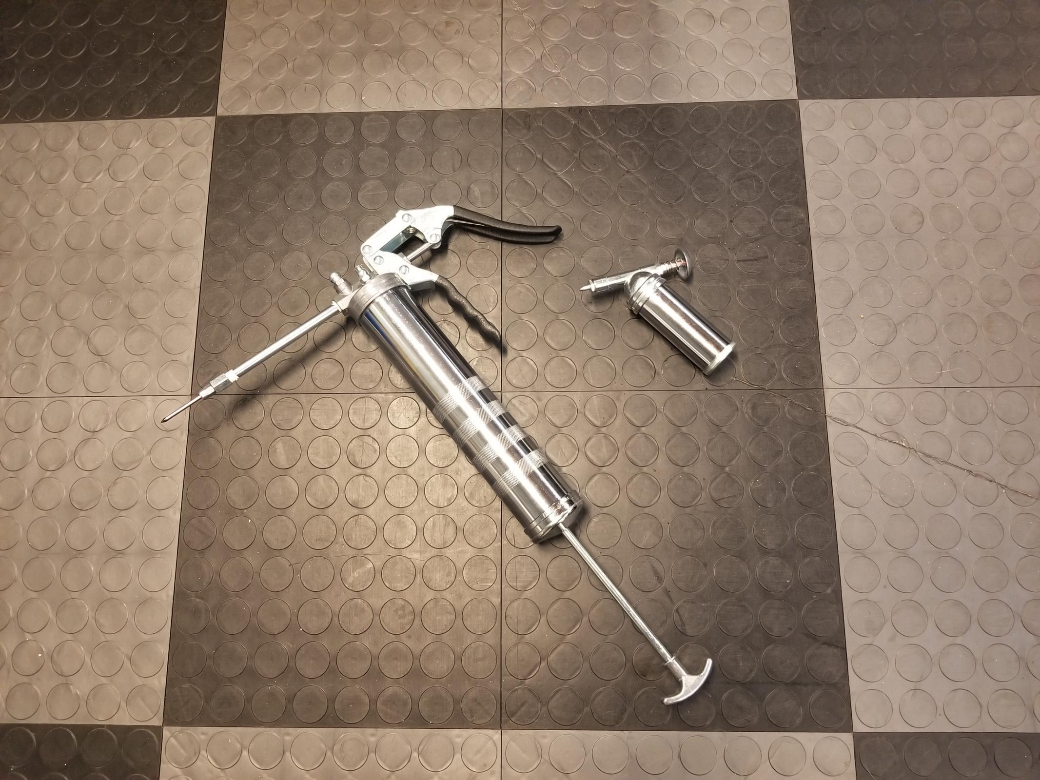

It pilots into the shaft on the flywheel. You can see it in the second photo in post #100.
Ok, had to bust out the big guns. Couldn't have been easier, 3 pumps and it popped right out. Always use the right tool for the job!
(You vs. the guy she tells you not to worry about)

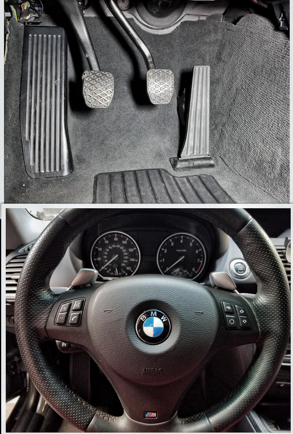

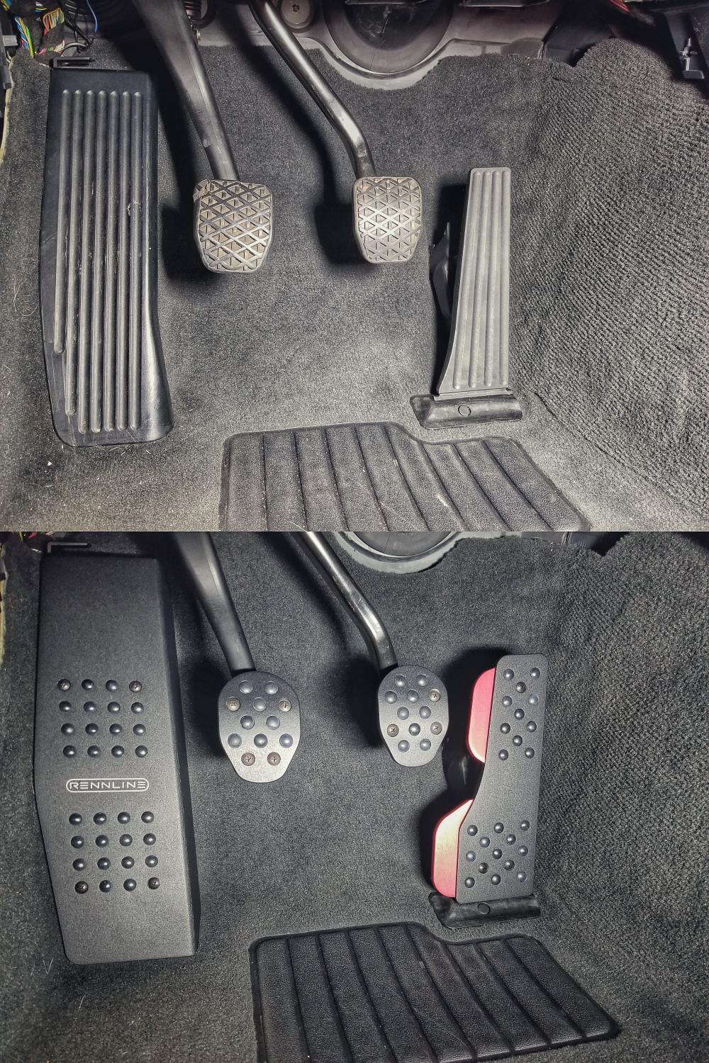

Random black friday purchase. I think they look good, and should make rev-matching downshifts easier.

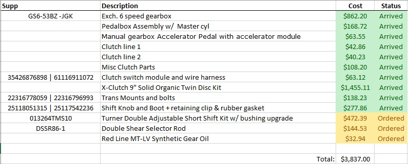

Originally Posted by Bari1695 View Post
Can you provide the part numbers used to convert from auto to manual? I’ve search the forums, but there isn’t any information in regards to the 1 series, specifically the 135i.
So, it's pretty much the same as the e90. Vehicular DIY made a great 3-part series on YouTube to walk you through step-by-step, this is the guidance I used for the swap. https://www.youtube.com/watch?v=szg15efwGzY
I plan to put together a DIY once I finish the swap. I'm still waiting on a few things before I put the trans back in and do the coding. Here is a list of what I ordered, not all the PN's are listed though. I used https://www.realoem.com/bmw/enUS/select to figure out the parts I needed.
Hope this helps.
