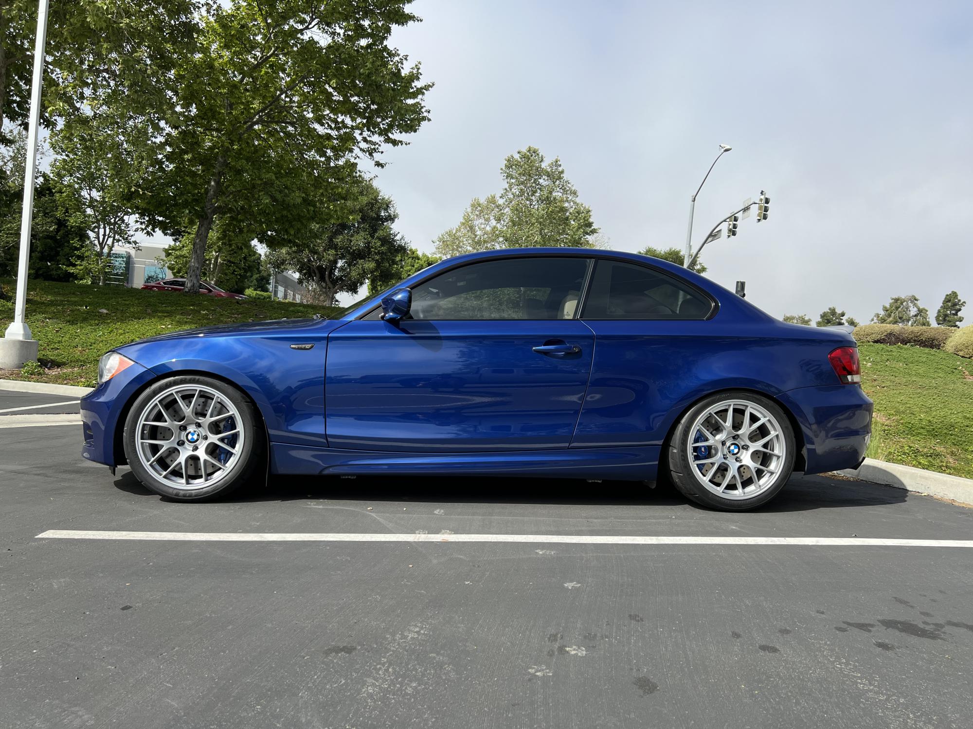

Measured my ride height from the rocker panels. Currently have a full tank of gas.
Rear measuring point is right behind the rear plastic jack pad: 6 5/16”
Front measuring point is right in front of the front jack pad: 5 13/16”
Both measuring points allow you to measure from the bottom of the car frame to the ground. I have been told by TC and HPA the rake front to rear should be about 3/4” and I’m at half inch. I can’t handle the look when it’s at 3/4” rake so looks prevailed in my case.
Adding a picture of my car so you can see how it sits.
