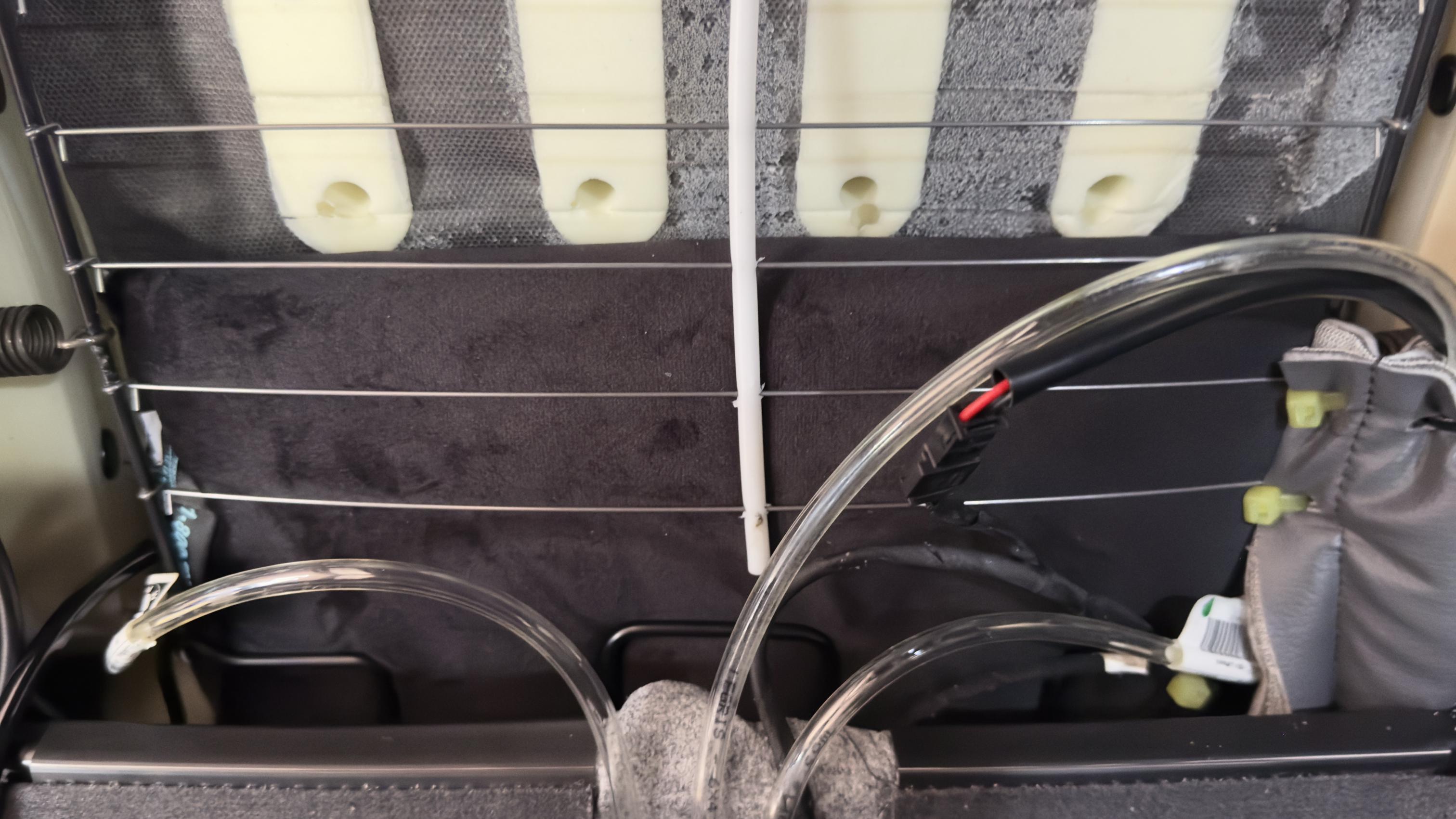

      06-17-2025, 04:37 PM   #18
Carpedonut
Drives: BMW 135i
Join Date: Jun 2025
Location: Washington DC
New install of lumbar support
Came across this thread yesterday when I decided that after almost two years with my seat torturing my back, it was time to do something. After looking at all the exotic and expensive options, I determined that cheap and fast was the way to go.
Ordered this on Amazon, and took all of 10 or so min to install. Once the seat back cover was off, just unhooked one of the springs from the mesh to make room to shove the pad in, rehooked the spring, fed the pump down the bottom, closed it up and done. $42 to solve the problem.
javinci54.50
