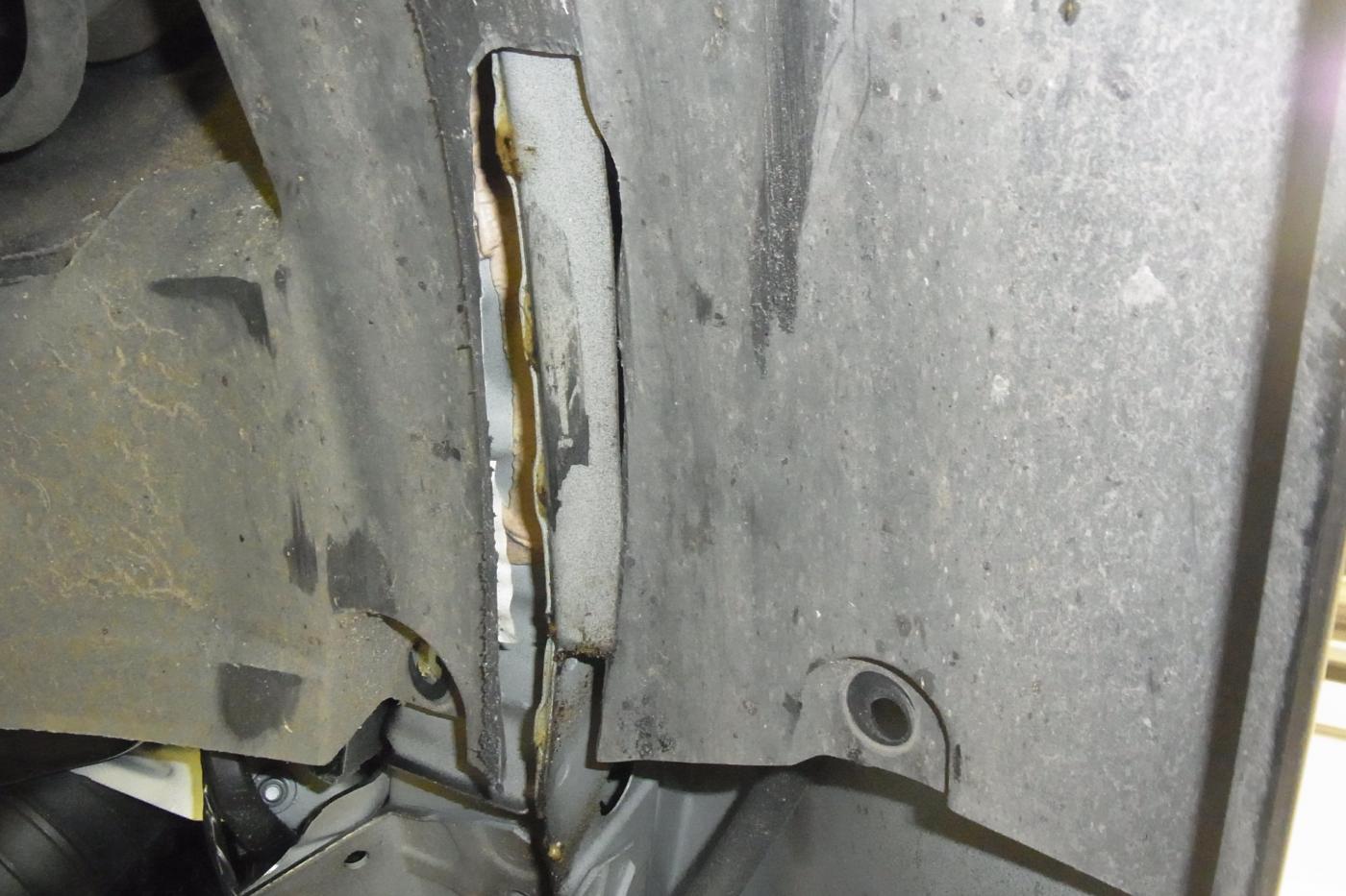

Yep, that is what mine look like.

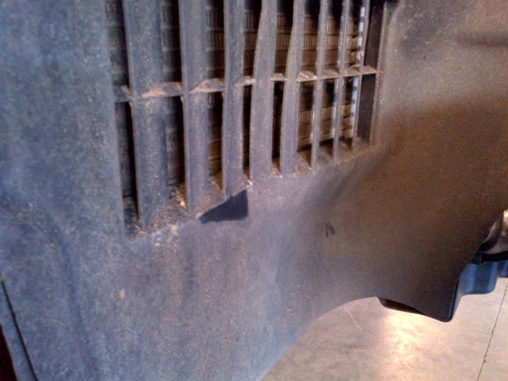

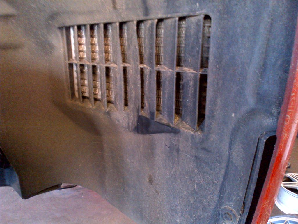

Originally Posted by Pete_vB View Post
If you're talking about deformation on the middle 3 fins then yes, that is molded in.

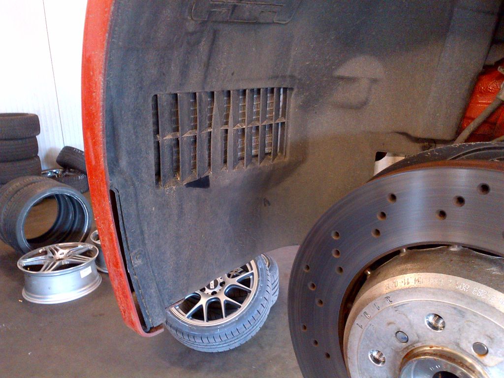

Affirmative: different design of the middle three fins/notches + indent is OEM. Below some pictures (June 2011 build). Small black triangles at the bottom of some fins/notches: tell-tale signs of the "love story" between front tires and fender liners...
Front left:
Front right:

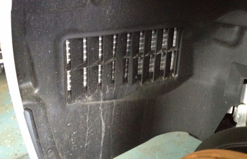

Originally Posted by Papethova View Post
Then I guess its safe to say its not a new part but rather a different mounting position. Hopefully we can figure this out before my wheels come in and I have to cut to fit.
Actually, so far no clarity about that. Anyway, as for now, the heat gun might be your 1M's clearance friend (but do handle with care). At least resolved the clearance issue on mine.

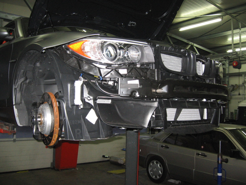

Below two pictures posted on the German 1M forum (the second picture is of an early 2012 build 1M). Do you see any difference in design and/or mounting ?
(source: http://www.1erforum.de/bmw-1er-m-cou...ml#post1438743)
(http://www.1erforum.de/bmw-1er-m-cou...ml#post1438926)

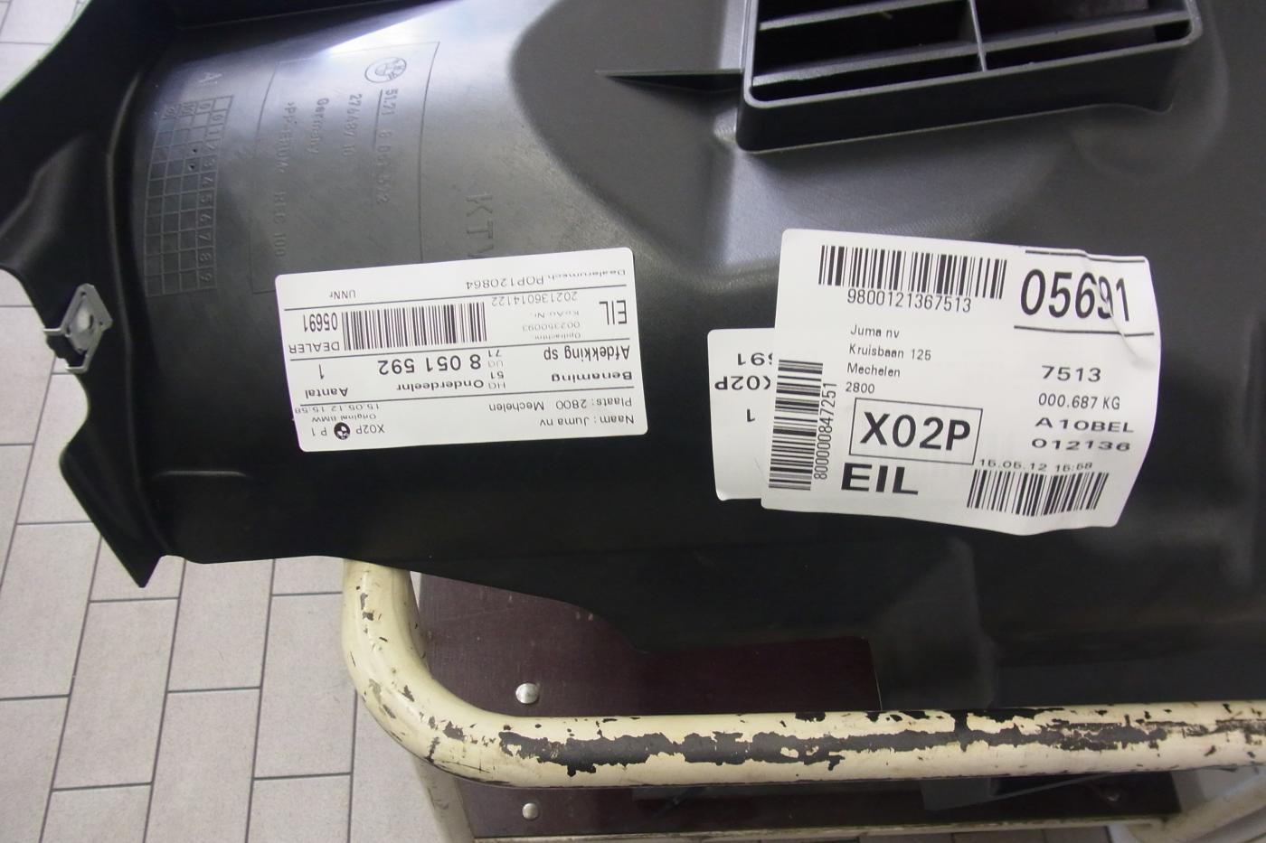

Thanks in advance for checking also the following during the replacement:
Any change in part numbers ?
  • front left = part# 51 71 8 051 591
  • front right = part# 51 71 8 051 592
Any change in shape or its mounting holes (see picture below) (note the indications "E82M L" and "E82M R"):

I had my front liners changed today under warranty.
The parts have the same code but no changes in the moulding form or mountings.
So bottomline much a do for nothing.

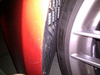

But I have some other serious probs. The upper and back liners at the front wheels showed some major holes due to wheelrubbing. I think this could be related to tracktime @ Spa. I've noticed a hole in the left wheel liner whereas there was none on the right side and Spa track has more right curvers/corners.
Pic below shows rubbing and bare metal

Quite worrying to see the merciless impact on the fender. Also does not seem healthy for the tires longevity.

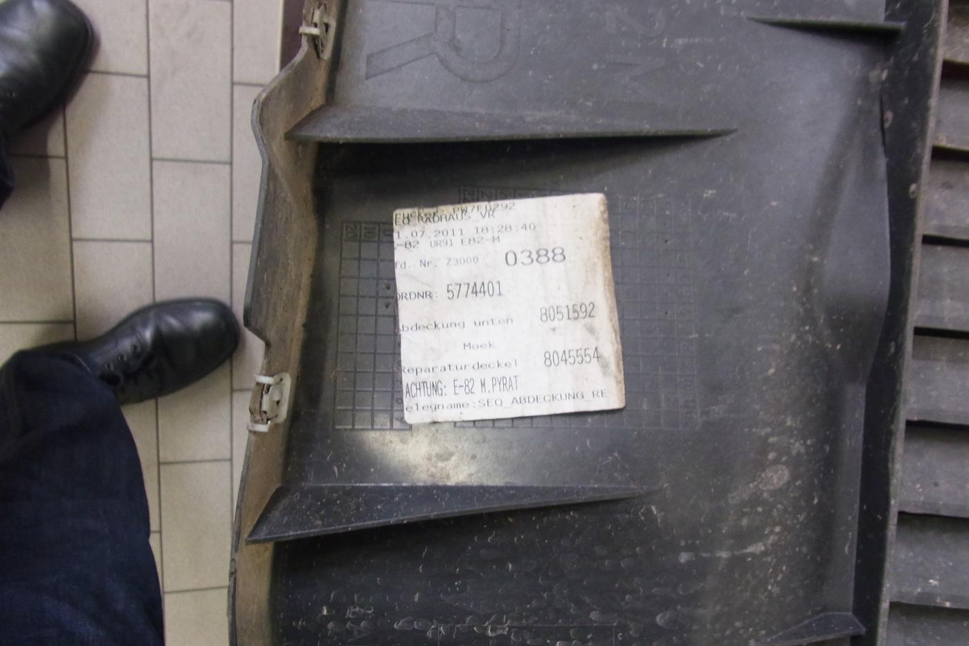

Have you noticed the reference on the sticker: "Achtung! E-82 M.Pyrat" ? Perfect idea for a decal on the outside of, for example, EINSER M.

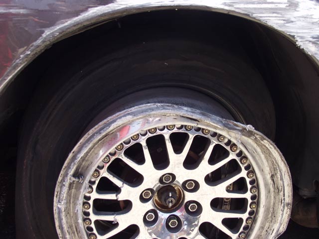

Be careful, tire rubbing could lead to tire failure. I was in a car on the track with serious tire rubbing and we had no idea.
One lap after I got out the tire blew (120mph+) and the car slammed into the outside wall of a large banked curve , driver almost saved it.
