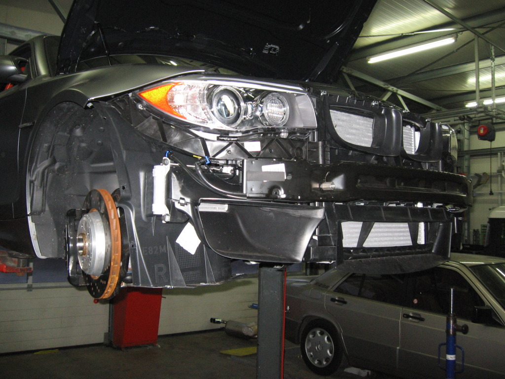

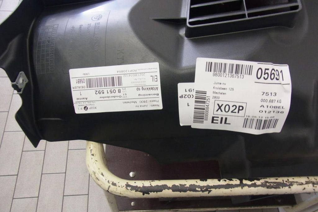

So... to be clear there is no improved part... just that dealers are replacing the damamge fender liner(with the same part) and installinng them to clear the tires mounted on the car.
Part# are apparently still the same (front left part# 51 71 8 051 591 | front right part# 51 71 8 051 592).
Pictures of the upgrade made available in Spring 2012 (to be distinguished from the upgrade of Winter 2012/2013)
(ha, and BMW still refers to "E-82 M.Pyrat" )
