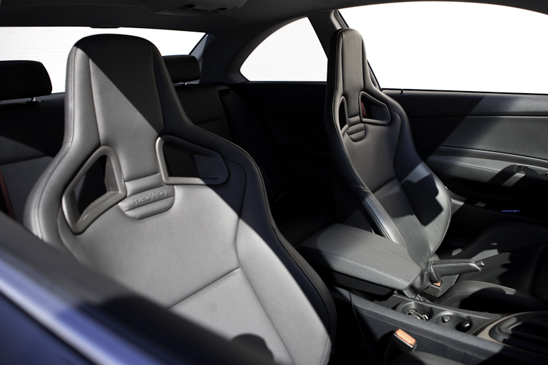

my set up for DD and trackday.

I love the Sporsters. No airbag lights?

u need to code it to take air bags light out

the only real Plug and play sport seat is BMW performance seat that can use heat and airbags without code

Do the Sportsters maintain better as the OEM sport seats ?

Way better, the best seat for due purpose DD/track IMO. And it match the OEM interior , without making the car to ricey
