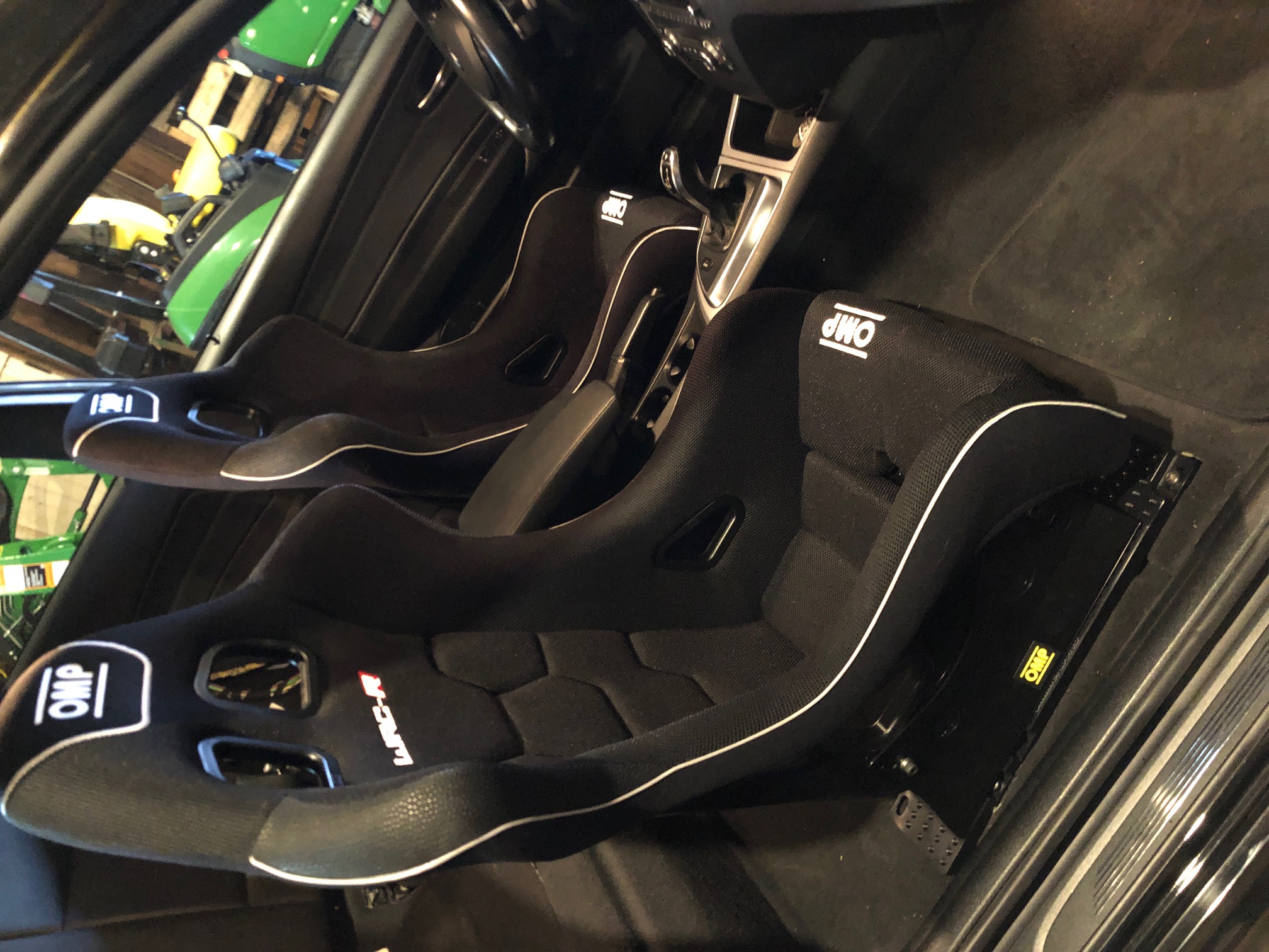

@ninjadog Those seats look nice but lack a pass through on the bottom for a 5-6 point harness. I'm wanting to upgrade to a 5pt harness but I currently drive to and from the track and back roads, etc. I was considering something like as OMP has a compromise with a 5 point slot- definite upgrade from the stock Sport seats, kind of similar to those Renault seats but heavier and cheaper most likely.
Anyone here running both stock seat belts AND harnesses? I don't want 5 points with no head restraint in driving around in soccer mom-ville.
I'm also a bigger guy so I need to wedge an XL seat in there...
D

I'm cheap but I run bimarco seats, FIA certified and real cheap they're light and have a fiberglass shell. ~$300ish.
They're fairly popular in The EU and I love mine, I was running a Sparco Evo previously but didn't really like the Halo setup since I street drove the car occasionally.

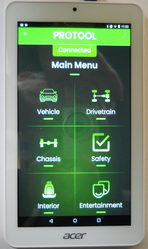

Bimmergeeks ProTools is a very simple approach to coding out the features that are removed when you remove the original seats. ProTools runs on an Android device and interfaces either by cable or Bluetooth.
Top Menu:
Name:  A Top Menu.jpg
Choose "Chassis"
Name:  D Chassis.jpg

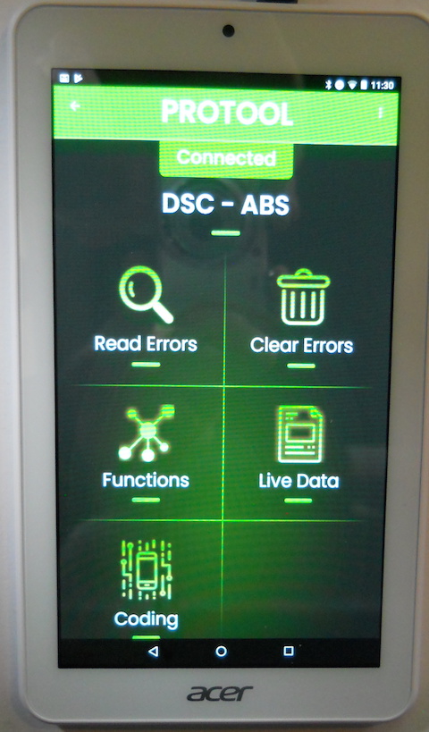

Choose "DSC - ABS"
Name:  D1 DSC-ABS.jpg
Choose "Coding" and you will find all the required items. In my case, coding out the following was needed to remove manual sport seats:
  • ProTools Description (Parameter)
  • Seatbelt Warning Master (CC_GURTWARNUNG_1)
  • Passenger Seatbelt Warning (SBR_BEIFAHRER_1)
  • Passenger Seatbelt Warning 2 (SBR_PREWARNING_BF_MRS)
  • Seatbelt Warning Driver (SBR_FAHRER_1)
  • Driver Seatbelt Warning 2 (SBR_PREWARNING_FA_MRS)
  • Seat Mat Sensor (OC3_1)
  • Passenger Seat Mat 2 (GK_OC3_POL)
  • Driver Seat Position Sensor (SPSF_1_CD)
  • Driver Seatbelt Contact (GURTKONTAKT_FAHRER_1)
  • Driver Seatbelt Tensioner (GURTSTRAFFER_FAHRER_2)
  • Left Side Airbag (SIDEBAG_LINKS_1)
  • Passenger Seat Position Sensor (SPSBF_1)
  • Passenger Seatbelt Contact (GURTKONTAKT_BEIFAHRER_1)
  • Passenger Seatbelt Tensioner (GURTSTRAFFER_BEIFAHRER_2)
  • Right Side Airbag (SIDEBAG_RECHTS_1)
As a practical matter, remove the seats then check for errors. Then code "not active" the parameter associated with each error.

Just finished installing a Sparco Circuit QRT and OMP 2" belts.
-Joe

Do you mind sharing your size and how you fit? I am 6' 188lbs and I think the circuit may be too tight for me
      03-07-2021, 07:43 PM   #106
joeo
134
475
Drives: 2009 Crimson Red 135i
Location: Sterling, Va
2009 BMM 135i  [9.50]
I'm about 5'10" and 175lbs and it's tight. It might be worth a trip to OG Racing's shop in Virginia to try various seats out.

I have the OMP WRC-R in mine, fit fine with the door panels still on. I think they have a halo version that's very similar. With the door panels off I'd think you could get just about anything in there.
Standard width or XL? VAC mounts? They look great.
