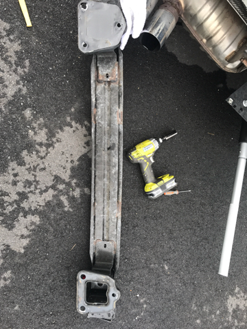

Installed a trailer hitch today and my 10 135i coupe had no ballast weight bolted to the bumper. Here are photos of both sides of the bumper.
About a month ago I did the same on my 2012 and there was nothing there. :/
In my modest attempt to shave weight I was justifying the hitch by removing the ballast. Well, rumored ballast. If anybody has a definitive answer to which models have the ballast (e.g. convertible, non-US spec, etc) please speak up for the other users here who may spend an hour plus getting that GD bumper cover off just to find a seamless slab of steel.

I don't have one either and the steel bumper isn't that heavy. Also with easy areas like the battery and rear seats you need to remove weight from the front where easy savings are much harder to come by. Or the car will get lighter but unbalanced, which will make it faster but the handling will suffer.
