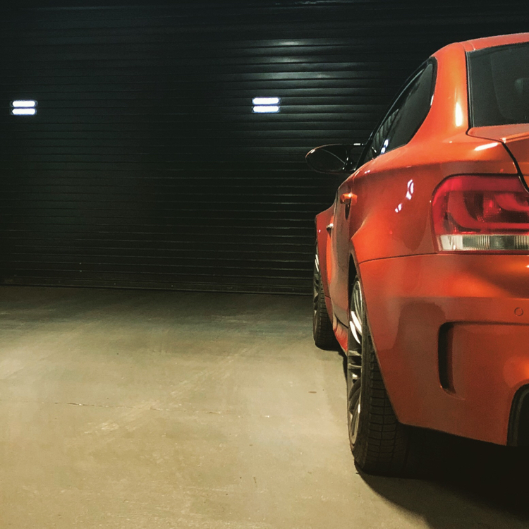

there are people running F80 M3 wheels on the 1M Owners Society (FB).
Plenty of us run 18s as Winter tires. These are M219s from the E90 M3. Fit great.
I think the car has pros and cons on 18s vs 19s. Turn in feels better on 19s, but on 18s the overall steering feel is better, IMO. I personally prefer smaller wheels, but love the look of the OEM 359s so i wouldn't permanently change to 18s myself. Because i use 2 sets of wheels for winter vs. summer i get to use 18s for at least 4 or 5 months out of the year. I like the contrast.
Are those 18s on the rear end rear sized? They look tucked in a bit.
Well I am not a fan of stanced or spaced stuff but I think these fit will really well. I like stock appearance more than anything...
They are 9.5" rear and 8.5 front vs 1M 9.0 and 10.0. But look good still.
They are the same as the OEM 1M 359s. 8.5 F and 9.5 R.
