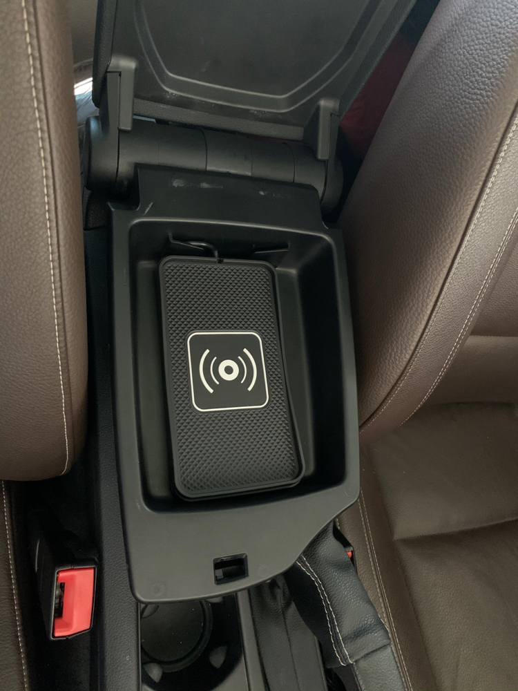

Final result, including wireless charger for my mobile phone
Jorge

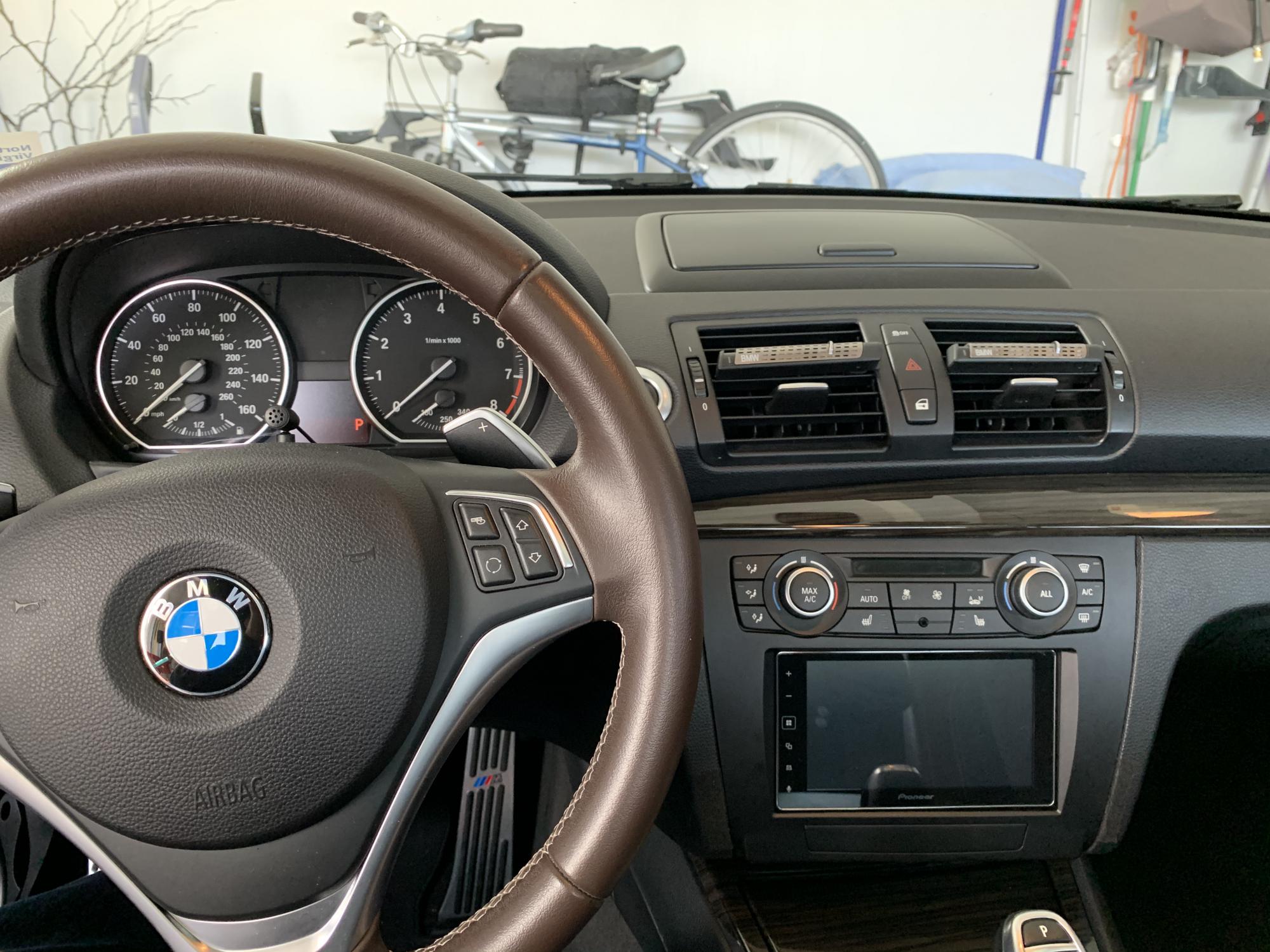

Final outcome - I removed the unit
Hello there
I used this qurantine time to work in my cars. So I have an update a about my 135i and the android unit.
Few things I was not able to solve:
1. Bluetooth quality for calls never worked well, background noise was always present - so I decided to open the unit. As it is mentioned in some android forums (see links i mentioned) there is a very small mic that is connected in parallel with the bluettoth card and the connector where you would connect the external microphone. Bottom line is: Even with an external mic you will always have the input from the cheap small mic inside. So I removed the internal one. To make the story short, this was the last and ultimate frustration - everybody, everybody would ask me what is wrong with my phone connection.
2. Audio quality, once you are inside the unit you can clearly see the cheap crafmanship and the cheap design of the unit, truly. No wonder audio was not up to my expectations. Despite the fact I bought 3 different external DACs, it was painful to be concerned all the time about raising the volume manually, as the volume is not kep for the DAC, switch between apps before launching apple car play app, etc.
I am going to sell the unit on ebay for parts (as I did remove the bluetooth card) but otherwise the thing works in my garage.
So, what did i end up with:
Pioneer NVH-1400NEX - which by the way will take the original high-tech noise-cancelling OEM mic. I used the connector from the avinusa unit and replaced the connector on the PAC RP4.2-BM21. I even used adapters and I have the AUX and USB original OEM connectors working with the Pioneer unit. You want the external AUX input to use it with calibration mic from Pioneer.
P.S.
1. Will talk with Admin to change tittle of the post - if i can help in any way let me know.
2. To complete my all around german set the Helix Match MS 42C are a perfect fit for rear deck
3. Picture with unit is before i connected the OEM mic. Now it is removed
4. Metra is great company - not onece they have failed me but this kit was a pia... let me know if you have a question about proper fitting.
Jorge
P.S.

This may be a stupid question but what are those things clipped on your air vents.
      05-02-2021, 06:12 PM   #18
Jeespinozar
135i fan
25
39
Drives: 2008 135i 6sp, 2013 135i DCT
Join Date: Jan 2009
Location: Virginia
Oem controller does not work w avin unless you have the cic unit.
Things on vent are bmw oem air refreser
