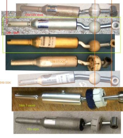

I have even made a rudimentary comparison via photoshop (I will dig up this pic later). This pic showed me the length above the ball joint and the length below the ball joint @ transmission selector linkage.
This is where I noticed that I needed a stick that had a length below the ball joint of in between 128i OEM and 128i SSK. The e60 stick came close, but it needed refinement in its shape.
This is where I looked at e8x 135i/e9x 335iside of things.
- n55 OEM stock stick looks like our OEM below the ball joint- they can use our SSK or n54 stock stick to get SSK results
- n54 OEM stock stick looks perfect mid point & shape. Its even shorter than 128i ssk above ball joint by like 1cm, it is shorter than 128i OEM stick by 5mm
- F3x f2x stick are way too different

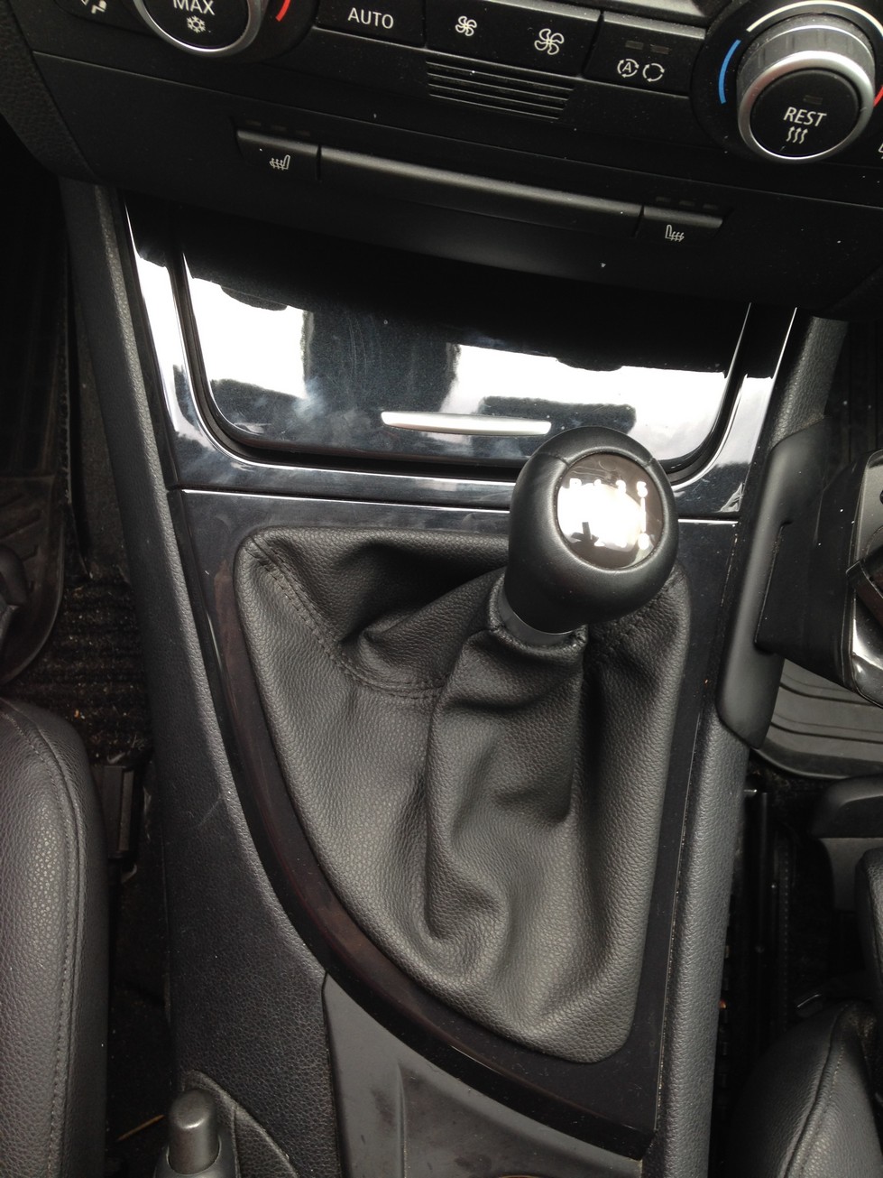

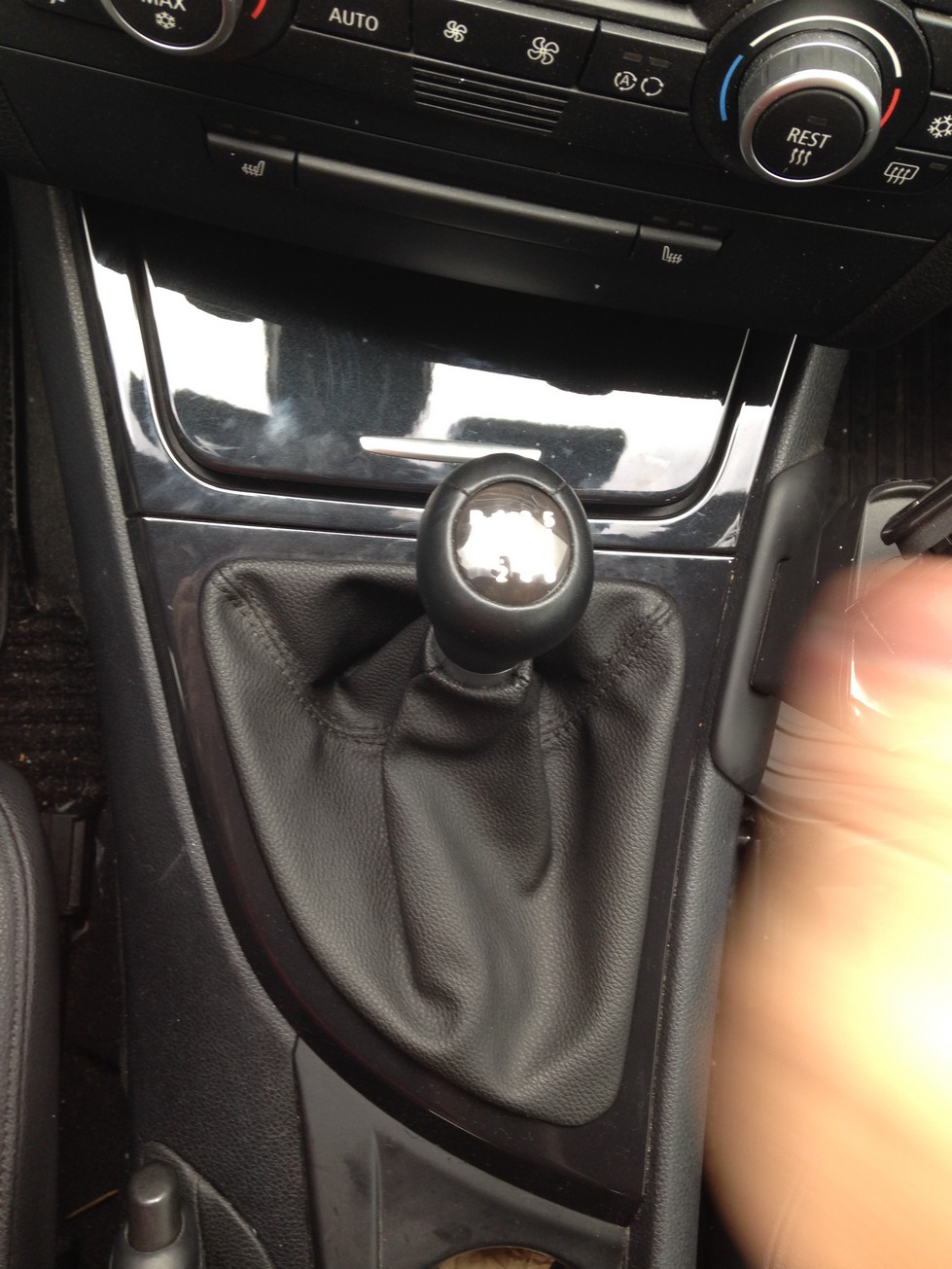

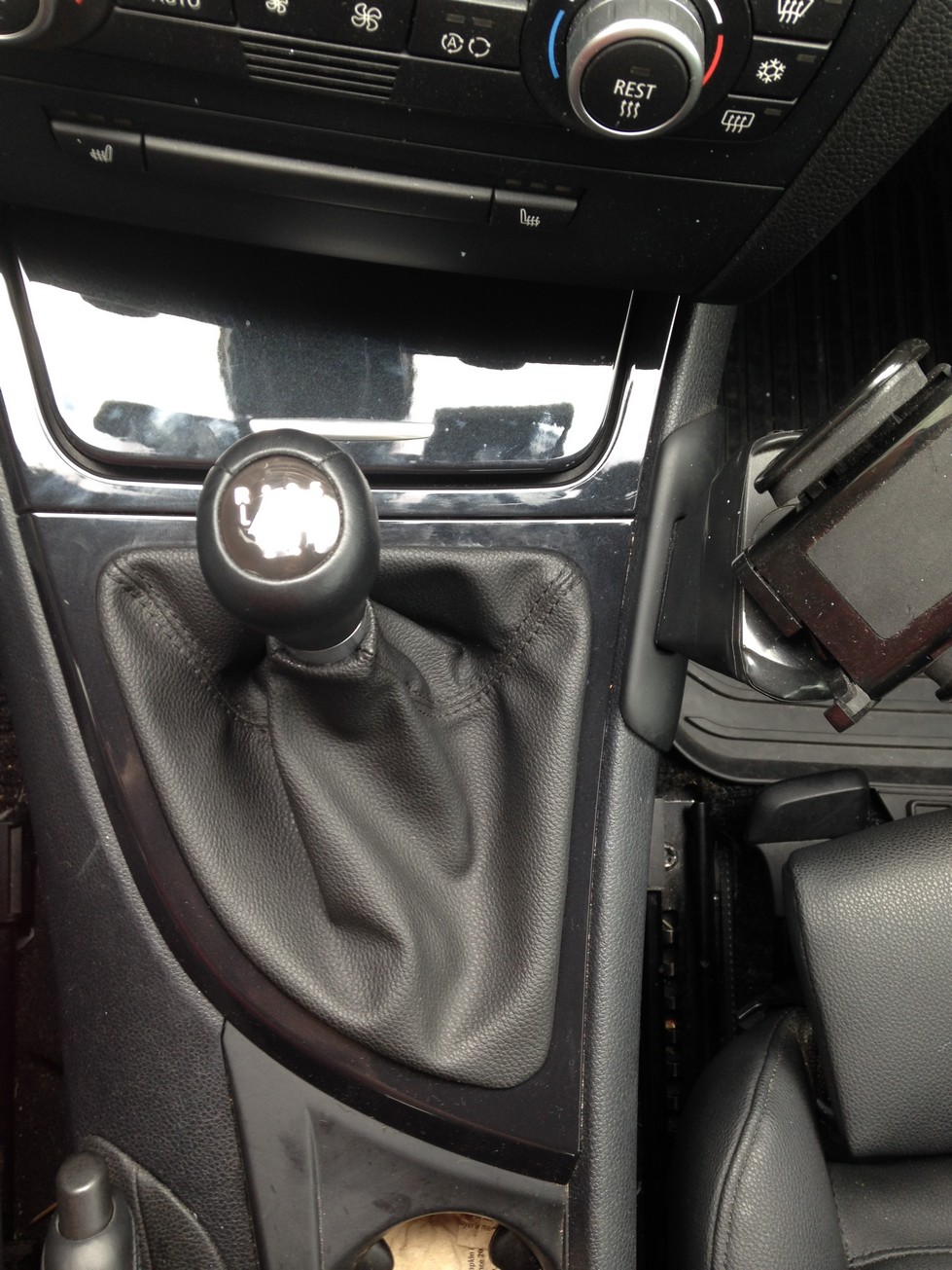

Lets look at the Before: N-1-2-3-4-5-6-R

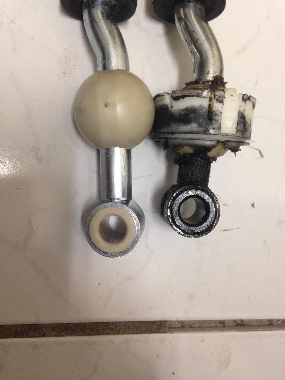

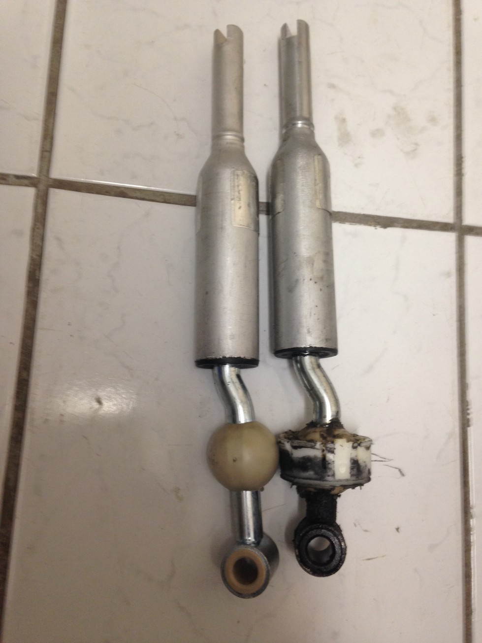

Difference in sticks - 128i is the dirty/ black with white bushing attached

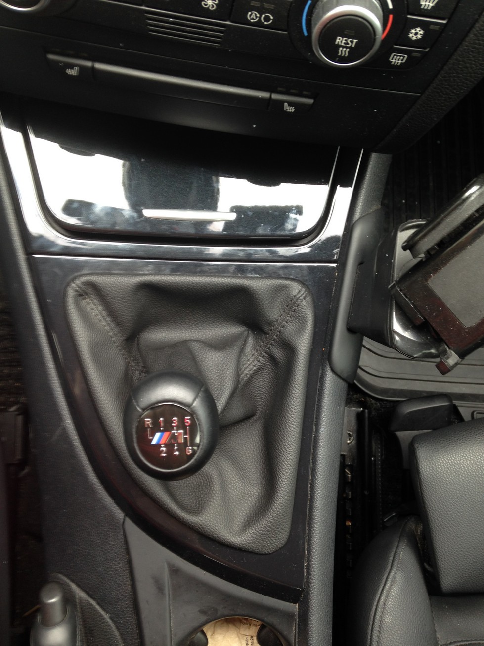

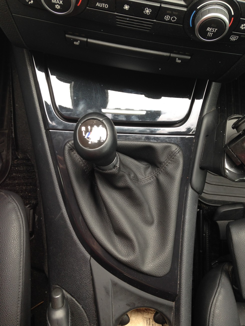

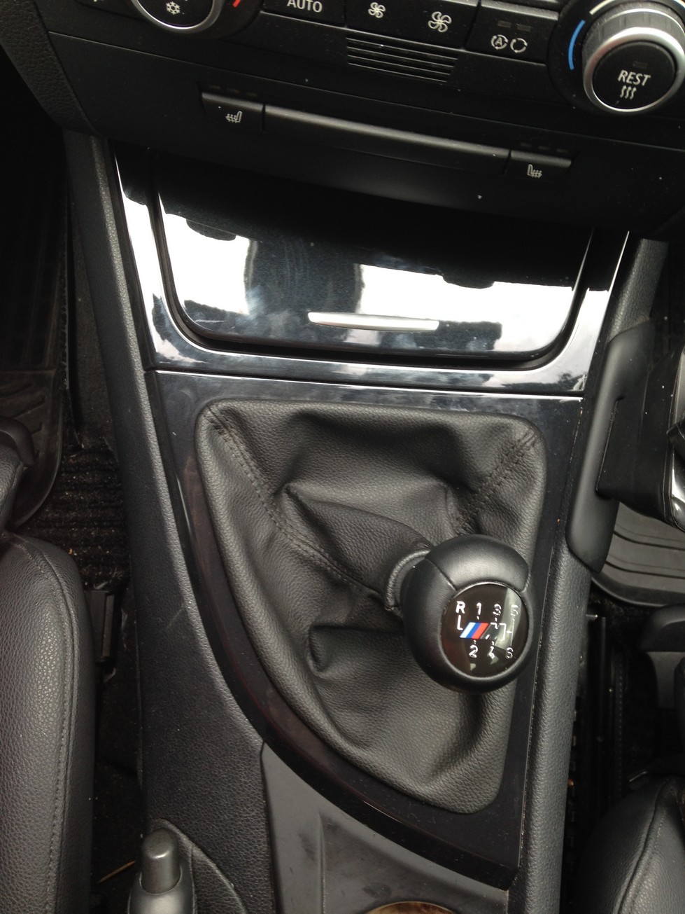

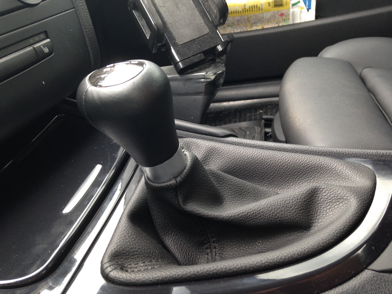

The AFTER 135i n54 Stick as SSK result: N-1-2-3-4-5-6-R
What you should notice is that the stick is shorter and sits closer to the console. The old 128i neutral is almost where gears 2,4,6 are now.
The feeling is great even with how it sits as is. I hardly notice the slightly forward position. I went from a 75mm thro to a 60mm throw, a 10mm longer throw than 128i SSK and saved 15mm distance over OEM. What is comforting is that I have seen here KGolf's 128i SSK pics with the ZHP knob and I must say the 128i SSK sits centered and looks very similar to my creation when in gears 1,3,5. I guess if i was to use 128i SSK knob, the result will be more centered
To be perfect, and why I didn't post this article till now can be achieved if the lever is bent back so that 2,4,6 are closer to the rear of the car by about 10mm. Maybe a bend of 10 degrees will achieve this.
The fix for where the lever rests can be achieved with this bending technique:
http://www.1addicts.com/forums/showp...&postcount=139

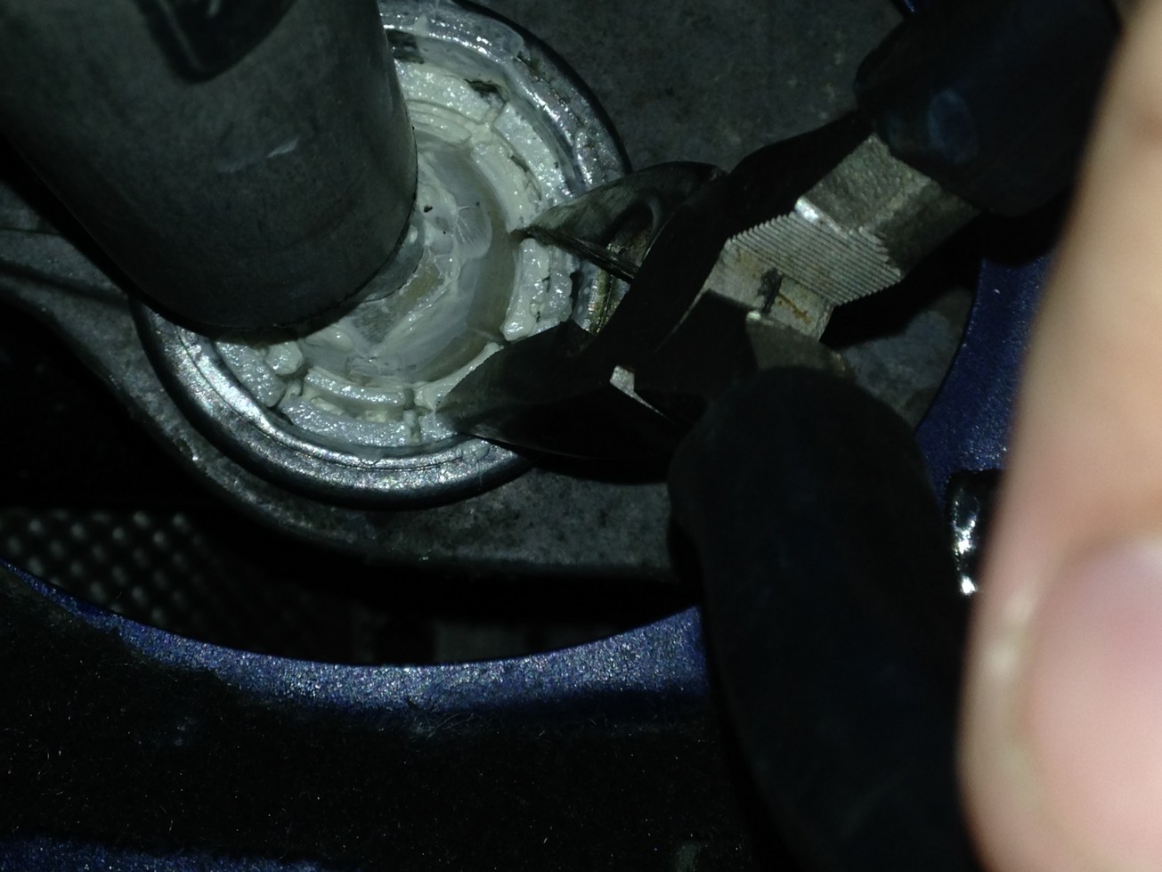

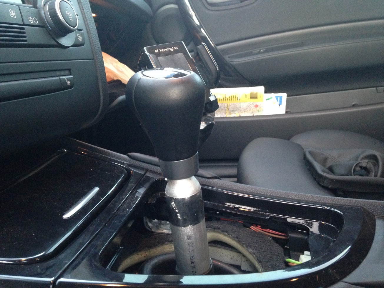

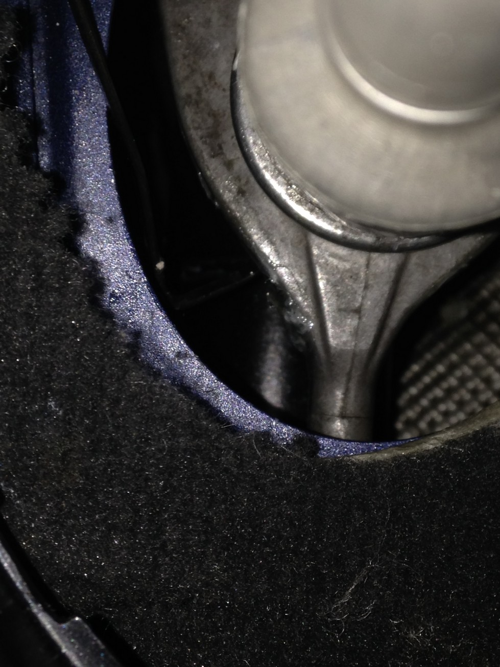

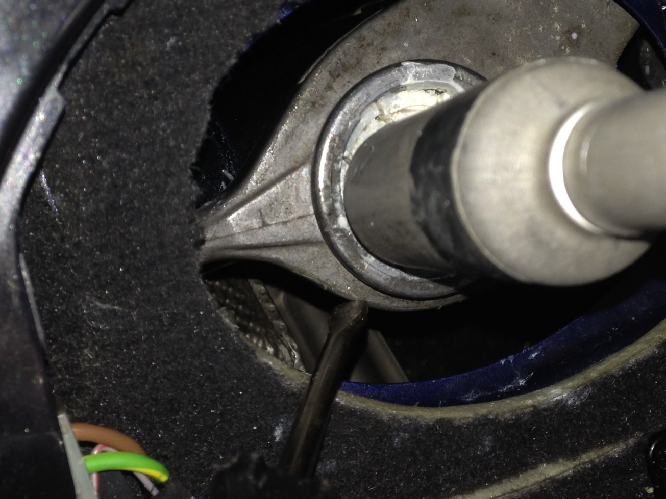

SSK install mini guide

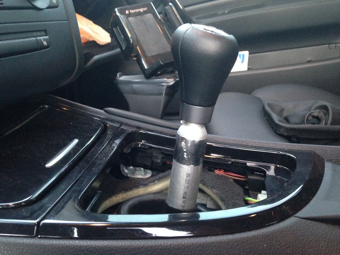

Tools I used:
Pliers to move the Original and new white bushing to release or lock ( be careful it scratches easily) - notice white lithium grease spray/foam on new ball

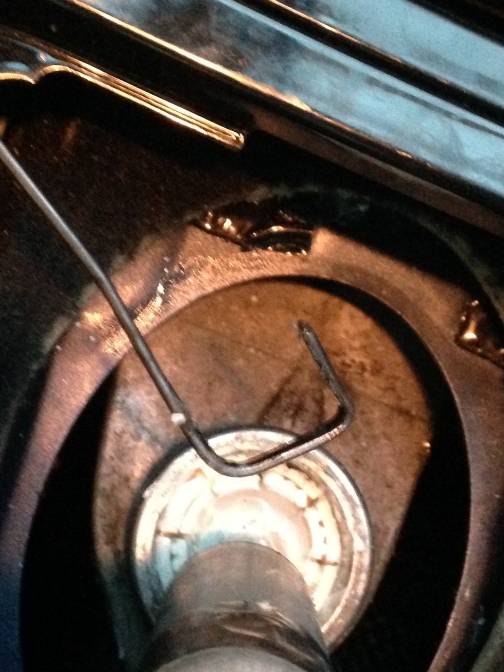

Custom hook to hold Lever selector arm in place and catch it if it slips
See how much room you have - need small hands

This step took me almost an HOUR- very hard with greasy hands/parts
Pushing the clip into place is done with a flat head screw driver, be sure to run a THREAD/wire through it so that if it falls you can get it back.

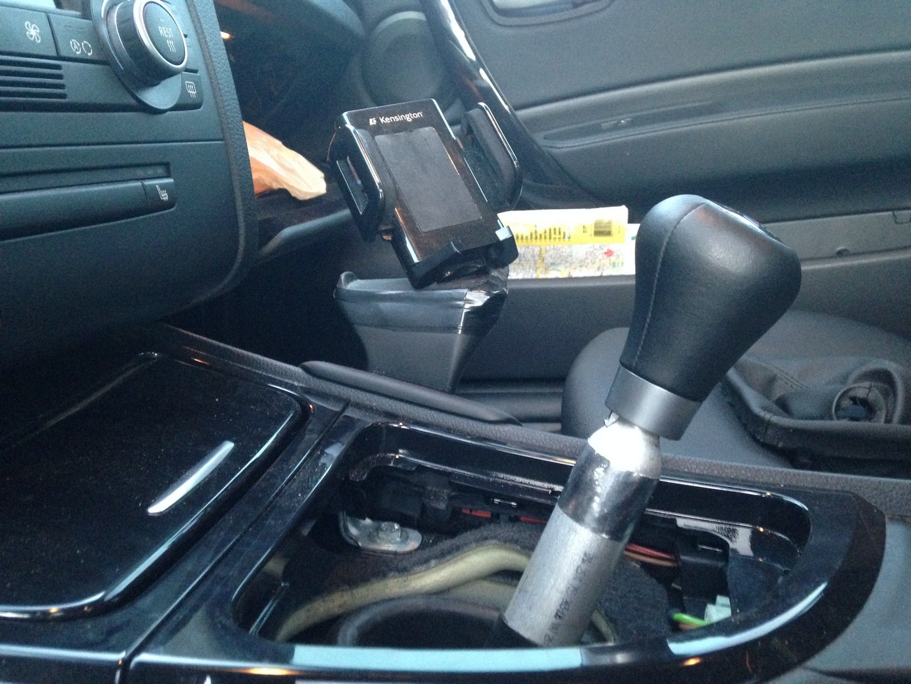

Top view of the SSK action: N-1-2-3-4-5-6-R

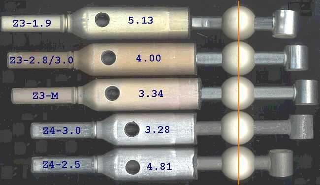

I think these photos might help some to understand how a SSK works, by moving the fulcrum point(ball)...
Name:  ssk  schalthebel.jpg
Name:  ssk levers 128i.jpg

128i stock is about 75mm
128i with my SSK is 60mm
That is my Photoshop Image of the levers. Thanks for finding it
Attachment 1110696
Attachment 1110697

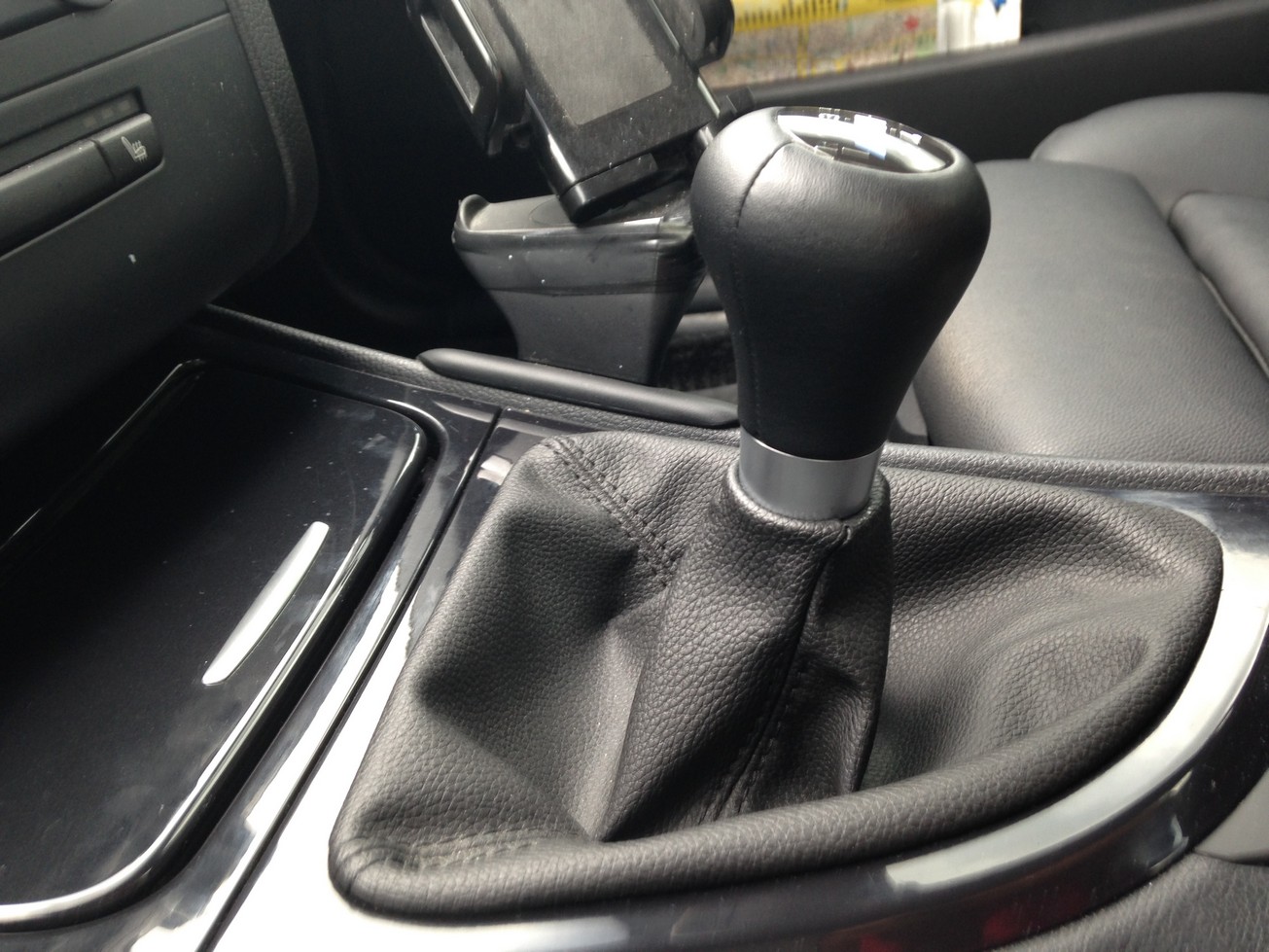

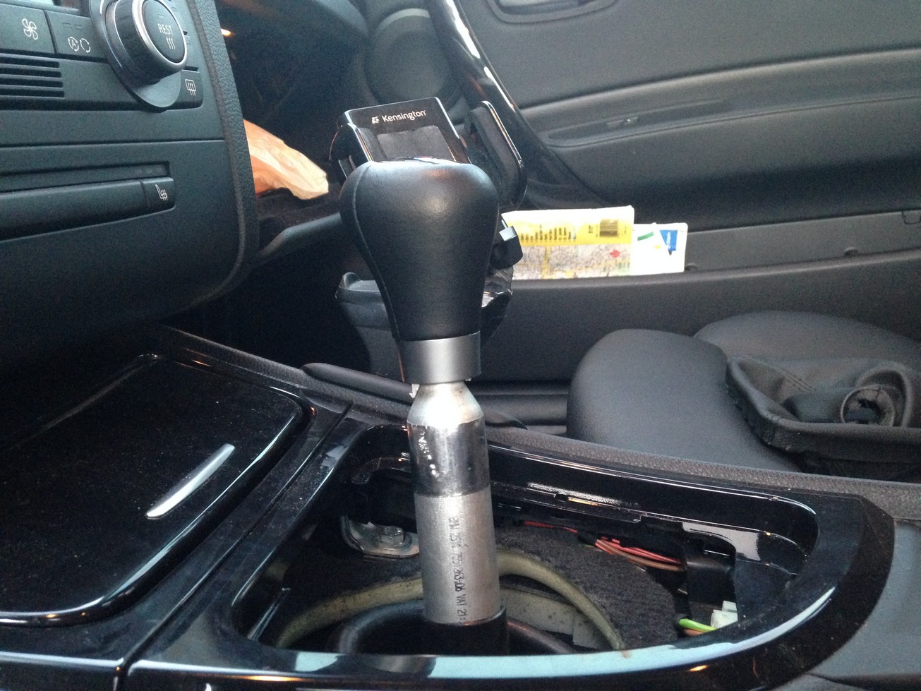

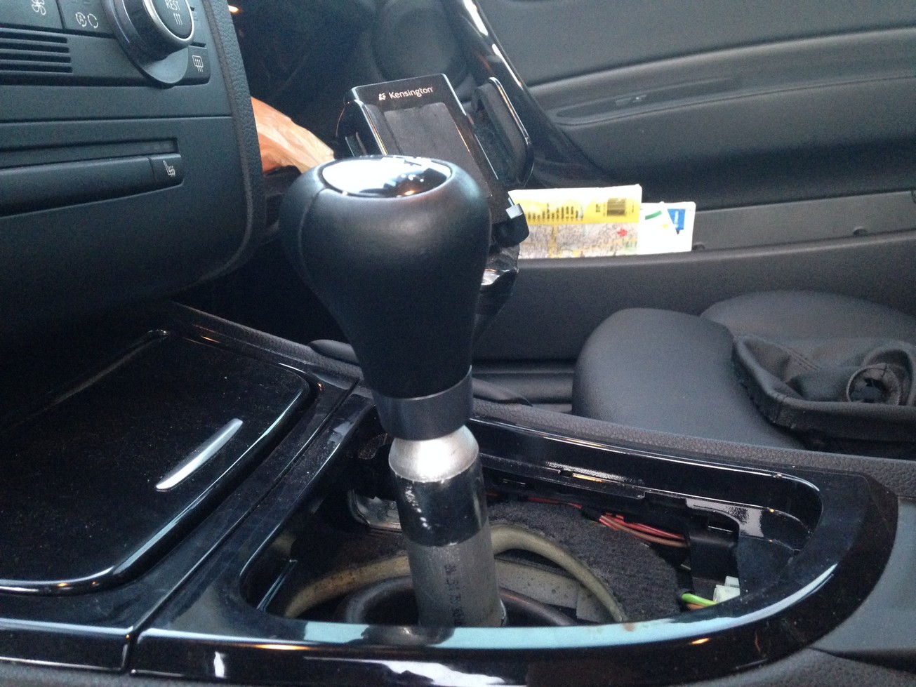

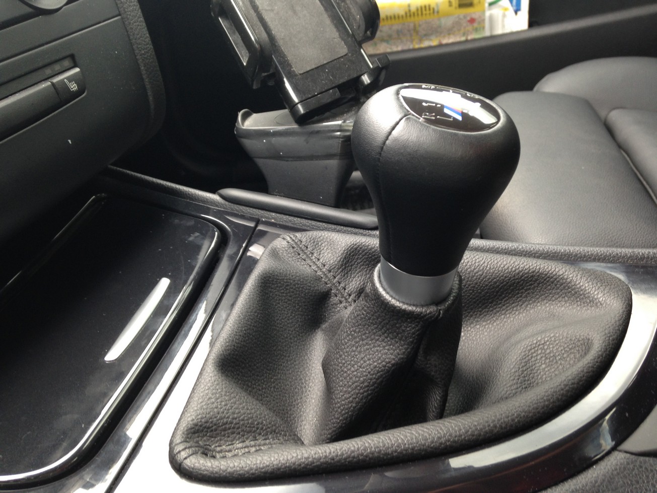

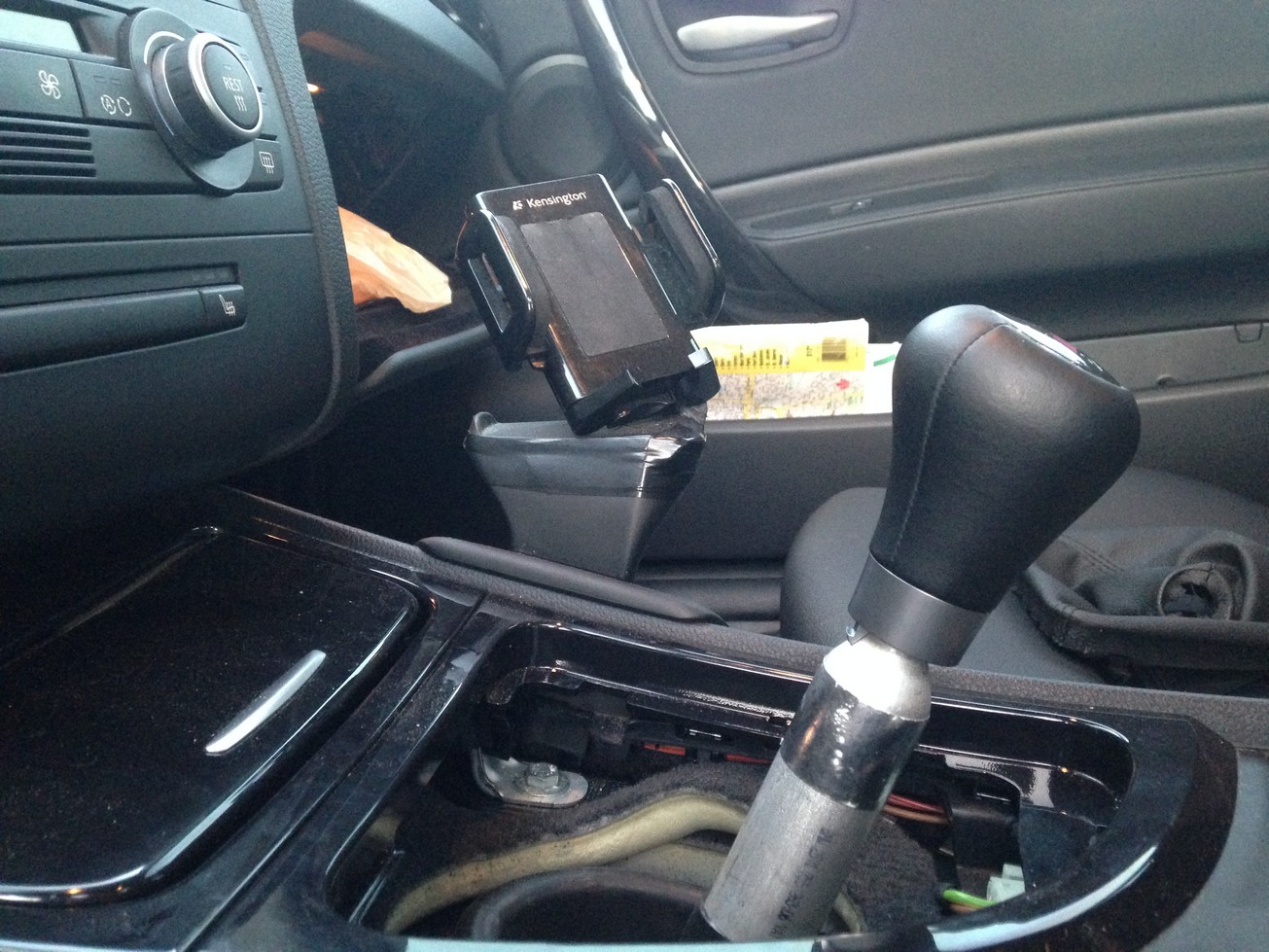

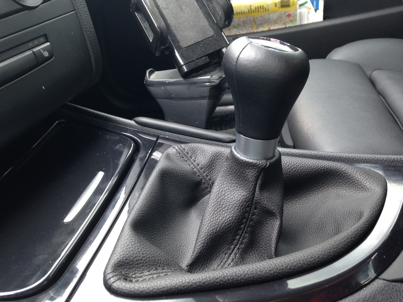

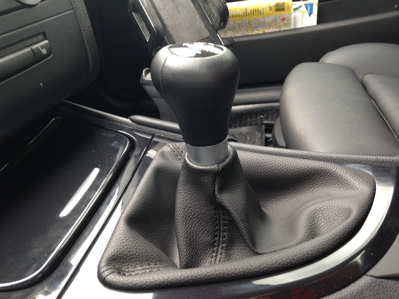

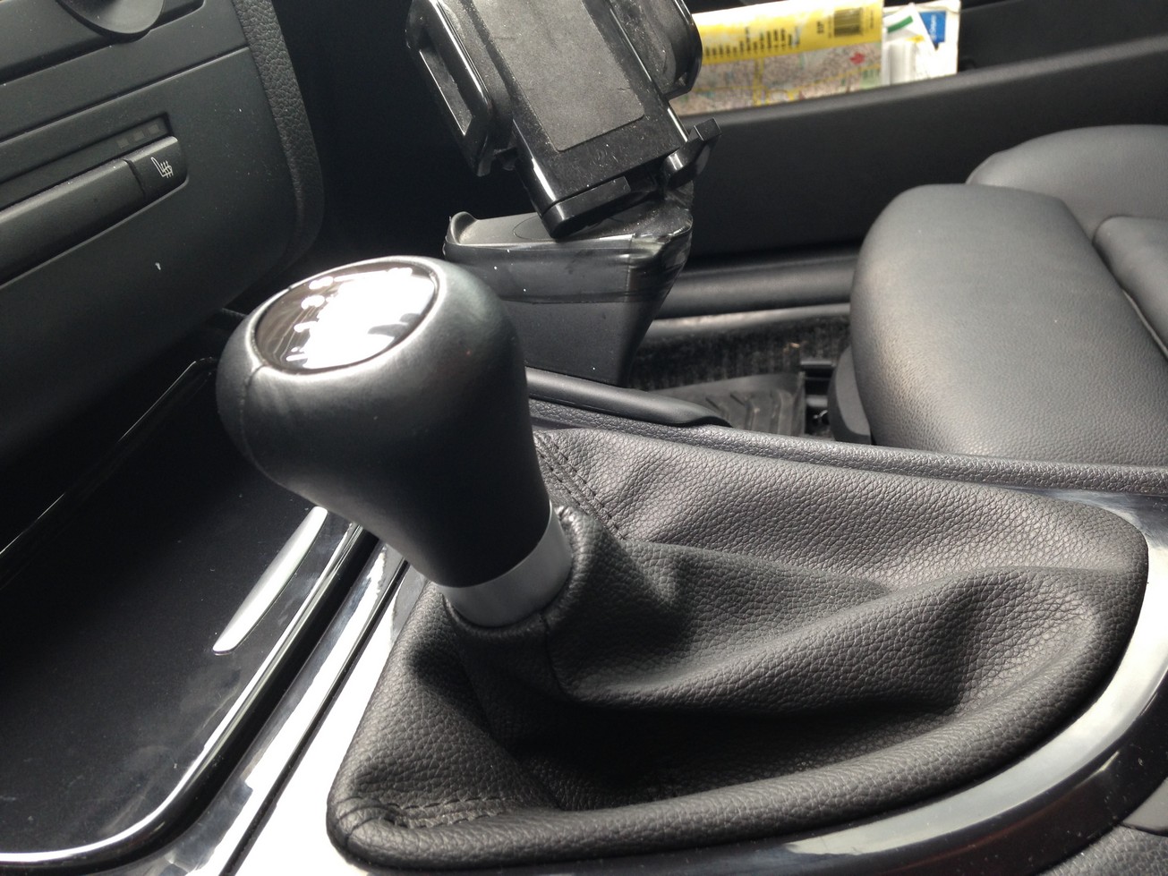

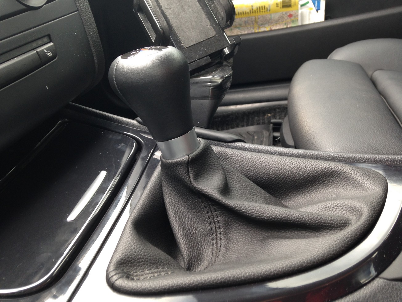

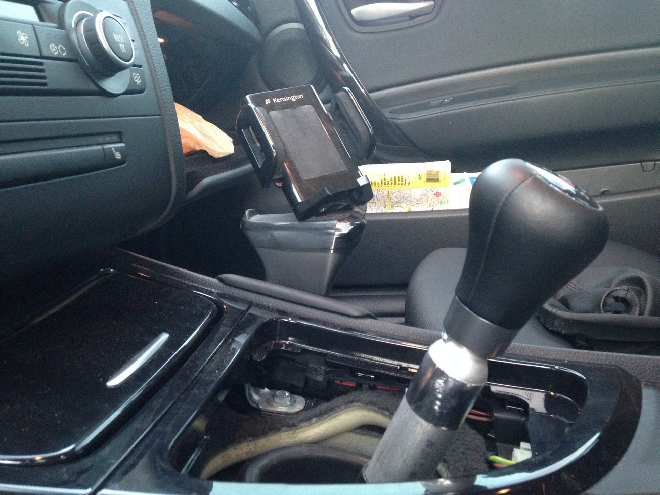

Here are pictures to back up the claim. Just for reference, on my BMW Performance SSK lever I had to bend just a bit to sit neutral like OE.

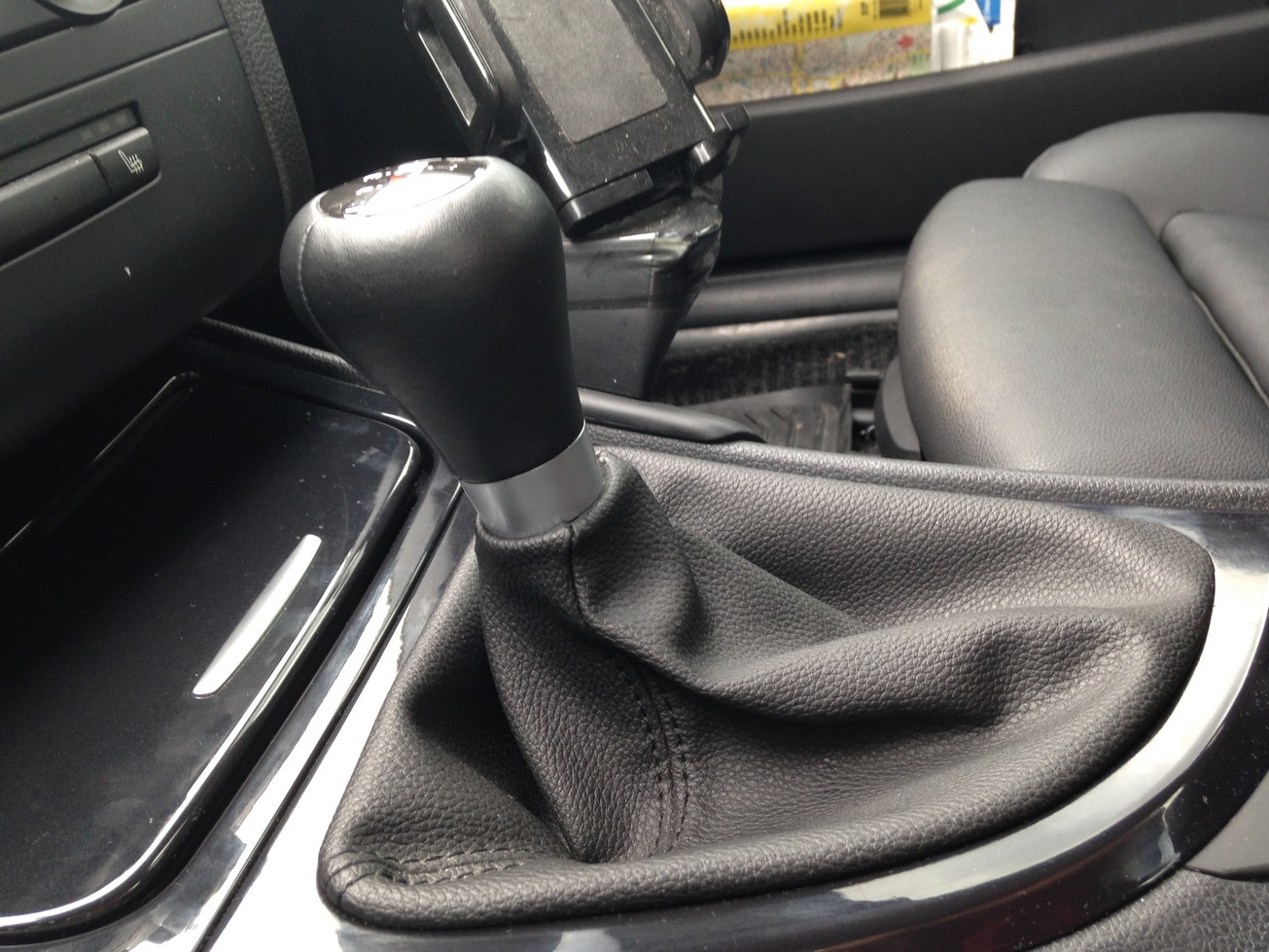

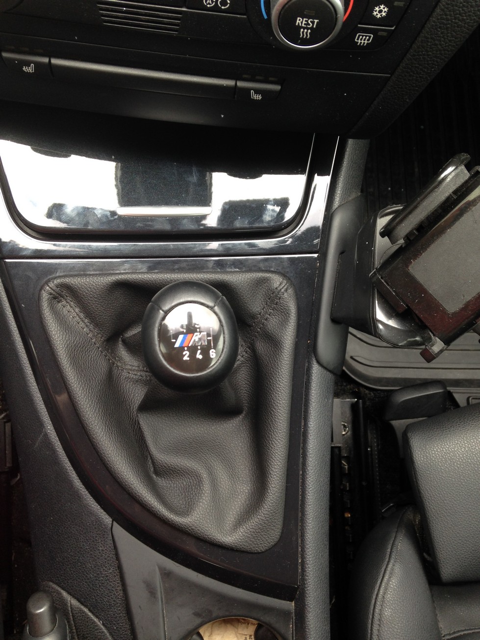

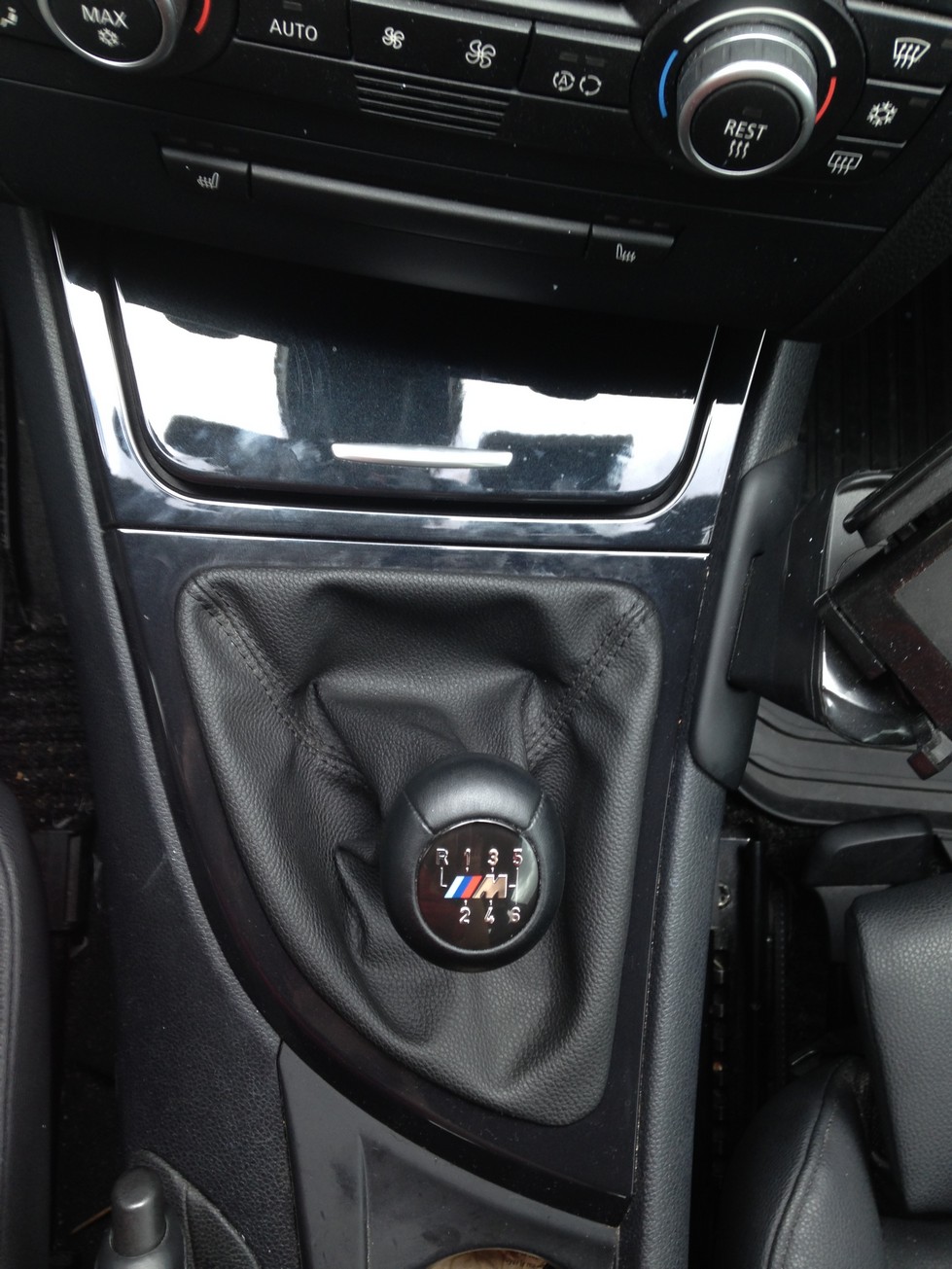

Disclaimer: I literally just ran outside and tried to take the same angle pictures as yours for a good comparison. OE M Sport Knob
Pictures N-1-2-3-4-5-6-R
Wow that is close
So your semi-bent 128i SSK has 2,4,6 is simmilar to my level
But your 1,3,5 is further away from the console than mine.
I'd say mine is about 8mm longer than to your throw (measured from Dack's standard bottom of shift knob)
For me to bend n54 lever to the same center as you, it would be ever so slightly longer than yours.
In any case I recommend anyone to reach out to your local SSK installed 1 or 3 series owner to get a feel for the short 50-60mm throws and make a personal decision. That is how I decided on my path.
PS @Kgolf31 what is the phone mount you are using?
Did you chop off the entire Cup holder or have you done what I did and made one of the sides a support stand for the phone holder?
That is the $300 kit from BMW for 135i until 2010/2011. Dack should have a part number is his thread that he linked to. Or you can search his Started threads from 2010ish.
Wow that is close
I should add that the knob is bent left/right in relation to the car...not forward/rear. It initially sat a bit more right than what I liked...took it off and bent it over.
Personally, the BMW Performance SSK is a bit overkill for DDing, I'll completely agree to that. I thought my OE Z4M was short until this was installed, and the 128 SSK makes the Z4M feel like a train handbrake.
The phone mount is actually a tablet mount. It holds my Nexus 7 tablet I use to run data for autocross via Solostorm (http://www.petreldata.com/). I can actually remove it now for winter since I'm done for autox this year
The mount is a ProClip Mount. They have one that can attach to the vent or to the side of the console.
http://www.proclipusa.com/dashboard-...7-88/2012.cmsv
Then you can choose your custom Phone/Tablet mount to attach to your mount (via screws). I needed something to hold a tablet while autocrossing and it held up perfectly.
I never had a cup holder there.
