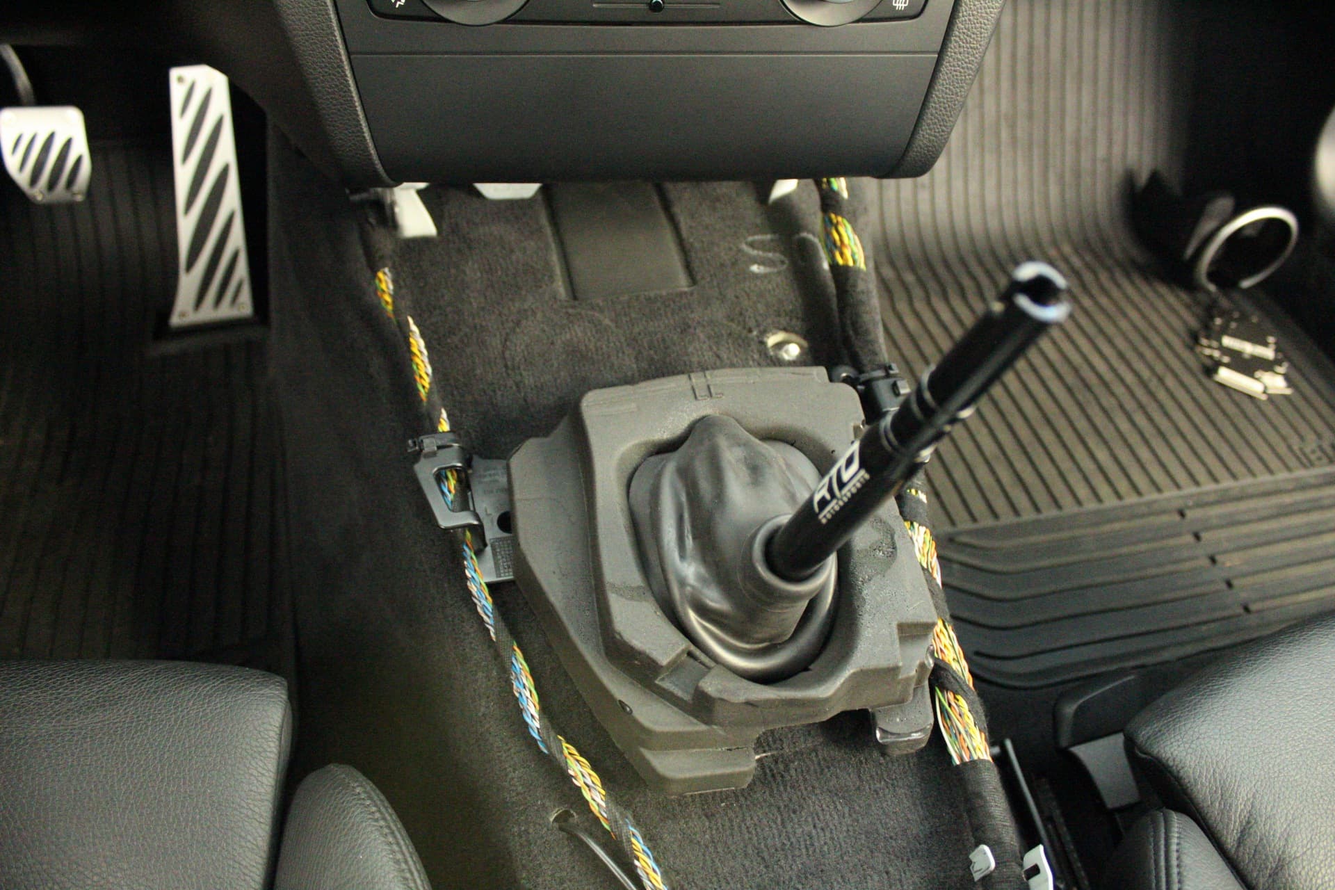

Some more bits for the interior came today!
• BMW Performance Shift Knob (Really happy about how this looks on the RTD Shifter).
• BMW Performance Alcantara Shift Boot
• BMW Performance Alcantara Parking Brake Boot
Also received some new transmission mounts, and the rear differential nut wrench that I need to install the Quaife LSD!

I will start the LSD install tomorrow. Also going to throw on the new transmission mounts, and Turner Upper Rear Spring Mounts.
The Spec Clutch and Flywheel are the next big project after that!
I am on Tune Revision 7 from Wedge now. Things are getting really dialed in at this point. I am going to schedule a dyno day for March, as everything else should be installed by then.
Loving the car!

The RTD shifter is amazing. I actually liked my shifter before, with the short throw, and upgraded bushings. But the RTD takes it to another level.
I thought about getting rid of the logo too, but I think I like it. They make a good product, and I don't mind advertising it for them. haha

This shifter lives up to all the rave. Next to the Pure Stage 2, this is probably one of my favorite mods currently on the car.
Previously, I was running an upgraded DSSR, Short throw shifter, and upgraded shift bushings. It felt good, but there was still some slop in the shift feel, and sometimes 1st gear would take two attempts to get into.
After installing the RTD Shifter and DSSR, shifter feel is addicting. The "click" sensation and sound that is produced when pushing the lever into gear, is very confidence inspiring. There is almost zero slop in the lever once in a gear, and everything just feels so much more direct. You do have to apply a bit more force to the shifter compared to stock, but this is because of the tension spring and design as a whole. I actually prefer this over stock, as it requires you to be more attentive and active when shifting.
