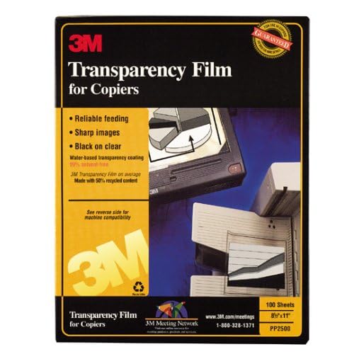

get some of this. It's expensive in a box, but OFFICE MAX/STAPLES will sell it by the sheet. I suggest you get 3 sheets incase you screw up. Put on your sun glasses, turn the radio on and hold the film up to the radio. Turn until you can see the radio the best through the glasses. Mark the film with and up arrow for reference to lay your template on latter. Be careful with the film as it will scratch easily.

Another happy customer ... thanks !! The only problem is who has Overhead Transparencies any more ???
One other note for those considering this, the Transparency is very reflective, so you may get a different problem with sun in the wrong place, I especially noticed this when sitting in the passenger side (don't worry I was just trying it out for size !!)

I've been dealing with mine ok for the past few years as I was typically able to peer underneath my glass frames if need by. However my newest sunglasses don't allow that, and this became a problem. I went to a CopyMax, which is attached to OfficeMax, and bought a single sheet of transparency film for $0.44. It took me a couple of attempts to get it right, but it seems to be working great. I'll try it out in the sun tomorrow to see if that changes anything. Thanks for the tips guys.
