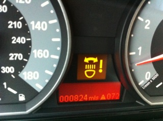

Just finished installing my lux h8 headlights, after about 5 minutes of driving the adaptive headlight warning appears. Any tips?

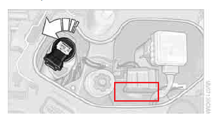

I appreciate your concern. I didn't install them myself, and I definitely wasn't going to take it to my dealership.
I found this diagram. I'm going to give it go myself this evening.

good luck. I used that as well mounting mine. works fine.

James T. - Hope you get this fixed soon and good luck fitting yourself! It can be a bit tricky (i.e. takes a bit of maneuvering and access is limited) but is quite do-able yourself.
Regarding placement, check out a couple of the earlier posts in this thread as these might help your situation of re-positioning the "little black box"
