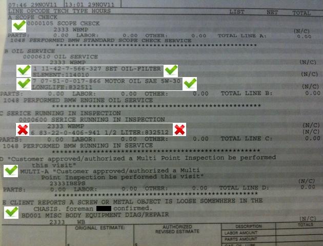

SAMPLE INVOICE(Incorrect Service):
A. Scope Check
B. Engine Oil Service (oil + filter)
C. Rear Differential Fluid
D. Multi-point Inspection
E. Loose Part(screw) in Rear Chasis Area
If you look at C, the part number for the fluid that went into the transmission or rear diff(unknown which one) is 83 22 0 406 941. This is BMW M3 MTF-LT-2 SAE75W-80 manual transmission fluid. This seems almost unthinkable. The mechanic had to ask for this by P/N the part is then scanned by the Part Dept. and then given to the mechanic to put into the car. In this case the only fluid that was changed was the engine oil. The inccorect transmission fluid was build out by mistake but never actually put into the car and the differential fluid service was totally forgotten and never done as well.

Question My Story.....
So believe it or not this keeps happening to people and now me. I thought I had all my ducks in a row. I called the parts dept. to verify fluids were in stock.
Parts guy verified that the Rear Diff fluid was in stock(P/N 83 22 2 282 583), but did not have the MT-5 fluid in stock(P/N 83 22 2 239 654). The service adviser told me to bring it in anyway, get the engine oil + filter and rear diff fluid changed out. They would then order the MT-5 fluid and schedule an appointment to perform that service when it arrives. I also had a screw rolling around sound coming from the back trunk area of the car that the shop foreman found while I was doing the paper work.
So the services performed according to invoice:
A. Scope Check
If you look at C, the part number for the fluid that went into the rear diff is 83 22 0 406 941. This is BMW M3 MTF-LT-2 SAE75W-80 manual transmission fluid. This seems almost unthinkable. The mechanic had to ask for this by P/N the part is then scanned by the Part Dept. and then given to the mechanic to put into the car. If anyone can offer a reasonable explanation I would love to ease my concern but I have a feeling this is not good. Thanks.

Originally Posted by James T. Kirk View Post
I'm sorry this happened to you, Metak. You're so conscientious.
If I were you, I'd have it flushed and changed.
The problem is I don't even know what to have flushed at this point.
-The service manager claims they never used the MTF-LT-2 on my car even though it appears on the invoice. They are firm in the fact that it was just a billing error(billed but not performed).
-They also told me the rear diff fluid wasn't even changed, even though it was in stock. It was just 'overlooked'. If I hadn't called I would have been driving without the 1200 service on the rear diff and possibly the wrong fluid in the transmission. What a total disaster.

[QUOTE=Mr.Metak2you;10934310]The problem is I don't even know what to have flushed at this point.
Metak - simply advise them that - according to their own invoice - they placed the incorrect fluids. They have NO backing for saying it was just an invoice mistake. I would advise that - according to all documentation including theirs, that they placed the wrong fluids. Say that this has accidentally happened to others (including me), but that other's dealerships have stepped up to the plate and done the CORRECT thing - replace the fluid with the correct fluid, then changed it again in 4 - 6 weeks with the correct fluids to make sure that the wrong fluids were completely flushed (this is what my dealership did). State also if they are unwilling to do this, then you will be contacting BMW NA and the area BMW servce representative. Also say that you will be giving them a "0" on any and all future surveys you fill out from BMW regarding their dealership. Also, ask to speak with the general manager regarding this and tell him of how other dealerships have handled this correctly.
Good Luck!
