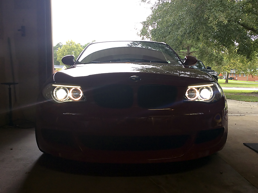

Finally ordered these headlamps, but got the Euro version. Just to verify - that last pic is of the Lux LED's? It looks really good. Normally I'm sort of anti-tampering-with-AE's, might I think it might be worth it to get the brows and AE's to match. Plus it might be a really good time to install them, while the new lamp assemblies are out of the car anyway.
My only concern is getting an AHL failure. How long have you been running your LEDs? No issues at all?

Nice! Love the amber-free lights haha.
Yes sir, those are LUX V5 @ 5000K. Match very well thanks!
I had V4's previously and got AHL errors. After getting frustrated I ditched them, but after talking to LUX earlier this year I ordered some V5's. With my car in storage I had time to analyse the new housings while they were out of the car. In doing so and comparing the positioning of the ballast vs headlight components, I came up with a very very easy way to modify the headlight cover to prevent these AHL errors from occurring. Currently zero errors since installing with this method, and it's been three months or so I think now with many many car washes both by hand and wand.
While swapping over the control units and such, I used some Amsoil silicone spray to lube up the seals again to help get some moisture back in. Seemed to work well.
See my thread here: http://www.1addicts.com/forums/showthread.php?t=1086352
And DIY, don't mind the cliché intro and uber serious 'hello' hahaha. (also this is wayyy easier with the headlights removed ):

Success, of sorts.
So I ordered a second pair of wires from ECS Tuning a week or two ago - it turns out they're used somewhere in the foglight assembly, and the connector is too large to fit in the 12-pin headlight socket housing, and the wire itself is noticeably thicker. But I kept them around, just in case.
Then, while I was searching around for a replacement cap for one of my headlight sockets, I stumbled upon this: a repair kit for said socket housing, which includes not only a replacement socket and cap, but also several metal connectors and a bunch of those rubber insulating plugs. I went ahead and ordered it, since I needed the cap anyway, and figured I could use the metal connectors with the wires I mentioned above to make my own jumper cable that would be guaranteed to fit.
Well, it was a good theory. I fabbed the cable okay, but for whatever reason I just cannot get the connector to seat properly and positively engage the socket housing. It's just loose in there, and does not make a connection as intended. And I know I have the exact right connectors, since it was part of that kit (it turns out they are the same type of connectors I tried the first time around, too).
I finally gave up and clipped the connectors off, stripped off some of the jacket, and shoved exposed copper wire into the socket housing. As soon as I did it, I knew it would work - I could feel the wire "click" into place as it engaged the metal contact inside. I backed the wire up a little so that it wasn't sticking out too much on the other end, and tried to shove the rubber insulating plug into the housing enough to keep the wire from moving around. Soldered the other end and taped everything up and voilĂ :
I'm not thrilled that I wasn't able to use the actual metal connector as designed, but the thicker wire I used felt pretty darn snug in the socket housing, plus it has the rubber plug to hold it in place, so hopefully it works out. I will probably obsessively check the connection every other week or so until I'm satisfied it's okay, or I'll dig into the repair kit again and try to get the connector to work, I don't know (I just don't get why it won't fit!). Either way, I'm happy enough for now.
