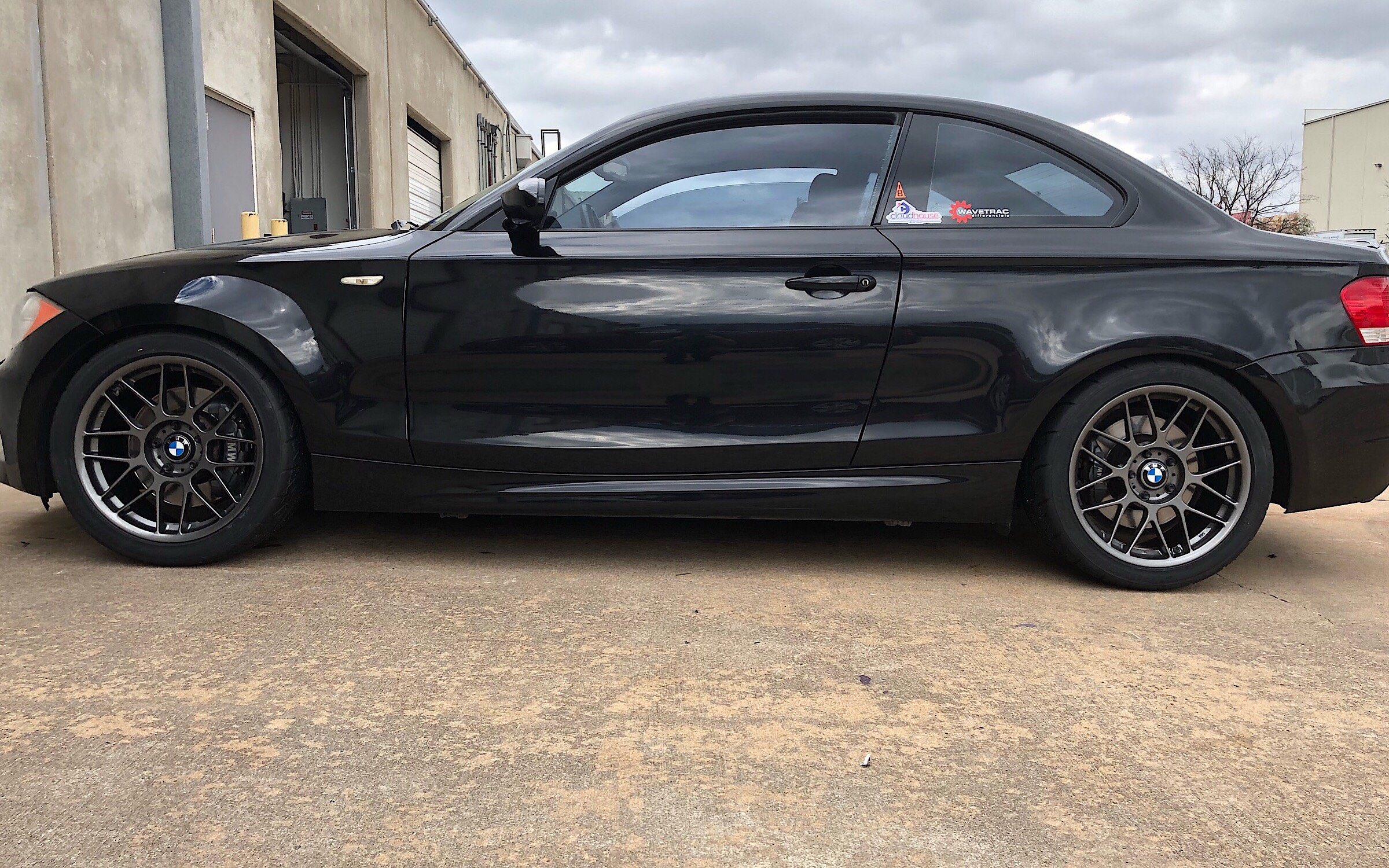

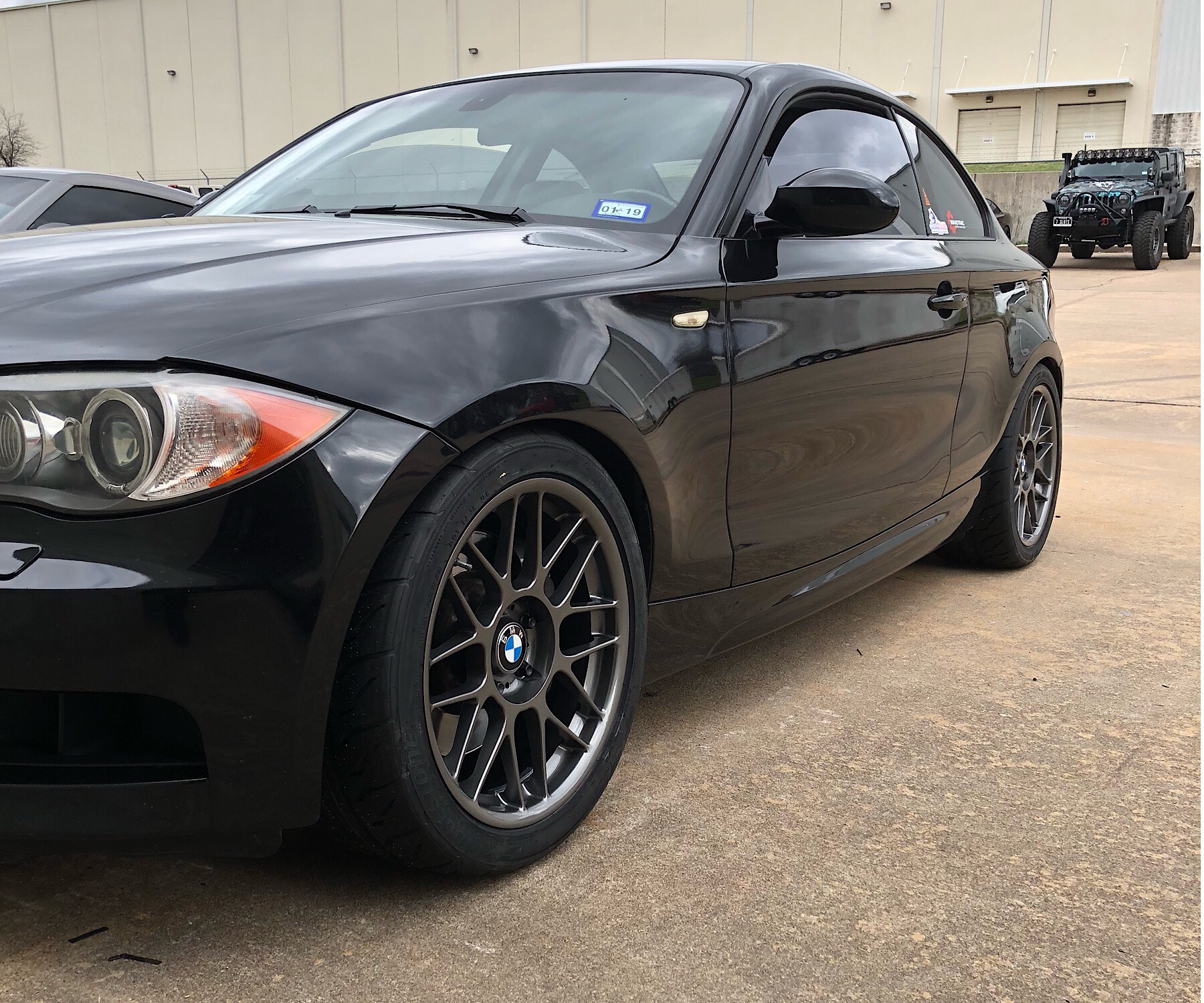

Just got my new wheels and tires on!!
Arc 8 18x8.5 front et38 and 18x9.5 rear et58
RE71r tires 245x40 front 275x35 rear
TC Kline s/a coil overs -3.2 front -2.2 rear

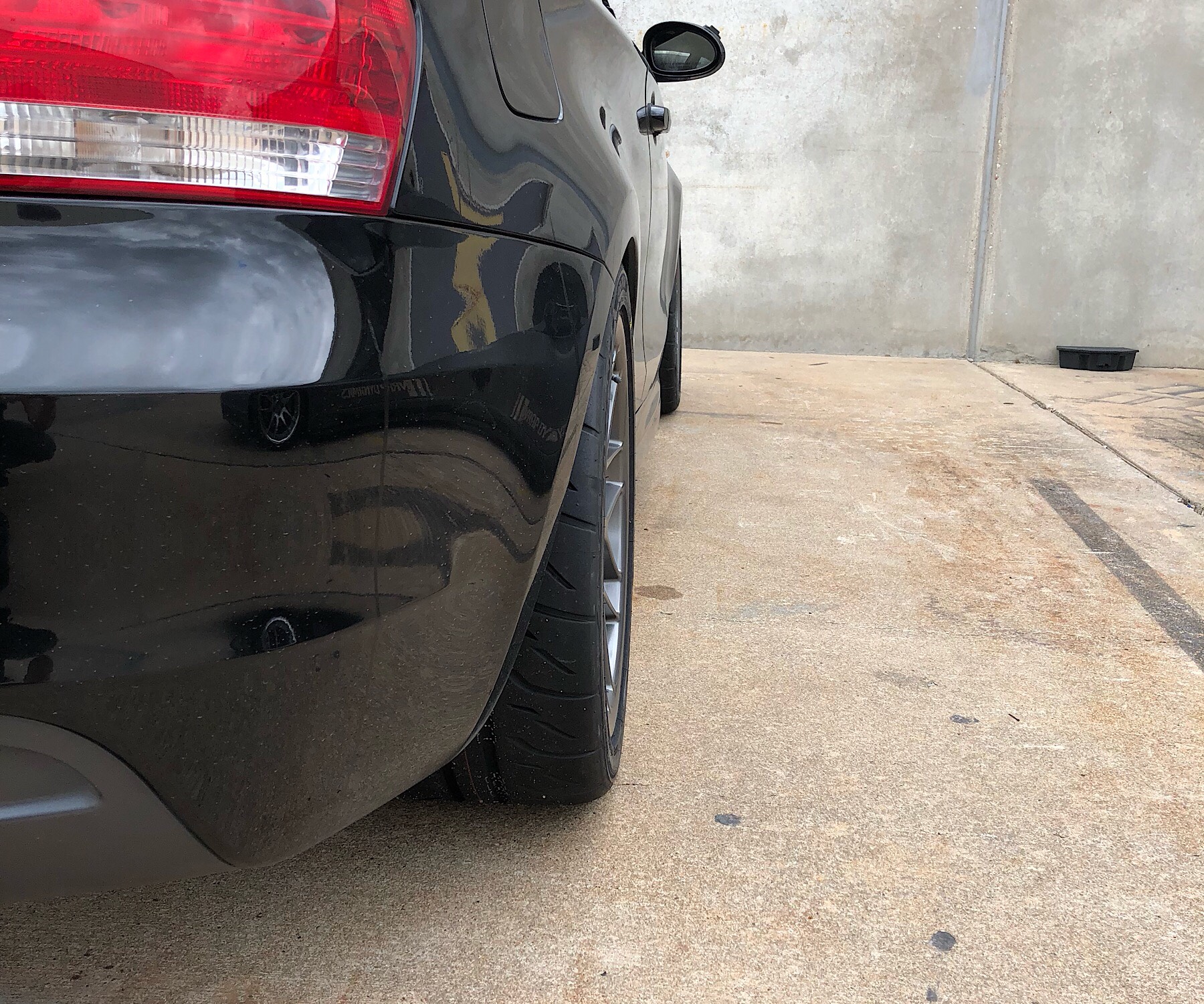

Very little rubbing at this height, but i had to remove a couple spots on the front fender liners and heat the filler tube for the tank and push a small dent into it in the rear

If you had to heat the fuel filler, I'm afraid you're going to run into issues after a few laps. Tires flex and what clearance you think you made probably wasn't enough.
Just keep a real close eye on it.
it was just barely touching the inner fender liner at the filler tube and i pressed it in about a half inch so should be good but i'll keep a close eye on it for sure.
