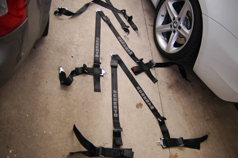

Here's my writeup on how to install the Harnesses:
Schroth Rallye 4 - Left (sr 16100) & Right (sr 16600)

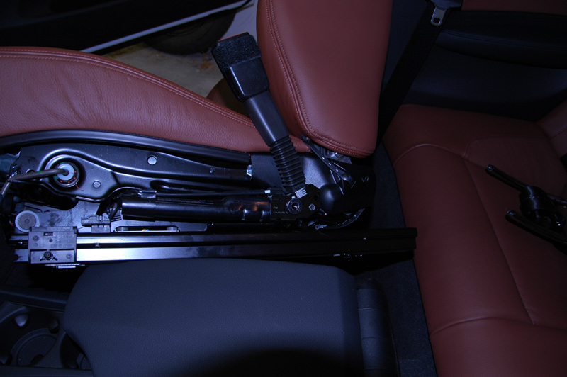

The only tool you need is a ratchet, 12" extension, and a T45 Torx bit. (see pic 1)
One of the draws of Schroth Harnesses is that they have a quick fit. Unfortunately, they don't have an application for the e82, and I had my car measured by the sole US distributor (HMS Motorsport), for the purpose of them possibly making some in the future (don't hold your breath though). If you choose to go with these installation instruction, do so at your own risk. (I have to put a disclaimer in for liability reasons)
Okay, lets get these puppies installed!!

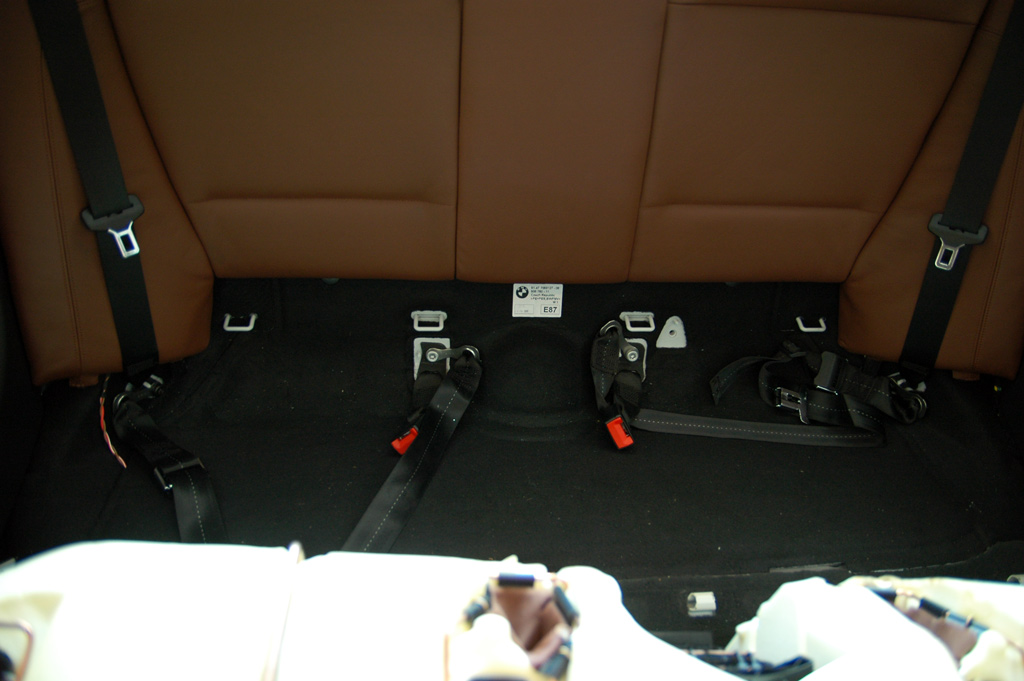

First, these belts have a left and a right. Grab the one for the right to start. They are identical, except the buckle side is towards the center console, and the clasp towards the door. (Pic 2)

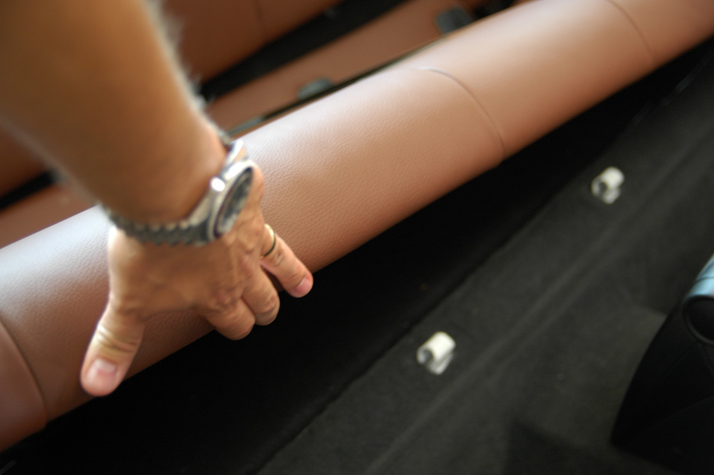

Remove the rear seat pad. It simply pulls off. (Pic 3), you'll see the four belt mounting bolts. Simply use the rear seat section of the Schroth harnesses and bolt them in, as if they were a washer just under the bolt head. (Pic 4)

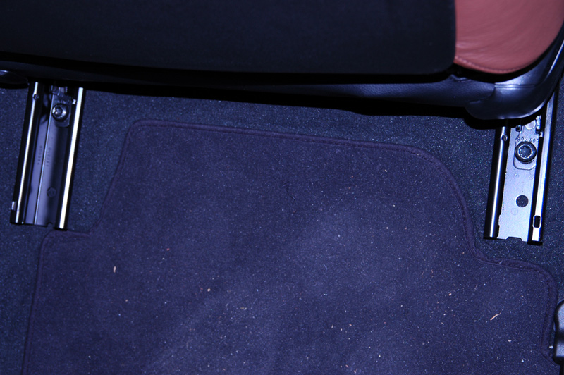

Next, we need to unbolt the front seat to access the belt anchor bolt, next to the center console. First, move the seat all the way forward, which exposes two of the four mounting bolts. (Pic 5) Unbolt the rear two bolts, using that one T45 ratchet.
Then move the seat all the way back, which exposes front two bolts (Pic 6). Remove these. Then cover your center console with one of your carpets (to not marr the pretty plastic), and tip the seat on it's side. (Pic 7)

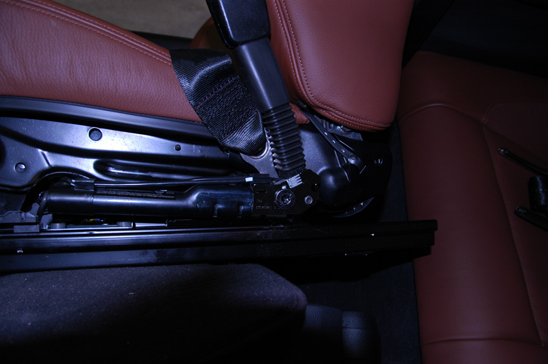

Take that T45 again, and unbolt the stock buckle. Insert the harness mounting point between the seat and the stock buckle, and bolt back in using the same bolt. The threads are long enough that you do not need to use another bolt, and they penetrate completely through the threaded hole. (Pic 8)
Bolt the seat back down. When bolting this down, make sure you have not twisted the belts, and they'll be in the correct orientation when you use them.

Okay. Now put the headrest back on, and adjust your seat to your sitting position. Thread the quick click portion of the front harnesses between the posts of your headrest, and click it to the rear belts.
Once you do that, all you need to do is adjust the belts. Make sure the belt is at or below your belt line, centered and tight. These harnesses are designed to keep you from submarining, similar to a 5 point belt does.
