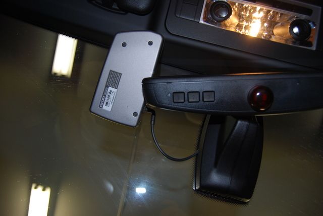

Ok so finally had some time to install my Passport 8500 x50 in my 135i Convertible and hardwire it to the fuse box. Set a few hours to do the install.. It took me longer since I soldered all my connections and used heat shrink for all the connections for a nice clean look..even though you cant see them :biggrin:..

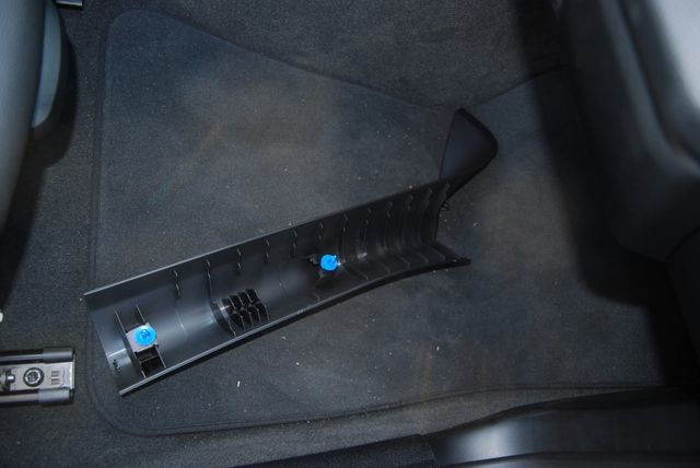

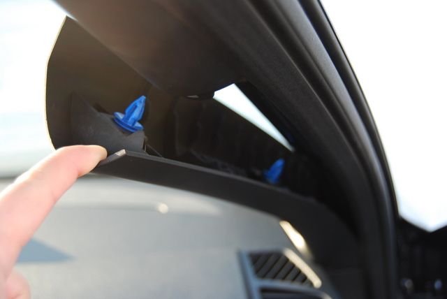

1. Start pulling the pillar trim off. I started from the top and worked towards the dash, there are 2 snap-in 9in blue and towards the dash its a slot and hook type where it slides in. Just take your time and be careful.
Here is another pic with it removed. There are 2 snap-in (in blue) and there is groove and hook type towards the dash.

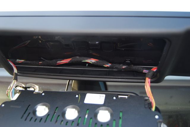

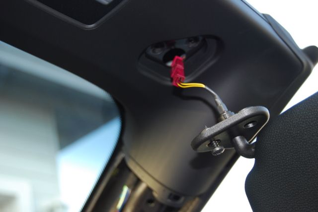

2. Then I started prying out the light assembly above the rear view mirror. There are hooks on all 4 sides. Start from the front, back right, and left. once its loose you can push in the 2 hooks on the right side and it should flip down. (again just take your time not to scratch anything.. If you have trim removal tool, that will really be handy. I didnt so I found some firm but soft plastic tool that worked for me.
3. Next I removed the passanger visor to make it easier to feed the wire. Remove the 2 screws and there should be a cable for the light switch. Very thin wire so be careful and unplug the connector.

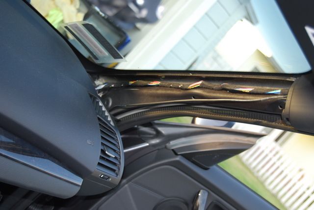

4. Next I started running the cable from the winshield towards across the top, down the pillar and to the fuse box.
For the cable I used some left over stuff I had lying around that was rated for 300volts. it was overkill.. but didnt cost me anything :wink:. I then crimped a RJ-11 connector. Then use the heat shrink to make a nice clean look.

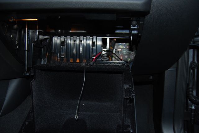

Here is the cable going down the pillar headding towards the fuse box.
Here is the cable now by the glove box. I found that it was easier to just follow the directions in the manual to access the fuse box to save some time instead of removing the entire glove box.

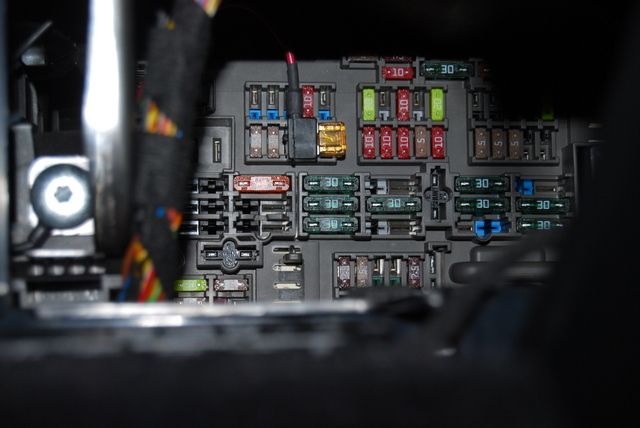

5. I then attached the ground to the bolt on the left and used the add a fuse for the power. I used fuse 8.

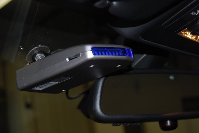

Here it is installed.

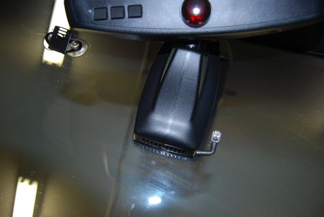

Another Pic from the bottom. I ran the cable around the window sensor for a nice clean look.
When the cord is not in use.. I tuck it around the window senor and wraps around.
Hope this was helpful and enjoy....

Does it turn off when the car turns off? (e.g., Is fuse 8 a switched one?)
Thanks.

Yup.. Its the acc fuse.

How do we tap into the fuse box? The end of this connector doesn't simply plug into the fuse (slot 8) does it?
What kind of set up does OP have going on? It looks as if he has a fuse on the side, horizontally connected to his 8 slot.

It's called a fuse tap. Any local auto parts store SHOULD have them. Make sure it's for the smaller size fuse body though. It crimps right onto the bare end of the wire.
