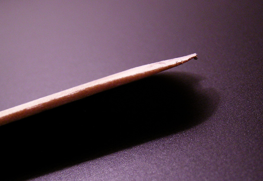

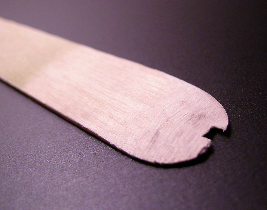

      08-10-2008, 01:43 AM   #10
Oregon
NRA Life Member, BMW CCA 30 year member
Oregon's Avatar
282
2,614
Drives: 04' M3
Join Date: Aug 2007
Location: Oregon
1971 2002  [0.00]
2004 M3  [0.00]
2008 135i  [0.00]
Performed Andy's DIY earlier this evening, a simple prying device assisted in making the magic sucker-thing happen. I submit a modified tongue depressor, reduce the edge thickness so as to resemble a blade, pull the sucker, insert the tongue depressor into the gap thus created, boink, roundel out. The first roundel took 10 minutes, which, included brain-farting the idea, modifying the tongue depressor, doing the deed, the last roundel extraction/install took 20 seconds. It works. The 'tool' got a bit banged-up...
Thanks Andy.

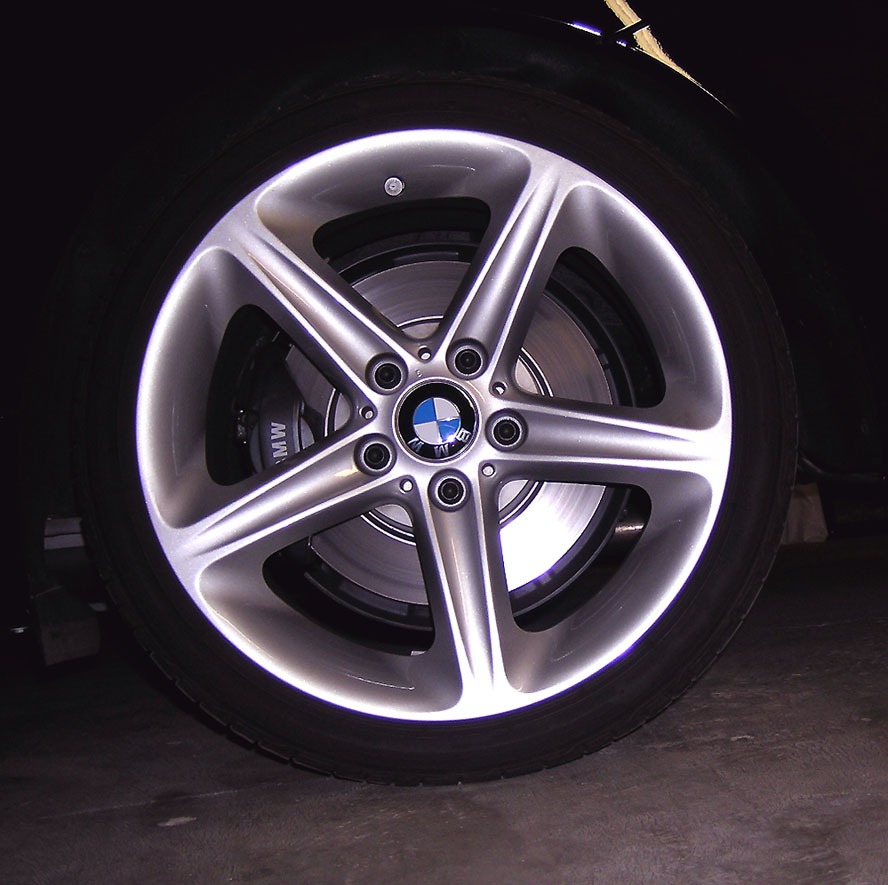

      08-11-2008, 12:53 AM   #20
Oregon
Oregon's Avatar
282
2,614
Drives: 04' M3
Join Date: Aug 2007
Location: Oregon
1971 2002  [0.00]
2004 M3  [0.00]
2008 135i  [0.00]
Before...apologies for the filthy rims, I blame 'the mountain', see sig.:wink:
Resigned 1ADDICTS Moderator
“To disarm the people is the best and most effective way to enslave them.” – George Mason
      08-11-2008, 12:53 AM   #21
Oregon
Oregon's Avatar
282
2,614
Drives: 04' M3
Join Date: Aug 2007
Location: Oregon
1971 2002  [0.00]
2004 M3  [0.00]
2008 135i  [0.00]
After...the replacement roundels retain their position far better than the stock items as well.
