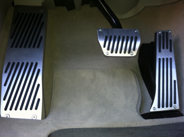

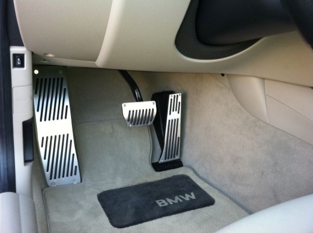

To my surprise, they fit perfectly! There was no drilling required for the clutch and brake pedals, and the accelerator was easy enough to remove from the car, drill the 4 required holes and bolt the new metal pedal on top.
The footwell pedal was also included in this package and it was easy enough to drill four pilot holes into the stock plastic pad and mount it over the top.
Looks amazing, about 10-15 minutes work. Very grippy, at least equal to the stock rubber clutch/brake pedals and much improved from the stock plastic accelerator and footwell pads.
Just wanted to give people heads up that these cheapies are actually quite good quality (one of the screw holes was not completely drilled on one of the brake/clutch pedals but easily fixed by ramming a screw through it by hand). I was very happy not to have to drill through the clutch and brake pedals as some other sets require.
Pictures from my phone (apologise for quality):
Thanks Satalite for your install photos!

Couple of images that may be helpful for installs (note not the same set of aluminium pedals that I used):
1) accelerator - small circle that needs to be flipped to access hex bolt.
http://img130.imageshack.us/i/accelz.jpg/
2) brake/clutch pedals with the stock rubber covers removed.
http://img684.imageshack.us/i/nakedpads.jpg/

Reviving! Just installed my set the other day! Will be taking pics this weekend. By far this set is 100% worth the money and effort of install.
Couple words for those wanting to do the install... take the accelerator pedal hub off after you have pre-drilled holes and then screw on the new pedal cover. It was hard enough reaching behind it in such a small space. The bottom right screw gave me the most trouble as I didn't know how to detach the pedal from the boot.
AT brake pedal is drill work. Just drill through metal and screw in, easy. And dead-foot is the easiest just pre-drill small guide holes then screw in!
All in all difficulty is about a 6/10 considering the screws/nuts are small and frustrating!
The look of the pedals is a 10/10!
Special thanks to Tyorll for helping me with a detailed PM and pics!
I would advise some lock-tight and the screws before putting on washers and nuts so no vibrations loosen anything. Takes an extra minute when installing each screw.
