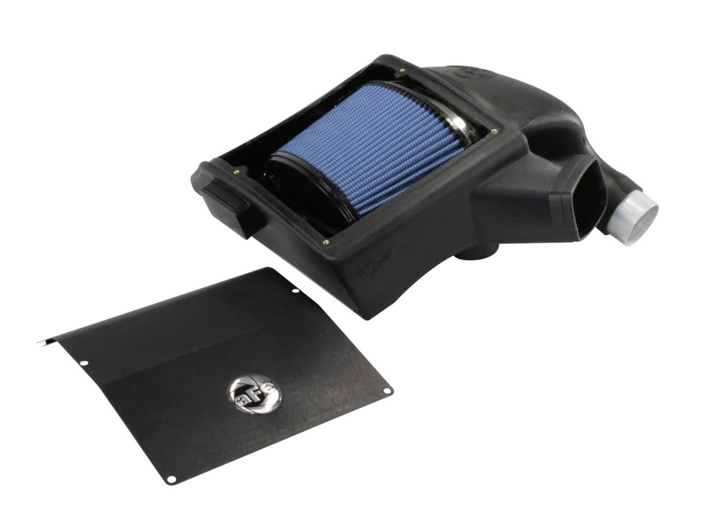

There is a new "Closed" AFE intake available..do a search
Here you go!

whats up with the new afe one? is it supposedly better??
      05-27-2011, 01:35 AM   #8
It's a sealed system that provides maximum cold air and keep the hot air out.
then isnt it the same as the stock one but with a cone style insert? I just cant see the difference.

how would the CLOSED afe box do against the stett cold air intake
Open your oem air box and have a look, more than half of the filter is sitting against bottom of the air box with minimum exposure to the air, volume is greatly reduced at those surfaces. In addition, the cone filter has a much larger filtering surface than the oem panel filter.
Harold
it's confusing me a bit.
so you mean, previous afe CAI is better than OEM, and the new afe CAI
is better than previous afe CAI??
even it looks like previous ver. one has more larger filtering surface than the newer one??
Either of the AFE units is better than stock when you're running higher than stock boost. The closed one has the added benefit of keeping the heat down on the air that's entering the turbos. The open one still has a heat shield and is very unrestricted, but the closed one has better heat shielding.
At stock boost levels, the open intake would probably be roughly equal to the stock. You lose some performance and response in the lower RPM and boost ranges, because the engine is sucking in less air overall and the negative effects of the heat are more pronounced. However, at higher RPM and boost, you need much more air to enter the engine, so in this case the open nature of the AFE is very beneficial and outweighs the bad effects of the heat.
At stock boost levels and lower RPM, a closed intake would make more sense because you won't get "heat soak" which is the lack of initial power and response you get due to the extra-hot air. However, once the turbos start spooling and sucking in lots of air, the heat isn't the biggest factor, it's all about how fast you can get more air into the engine.
I think Harold @ HP Autowerks was saying that compared to the stock airbox that came with the car, the closed AFE intake has more surface area. JZ was wondering why go with the AFE if it's a closed box with a cone filter, versus the stock BMW itnake which is also a closed box of a different design, with a flat panel filter. The cone filter provides a larger, 3-dimensional surface to filter and suck in the air, while the stock BMW filter is a 2-dimensional flat panel, which rests very close to the walls of the airbox which greatly restricts the air coming in.
2024 i4 M50 | 2008 135i | 2024 S1000R
Scruffy's gonna die the way he lived... Mmhm.
