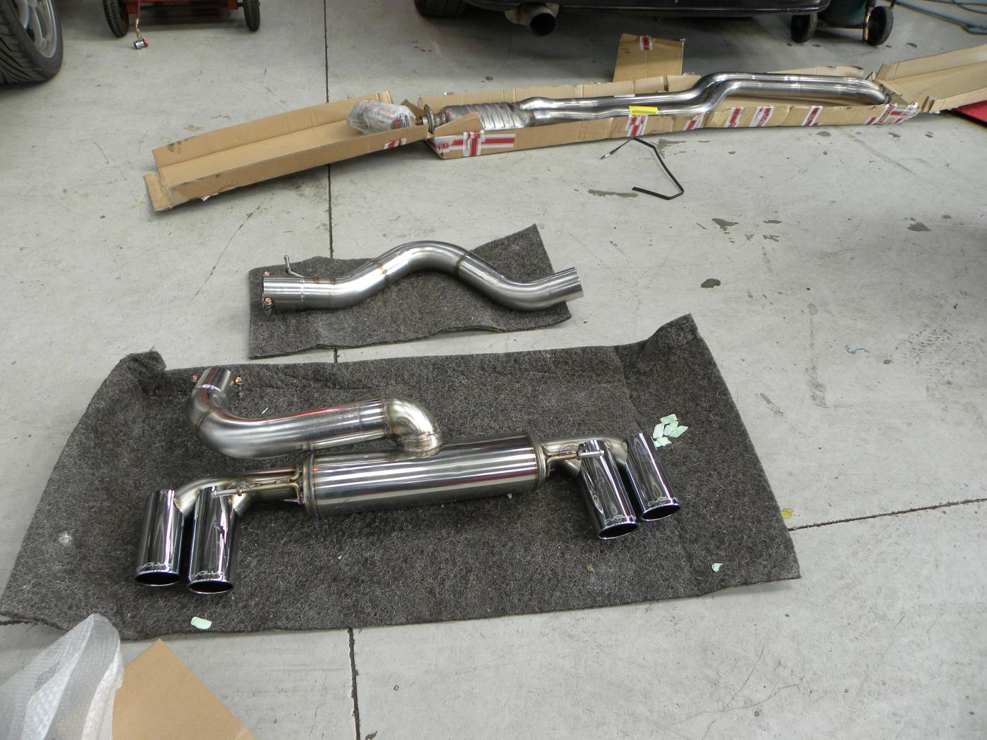

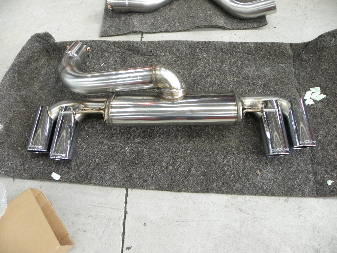

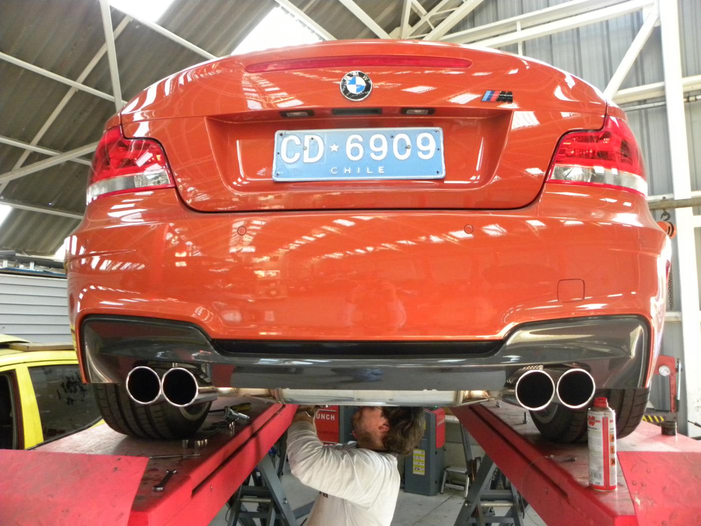

Fellow members: remember my recent post in the other Evolve thread concerning installation of this set up? Here is a few photos before and after the dyno and installation of the exhaust, one of the posted photos is the actual dyno chart (before install so fully stock, Mustang dyno), this website does not let me post it otherwise, don't know why yet. About the dyno results and my first impressions please read my previous post in the other Evolve thread in this section. A sound video is coming soon (fingers crossed). Any questions, I will answer here or as PM.

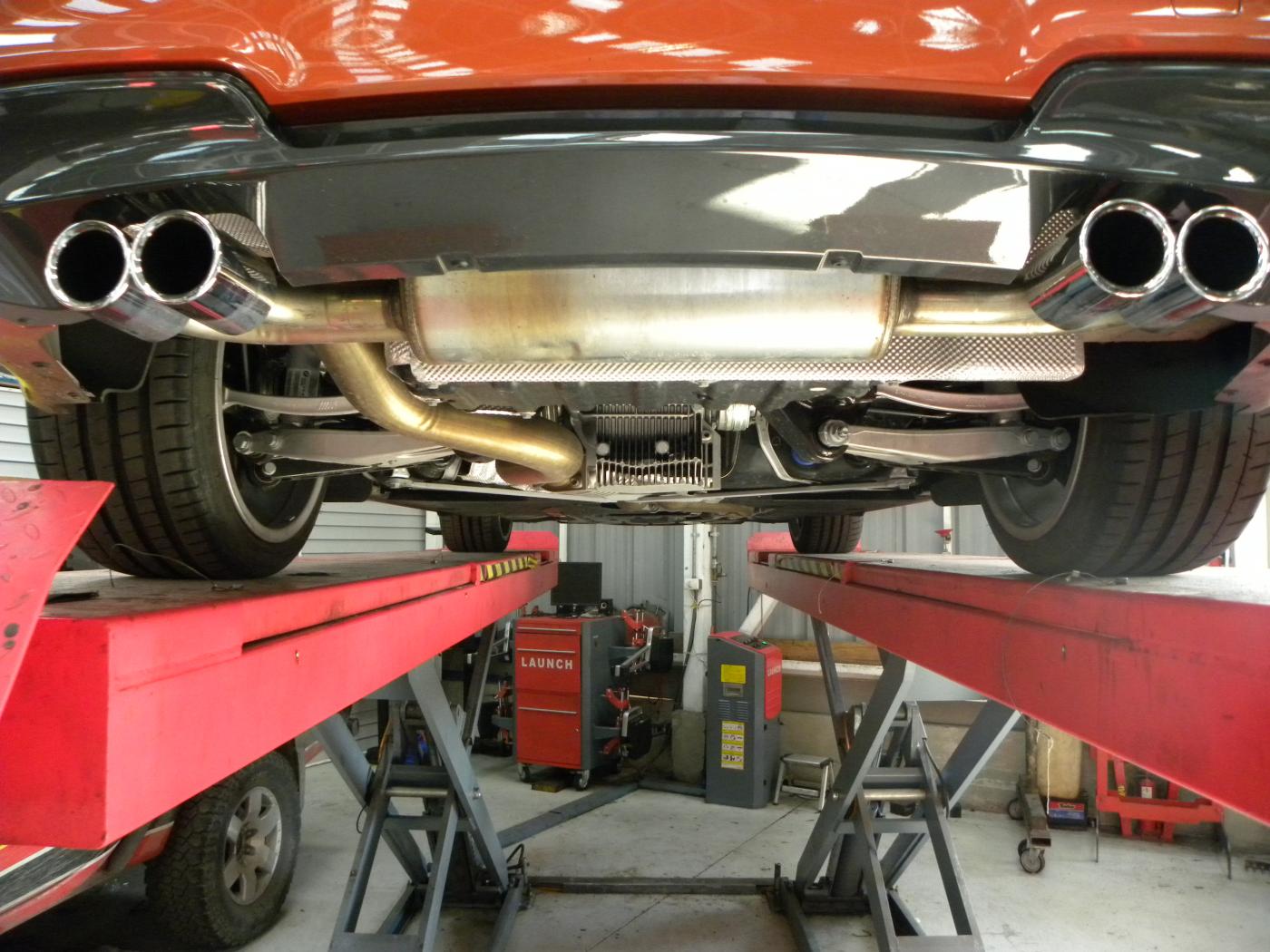

More Pictures:

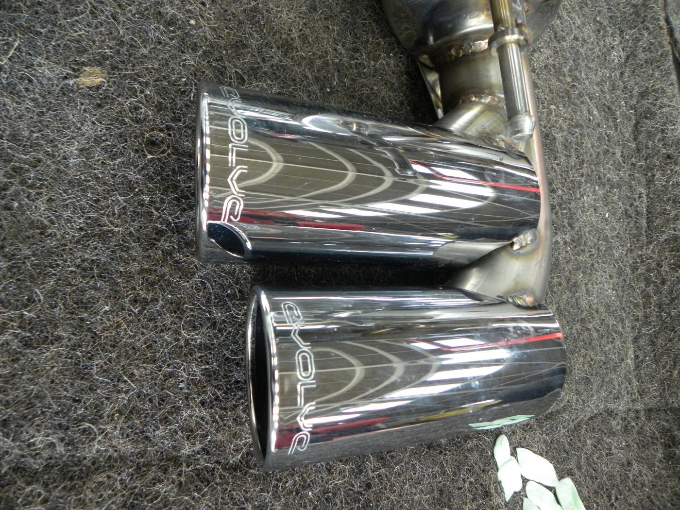

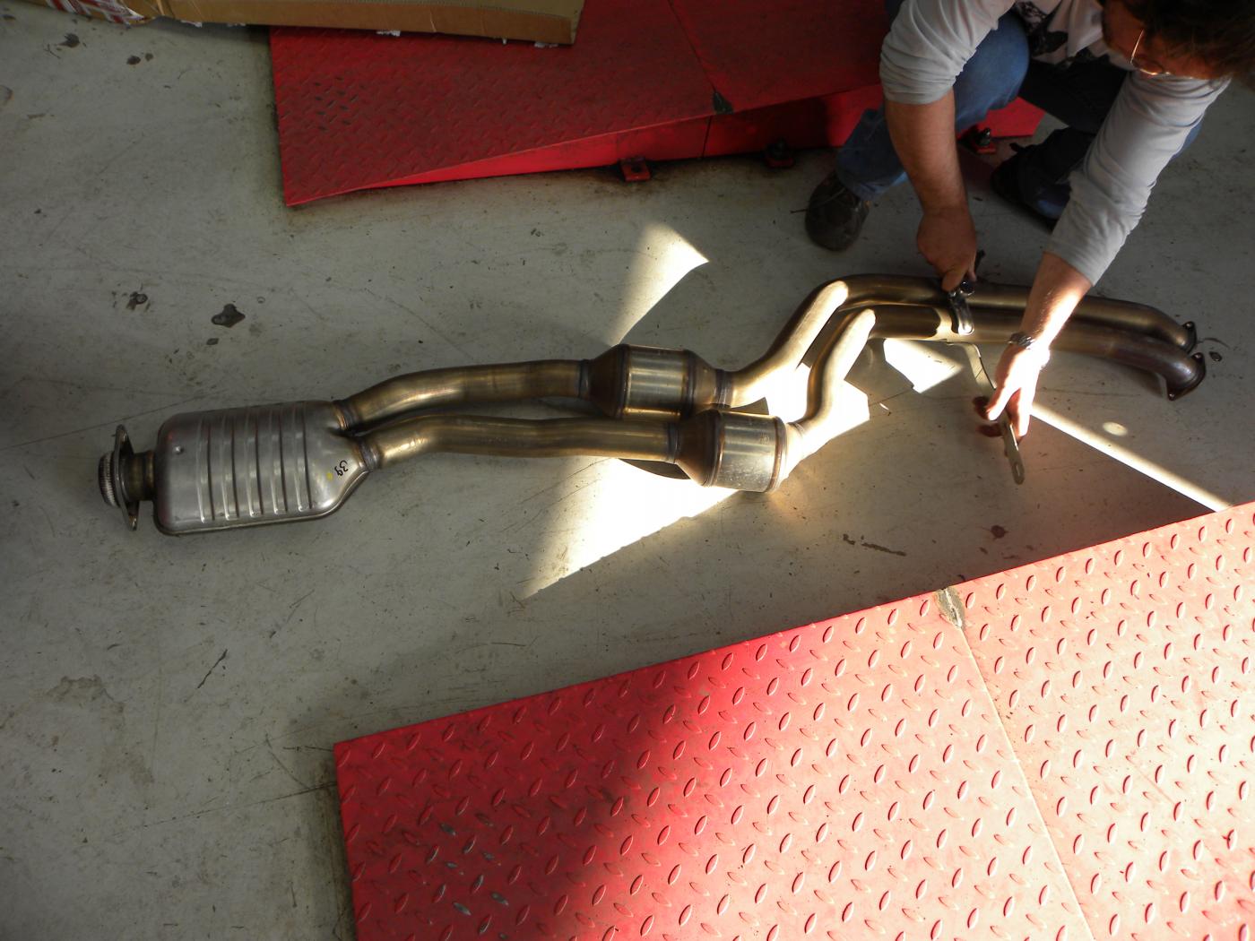

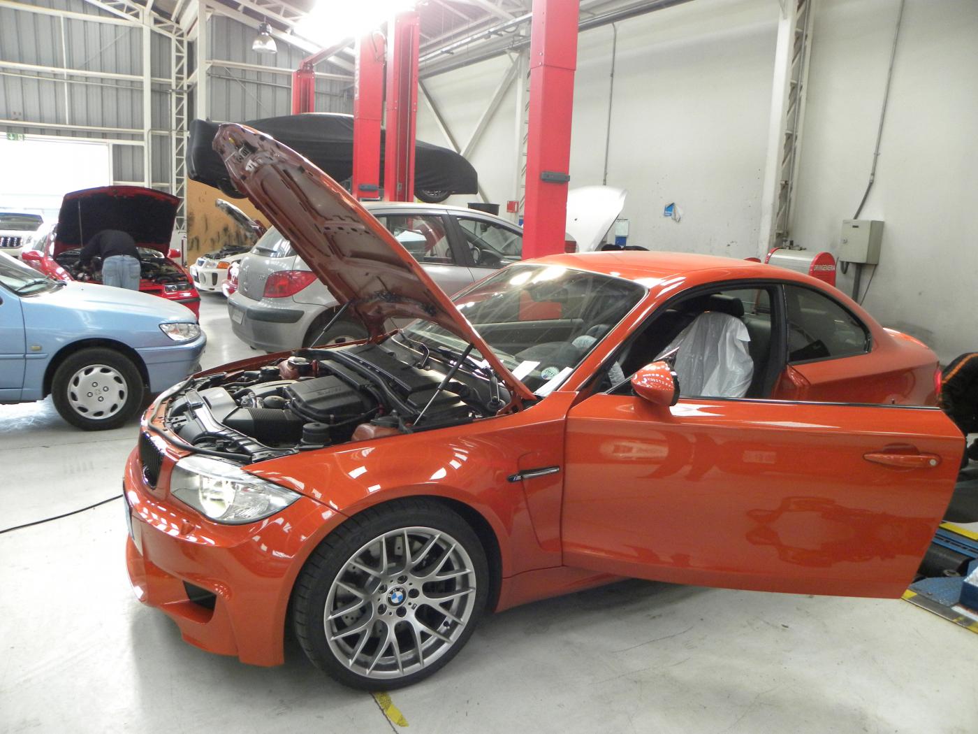

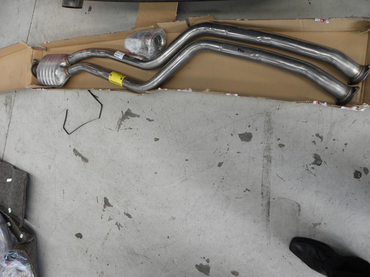

Here is my recent post from the other Evolve thread:
"Long Post, WARNING!
So I just installed the Evolve Race with N55 midpipe today. First sample of this combo as far as I know. Also put the car on a dyno before the exhaust install in order to have a baseline and see what it makes stock. I can't post the pictures I took here and now plus dyno chart will be sent to me tomorrow or so by mail from the shop (very late here and shop closed later than normal just because of my car so...), in the meantime I plan to make a sound clip too and post everything packed together in a separate thread as soon as I have some time.
Here I got to say that it was great service and price from Evolve (thanks Imran) for such a fine product. I also found a gem of a workshop in Santiago and met some great people thanks to fellow Forum member ///Morgan.
In a nutshell, car performed as expected (butt dyno impressions) at the dyno, no more no less; it was a Mustang Dyno, and the operator told me that it really really reads low(er than people want to see) so I should not wait anything over 280 hp or so he commented, they had 2 1Ms there previously but for install jobs merely not on dyno, I told him that it will perform better and be closer to 300 than 280, my car has just 3100 or so kms., was a quite warm day (25 to 30 Celsius) but no humidity to speak of, acceptable but not ideal fuel quality (Shell 97 RON V-Power is best we have here, I assume it is somewhere between 91 to 93 US, or 95 to 98 Euro gas), M button pressed, DSC off, a total of three runs at 4th gear, all consistent, peak power was 294,2 hp and torque was 342 lb-ft at the wheels. If I follow what I keep on hearing and what the dyno operator suggested I should take it as minimum 350+ hp and 550+ nm of torque crank, confirming what I always thought, that the stock car is closer to 360 hp and 550-560 nm torque than the factory's official numbers. The real point is now I have my baseline and car will go for another dyno run there but only after I make around 500 km. with the new exhaust and I'll see if there is any change.
And exhaust: I know everyone rightfully will want a sound clip and photos and I will provide ASAP but I have to say it is exactly like I wanted it (and the stock car) to be: calm and understated when you keep it low and very rich and strong when you press it and there are lots of tones in between. It burbles all the time Drone was still present during my first drive back home but it is much less annoying (my car had a good deal of drone between 2000 to 2900 rpm) and at a narrower band than stock (like 1800 to 2300 and less in tone), much better to my ears. I can already say that throttle has a more natural feel (default setting, non M mode) and good response. Fit, finish all top notch and very light exhaust compared to stock (did not weigh it but I remember that Imran posted when they first announced it). Overall, very refined exhaust set up for half cost of some top priced ones and far from some one-dimensional products (I mean just making loud for sake of loudness), imo fits the 1M like a glove, an enhancement of the stock sound, polishing it wherever it really needs and preserving whatever was already good; only educated eyes and ears can (quickly) tell that there is something else down there. Together with my Michelin PSS set, the exhaust kind of complete the stock car's near perfect feel and give full satisfaction. Promise: next is a separate thread which will have essentially what you guys can see and hear."

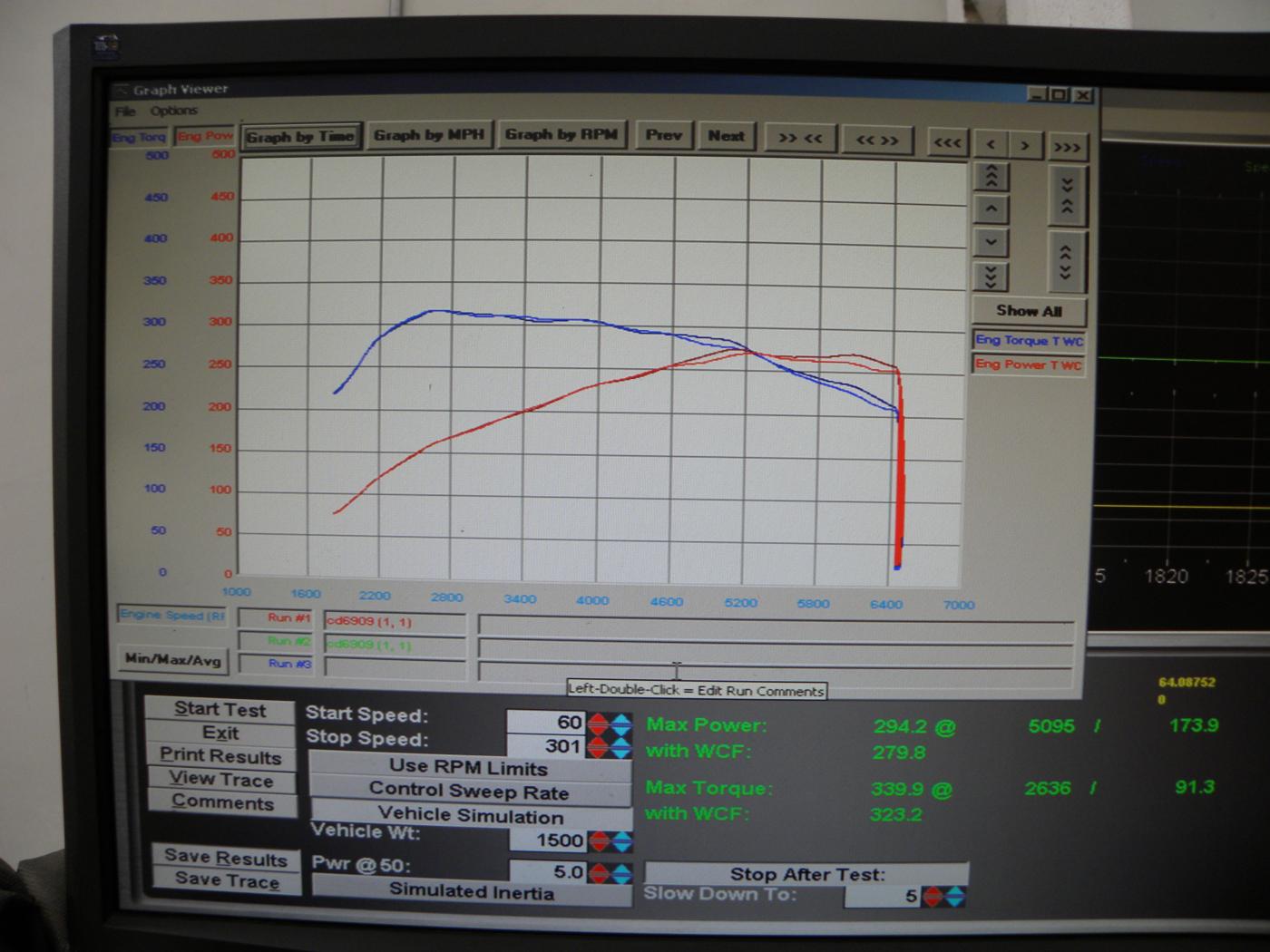

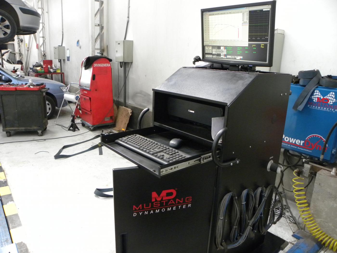

LONG POST: New Dyno; Better curve, a bit more hp and tq
I finally had the chance to go to dyno shop again to check what is the difference after installing Evolve Rear muffler and N55 mids sometime ago. I made close to 580 km. before doing this second dyno and the car is exactly same, nothing else changed since then. Did my best to secure close to identical conditions; same gas brand and type, same levels, same dyno shop and operator, same 4th gear runs ending around 6600 rpm, M button pressed, DSC off. I was not able to pick a day with exact same temperatures though but don't think the difference of max 5 degrees Celsius worth too much, was just a bit cooler today than the first dyno day.
Reminder: it is otherwise a stock car. Bone stock, peak power was 294.2 whp and peak torque was 339.9 lb.ft (note: car did better tq in another run with 342.9 lb.ft). Almost identical numbers with GIAC's Mustang dyno tested stock 1M, so reliable and believable.
It is a Mustang dyno reading seriously lower than some other dynoes. But it is well calibrated and consistent like its operator (great guy). Recently a 2012 stock E9X M3 dynoed there he told me, with 323 whp, before installing a supercharger and other stuff. I saw the chart and numbers which is confirming other Mustang dynoed M3s from US and other countries.
Today my 1M with stock down pipes, N55 mids and Evolve Race rear muffler dynoed 300.5 whp and 347.1 lb.ft. So, registered an increase of 6.3 whp and 7.2 lb.ft wtq.
I am going to post the new chart and a second chart with old and new together as soon as possible, when I receive them by mail. The real good news is there is constantly more hp and torque after around 2600 rpm till the end, and the higher the rpm the higher the difference from stock car. The hp simply doesn't fall at all after 6000 even 6500 rpm and torque is also smoother at the top, lots of power and tq up there (stock was not too bad too compared to other N54s). The stock car's peak hp came at 5095 rpm while today it was reached at 5454 rpm.
This exhaust set up is just perfect for someone who wants a calm and refined sound before around 4000 rpm and wants the car sound mean and loud after that. And after this dyno I happily noticed that my butt dyno impressions during this last 580 kms. were right and revs flow easier now and when the sound starts getting really different vs. stock exhaust, which is after 4000, the car indeed is pushing harder all the way to the top.
If I follow the same suggestions for calculating the crank hp and tq, stock car was 350+ hp and 550+ nm and with the exhaust it is now 360+ hp and 560+ nm. The operator thinks it can be even more than 370 hp but I am playing safe and conservative here. Literally, only 23 less whp and around 60 % more wtq than a V8 M3, that's what it is, nothing more nothing less.
Another thing that I now know is there is no way you can make 15 whp or more just with a midpipe or rear exhaust on a bone stock car, you make less, even midpipes and muffler together hardly gets close to those numbers at crank. But whatever you make you can make at all the right places. I am sure a car with full bolt on mods and a good tune will have double or more gains from this exhaust set up but for me it just delivered everything I was hoping for
Charts and a new sound clip during one dyno run will follow.
