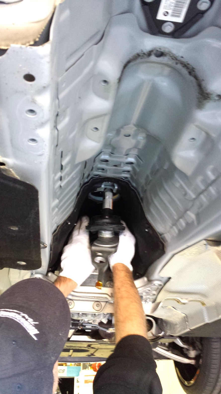

Thanks to some advice from friends in Singapore, I had just the shift lever from the BMWP SSK installed in my car i.e. part#25110434217
The shift action is definitely shorter and much more direct. It took me a week to get used to it, but once I had CDV it felt perfect. I think it suits the character of the car better than stock, plus peace of mind of genuine BMW part.
It's not tricky, just a bit involved with mid-pipe & driveshaft needing to come out. Pete@Advan (Skycat) is across the install detail and can help anyone else out.
Here are some pics...

Fitted mine today. It is really short and firm, but good fun on gear changes. I will post up some pics soon with before and after measurements. It does sit about 1" higher. Even the dealer gave big thumbs up
How does it sit 1" higher? That seems a lot. You mean the actual gear knob sits higher? Do you think that might annoy you? Looking forward to seeing the pics
