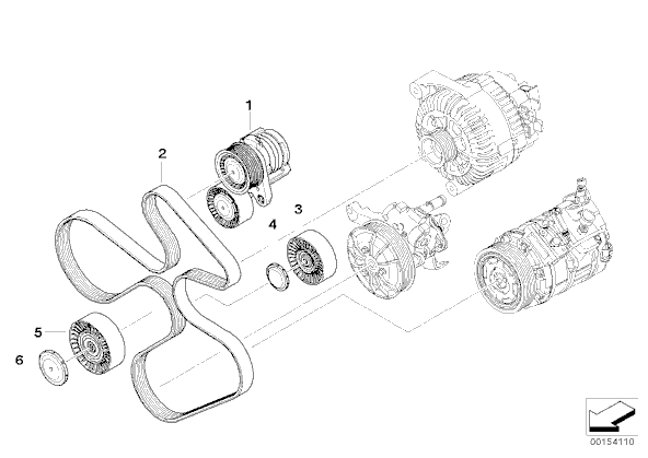

gahhh couldnt find a n47d but im sure n47 is same set up
http://realoem.com/bmw/diagrams/m/g/232.png
just two bolts. yank on it, should come off. twisting it sideways helps as well

thanks, i removed the two bolts, but the alternator is still stuck, i dont know if is really necessary to loose to belt or if it will jump off with only these two bolts removed..

Changing the Alternator...
First DISCONNECT the battery before working on the Alternator. I have seen guys cause firs by forgetting to disconnect the battery! Look at RealOEM.com it looks like there are only two bolts. But you will have to remove the polly ribbed drive belt - to remove the alternator. I have never done it on a 1er but this aint rocket science. lol
Here are some pics to help you out. Perhaps have a BIG pry bar handy to pry the old atlernator out of its bracket that is bolted to the engine.
Good Luck
Dackel
