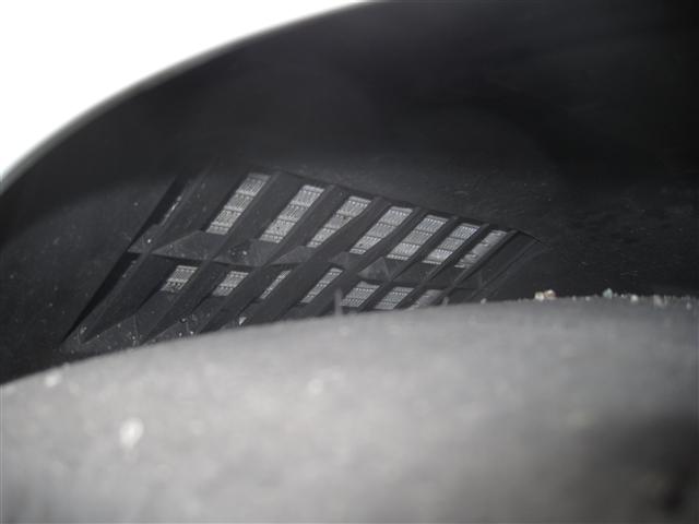

I am glad you posted this. I was looking at the liner a couple of days ago and noticed that an area of the vent part looked to be molded to give room for the tire to squeeze in. I couldn't tell if it was shaped like that by design or if it was caused by rubbing.(I am on the stock suspension and tires.). Now I think I have the modified wheel well liner. Cool.
Anyone with an older build able to confirm this same piece?

My 1M definetly has a notch taken out for clearance, definetly OEM and not done by the tires.

My worn liners (see attached).

The shape of the notches shown on the pictures is OEM and perfectly normal, though (the ones in the middle inclined = OEM). It already indicates that BMW knew that it was a close call. However, still not enough for 100% clearance for the 270 winter set-up on most 1Ms (see also the rubbing traces on the pictures). Fender liner should be "deeper" (towards cooler) to avoid any rubbing at all.

So you mean there is an indentation already in the liners?

If you're talking about deformation on the middle 3 fins then yes, that is molded in.
